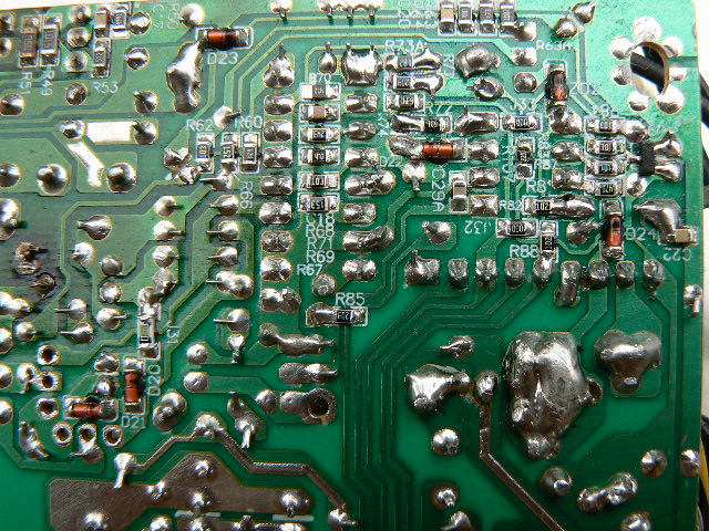

                        Any chance you can post a few pictures (top and bottom side of PCB) of the controller area?
                        These ICs usually don't go bad, but it's possible that the out-of-control 5VSB pushed the auxiliary supply too high and killed one of them.

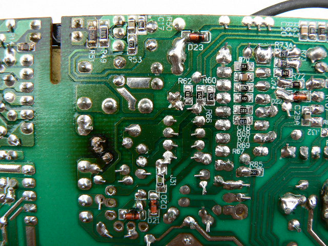

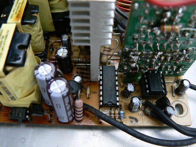

                                  Pins 8 and 11 are the output from the 7500 chip. Notice that before changing the 7500 chip you had a noticeable difference in voltage. They should have been the same. After replacing the 7500 you still have a slight difference. It is common that when the 7500 goes bad one or both of the driver transistors also goes bad. I recommend replacing both driver transistors AND the small (usually glass) diodes in the driver circuit. There should be 3 or 4 of them. Also check resistor values in this circuit - sometimes a resistor has changed value due to burn damage.
                                  From your voltage readings, it looks like your psu is trying to come back to life. If you still don't get a twitch of the fan when attempting to turn it on, I would look at that driver circuit between the 7500 chip and the small driver transformer. Two transistors, 3 or 4 diodes, and a few resistors.

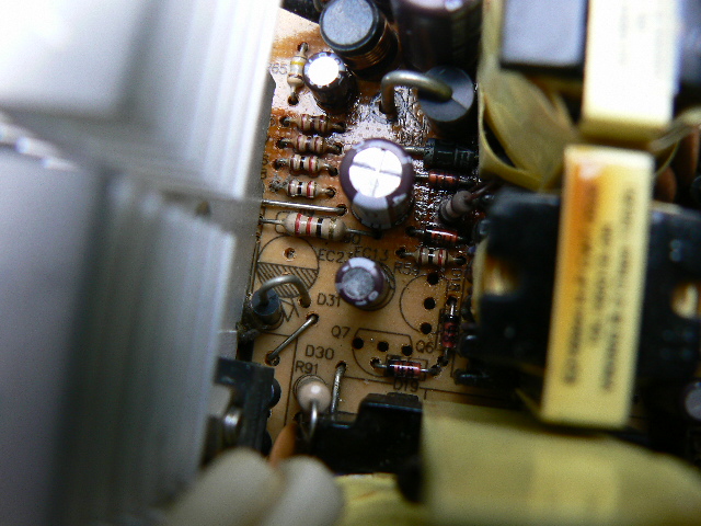

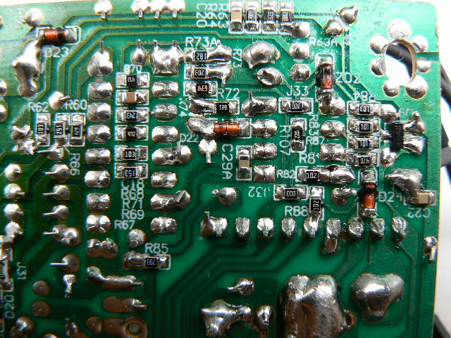

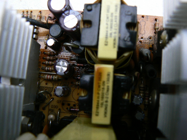

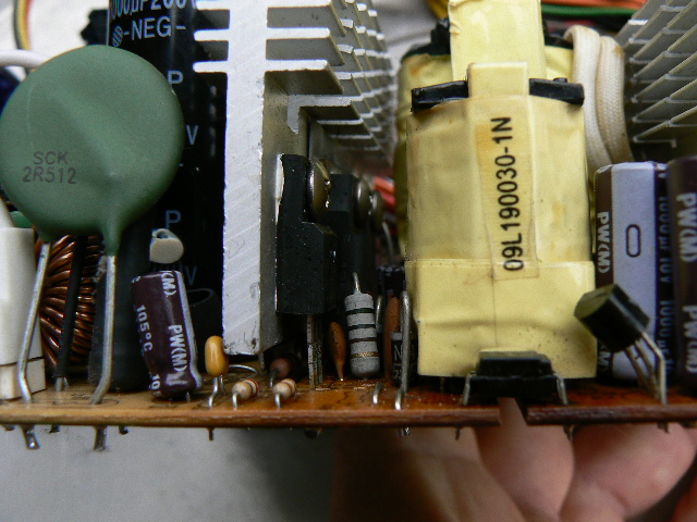

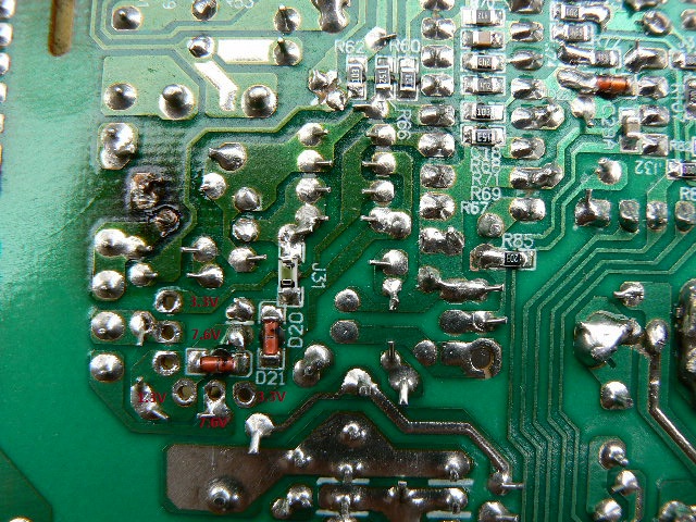

                                      I finally have pictures. I removed the two transistors attached to pins 8 & 11. They and the diodes all test good with the DMM diode test. The transistors are H945 and I do not have any on hand with that pin-out so I decided to check the voltages with them out. I put the voltage readings directly on the first image by the pin location.
                                      Pin 16 on the KA7500 came up to 0.73V and pins 8 & 11 went to 3.3V. I still do not understand what all the pins on this chip are supposed to do so I do not know what the voltages should be on them. The datasheet says the typical voltage on 8 & 11 is supposed to be 30V. Is this supposed to come from a transformer or does this chip generate that voltage somehow?
                                      If I need to take pictures of something else or differently let me know and I will do my best to take them as directed. Any guidance on what I should do next would be appreciated very much.

                                        I found a couple of C1815 that I was going to use in place of the H945, unless there is a reason I should not. Would BAT85 diodes work to replace the hole mount glass ones (D18, D19,..) tied to the two transistors I am replacing? Should I also replace that vertical resistor next to the burnt spot and transformer, D18 is pointing up at it. It seems to test good with a DMM but I am not 100% of its' value.

                                          I am sure that those of you that are tired of seeing this thread pop up will be glad to know that this supply is back alive. I am not sure which part was the magic part exactly. I replaced the two H945's with scavenged C1815. The diodes turned out to be 4148's and I had those on hand so they were replaced. The thing I did that I feel uncomfortable with is replacing R51 which looked burnt and had a tested value of 1500 Ohms. I did a search on SmartPowers and "R51" and it came up with Everell saying he replaced R51 with 270 Ohm resistor. Thinking my burnt one had a higher than rated resistance I put in a 1/2W 330 Ohm resistor. I do not know what this resistor is for so I am playing with fire in a way, but it works. If anyone knows the real value for this resistor (R51) I would be grateful if they would share it and the life of my power supply may depend on it.
                                          The Fan now runs a decent speed with the resistor mod. I have to change out the main caps for the new Chemicon's that I have for it. I also still have to do the 5.6V Zener / 5VSB mod and I thought I should use two 1 watt Zener's instead of one.
                                          I did notice that my -12V was only slightly above -10.xxV, I do not have the exact numbers with me but they were closer to -10 than -11. Is this normal for these supplies or do I still have a problem?
                                          I want to thank everyone for their input, it was priceless as I was really lost. This has been an excellent learning experience. I still have a lot of power supply gray or just plain black areas but at least bad supplies do not have to be instant garbage fodder for me any longer.
