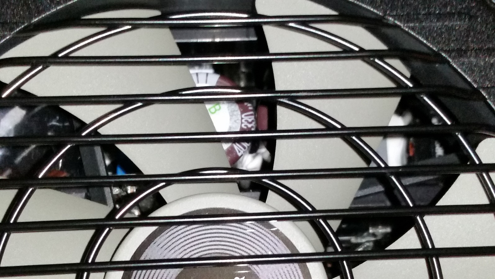

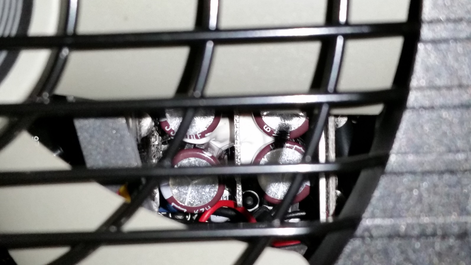

              I hate to dig up an old thread, but Corsair's new RM650 and RM550 use almost entirely CapXon on the output (although the 5vsb has NCC). The worst part is, it's fanless for the first 250W or so
              Yeah Old thread, but the RM no longer uses Crapxon and Lshit. It looks like the new revision using 100% UCC caps, both for primary and secondary. Also the manufacturing looks way different now, perhaps someone else is making them for Corsair now.

                nice, KZH with heatsinks both sides.
                i wonder how long they will last like that.

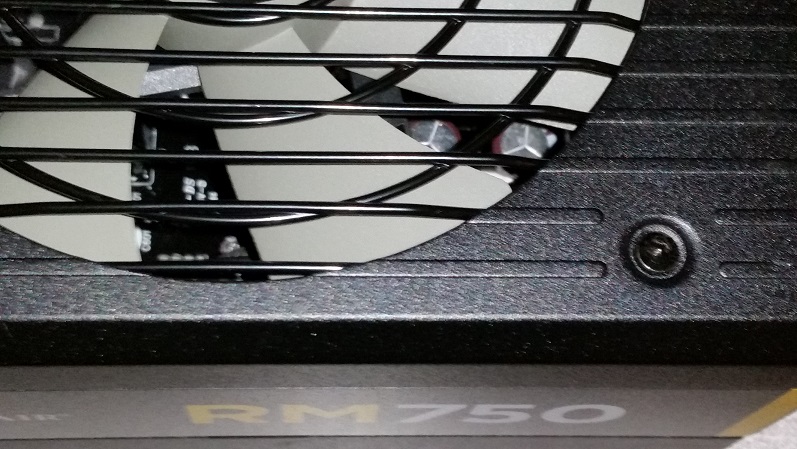

                  Re: Shame on you Corsair! (Capxon)
                  Niiiiiiiice!!! Hopefully, corsair quietly changed (they never specifically said they did, though), or maybe they chop and change on them depending on what they have in stock, and you just got lucky.
                  btw, that's the RM750. It never did use CapXon, since the RM750 and 850 were made by a different OEM (Chicony). They usually used LTEC on the secondary side (which are about on par with CapXon in terms of quality from my experience). Delta often gets away with using LTEC, but they fail a lot for everyone else.
                  EDIT: No, the Chicony-built RM series PSUs are now discontinued. Corsair uses CWT for all RM series models now.
                      For their customers' sake, I hope Corsair is acquiring genuine NCC capacitors.
                      LTEC's general purpose capacitors do have a penchant for drying up very fast with no discernible cause (similar to 4mm-8mm Teapos). However, IMO, their low ESR capacitors are MUCH better than CapXon. Yes LTEC capacitors of all kinds fail enough to be considered bad but if you compare the ratio of failed LTECs to failed CapXons there is no comparison. CapXon fail very fast in well cooled and ventilated equipment whereas Delta have proven that LTECs can last if kept cool enough, at least for a while. But that doesn't go without saying that CapXons are commonly found bad because they're (unfortunately) a very popular choice of capacitors in OEM equipment.
                      Hard to say. I say that because if you read this thread, in a DPS-800GB, it didn't take long for a KZH on the -12V rail to blow its bung out and halt the PSU's operation (at the bottom of the page). That sounds similar to the way KZGs and KZJs fail. Also, if you look at this thread you'll see a 1000uF 16V 8x20 Chemi-con KZM bulge and the other 1000uF 16V 8x20 Chemi-con KZGs (on the VRM input of a Socket 754 board) look visibly okay (though a couple 6.3V ones failed as usual, and KZM is supposed to be the "long life" version of KZH). I know a couple failures isn't much to go by but knowing Chemi-con's history with KZG, KZJ, and all capacitor series equivalent and lower from them in terms of ESR... it also could have just been that the OP's PSU was bad as well, and the fact that all those VCORE high capacitors are right up against two heatsinks. Or it could be bad seals (why they fail without bloating often). Chemi-con claims, in their datasheets, that their KY, KZE, KZG, and KZJ series of capacitors all use the same "special, low resistivity" electrolyte, yet we all know that KZG and KZJ have a bad formula, but never see KYs and KZEs fail like that ever (KZHs were claimed to have used a "unique water base electrolyte" - may as well be the same thing).
                      I'm not trying to knock Chemi-con or call out KZHs as unreliable as I have never seen any fail myself. Chemi-con do generally produce excellent quality capacitors.
                      EDIT: The KZM might be a replacement for a bad KZG but it still kind of looks to me like it's bulging in the second picture which is why I brought it up. It might just be the picture, though.

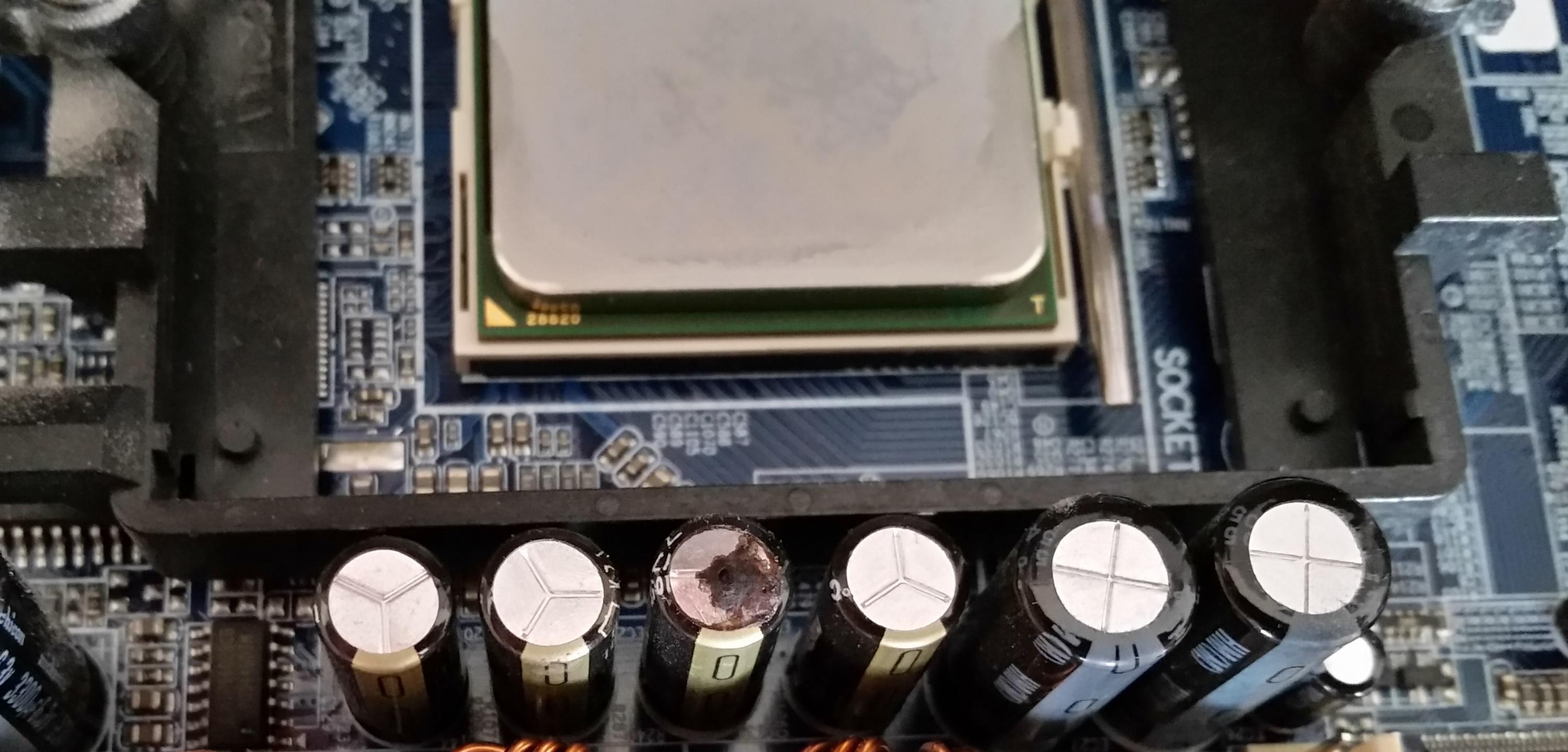

                        Speaking of UCC...I just recapped Old Gigabyte with bursted KZJ in it , yeah they certainly had bad batches for sure, but I personally had never seen bad KZE or KZH.
                          I remember some people from Corsair saying that Japanese caps would only be used in positions where caps would fail under warranty.
                          The KZM looks like the replacement for a bad KZG. Only the three leaking KZGs were replaced, and KZE and KZM series caps were used.

                            #113
                            Yup. The KZM never failed in that thread. It was simply what was used to replace the bad one.

                                  #116
                                  Problem is that you can never know if it was a bad quality cap or misuse, especially if caps are used in some kind of VRMs...
                                  And that looks like it's a Socket 939 or even 754 board...

                                    KZE and KZH should have different electrolyte than KZG/KZJ. They are being used for many many years now in all kinds of power supplies, I do not know about a single failure.

                                      #118
                                      This was my old s 939 board that was laying around in my pile of old parts. The visibly bad KZJ failed long time ago I just never bothered fixing it since I was doing major upgrade. The reason I fixed is because I wanted to build gaming pc to play old win xp games.
                                      The point is that KZJ and KZG have been known to fail under light use and we'll ventilated area.
                                      https://www.youtube.com/watch?v=xb0sg8QavDI similarly what happened to this board.
                                        Yeah, they'll fail pretty much anywhere. But on your board, they were doomed for a very early death being on the VRM low side, plus getting all the warm air coming off the CPU heatsink
                                          Yep... Works good now...
