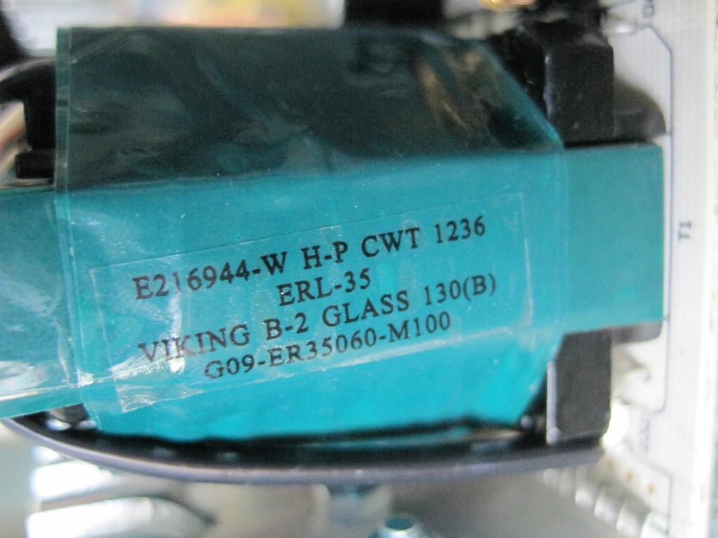

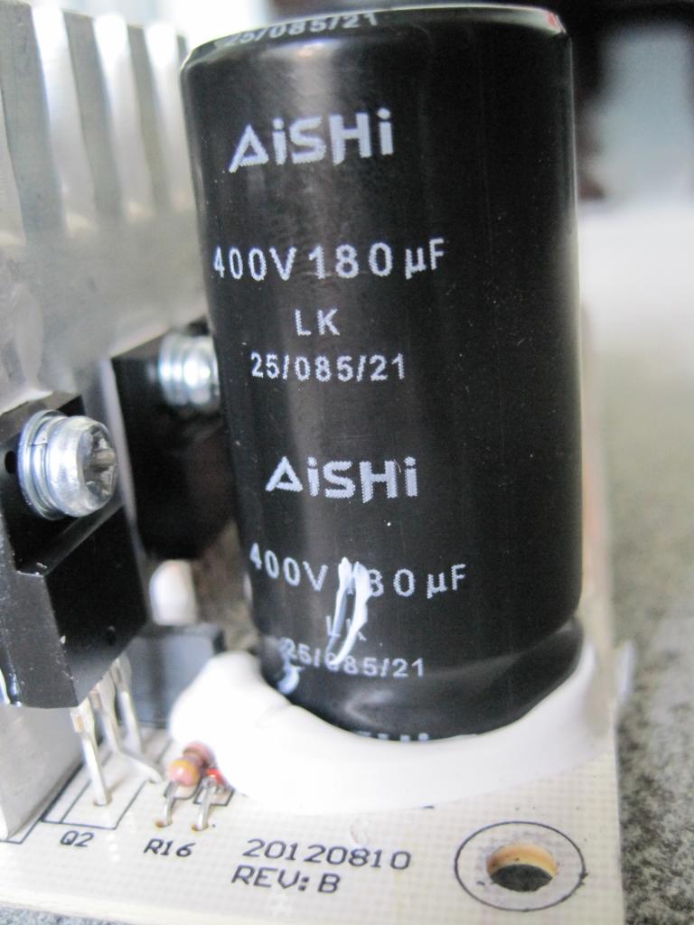

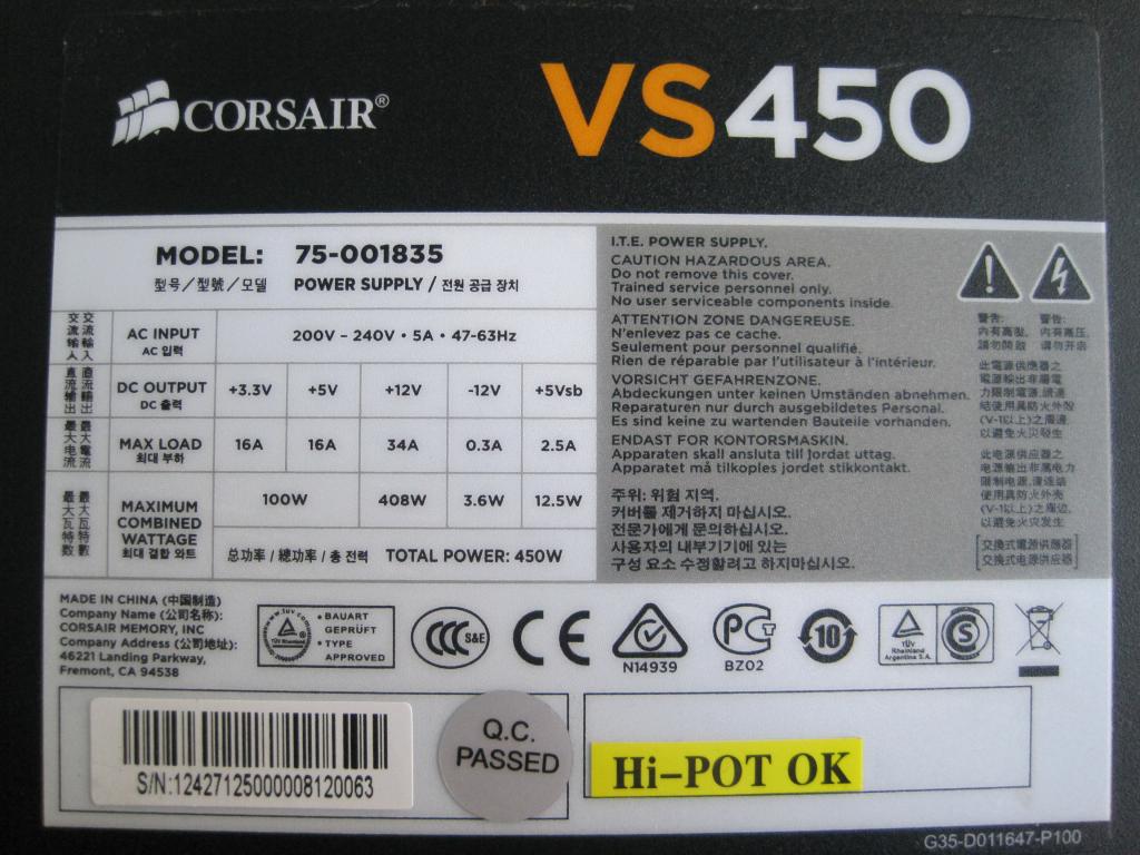

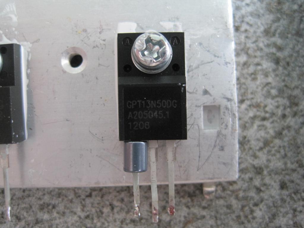

                          Sorry for a bit OT but related to Corsair - VS450, fake wattage ?
                          Corsair has recently launched the VS450 model in Vietnam. According to their website, they claim that: "Real power. The VS450 delivers a guaranteed 450 Watts of continuous power"
                          http://www.corsair.com/cn/vs-series-...er-supply.html
                          Today, on some Vietnamese forums, users have a suspicion that the VS450 can't deliver 450W. None of those have enough equipments to test. The link below is in Vietnamese but pictures say everything:
                          http://vozforums.com/showthread.php?t=3059996
                          Primary rectifier: GBU406, main transformer: ERL-35
                          Any expectation that it could deliver 450W ?
                            #73
                            Re: Shame on you Corsair! (Capxon)
                            Certainly not with 180uF of bulk capacitance!
                            For a PFC design, it's generally capacitance (in uF) doubled to get output power.
                            So 360W would be a good rating for it.
