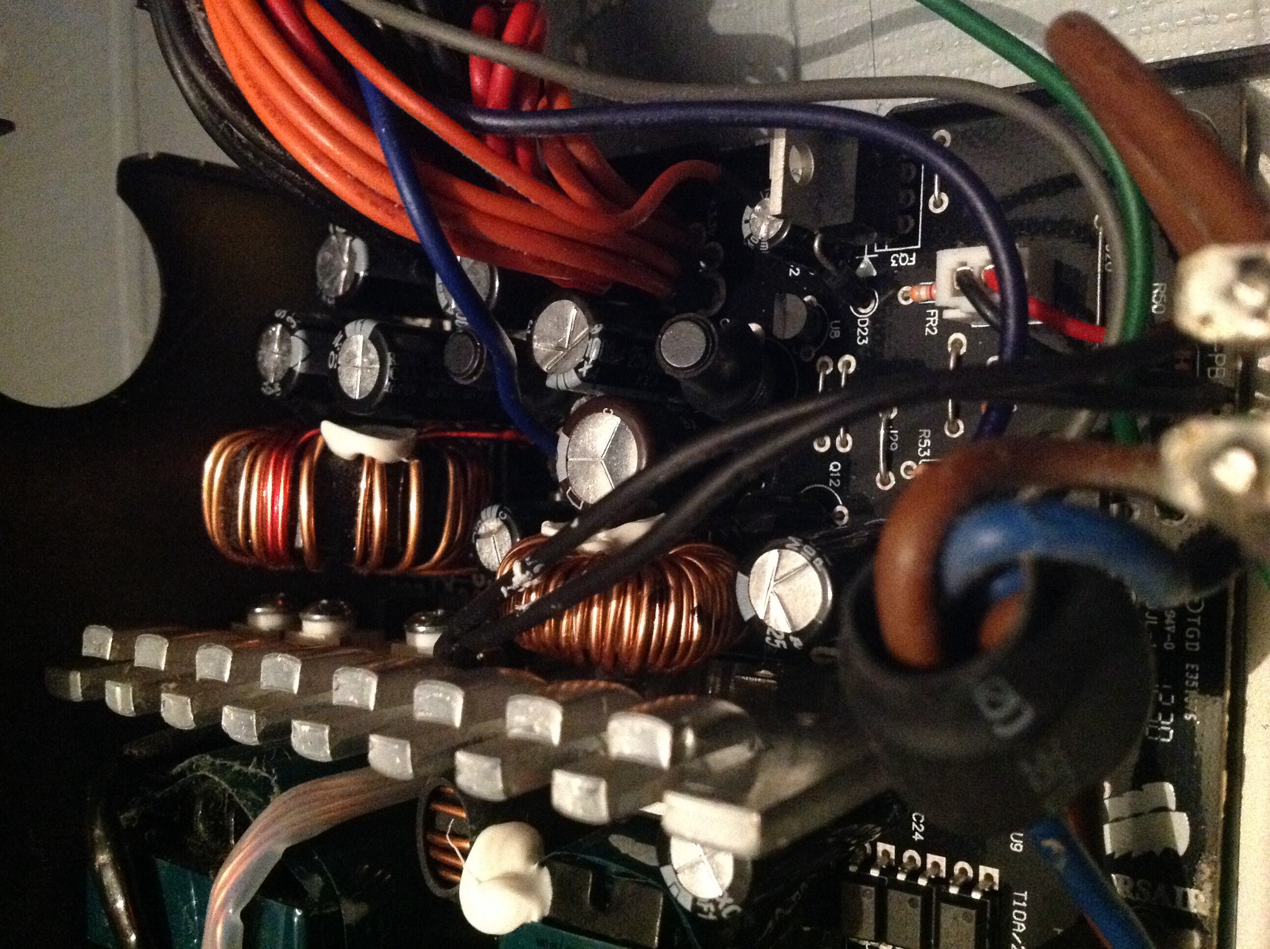

      On this board I'm pretty sure the blame lies entirely with the caps themselves. It's a well known fact that NCC had problems with that series. They were often used interchangeably with equivalents from Rubycon, Panasonic and Nichicon, and only the ones with NCC KZG and KZJ failed.
      But yah, some manufacturers did really stress their caps big time. The Dell SX280 was an example (Prescott CPU in an ultra small form factor case). It was very common to see those with cooked Rubycon and sometimes even Panny caps. About the only way to reliably fix one of those was to poly-mod.

        I recapped my cx430 that was in my htpc it has samxon gfs eww, it gets quite warm as well so I wanted them craps out, primary unit is a panasonic so I left it alone. I used rubycon, chemicon, panaonic, smaxon Rs been runnning great for months now....

          Looks good These definitely need the good caps since the fan doesn't seem to rev up very much even when the load heavily increase. My cousin had one with a Core i3 overclocked to 4.4GHz and an overclocked 4870. I was amazed that the CapXon in there lasted 2 years powering that machine! I gave him a recapped Seasonic, because I didn't want those CapXon taking out his machine. What is yours powering?

            Cheers mon, capxon I normally replace on site they are one of the worst caps ever. And corsair using them is just away to make more money on rma when the caps fails and cause the psu not to start lol

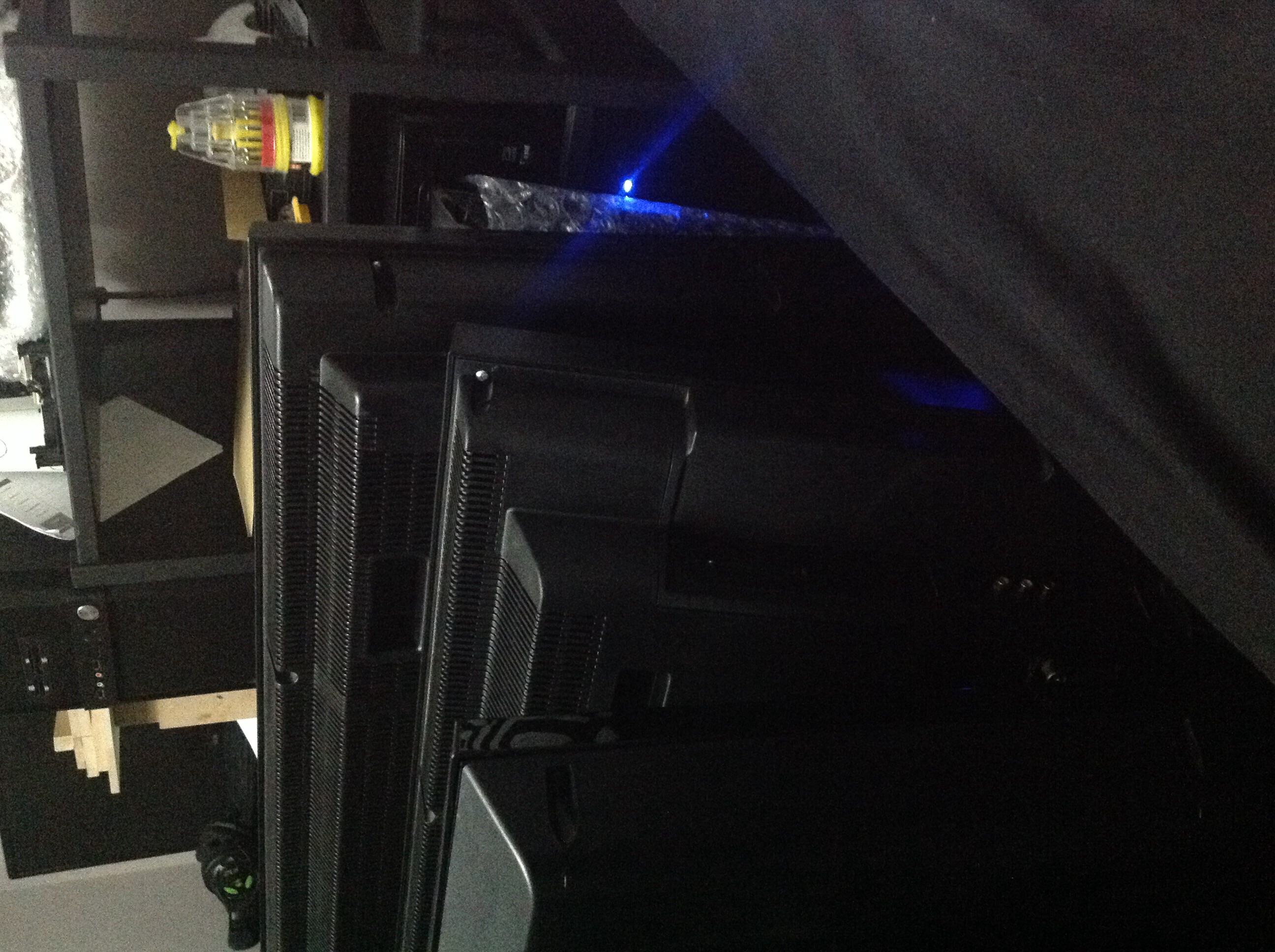

              All mine is powering is a amd sempron 145, 250gb 2.5" hdd, asus m5a78l motherboard with a gt210 gpu on uses around 233w I think is what I read on the meter I know im loosing out on efficiency but ohh well brough this new for the application so mares well use it.

                Is it 33 W? Cause 233 W is very wrong.

                  The cpu is 30w if thats what you mean, I measured it with my load tester the total watts the pc uses is 233w.

                    Than you either have very serious problem, or the PFC is off due to low real load and your meter shows crap. There is no way how this could draw 233 W, that's 186,4 W output with 80 % efficiency. The CPu with graphics take maybe 60 watts, the rest maybe also some 20 W. That's 100 W missing.

                      I will recheck it when I can get to that pc too many tvs in the way atm to get to it, I hope nothings wrong but thats what I recall tbh I dont think there is.
                      The blue light is the power button on the pc I have no way of retesting it untill he room is clean.
