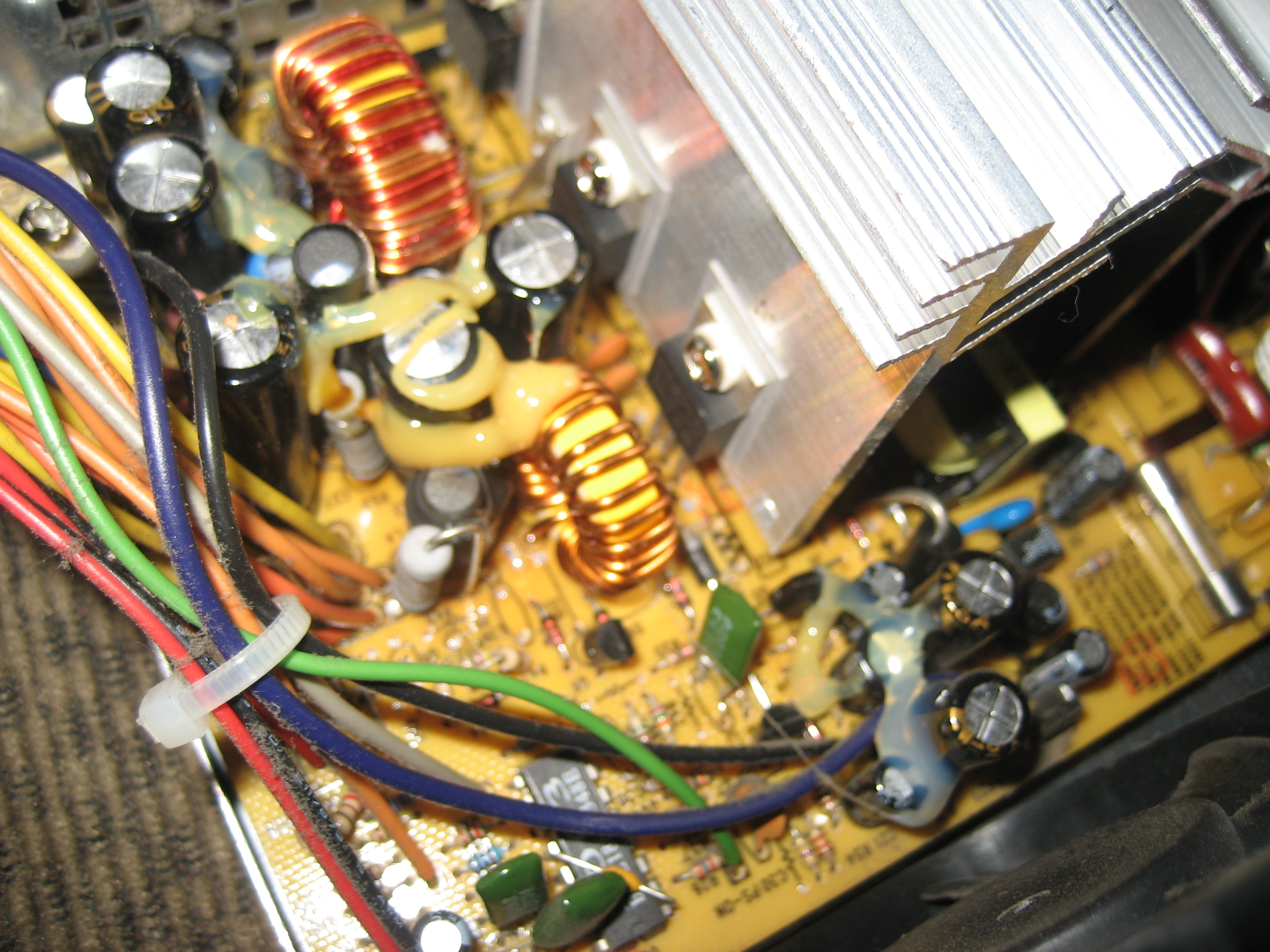

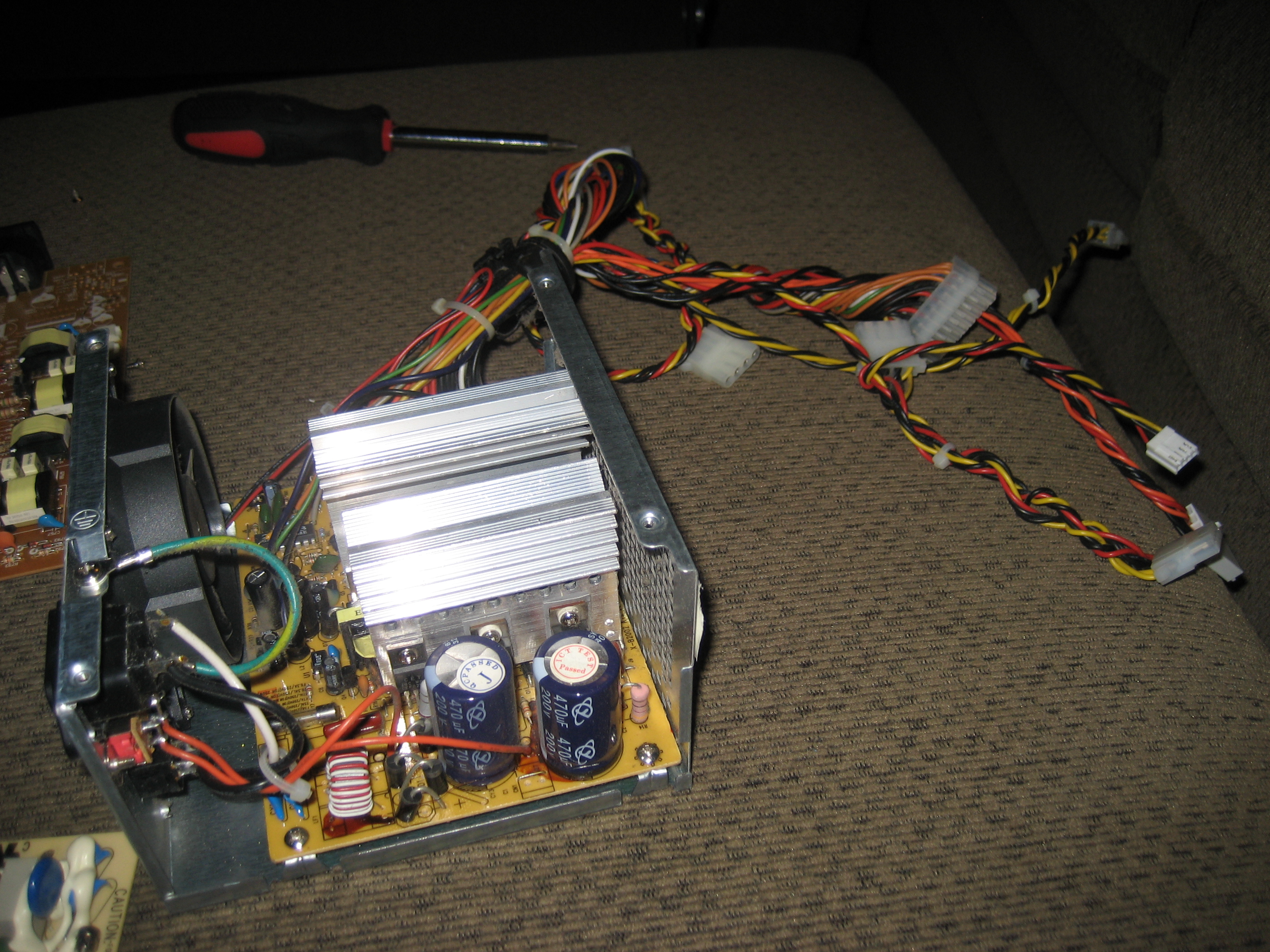

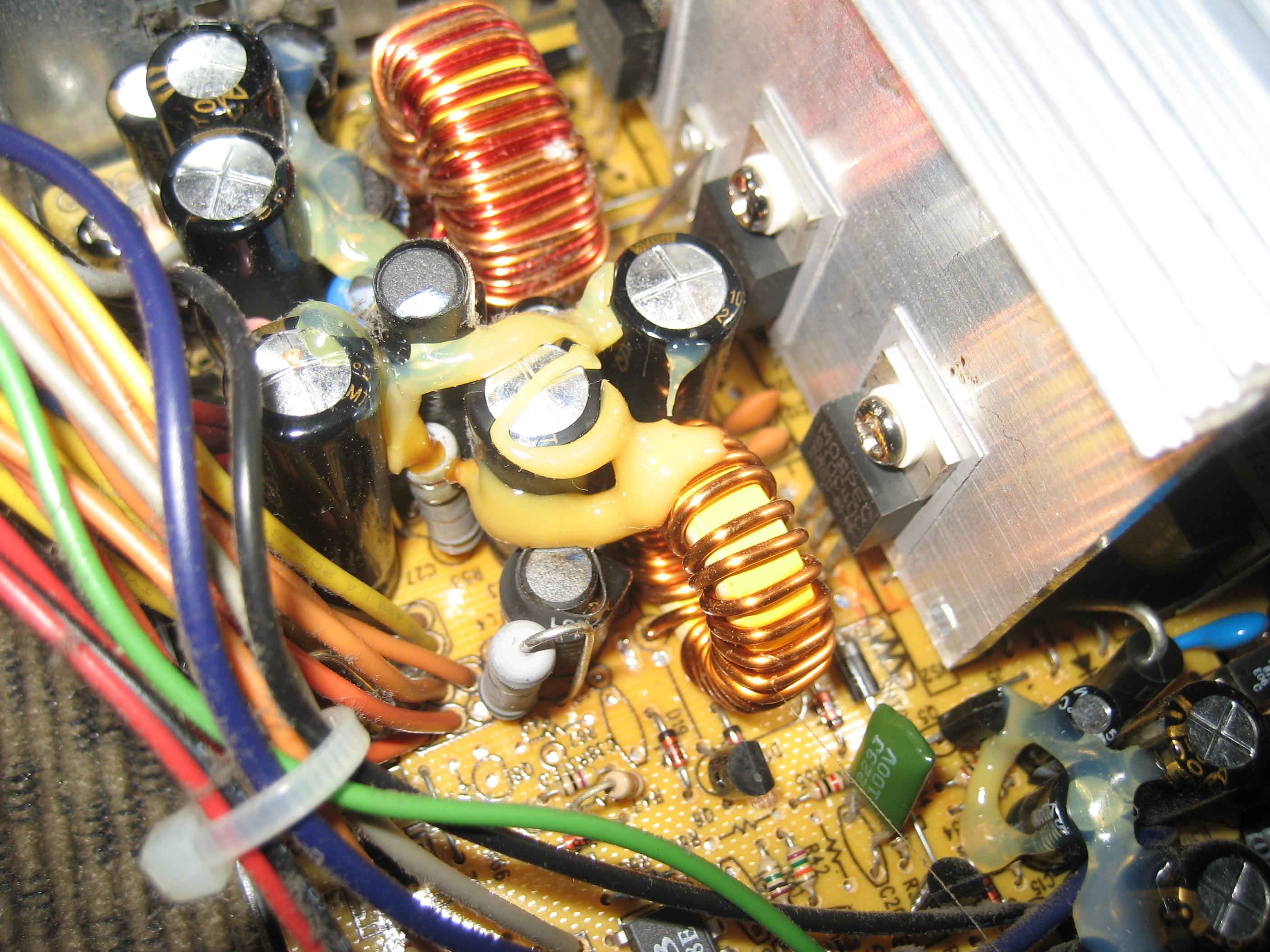

    so I have this cheap PSU with blown caps (huge surprise there), but it actually looks worth saving.
    its an Excellent XPower 300, and 2 of the caps are 2200uf and I cant see the other 2 or 3 blown caps.
    So is it worth replacing the caps, or will it just blow them again?
    thanks for any help!

    Post pictures. As clear as possible.
    Not familiar with the brand name, but if you're lucky it could be an OEM design that's worth keeping around.
    Can't tell that without actually seeing the power supply internals.

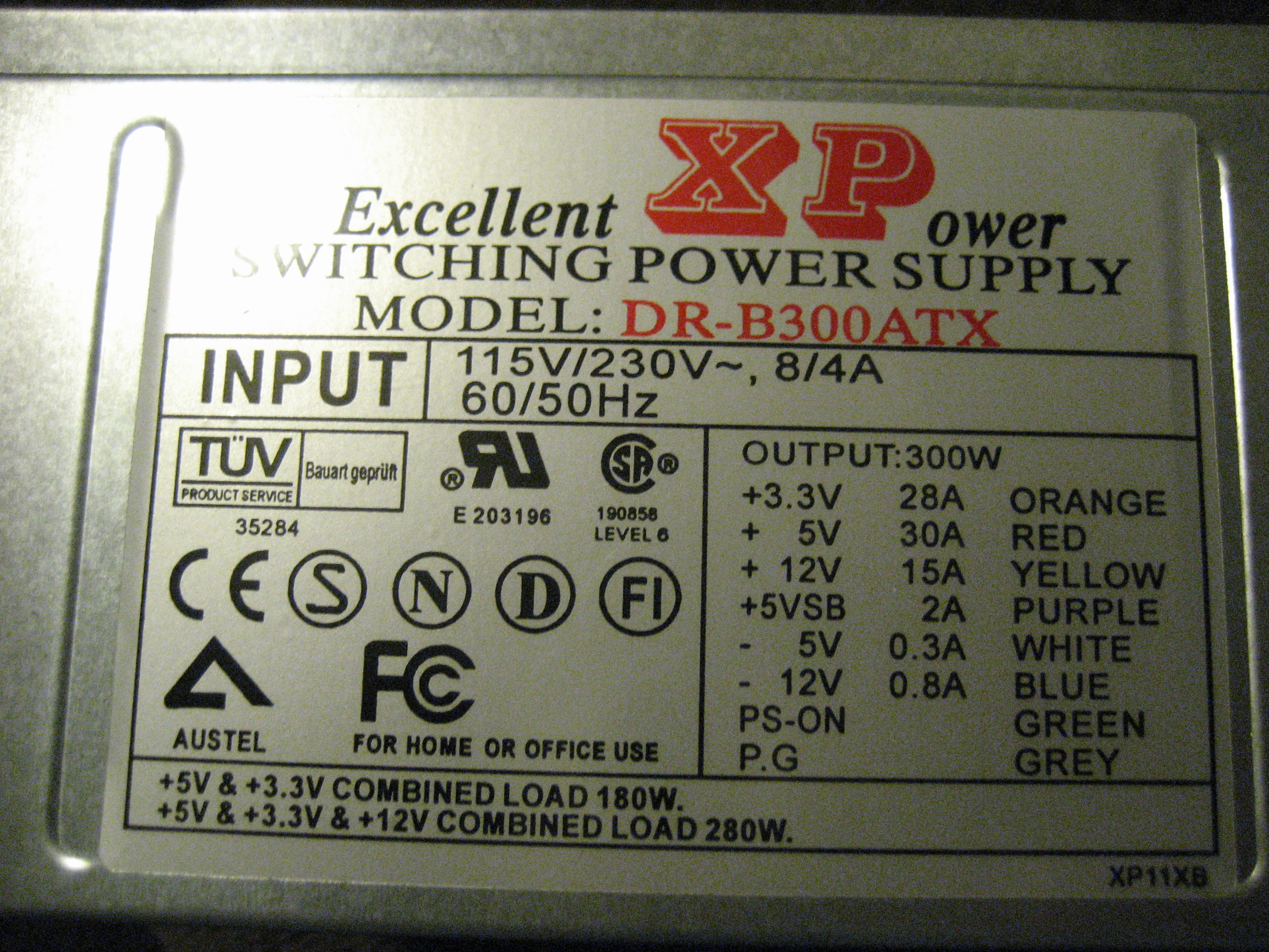

            Well, based on the UL number, it's a Deer: http://database.ul.com/cgi-bin/XYV/t...374&sequence=1
            The page lists it as 12v @ 18A, 5v @ 26A , 3.3v @ 27A so the label of your ps is even more honest. Though I doubt it can make 10A at 12v.
            I guess if you have a system that uses 150-200w max, it would be good... yeah, I'd recap it.
            Those Cy (Saturn I think) capacitors are not the worst Chinese capacitors but the design is bad, they're around resistors that heat up a lot so eventually the capacitors cook.

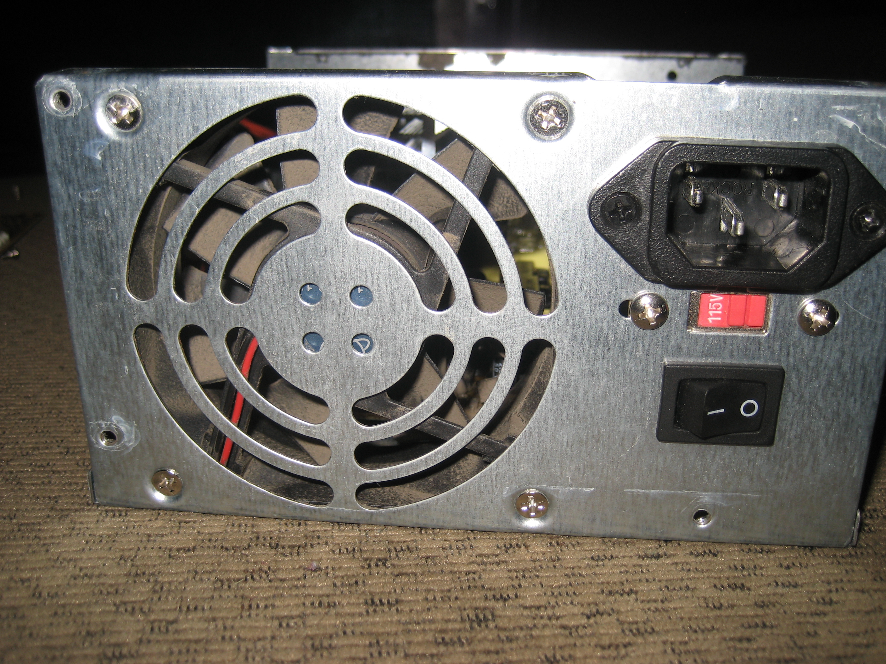

            ps. would probably be worth replacing the fan with a ball bearing based one. the one there is ball bearing, noisy.. and since it's so old you don't know how good it still is.
