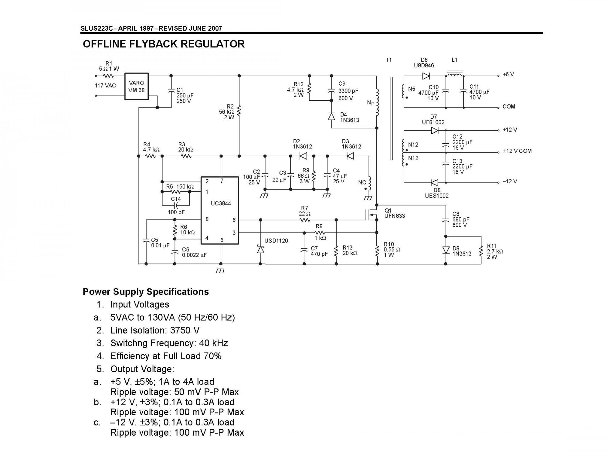

    Another episode in the power supply saga courtesy of yours truly.
    This time, we will be focusing on the UC3842 current-mode controller. We will be making a small, cheap, low parts count, low power flyback supply using a 5vsb transformer from an ATX PSU.
    A current mode controller has two feedback loops. One for voltage, one for current. Along with sensing the output voltage, it directly senses the current in the power switch, enabling better line regulation, and overcurrent/short circuit protection comes free. Done properly, a current-mode SMPS cannot be damaged by a secondary side overload or component failure. Trust me, i tried.
    It also makes compensation easier, but that's something i'll get into a while later, gotta figure it out myself first.
    I will be loosely basing my work on this design:
    The general idea is good, but there are a few things that could use improvement. I've built my version on a perfboard. It looks like a disaster waiting to happen, but it works just fine. It'll drive anything all day long, and gets away without any heatsinks. Outputs 12W or so before going into current limiting, and i made it adjustable up to 15v. Flyback topology is nice in that regard. I'll be posting an updated schematic soon, and i'll also be making a PCB i will share here. Time to put those scrap 5vsb transformers to good use. I see this as an all-round wallwart replacement.

    I don't see any RCD snubber on the primary, that FET won't last long under high load.

      Using a 350V rated input cap isn't a great idea either, as it's not too hard to exceed it. And what about EMI filtering???

        At UK maximum 253V that puts 351V across cap (accounting for diode bridge drops.) 400V caps are cheap and give a much safer margin.

          Also has anyone spotted that the fet is labeled as 450v? That won't work... I used a 650v fet, and scoping the drain reveals that the spike tops at 550v, thus no need for a snubber. But a 450v most certainly won't work. I'll be leaving room for the snubber when i make the PCB.

          I used a 47uF 450v Samxon as that's what i had lying around. As for EMI filtering, i'm working on it. Also note that in the original schematic there is no fuse either...

            You can get away without a snubber if and only if:
            • dV/dt won't kill your switcher or turn your FET on for too long
            • Avalanche energy is kept under device maximum and power dissipation is within limits
            Both are very hard to achieve, especially the second one for outputs more than a couple watts... plus an RCD network is much cheaper than a bigger heatsink.

              The FET won't avalanche unless you exceed its breakdown voltage, which in my case does not happen.

                Yeah, just saying a 450V FET would work for low power. Probably not 12W though. The only way to find out involves letting out magic smoke from expensive transistors, so best to design in a good margin.
