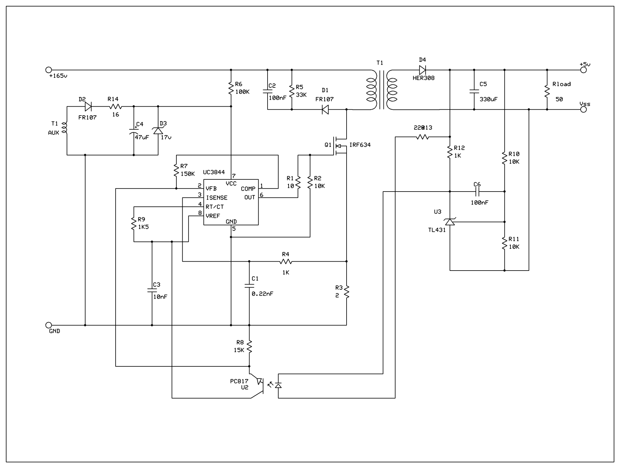

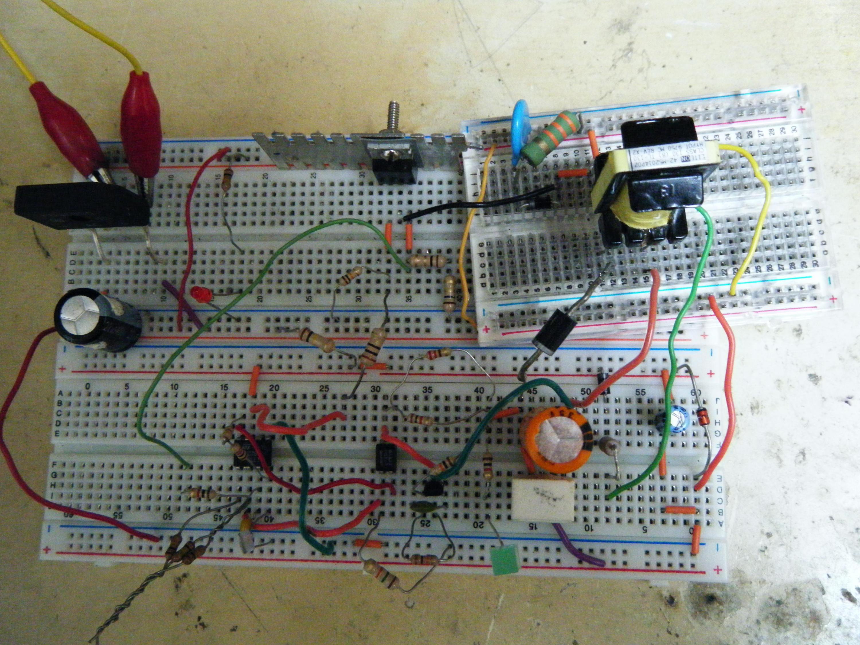

                    Ok I had a go at this again, and I did get it to work!
                    Im using a UC3844, and a 5vsb transformer. (again xD)
                    Its regulating the output to just about 5v like it should, BUT, the transformer whines! Does this mean the feedback loop is unstable??? I have the filter capacitor (an NCC RX(discontinued!), 330uF, 35v, low esr) right after the diode, but before the TL431. Could that be why it is whining?
                    The opto is a PC817.
                    I can post pics tm

                        #51
                        Re: UC3842 basics
                        Originally posted by budm
                        Did you check the frequency it is running at? May be running at the wrong frequency or it has loose core assembly.
                        My fluke 87 says its running at 21khz.
                        Strange, b/c I built the circuit just like the one Th3_uN1Qu3 posted. (used the same cap values for the UC384x)

                          #52
                          Re: UC3842 basics
                          Update. When I put the probe to measure the voltage on the output (it was 4.8v), the pitch of the whine changed! So, there IS a problem with the feedback being unstable. Nothing is getting hot, the only things that are warm are the load resistor and the snubber resistor.

                            #53
                            Re: UC3842 basics
                            ANOTHER update
                            I found another circuit which is MUCH nicer.
                            I modified the psu on my breadboards, and now it is working better. That is, with a light load. A heavy load makes it hiss. So it still has some tweaking to be done. But I tested it with a 1A load, and the supply happily kept up a constant 4.95v output, and 4.99v with only 10mA load (an led).

                              #54
                              Re: UC3842 basics
                              When you build this kind of circuits on bread board like that, you will have to really watch out how you route the ground current return path for each section of the the circuits. You may want to search "how to do PCB LAYOUT for switching power supply" to get more understanding. You need to keep high current path as short as possible for the return current to flow back to the source without modulating other sensitive circuits such as feedback, ref voltage source, etc.

                                      #58
                                      Re: UC3842 basics
                                      Update.
                                      So, I used wires to connect the mosfet and transformer directly to the bridge rectifier. Now there is no hiss or whine, but the output voltage is low
                                      I used some 20 gauge single conductor copper wire, but it didn't do anything better.

                                          #60
                                          Re: UC3842 basics
                                          Check your feedback section. I work with an expert that used to design power supplies for ALCATEL, very lucky to have good him to guide me, still learning every day.
                                          It turns out that I was missing a 470pF capacitor on the Isense pin, so it was triggering the overcurrent protection, causing the whole circuit to turn on and off, making the whine/squeal sound.
                                          With a 1A load, it is dead silent now!
