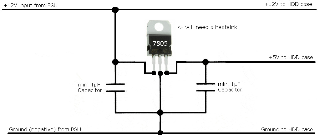

can I downscale a powersupply brick to power my HDD and enclosure?
  • newtoCaps101
    • Jul 2011
    • 93
    Hey Guys, so I was wondering. as you already know my cheap Hard Drive enclosures power brick died recently. Since I actually have a few salvaged adapters and bricks in my house, a couple from old LCD monitors. I was wondering if I could maybe "downscale" or downgrade one of these power bricks to power my HDD enclosure?
    They look quite well made and I still have my enclosures power brick so the plug / socket shouldnt be a issue if I can downscale it and hack them both somehow instead of forking out $30 for a new enclosure?
    here's the specifications of my enclosures power brick
    MODEL: CSE35-G
    INPUT: 100-240VAC, 50/60Hz 0.5A
    OUTPUT 12v === 1.5A
    5V === 1.5A
    new lcd power brick specifications
    INPUT: 100 - 240V -- 1.0A MAX
    50 - 60Hz, 100 - 200VA
    OUTPUT 12V === 4.0a
    OUTPUT POWER: 48W MAX

        Most hard drives don't use a lot of power from 5v, they use that strictly for the electronics. So it's safe to say the average drive uses about 0.3-0.5A of power on 5v.
        The 12v is important, the drives will use up to 1-1.5A of power on 12v.
        Considering the load on the 5v is so small, you can generate the 5v by using a linear voltage regulator powered from the 12v line.
        You can buy such linear regulator for 0.5-2$ pretty much anywhere.
        For example the classic 7805 is on Digikey for as low as 0.66$ in a package easy to work with. It can do at least 1A of output, which should be more than enough for any hard drive.
        http://search.digikey.com/us/en/prod...ETU-ND/1051218
        http://search.digikey.com/us/en/prod...05CT-ND/458698
        Both of the above have 3 pins :
        input - at least about 6.5v or higher to get 5v out, you have 12v which is ok
        ground
        output - 5v
        so you basically wire them like this
        Code:
        + 12v ---- [  +  ] ----- IN
              [ C1  ]
        - GND -----[  -  ] ----- GND --------- [ -  ]----------- - GND
                              [ C2  ]
                      OUT --------- [ +  ]  -------- + 5v
        where C1 and C2 are two capacitors. C1 should be rated for minimum 16v and C2 should be rated for minimum 6.3v.
        The datasheets recommend at least 1uF on both sides, but I usually use 47uF or higher.
        You will just have to be also careful because this chip will get hot so you need to screw it to some heatsink or an aluminum piece of something.
        The difference between 12v and 5v gets converted to heat, so the heat output will be (12v - 5v ) x load ... so if the drive sucks 0.3 A the heat ouput will be 7v x 0.3 = 2.1 watts.
        Without any heatsink connected to it, the chip can probably dissipate about 1-1.5 watts so you definitely need even a small heatsink. Something like this should be enough for the load of a single drive : http://search.digikey.com/scripts/Dk...000G&x=14&y=10

                    Could you post some pics of the HDD case itself with its circuit board?
                    Would probably be easier to just feed 12V to the case and have the 5V regulator inside the HDD case (if it's metal, it could act as a heatsink too)
                    Attached a (very) crude drawing of what mariushm meant. Getting 7805's shouldn't be a problem really. They're jellybean parts. Every electronics store should stock them.
                    edit: since when do .gif's automatically get converted to much smaller (in dimension) and shitty quality jpg's when you attach them? that's retarded..
                    Had to save it as a jpg and re-attach it so it doesn't get resized and unreadable

                        ps... In Scenic's version the negative side of each capacitor is at the bottom. I'm going to add a picture of the circuit myself in a moment just to be extra clear.
                        here you go:

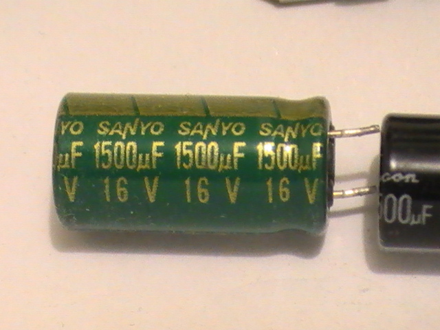

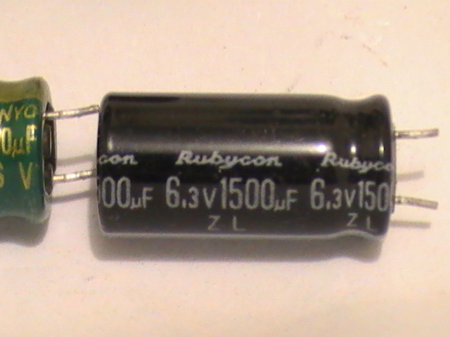

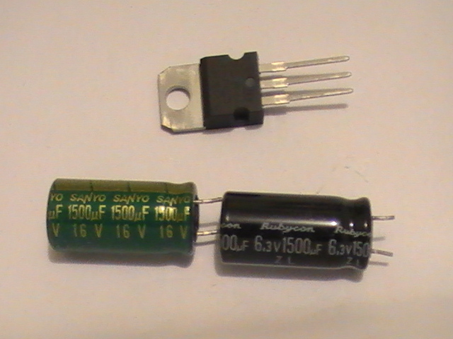

                                  Hey Guys, I couldn't find the LT10765 but I got a 7805CV and ordered it (thats the one right?), should be in the mail in the next couple of days
                                  I also got some 16v and 6v caps at home, I salvaged from some old motherboards, they are 1500 uF however. Well anyway, I will be back in a couple of days when I get the chip and hopefully we can make the power supply work with my enclosure.
                                  Will also post some pictures of both adapters and the enclosure soon.
                                  • mariushm
                                    • May 2011
                                    • 3799
                                    Re: can I downscale a powersupply brick to power my HDD and enclosure?
                                    Those 1500uF will work.
                                    In some extreme cases, with some very sensible hard drives, you may have to plug in the power supply and leave it to charge the capacitors first for about half a second before you plug the connector in the hard drive.
                                    7805cv is OK. This one is linear regulator, for which you only need those 2 capacitors.
                                    For LT1076-5 you would have needed at least a Shottky diode and an inductor which are a bit harder to find locally. The advantage would be that this chip doesn't get so hot as the 7805 ones.

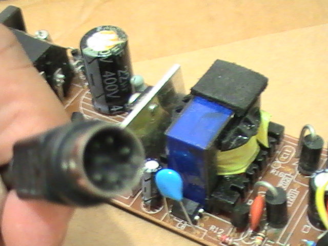

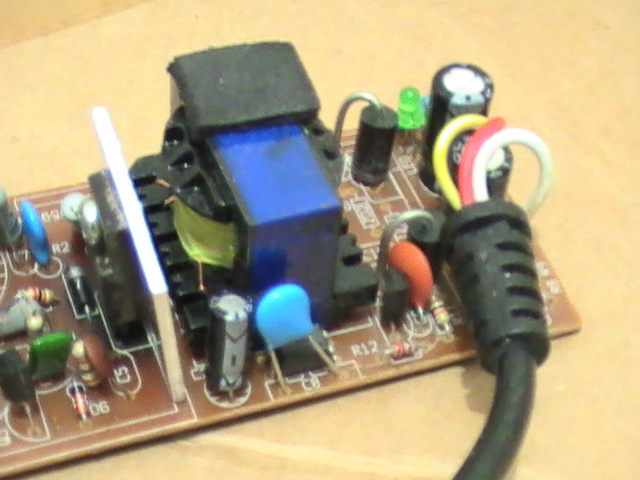

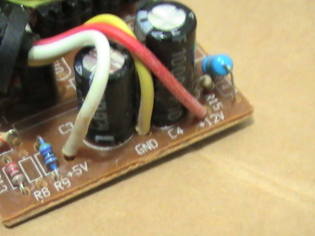

                                      Okay Guys, I got the parts
                                      I will post pictures of the adapters in the next post..

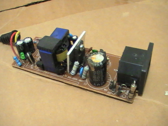

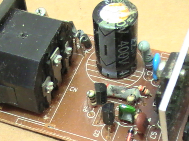

                                      • newtoCaps101
                                        • Jul 2011
                                        • 93
                                        Pictures of my old (original power supply brick of the enclosure) I have noticed a 16V and a 10V cap and some resistors on the PCB that creates the 5V line.
