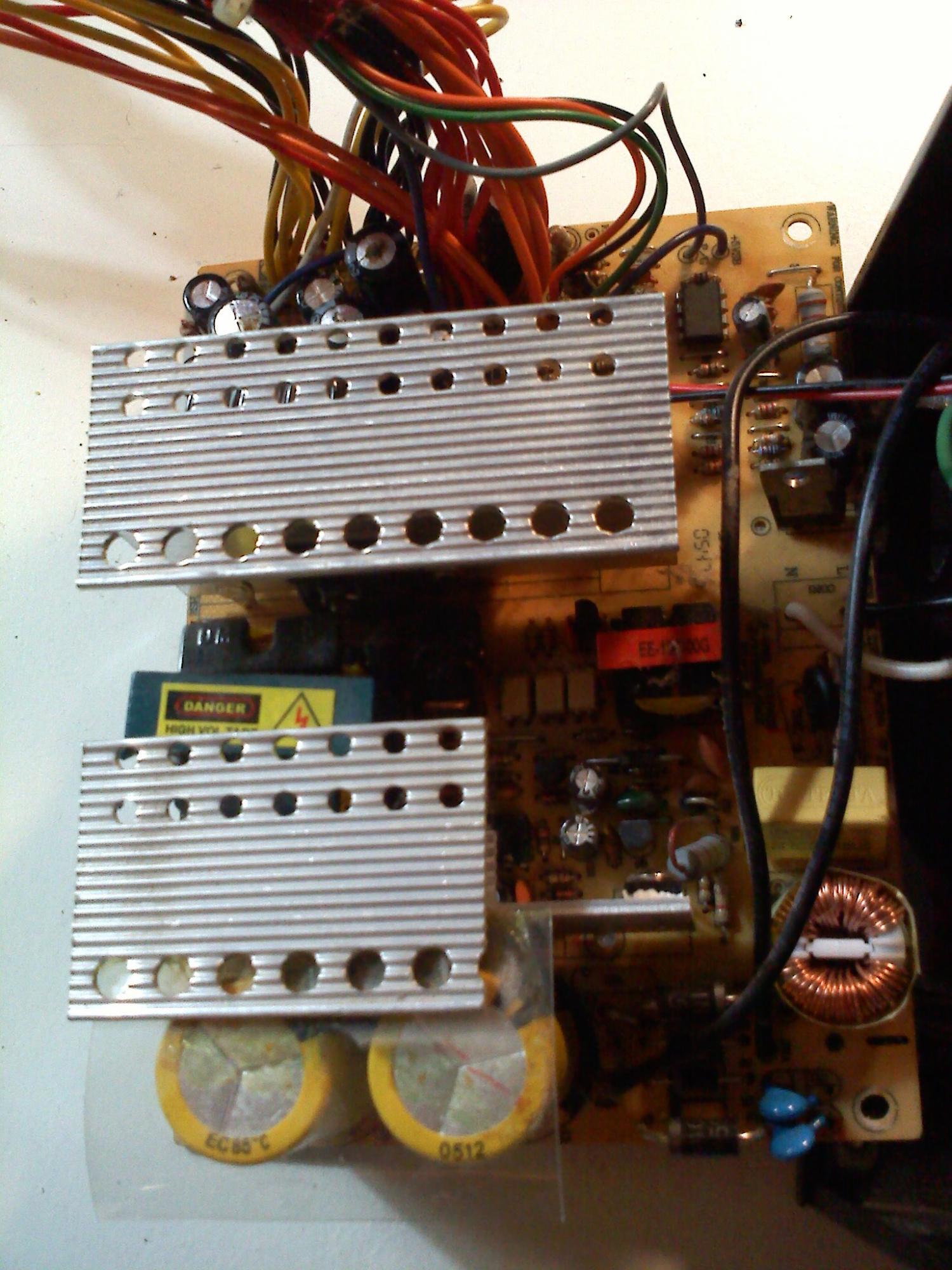

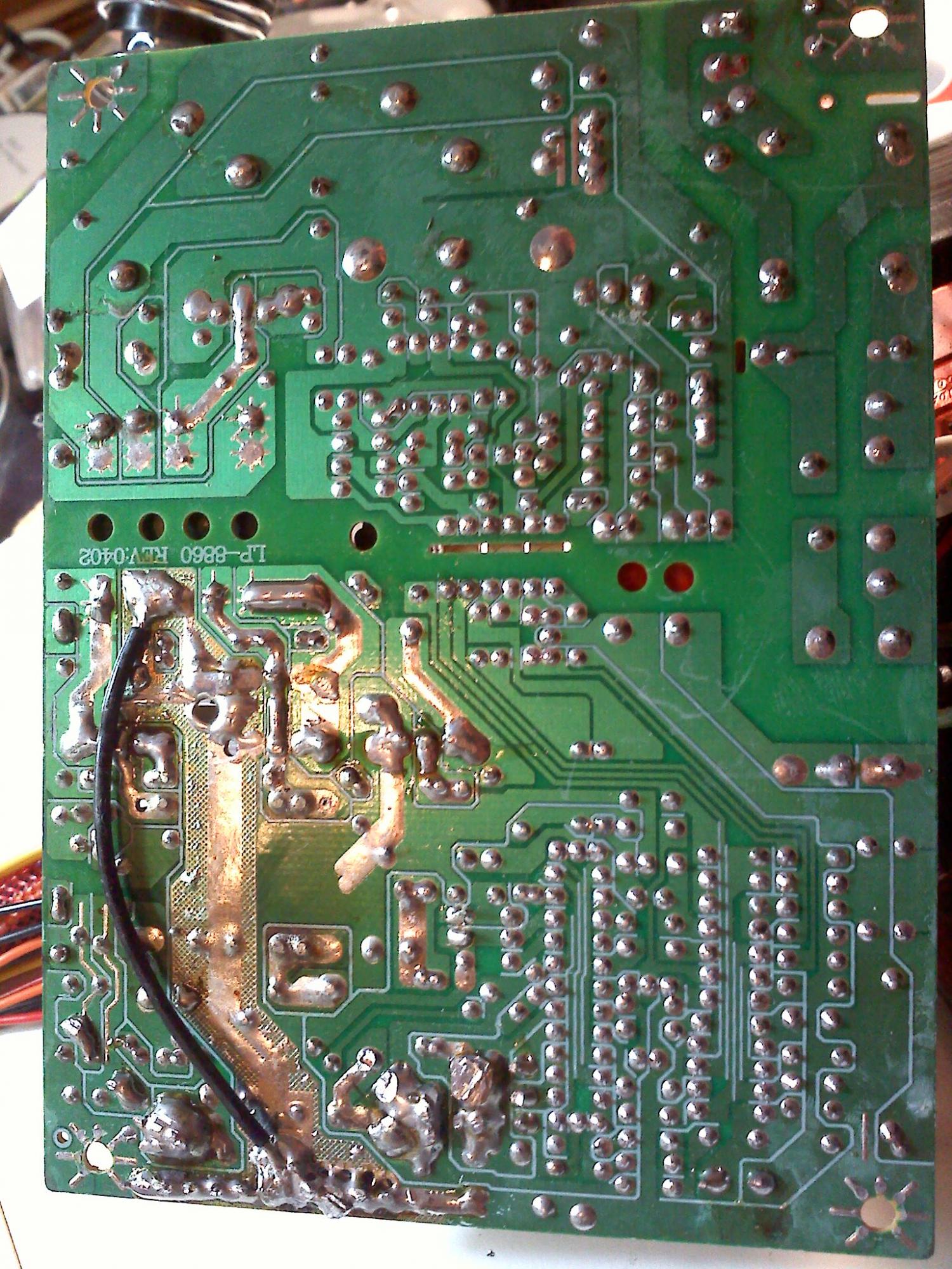

    I just pulled a smoking Dark Knight Titanium (550W) power supply. It has 5 very bad caps which I think I could replace. However, looking at it closely, one of the circular copper-covered coils is heavily burnt at the point where it is soldered to the pcb. After pulling the pcb off the damage is local to the coil where the copper goes to the pcb, that area is definitely burnt but looks mostly superficial. Looking at the soldering quality from the underside is really scary. It looks like whoever did it had a giant squirt-gun of solder and just laid it on there. And then there's a jumper wire that got thrown on there for some reason. Any advice? Maybe I should just dump it? It got replaced with an Antec 430 which is barely better.

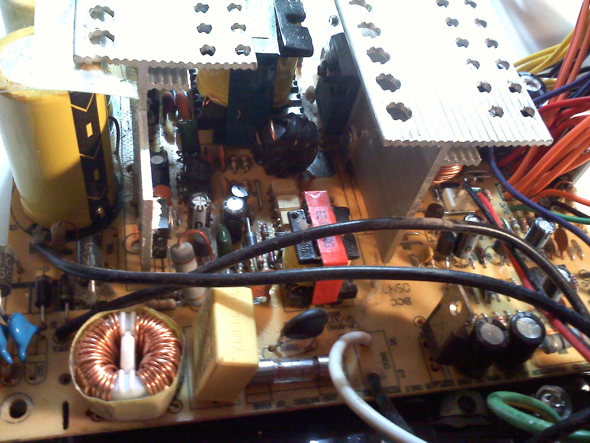

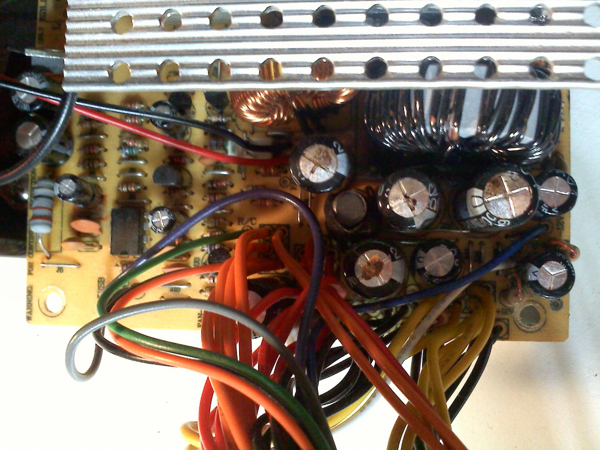

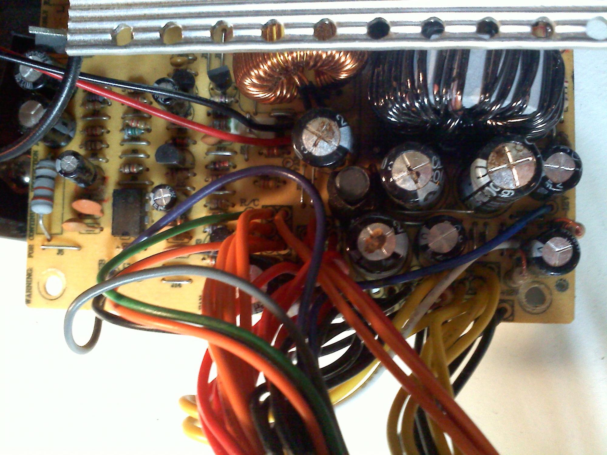

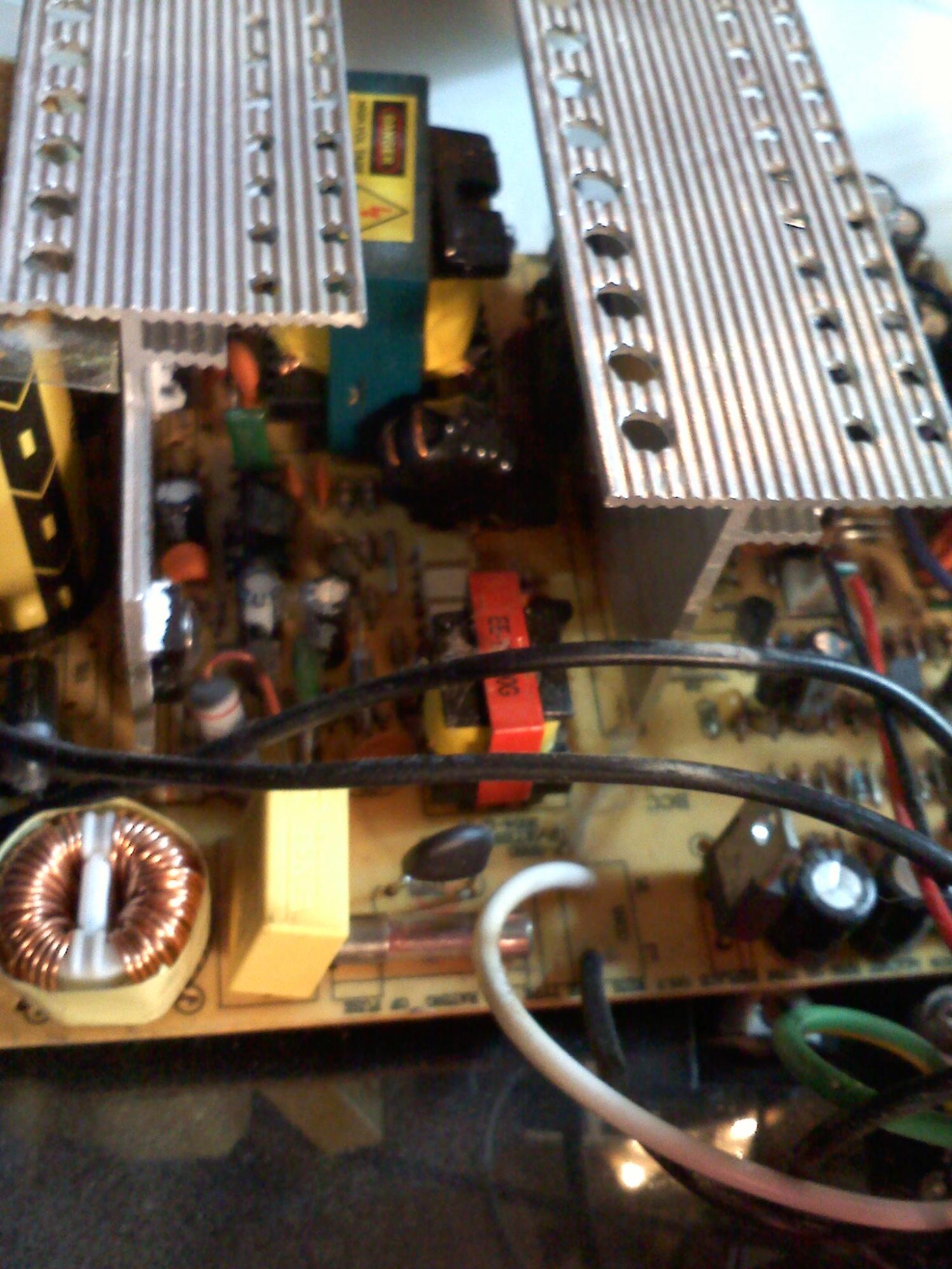

            Ya know, I got other pc power guts strewn all over, plus I'm working on a Dell USFF machine. This is just what I need to fiddle with. Does anyone make a decent kit for replacing the guts of one of these things? Here's some shots; on the pic with the obvious bad caps, there is a coil colored black. The problem area isn't very visible but its just at the base of the part. Anyhoo, you're right, I can salvage the 'sinks and the fans, the other stuff looks no good so I need something to stuff into there....BTW, check out the top notch soldering, I think my 7 year old kid could do a better job. Sorry about the mediocre pix, they came off my 'droid. If y'all want more pix, sing out before I hose this stinker away.

                  Powmax... Maximum Pow. First time i see a burnt filtering toroid in the secondary. Canicon capacitors, small board, garbage soldering... lovely. Keep the fan, heatsinks, transformers and primary capacitors. Throw away everything else.

                    That would be the second time I have seen a cooked filter on a secondary and those yellow caps on the primary look like Fuckyoos to me... those are the only primary caps I have ever seen to vent and blow.
                    Definately junk.
