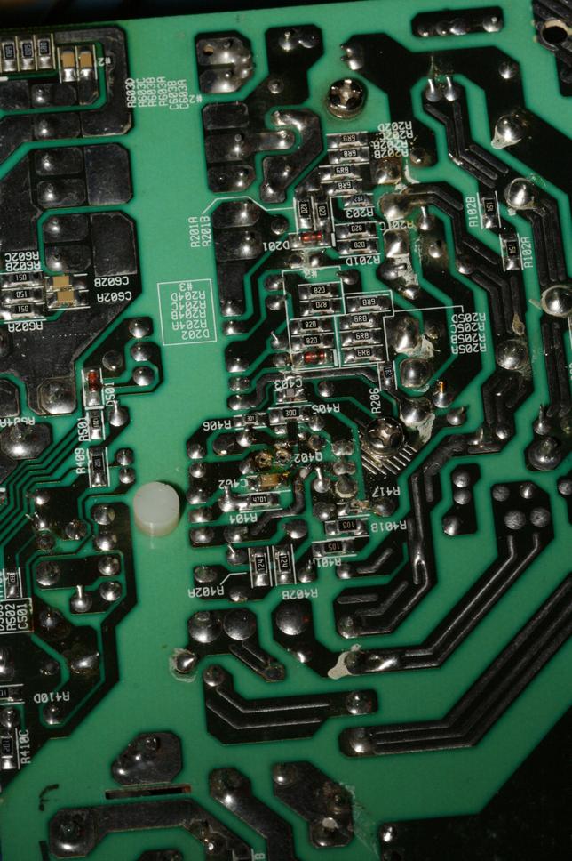

        Indeed, I've found the second transistor. It was a SMD one on the other part of PCB covered in some white stuff. Both transistors are OK, but a 4.7uF/50V Teapo was blown up, electrolyte leaked, etc.
        I will go tomorrow to find a replacemnt cap (did not found another one rated more than 35V on my junk) and a replacement Zener diode. I found 5.6V, 6.2 and 6.V rated 1.3watts. Should I get 5.6 or 6.2?

          Looking at your picture more closely now. I see the burned diode has a designation of D583. Is that correct? Zeners are -usually- marked ZD### or Z###.
          Look around the board and see if there are any marked that way. If so, then I expect this to be a switching diode, not a Zener.
          Can we get a larger overall shot of this area? Where is the 5vsb transformer?
          The 2 transistor circuit is usually (as mentioned by others) one mounted to the heatsink [mains HOT] and the other is a TO-92 type, 3-legged package, mounted nearby. Perhaps they used an SMD, but without a better overall shot, it's tough to tell.

              All diodes, including Zener ones are marked with just D. Found another ones marked only as D.
              The switching diode is before this, a big one in a black capsule which I found to be just fine afteher removing one leg and measuring it.

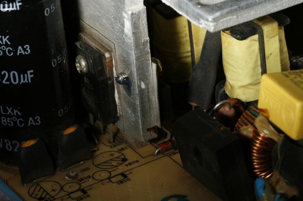

              Yes, the 2 transistor circuit is complete, one big transistor in a TO220 capsule on a heatsink marked SSP 2N60P and one SMD one marked K1P which seems to be MMBT2222A SMD transistor shorted base to emitter.
              The emitter of the MMBT22222 SMD transistor is tied to the stand-by transformer.
              The picture of the are is quite hard to understand, there is a mix of through the board and SMD components, but in the first post there is a schematics of what's afther the transformer.

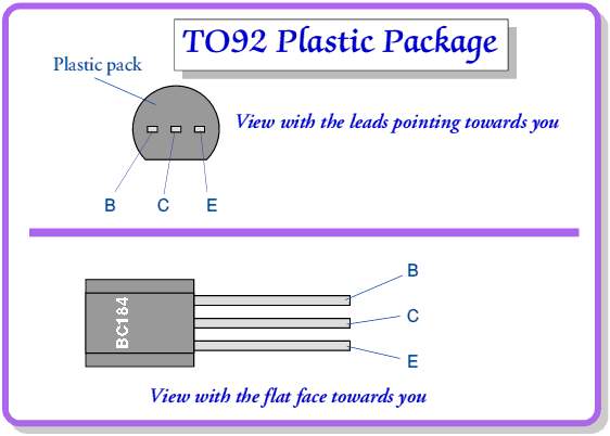

                    Yes, indeed it is a very common transistor, I can find it in TO92 capsule, but not in SOT23 ...

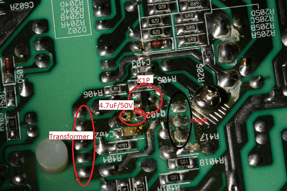

                      Here are the pics of the PS board: first one, the TO220 transistor is on the other side of the heatsink, and in the vacant place was the 4.7uF blown cap.
                      On the other pics are the SMD components on the other side of the board.

                          That's the best i can do, really. The big transistor is behind the heatsink which is also above it, the big rectifier bridge in front ... so on.

                              The smt transistor may not be shorted. There is usually a 39 ohm resistor between the base of the smt transistor and the emitter of the big TO-220 transistor. From emitter of the big TO-220 transistor is usually a 2 ohm or less resistor to common. The emitter of the smt transistor goes to common. So between base and emitter of the smt transistor you should measure about 40 ohms each direction which can be confused with a short. The only way to check that smt transistor is to remove it, and then test it outside the circuit.
                              But...............if you go to the trouble of removing the smt transistor, you might as well replace it with a new transistor. I would leave that transistor alone and replace just the capacitor which is definitely bad. Then test the circuit. If the capacitor doesn't fix it, then go for the smt transistor. If it is shorted, the low ohms resistor between the emitter of the TO-220 big transistor and common is probably open. And maybe some other parts bad!

                                  I've measured 31ohms base to emmiter on the SMT transistor. Between the base of the small transistor and the base of the big one there is a 30ohm SMT resistor.
                                  From these measurements can we conclude that the transistor is fine?

                                    Yes. A shorted transistor measures zero ohms. Replace the capacitor and fire it up!

                                      Replaced that Teapo 4.7uF/50V cap with a Jamicon 4.7uF/63V same can size. Also replaced the unknown diode with a 5v6 1.3watt Zener on secondary.
                                      Afther rewiring everything, it went on without any problems.
                                      Filtering caps for 3v3 and 5v are Teapo and 12V is G-Luxon, but they are all just fine, with ESR around 0.02-0.03 ohms, so I did not replace them.
                                      Thank you all for the sucessful repair!
