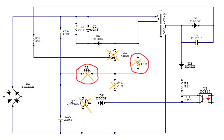

    FSP 350W PSU, +5VSB primary blown, resistor values?
    I have a FSP 350W power supply from an Ahanix case. The primary stage on the +5VSB blew up, although it didn't blow the fuse.
    Some parts got burned and crispy, more specifically, 2 1/8W resistors that are too burned to tell what their values were supposed to be.
    I've attached a schematic of what the 5VSB primary circuits looks like (at least, to the best of my tracing and schematic drawing ability).
    The orange X's indicates parts that were burned. Both transistors were shorted. R16 2.9ohm is a big resistor that went open circuit. The resistors I circled in red are the ones I can't ID.
    R60 - tests open circuit. Not completely burned, but cooked to a nice golden brown. Bands are red-yellow-(purple or brown)-gold, so either 240ohm or 240M ohm. The third band is too darkened to tell for sure. I feel like it would see too much current when MOSFET is off to be 240ohms, so does it make sense to have a 240Mohm resistor there? It would make sense that it measures open-circuit because it's too high for my DMM.
    "R1" - not really R1, but it didn't have a label on the PCB. Brown-blue-???-orange-gold. The ??? is a black, burned section. If no extra band, it could be 16k, but the burned section looks large enough it could have had an extra band there.
    Any idea what those resistors should be? Also any guesses on what could have cooked those parts? All caps look fine.

        Re: FSP 350W PSU, +5VSB primary blown, resistor values?
        Thanks, I wish I knew about the DM311 mod awhile ago because I would have rather gone that route. Unfortunately, I had already replaced the transistors awhile back and only need to replace the resistors. I think replacing the 3W 3.9ohm to the source of the FET is all it will take to energize the +5VSB circuit. I don't think the 1/8W resistors look particularly critical so I may give it a shot. If I've missed something and my parts go up in smoke or the +5VSB is off spec, I'll definitely do the DM311 mod.
          All parts replaced, but I noticed +5VSB voltage swings from 4.65V to 5.25V for a few seconds back & forth before stabilizing at 5.15V. For some reason, the PSU would not power on by shorting the power on wire to ground. Nothing at all happened, even with a HDD plugged in. Not sure if there are bigger problems or if it needs a mobo load. After a few minutes, I noticed that something smelled hot (not burned). I shut the PSU down and waited a minute for caps to discharge, then touched the 5VSB MOSFET heatsink, it was crazy burning hot!
          It seems like regulation looked okay, I'm not sure if the 5VSB was being loaded down or if the MOSFET isn't turning completely off or on. I may need to drag out the o-scope and scope the gate. Any ideas?
