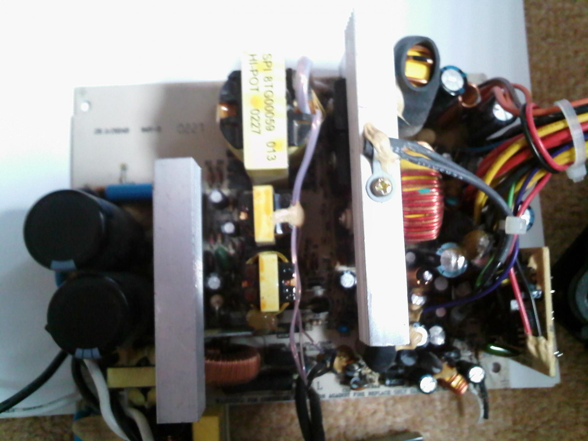

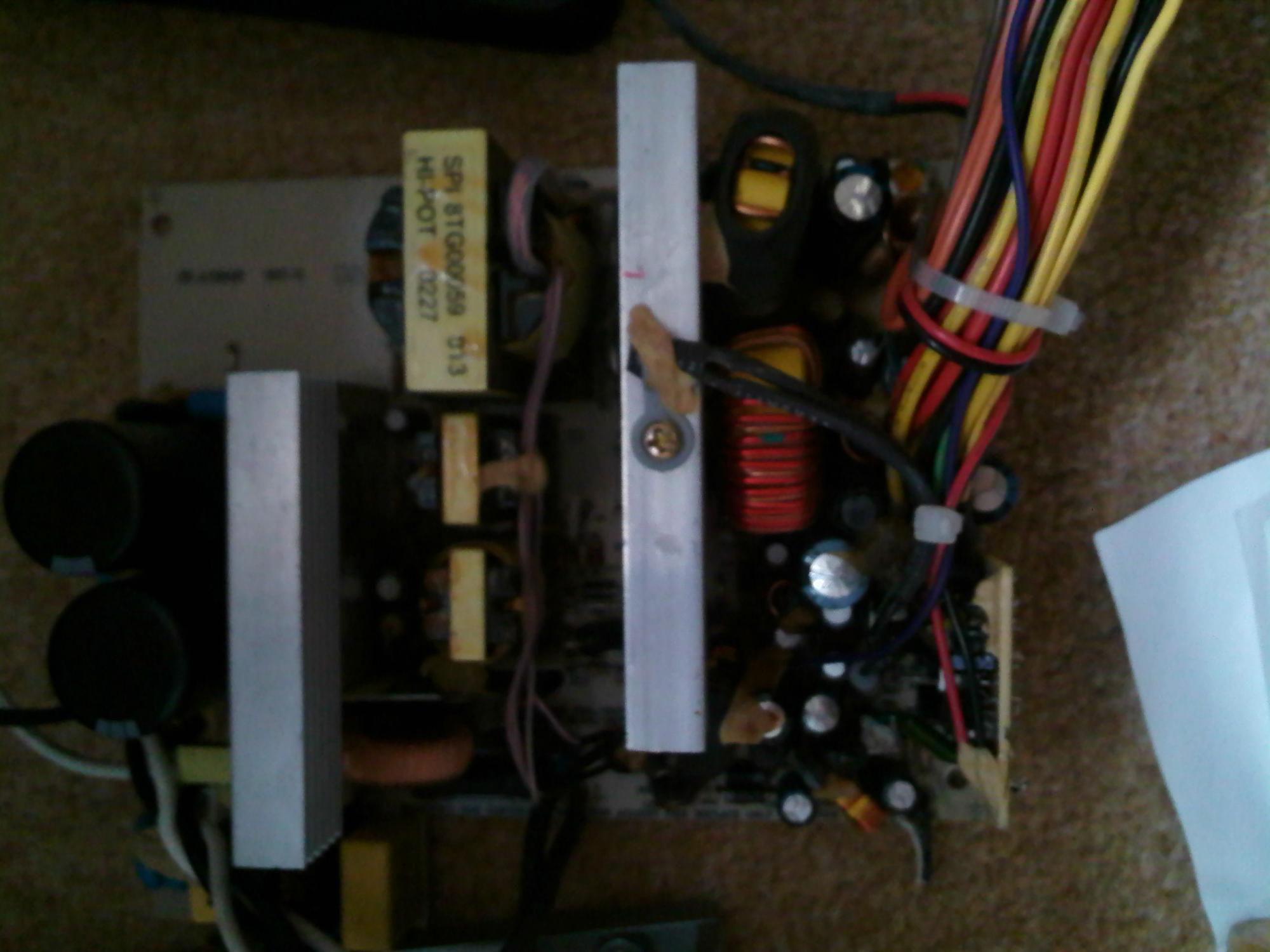

    An FSP250-60PNA Power Supply with Bad Caps. I will probably re-cap this power supply as soon as i order the replacements. This will be my first Re-Cap so go easy on me.

    List the caps.
    - Make / Series / uF / Volts / Diameter / Approximate Length
    From that we can find the Ripple and ESR specs.
    While you are at it make a map of the PCB and mark where all the caps are including their polarity. [Cap Map]
    It will come in handy later when you forget what came from where or which side of some cap was negative.
    On PSU's it's easier if you draw it life-size.
    Lacking a tiny inspection mirror. [Which are near impossible to find small enough.]
    ... For those buggers you can't read the back of take a butter, steak, or exacto knife and polish the 2" of blade nearest the tip up all nice and pretty with some gritty toothpaste. Then use it for a mirror.

      My Capacitor knowledge is limited, but i will try my best. I am not sure how to measure the Capacitors though.
      Replacement List:
      Jamicon 3300uf 16v
      teapo 2200uf 16v
      jamicon 330uf 16v
      fuhjyyu 1000uf 16 (its a weird size though, slightly thin but taller, but i will just get a standard replacement and mount it on its side.)
      Its only 250watt, but its got an acceptable 12v rail amp, so im putting it in a pentium 4 build. Everything else in the power supply looks ok. None of the Capacitors state "Low ESR" so i guess putting a Power Supply rated Cap will be ok.
      My soldering skills are acceptable.
      I wont be able to get the Caps till next week though.

          Ok.
          Jamicon TK 3300uf 10v 30mm x 10mm
          Fuhjyyu TNR 1000uf 16v 24mm x 8mm
          Jamicon TK 330uf 16v 7mm x 7mm
          TEAPO (the capacitor looks like it burnt so i cant read the series) 2200uf 16v 30mm x 10mm

                Looks like a bulged light blue one with glue in one of the photos.
