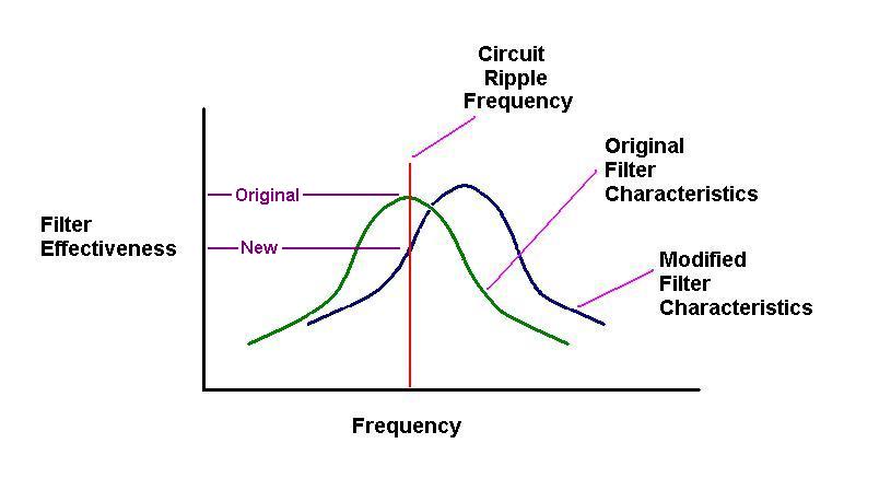

      Sounds to me like you ignored the ESR specs of the original caps and slapped FM's in there.
      Your ripple is high because your filters are no longer optimized for the frequency of the ripple.

          I wouldn't call shooting ripple up to 170 mV an improvement of performance or anything else.
          You repeated the same mistake Oklahoma Wolf did on the jonnyguru site a few years ago.
          FR/FM and KZE are significantly different grades.
          Unless you reduced the can size going from KZE to FR they aren't that close in specs.
          Considering the FM and FR tend to be large for their uF [and KZE isn't] that is very unlikely.
          The OP caps in PSUs are part of filters that also include inductors.
          The values of the caps work with the values of the inductors to optimize the filter to remove Ripple for some frequency which is the expected Ripple frequency of that PSU design.
          Your Ripple not only went up, it went completely out of spec, which means you shifted the filters operating curve and it's no longer as effective as it was at the Ripple frequency of concern in that PSU.
