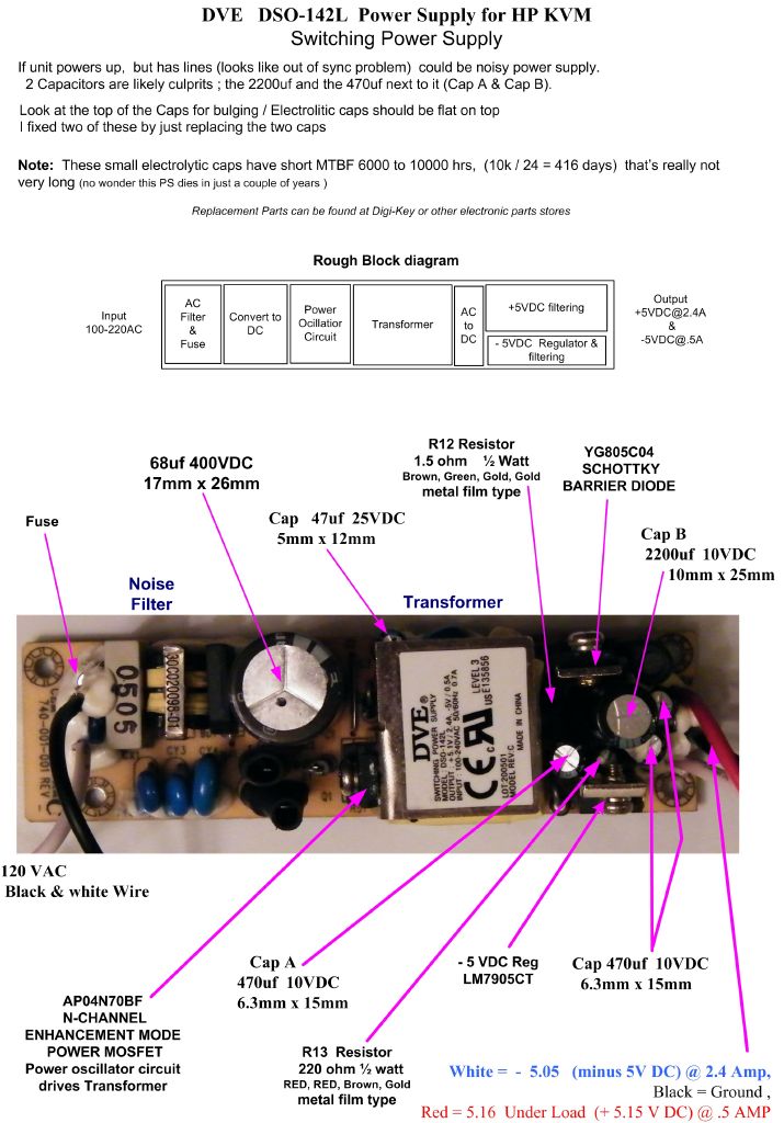

          Re: HP KVM 336045-B21 (avocent)
          I have repaired several of these PSU's and I found the 47uf 25v when tested with an ESR meter had no reading. After replacing this capacitor in the primary side as well as all the capacitors in the secondary side (three 470uf 10v and one 2200uf 10v) the PSU worked perfectly again.
          Hope this helps.
            Hope this helps.
            Thanks. Replacing all five capacitors worked for me as well. It did not work when I had only replaced the two caps mentioned earlier in this thread. But the picture in that post helped tremendously.
              Apologize the picture was from another forum. Attaching it here.
                I am having a hard time sourcing the Caps listed in the previously attached schematic. Could anyone provide some help?

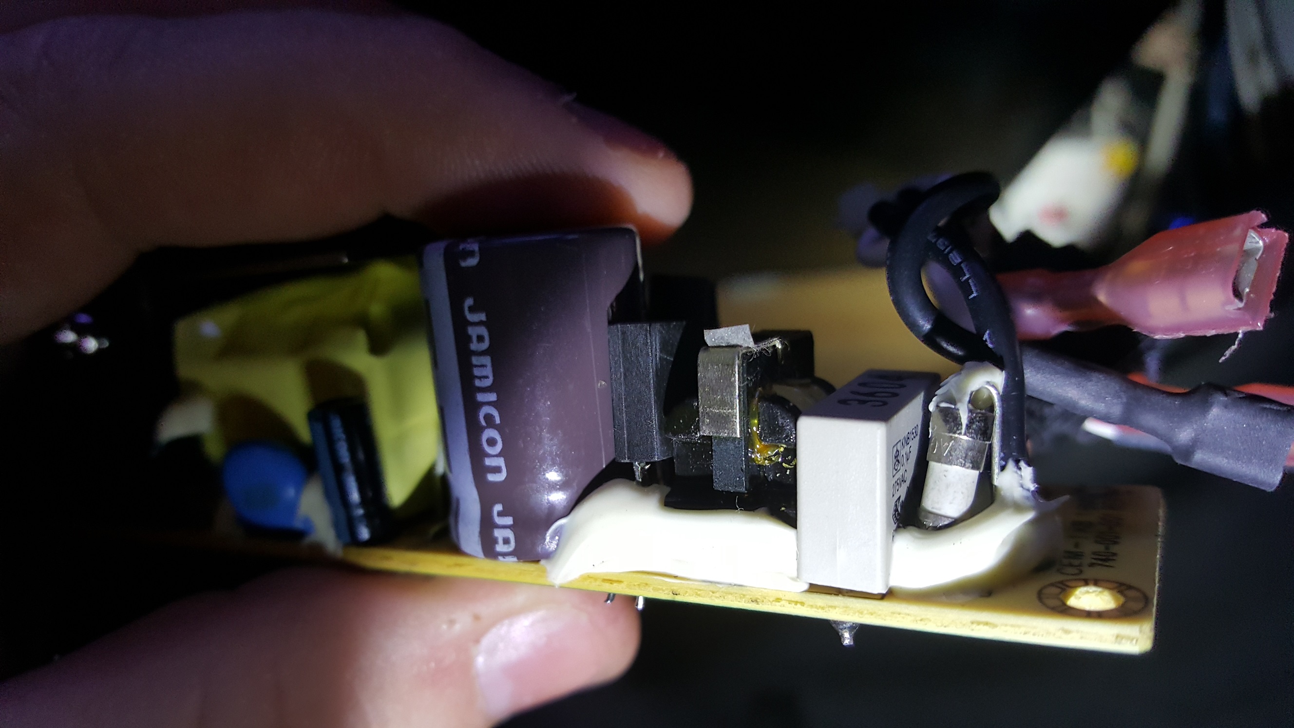

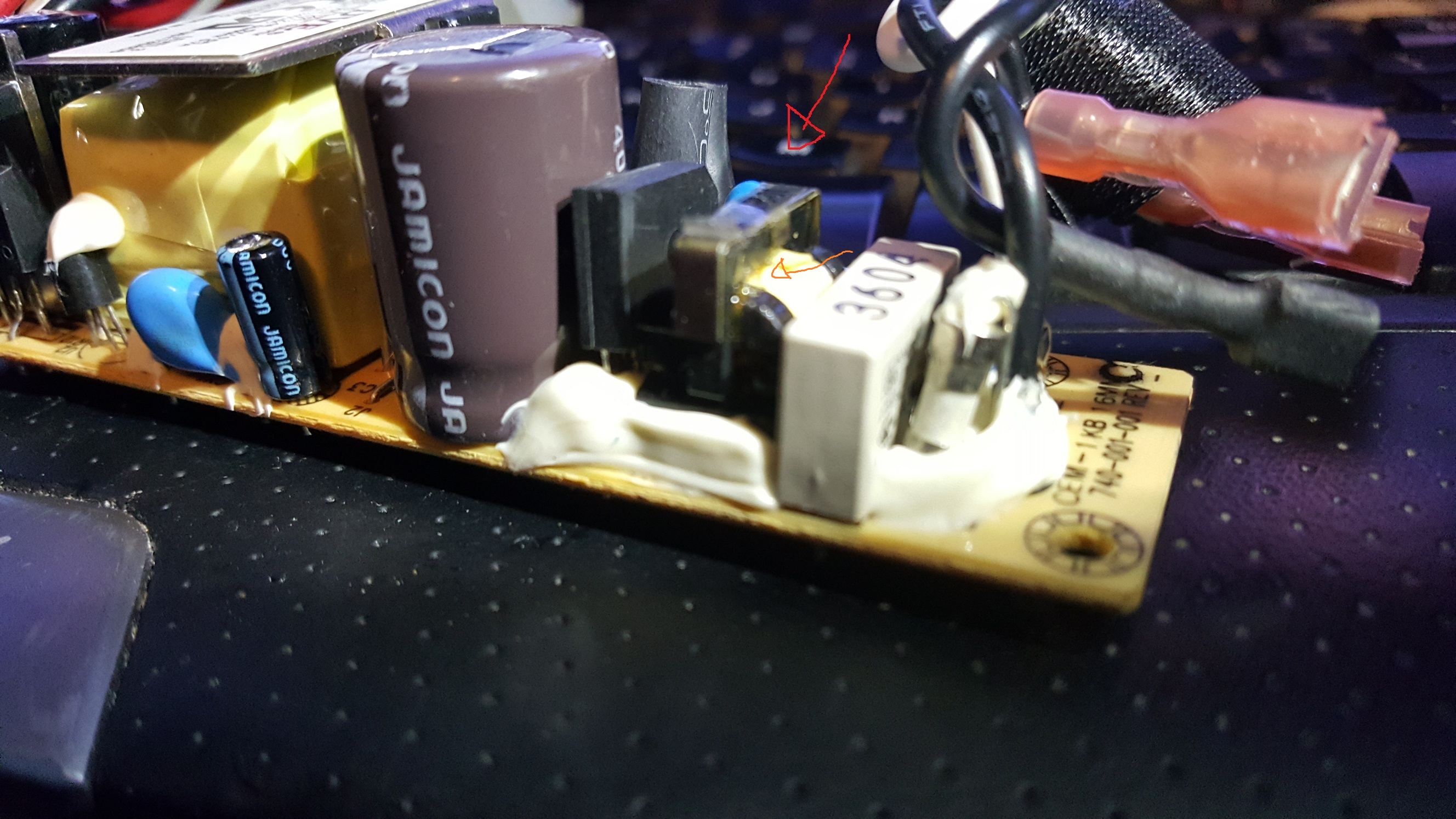

                  I'm also working on replacing the caps on one of these power supplies. It was in a HP EO1013 KVM. My main question is, does anyone know what part (or compatible part) is the 30c02098-01 part? I believe it is a "noise filter"? Mine appears to be leaking. The giant cap seems to be okay. I see at least one of the smaller ones bulging. Picture attached of the part in question.
                  Thanks!

                    • 31163
                    the white stuff is glue.
                    • Minionz
                      • May 2016
                      • 2
                      The stuff that is leaking is amber color to the right of the arrow.
                      Edit-
                      Added another picture
