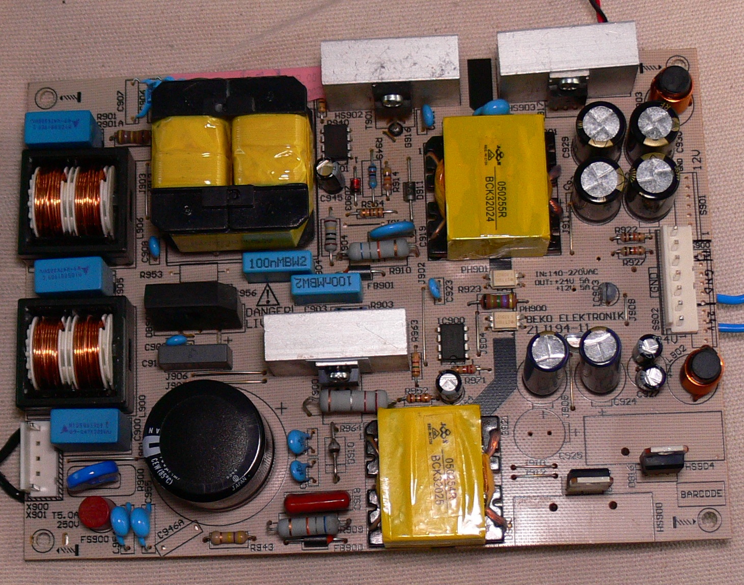

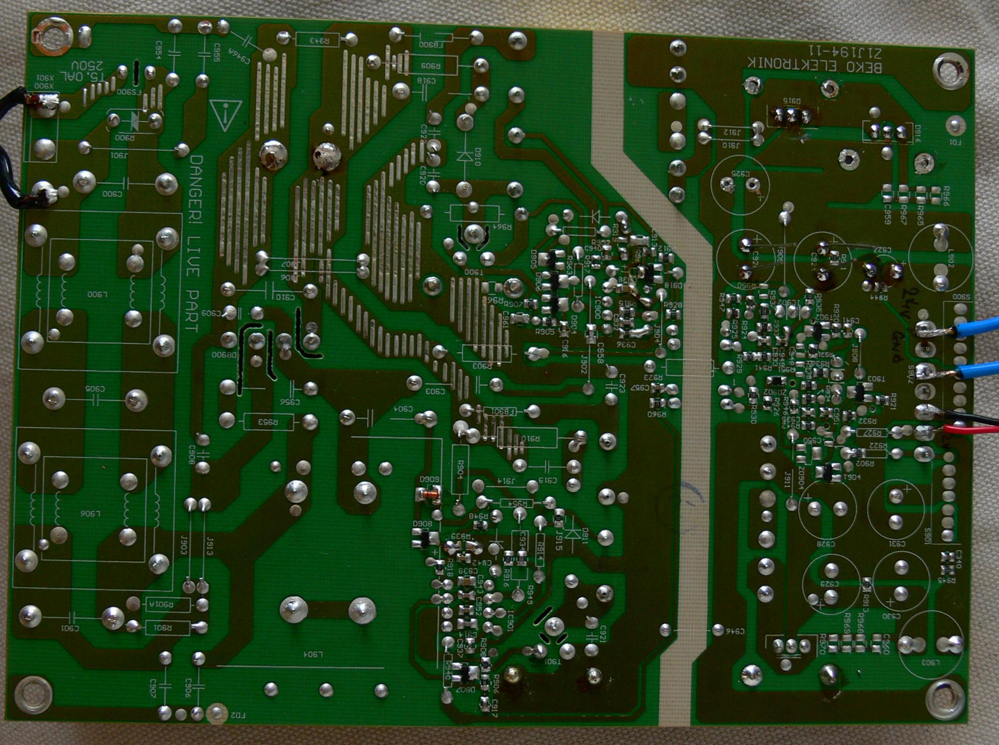

    Ok, last night got a 26" Grundig LCD TV from outside the dumpster downstairs.
    Chassis / inside are made by Beko. Power supply's basically two flyback converters on the same board. Silkscreened on the board it says the outputs are 24v @ 5A and 12v @ 5A. Controllers are Infineon ICE1QS01. Caps are / were 3x G-Luxon LU 680u/35v and an LZ 220u/35v on the 24v output, and 4x Daewoo RF 1000u/25v on the 12v output.
    Now... The 24v output is around 3,9v and the 12v sits around 10,6v. That's with or without a load (two car bulbs in series on the 24v and a 12v fan on the 12v output).
    The voltage on the filter caps for the ICE's are 14.895v for the 12v one and "bouncing around" between 12 and 15v on the 24v controller.
    I've replaced, albeit temporarily, the 3 big Luxons with two Panasonic FK 1000u/35v, and the small one with a pair of Rubycon YXF 47u/35v. Same Ruby's on the ICE Vcc's. Also replaced the 150u/400v G-Luxon primary cap with a 150u/400v Elna. Even went as far as replacing the two rectifiers on the 24v output with STPS20H100's (originals are Fairchild "YM3010N", on which i've yet to find a datasheet).
    Any clue what i should be looking for? My hunch says "feedback", but i've yet to trace the circuit...

    With slight embarrassment, i offer a small update:
    Except the two 24v, three GND and one 12v pins on the output connector, the last pin was as-of-yet unknown. Upon bridging that to the 12v output with a 15k resistor, the psu came alive! Load bulbs lit up, 23.67v, and the fan i had on the 12v line spins a bit faster than before (at 10.6v).
    Guess i'll now have to open a thread in the TV section, since the main board doesn't seem to turn on the psu...

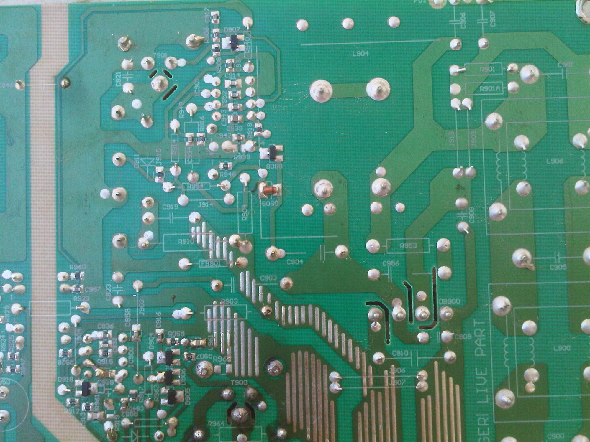

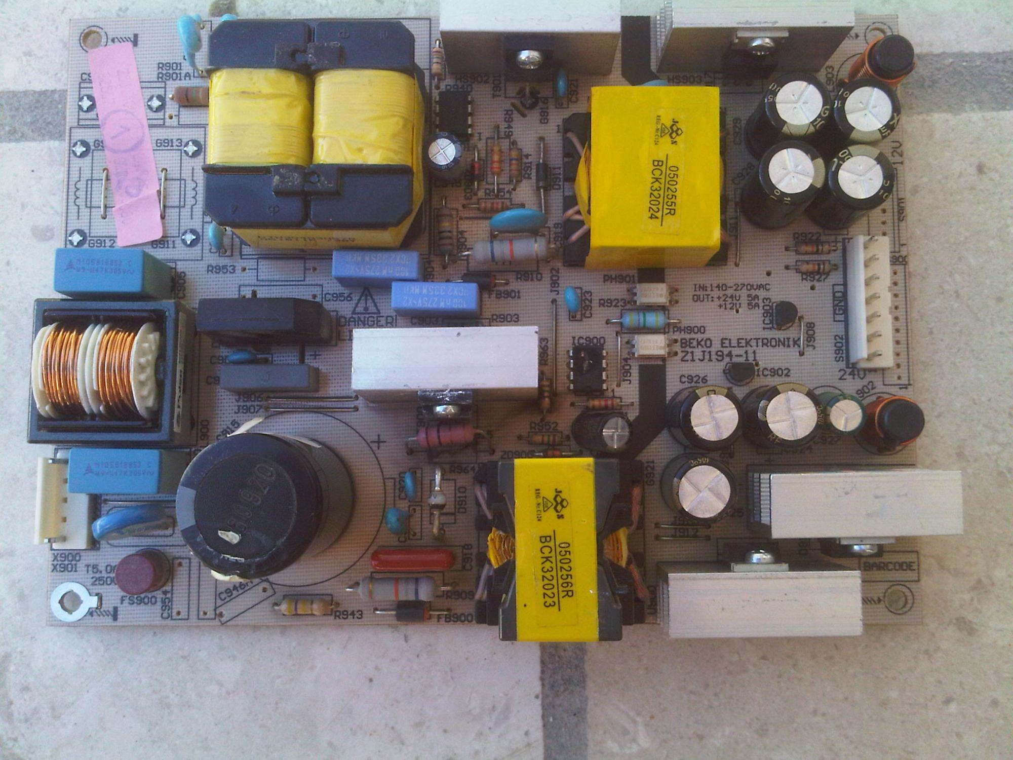

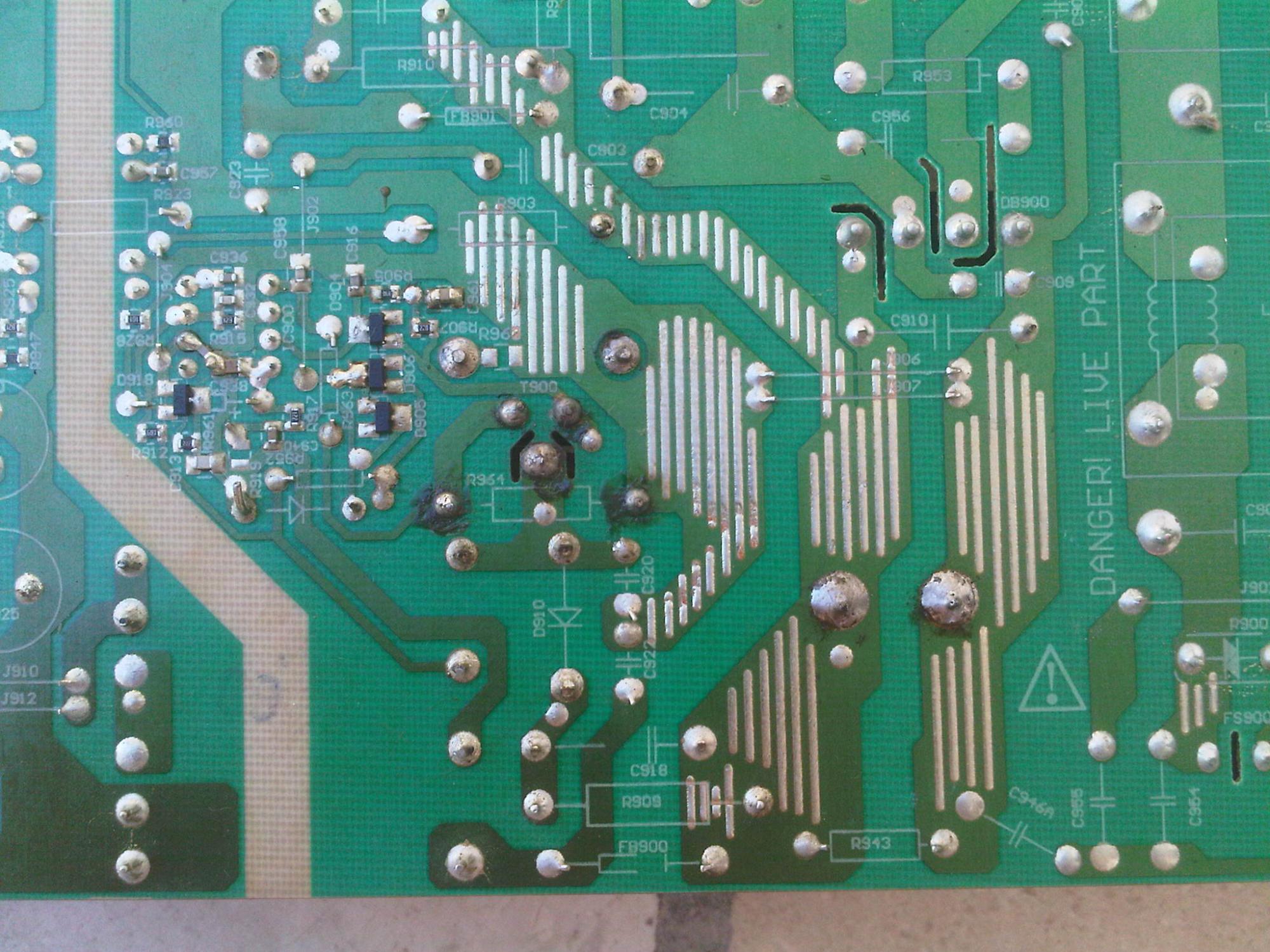

                first of all, thank you for the interest shown.
                Ben7: i have checked them, everything ok.
                selldoor: yes, 20N60C3 (as shown as in the picture) could do the job, although 20Ampere mosfet might be a little exagerated for a 140W LCD tv.
                well, i think i'll discuss the problem from the start in this thread.
                TV had been serviced elsewhere but previous technician did not succeed.
                i found:
                IC900 totally destroyed. ICE1QS01.
                T900 power mosfet shorted.
                R964 0,1Ohms ((-) to the Source pin of transistor) opened.
                D904 SMD (from oscillator to the gate pin of transistor) opened.
                R963 150 Ohms resistor (from the source pin of transistor to "Overvoltage Fault Comparator" pin of controller) opened-burned.
                other components including fuses are ok.
                with a little observation:
                the 12Volts section works properly. interesting, it has the same controller, the ICE1QS01 with a-maybe-less-powerful mosfet and much less other components. surprisingly, the "Overvoltage Fault Comparator" pin of controller is grounded and not connected with a 150ohms resisitor to the Source pin. the source pin too is connected directly to (-) and not with a >1ohm resistor as in the 24v section.
                i checked the ICE1QS01 datasheet and "Overvoltage Fault Comparator" was an option which you could delete by grounding that pin.
                my electronic knowledge does not go that far. yesterday, i read all day long about SMPS controllers and learned many things, but i still dont know why in this case the manufacturer enriched with components the 24V section and reduced them in the less powered 12V rail. it has got to be with power, for sure, but how it would behave if i followed the 12VDC schematic too to the 24V?
                i mean, if i ground the OFC pin, would the PSU be reliable? maybe i have gone into deeps but i really want to learn how to build a simple and cheap SMPS myself. maybe the ICE1QS01 isnt the most reasonable controller, but i find it simple. do you agree? or sth better can be done if i remove all components and follow another schematic of an another good controller?
                thank you for your time! your feedback means a lot to me!

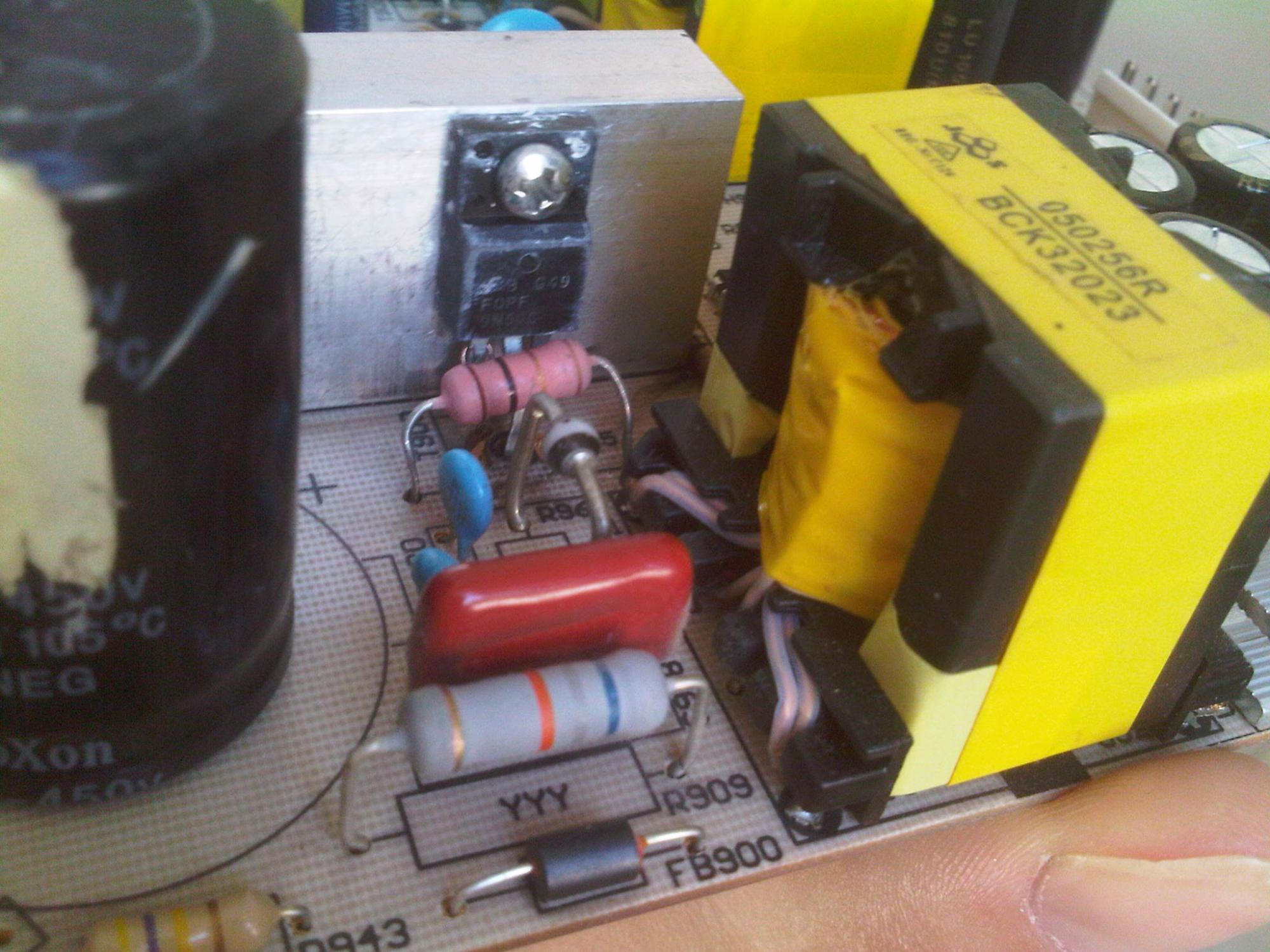

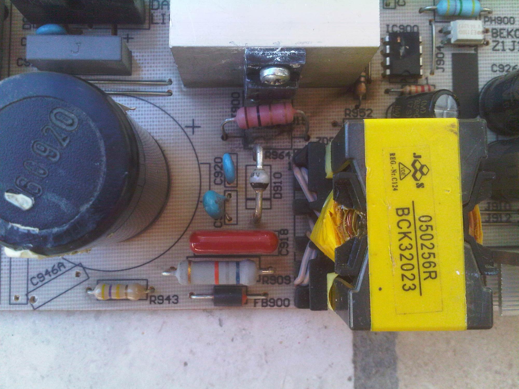

                  now i see, that the original .22 ohms resistor has been swapped from the previous technician for a 0.1 one. does this affect anything?
                  • ben7
                    Capaholic
                    • Jan 2011
                    • 4059
                    Re: Grundig / Beko LCD TV power supply problem
                    Actually yes, the resistor is probably for the current sense, so maybe this is why it blew up.

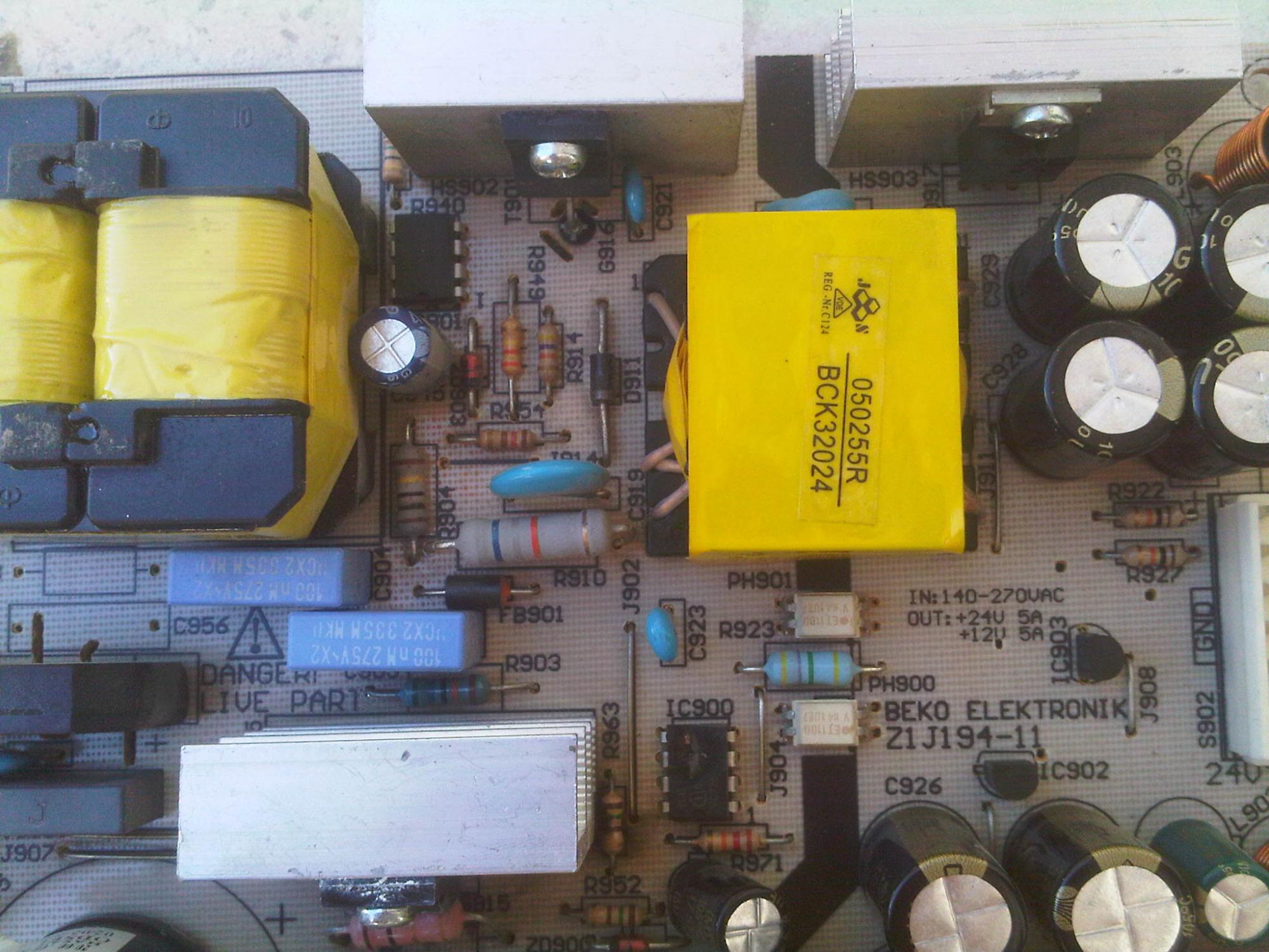

                      My electronics knowledge is far less than yours - you probably need input from more knowledgeable members.
                      Just one thing in pic5 R903 (which I dont think has been mentioned) looks badly soldered on the right hand leg - (may just be shadow on the pic)

                        yes ben7. in the ICE1QS01 schematic, the corresponding pin had to do with the current sense. but i cant see how a lower value resistor can raise the voltage in an application like that. although now im blaming directly R964 for the failure.
                        selldoor you are right too, it is badly soldered but not so bad, it works. maybe because of the low current which goes through it.
                        anyway i think i should start collecting the components for the repair.
                          With smaller value (lower Ohm) Source pin current sensing resistor, the MOSFET will have to conduct more current through that resistor to develop enough voltage to trigger the shut down, so basically when 0.1 Ohm is used the over current trip point (more than twice as high as it was original design) will be higher, in this case, it is higher than the MOSFET can handle so the shutdown function become useless. They pick the 0.22 Ohm for reason. It is like putting in 20A fuse in place of 10A fuse. The resistor is also precision, I think it may be 1% resistor. This is one part of the circuits that must use the same value component.
                          If you look at page 17 of the spec sheet, the OFC is 1V for the trip point.
                          So the MOSFET will have 10A flowing through it before the circuit will shutdown when 0.1 Ohm is use for sensing current.

                                i imagine this scenario, the mosfet had failed (bad quality, overstress, overheat) and shorted. at this point the 0,22 resistor has blown. maybe it has burned in such a way that has became unreadable. so, the previous technician has guessed by putting a 0,1 one. this has deteriorated things by applying high current to the OFC pin, as witnessed from the blown R963-150 Ohms and the destroyed IC.
                                now i have a 12V similar IC section, which i could have followed, but this does not help me that much, because the constructors have gone the easy way. pin OFC is shorted to ground.
                                i want to order only the:
                                IC ICE1QS01
                                the 20N60C3.
                                it seems to me much easier shorting the OFC and bypassing the R964. but i also hate explosions :P
