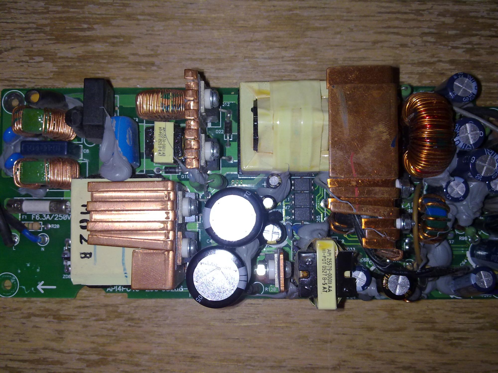

    i have a friends iMac G5 power supply that i suspected was faulty because her iMac wasn't turning on at all. i've taken the psu out and done voltage tests following this guide here:
    http://jimwarholic.com/2010/03/measu...ug-pinouts.php
    BUT, after searching about iMac G5 psu's on this forum i've found out that i wasn't testing the voltages correctly, the way i was testing it was just plugging the power into it and then measuring each pin. voltages were either dead on most pins or maybe double the value on some.
    could the reason of me getting these stange voltages be because i was testing the stanby power? if so (following this guide) will putting a jumper in pin 15 and 16 power it on so i can test voltages while it is on?
    also when using a jumper inbetween pin 15 and 16, do i just have to jump them together for a second to power it on and then again to power it off or leave them linked?
    could someone please give me guidance?

    Re: iMac G5 Power Supply Voltages (i'm a newb)
    https://www.badcaps.net/forum/showpo...1&postcount=37
    Jumper stays in place. 24vsb may read 19-20v in standby but should come up to 24 when jumpered.
    Is this an AcBel, Delta, or Celetronix unit?
    If AcBel, what is the API number on the case?

          i just did the voltage test with the jumper in it and got these voltages,
          1 - 00.0v
          2 - 00.0v
          4 - 00.1v
          6 - 00.1v
          8 - 00.0v
          9 - 10.6v
          10 - 00.0v
          12 - 00.0v
          13 - 00.0v
          19 - 00.0v
          20 - 00.0v
          21 - 00.0v
          22 - 44.3v
          what's with these voltages?
          and Toasty, it is an AcBel, i can only find 1 number that has API in it:
          API4PC46
          thankyou so much for your help so far!
            Time to re-cap the unit it seems. Open it up and have a look. Pictures please.
            No load on those lines will give false readings, especially when the caps are blown. Takes 15 for a full re-cap sans the 2 mains caps, and a good 45w or better soldering iron.
            You'll need a #8 Torx screwdriver to remove the case screws. Check them first though, as some of these use the Security Torx screws with the pin in the middle. There are screwdrivers made for those also. Given the choice between the 2 screwdrivers, buy the Security one.
            Toast

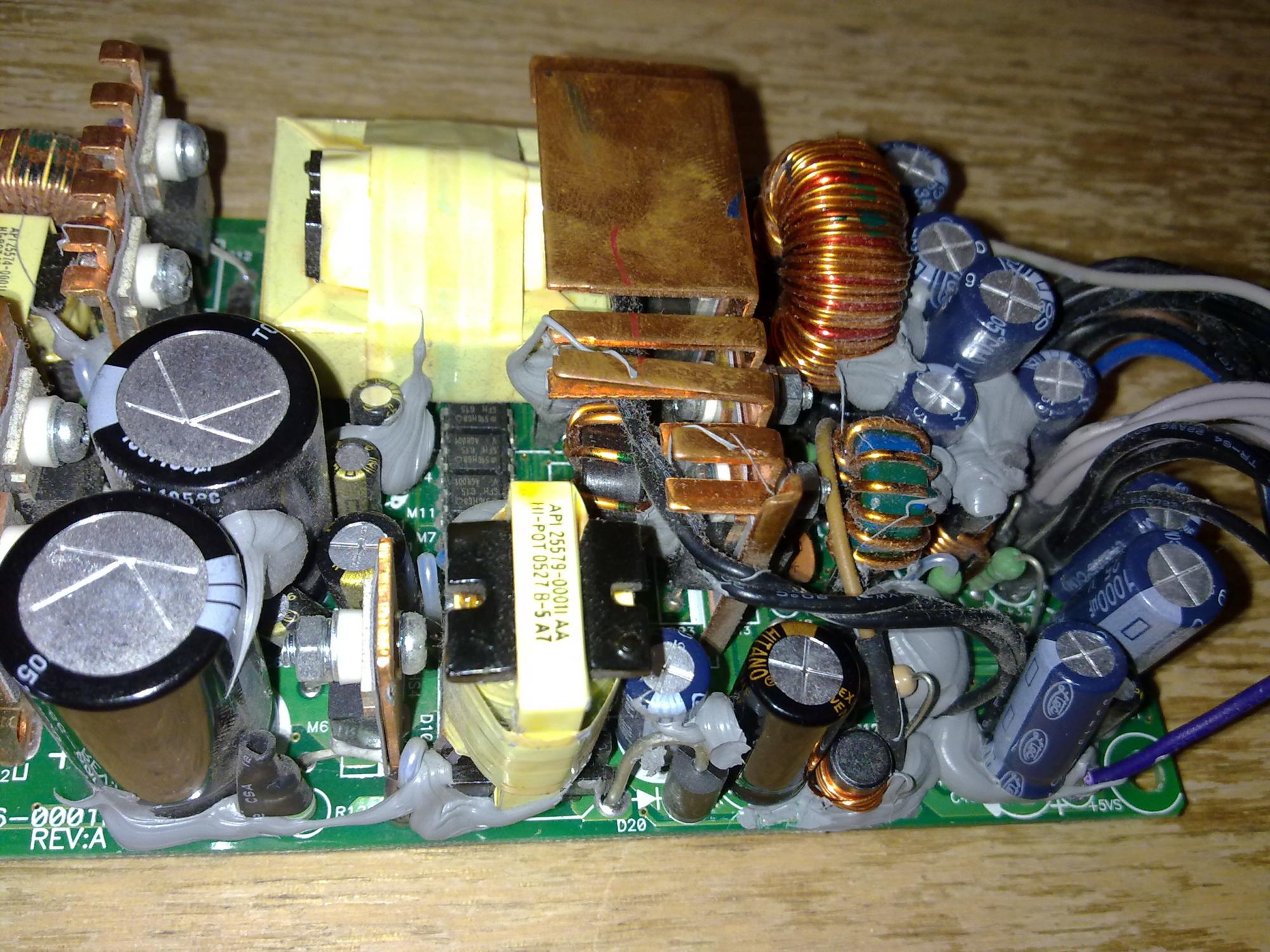

              already had it apart, all the caps look good except 1 was slightly bulged, already replaced it though and that never fixed it.
              in the first photo you can see the black and gold cap on the right of the board, this is the new one

                Caps can fail with no visible signs. Out of all the bad caps I have replaced, only two were bulging or leaking. I haven't even tried to work on my parents' old Dell, which has three visibly bad caps and many more that have likely failed. I don't have good enough soldering equipment to recap a motherboard and it is not worth getting professionally recapped.
                  Hitano. What series (3-letter code such as EXR or ELR), capacitance, and voltage values?
                  DMM I assume?
                  Without an ESR meter, you can't be sure the other caps are good. With all the LTec caps spread about, I'd be very sure more were bad.
                    it's EXR 2200 microfarads 10V.
                    so do you suggest replacing every cap on the board?
                    • Toasty
                      • Jul 2007
                      • 4171
                      Hitano - EXR - 0.052Ω - 1220mA
                      Original - LTec - LYZ - (10x23) 0.020Ω - 2365mA -or- (10x25) 0.022Ω - 2400mA
                      Either way, the replacement chosen is not within spec.
                      My suggestion would be to replace every cap except the 2 large mains caps which are Rubycon's. I've not seen them fail yet.
