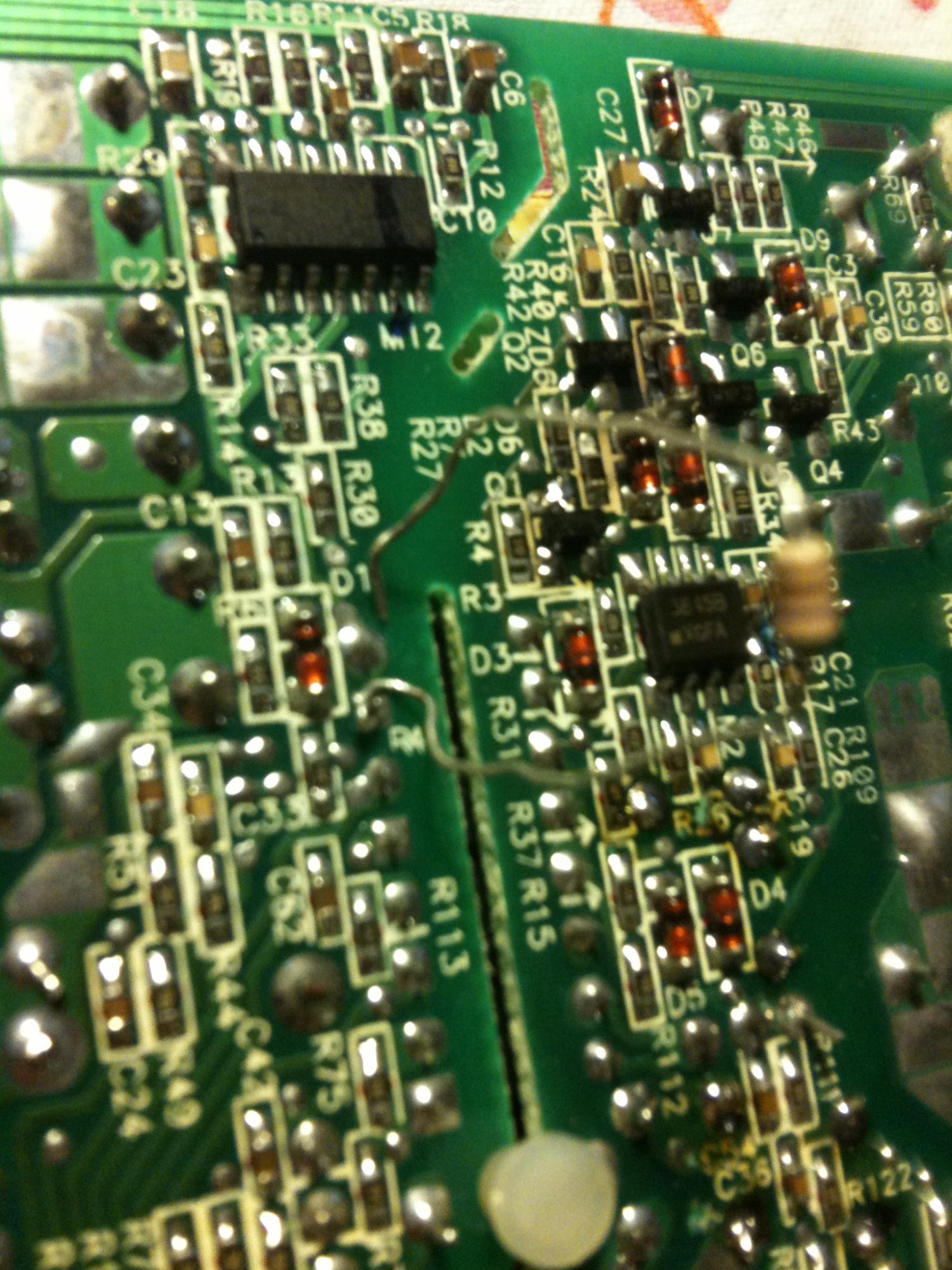

                                  I went ahead and tried again tonight to get voltages on another power supply. It's almost like you need 3 hands to do this. The only alligator clips I have are all attached to test equipment. So I had fiddle with it. Anyway now I'm not even sure I'm doing this right. I've attached a pictures with the resistor on the underside of the board to better show what I've done. Again, I'm not confident I'm following your instructions correctly. On the opto for M3 (underside) is pin 1 (square) the negative output and you short it with pin 2 using the resistor? If thats the case I'm not getting any voltages at other than the ones I gave you in the previous post. Those previous voltages I gave you are from standby regardless if I do anything with the opto.

                                    >>Connect a jumper wire (alligator clips) from output negative to one leg of the resistor.<<
                                    Means: the output of the power supply negative terminal(s).
                                    You could also solder one end of the resistor right to the negative which is 3/4" to the left of M3 / D1. The copper heatsink (on top) to the left is negative and you can see where the 2 feet for it come thru the board and are soldered in. Any trace on that will do.

                                      Ok I finally got some time to try this again and soldering the resistor to the feet of copper heatsink really helps. I was able to get voltages on another similar PSU but the layout is slightly different. However, on the PSU in question I still have no voltages coming out. They are all zero except for the ones that are the standby voltages which I mentioned in a previous post.
