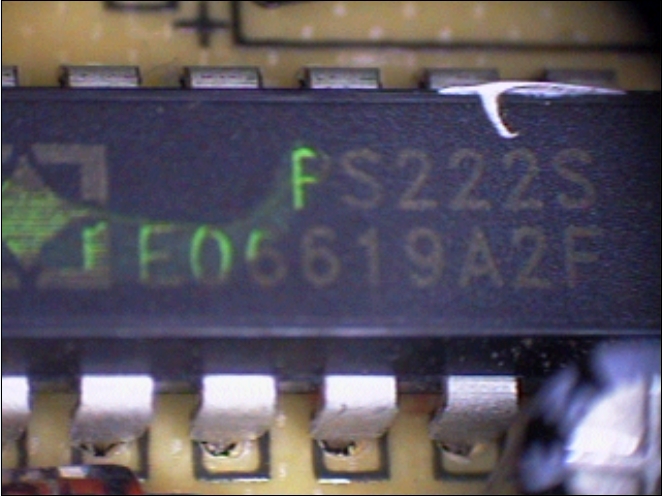

      Re: Bestec....the next generation

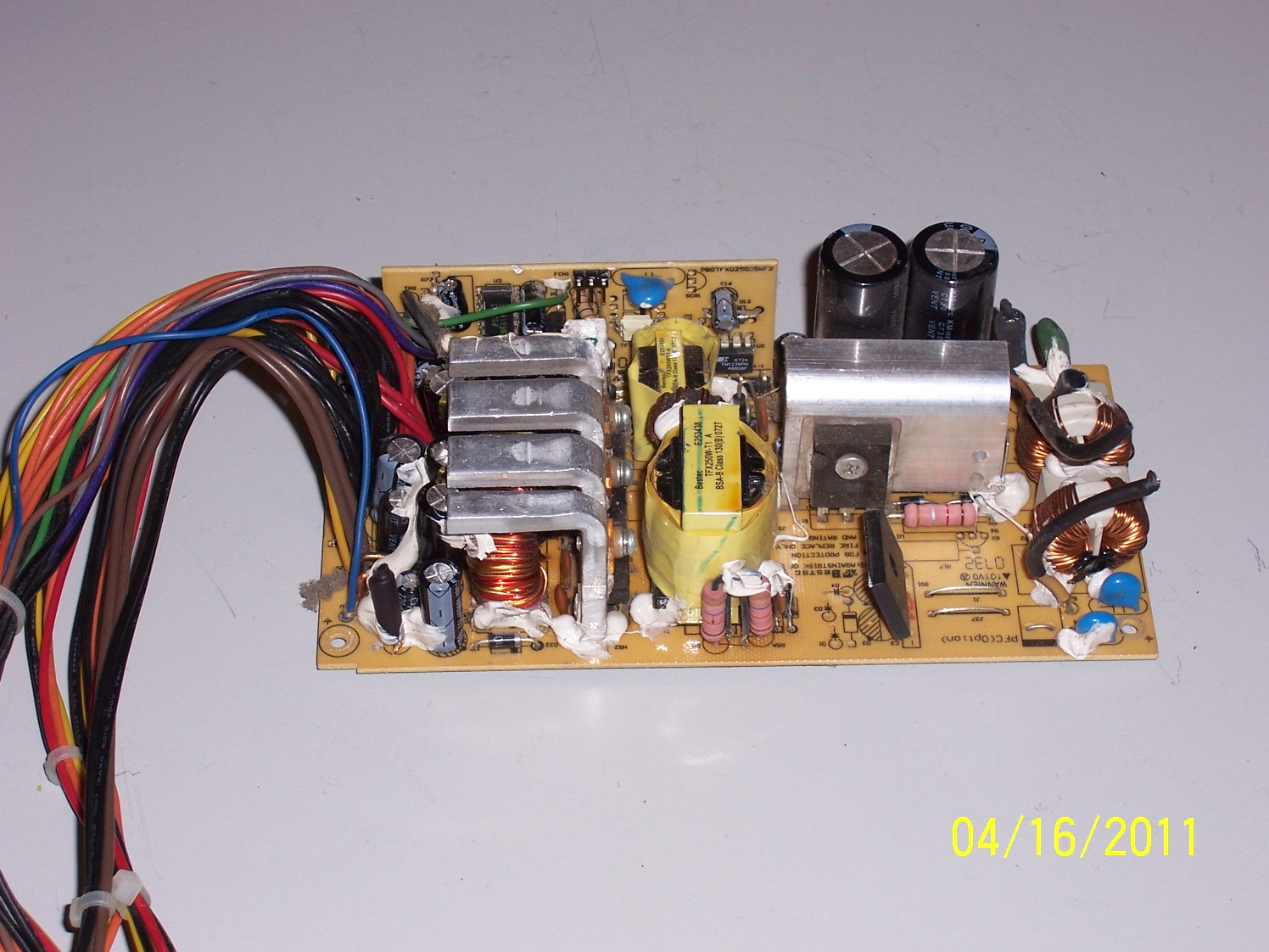

      Originally posted by Evil Lurker
      That would be a Bestec ATX0350D5WA. Considering the fact that it has no 4 pin molex connectors and is fairly dust free on the inside I'd assume that it is no more than 1-2 years old tops if that. My bad typo... meant to say C36.
      So........are you going to fix it or is it headed for the scrap pile? If you don't mind, see if you can locate where C36 is on this particular psu. C36, C37, and a coil usually form a pi filter for the 5vsb. Also, are those two bulging capacitors in the 3.3 volt circuit, or did I misguess that one?
      Old proverb say.........If you shoot at nothing, you will hit nothing (George Henry 10-14-11)

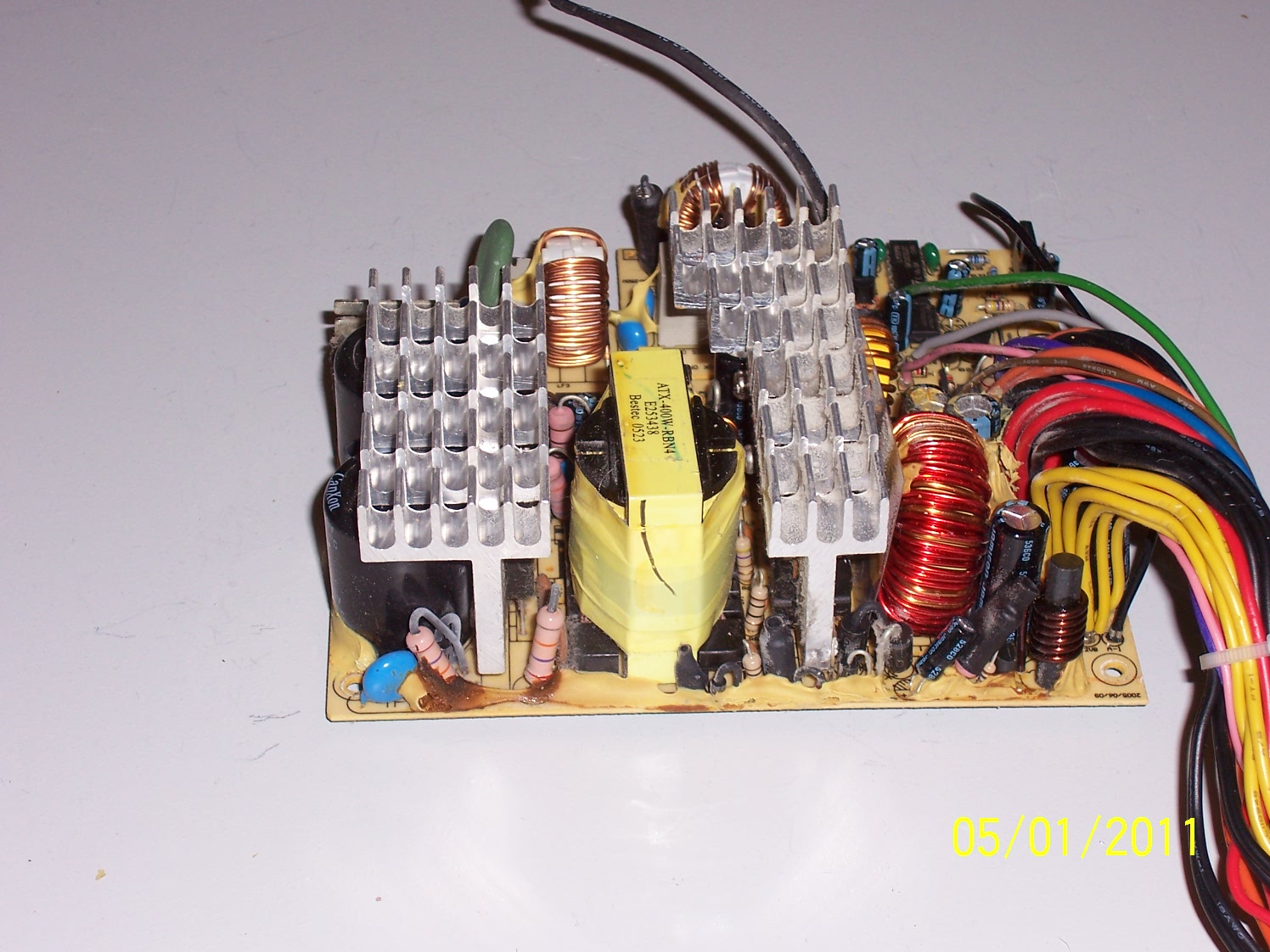

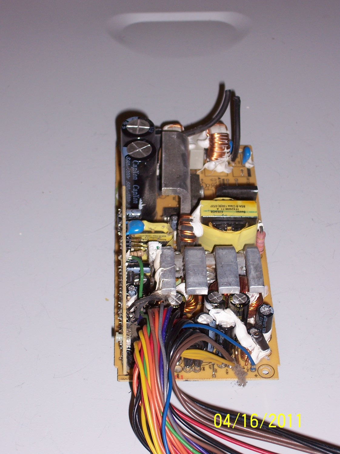

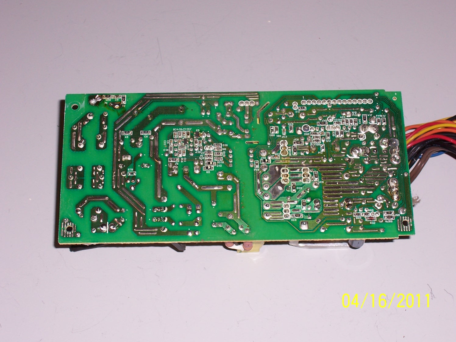

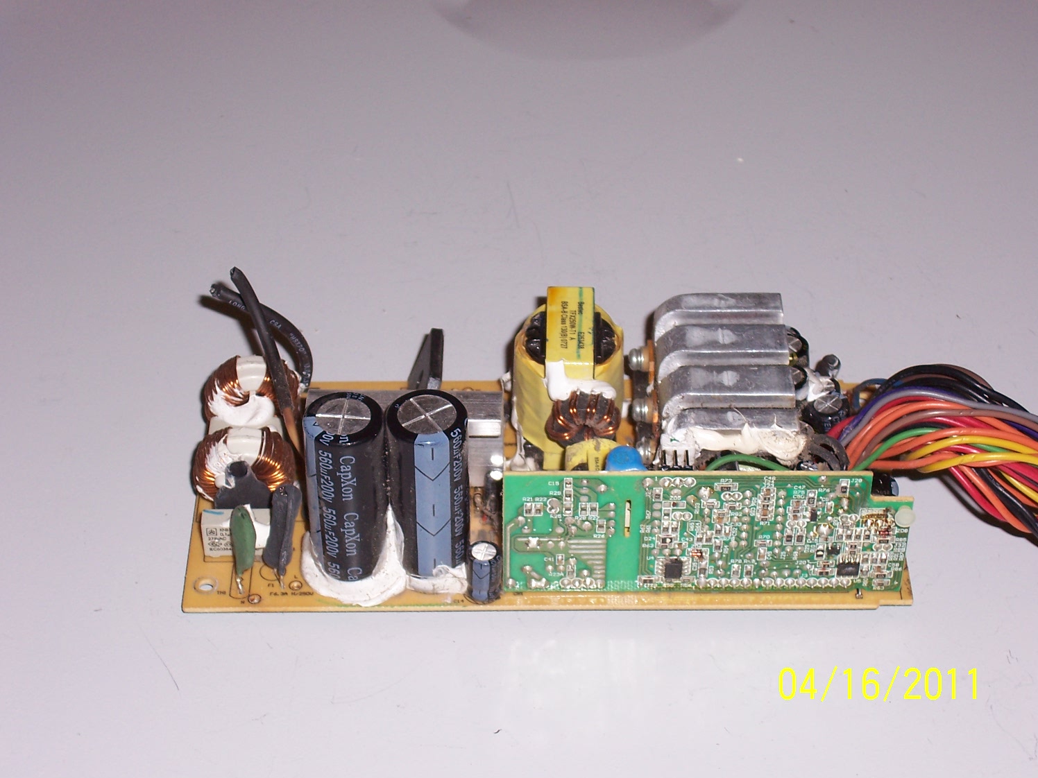

      • everell
        • Jan 2009
        • 1514

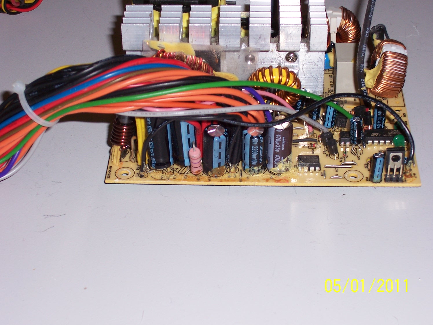

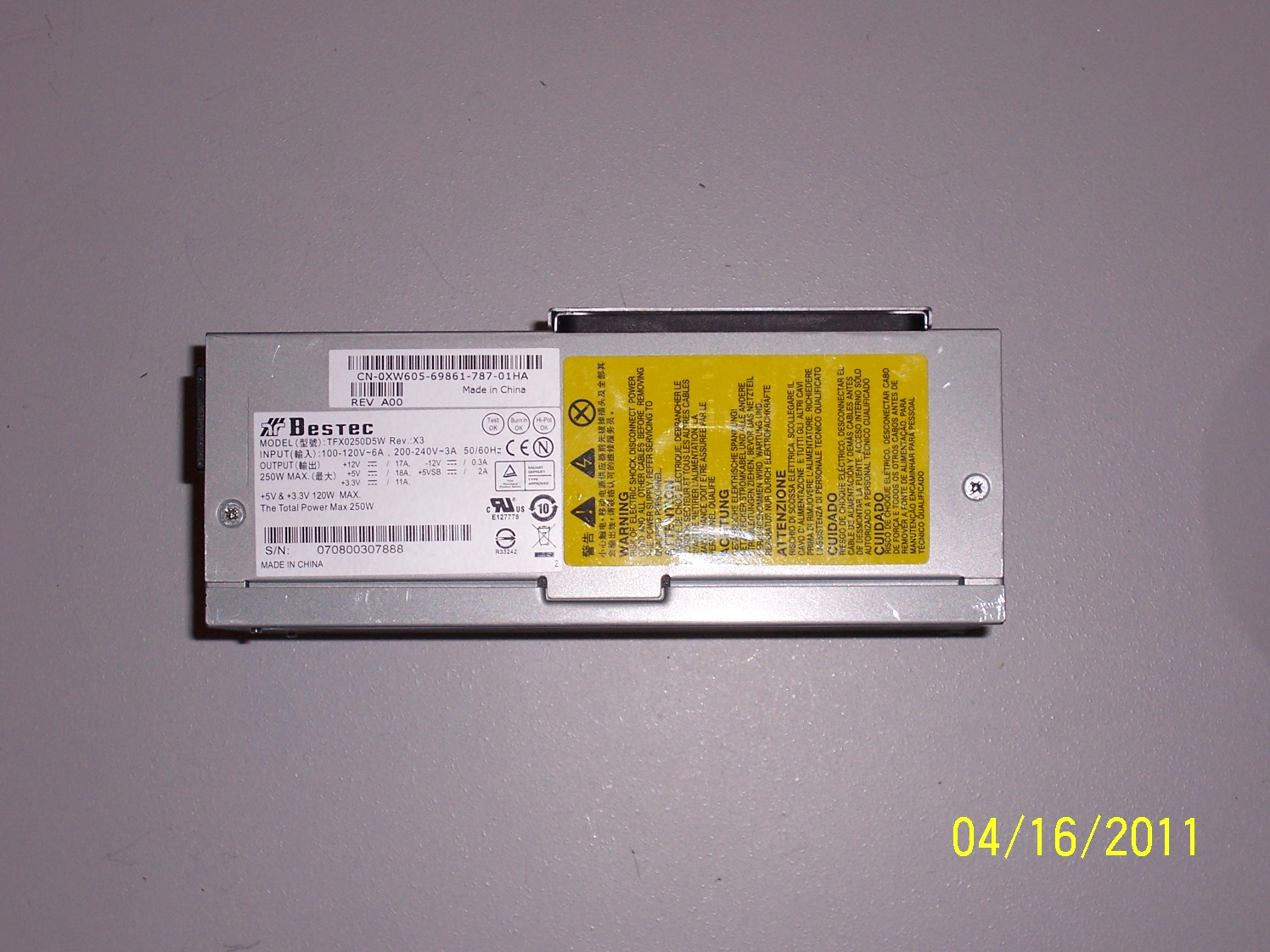

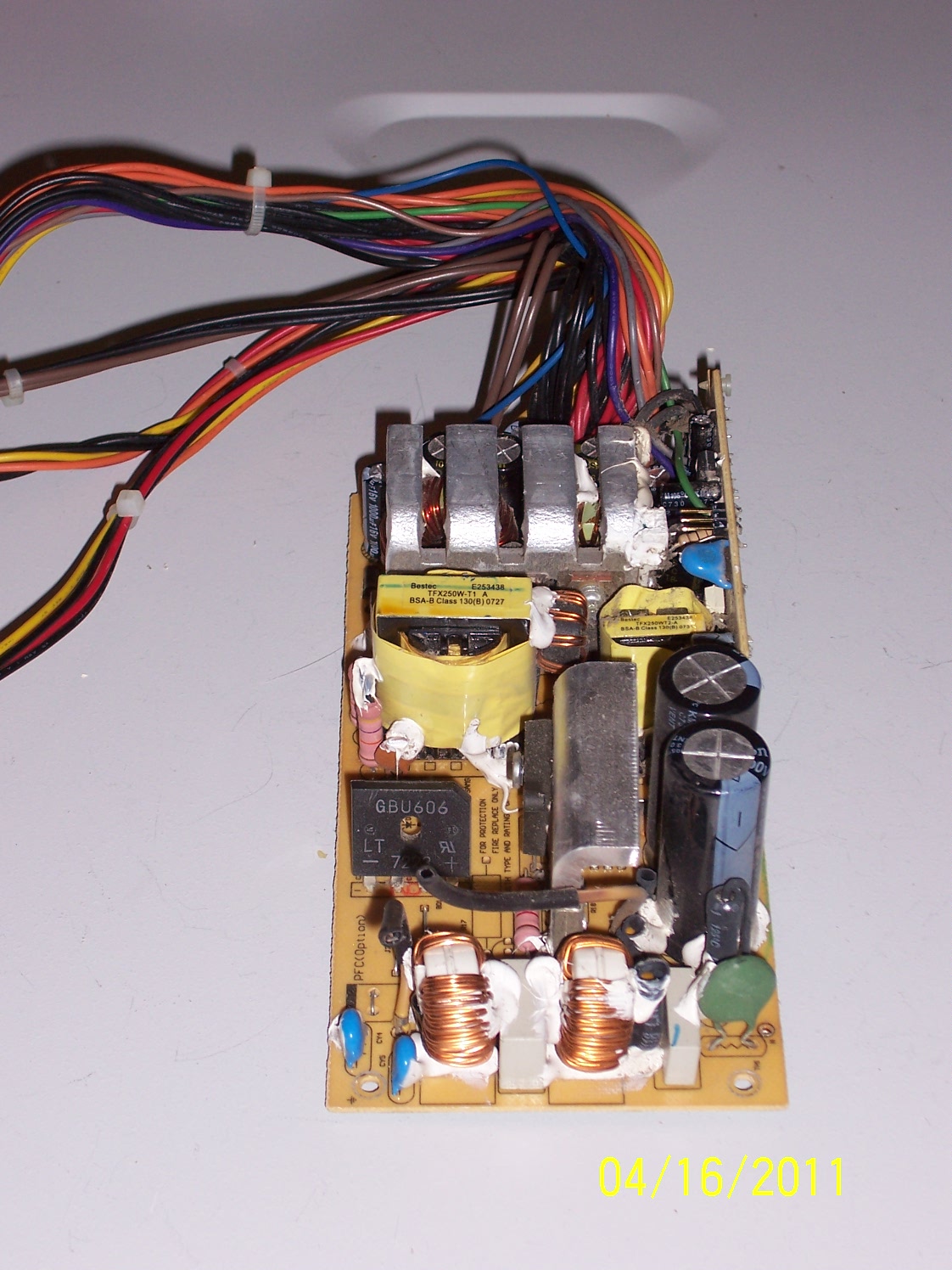

        Next up is a Bestec TFX0250D5W. A smaller case but a 250 watt cutie. It has a 24 pin connector for the mother board. Three SATA connectors but no molex connectors, a floppy connector, and a four pin cpu connector. This power supply is probably for a low end economy computer.

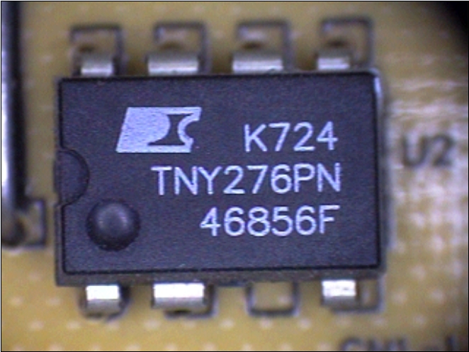

        • everell
          • Jan 2009
          • 1514
          The silicon used in the Bestec TFX0250D5w include a TNY276 pwm chip for the 5vsb circuit, a 3843 chip for the main pwm chip, a PS222 for supervisory control, 358 and 393 chips in supervisory circuits, and 9N90 switching transistor.

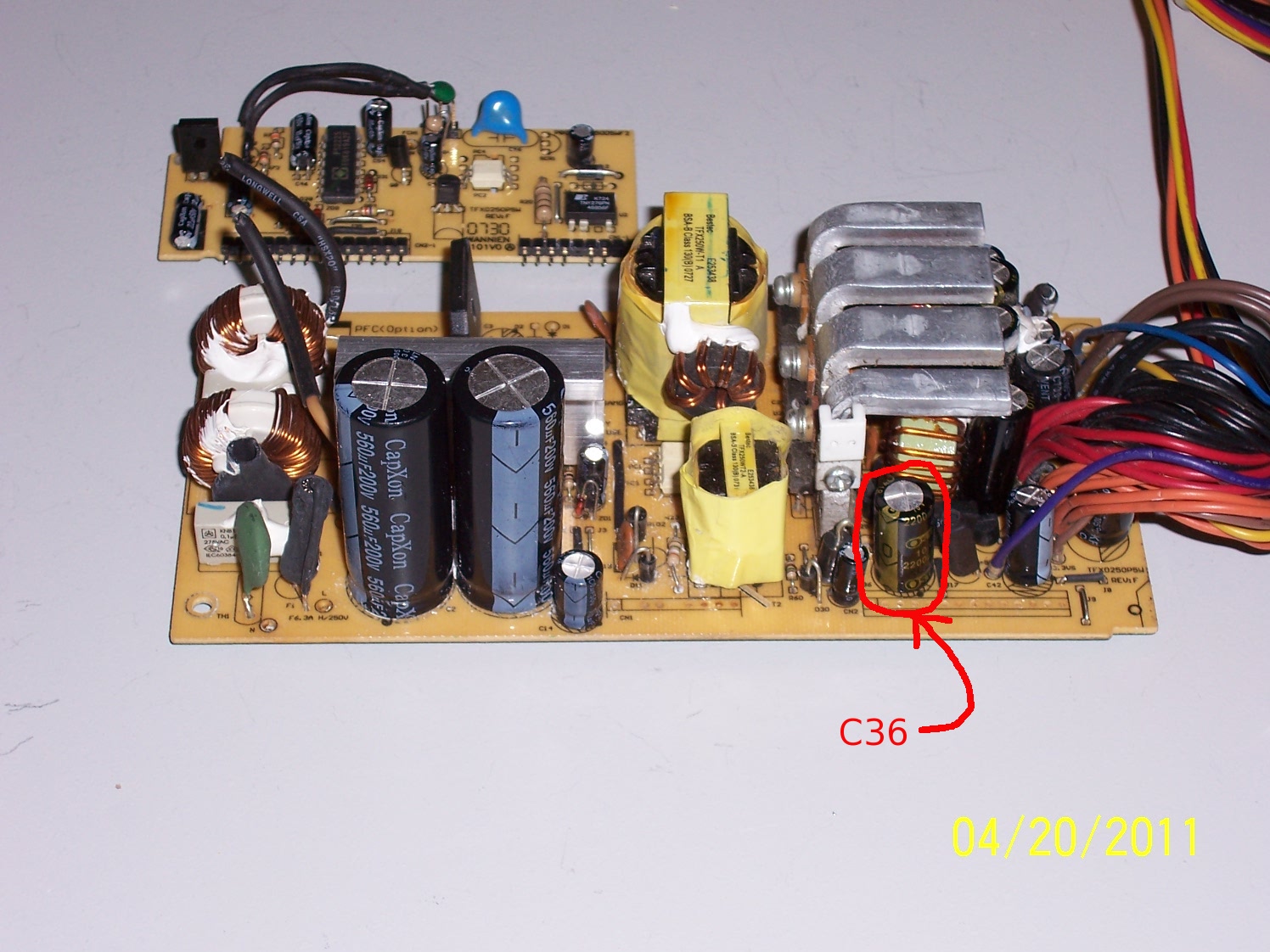

            • everell
              • Jan 2009
              • 1514

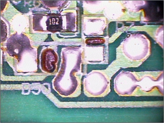

              On the down side, the Bestec TFX0250D5W has the same problem as nearly all Bestec failures. Capacitor C36 is bulging.....and bad. Will they ever fix this problem???
              • everell
                • Jan 2009
                • 1514
                Originally posted by delaware74b
                Yech.....Capxon and OST's. I don't think they used enough glue on that board
                The failing C36 capacitor is OST. This psu is full of OST and Capxon, so I don't know if the C36 failure was due to "crap caps" or a heat related problem due to location of the component. It was NOT in a location where it could get good air flow.
                As for glue, I removed a LOT of the glue before picture taking. You can't see what is under the glue if you don't remove it!

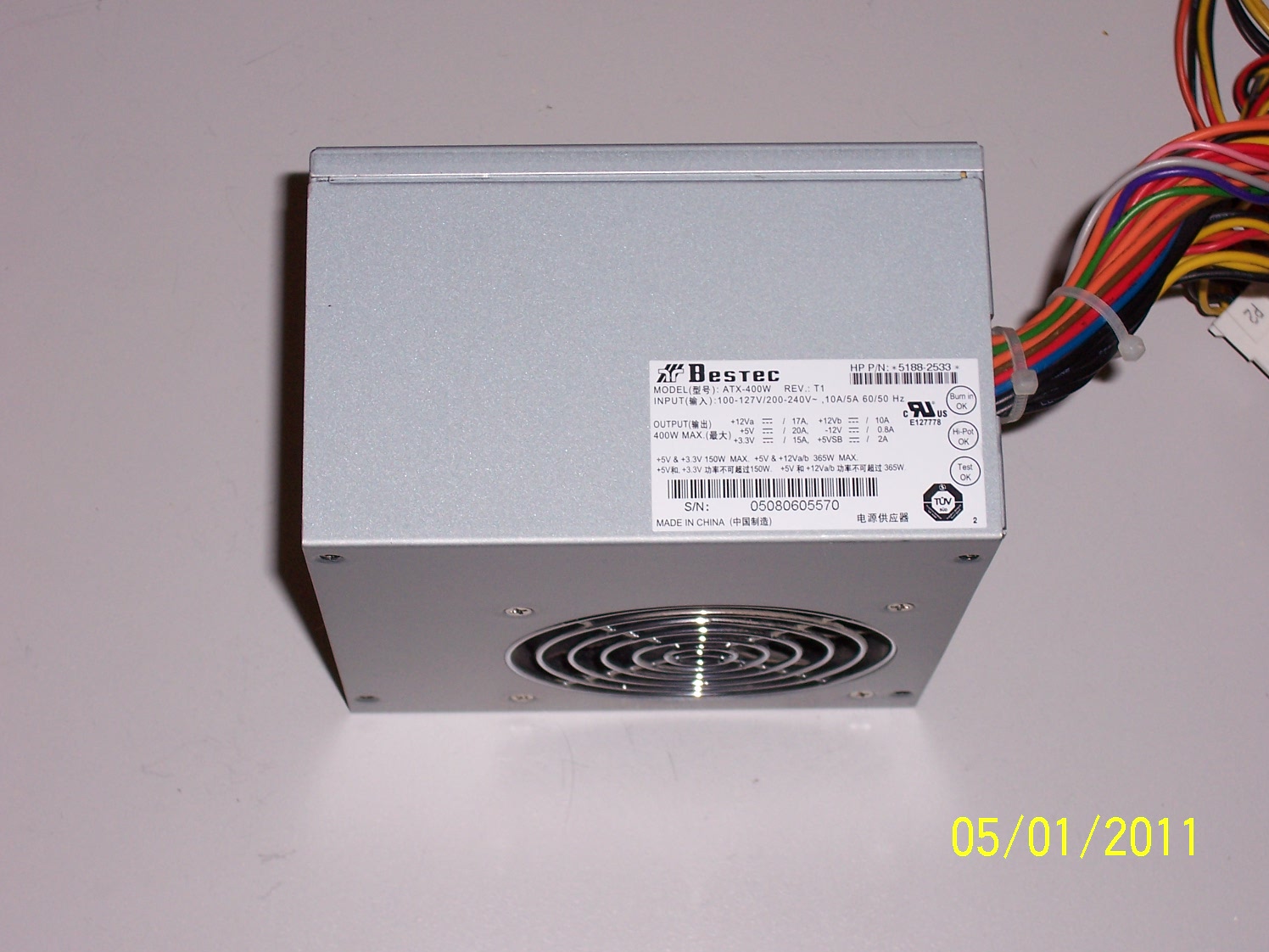

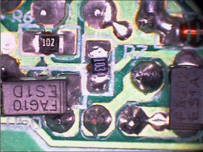

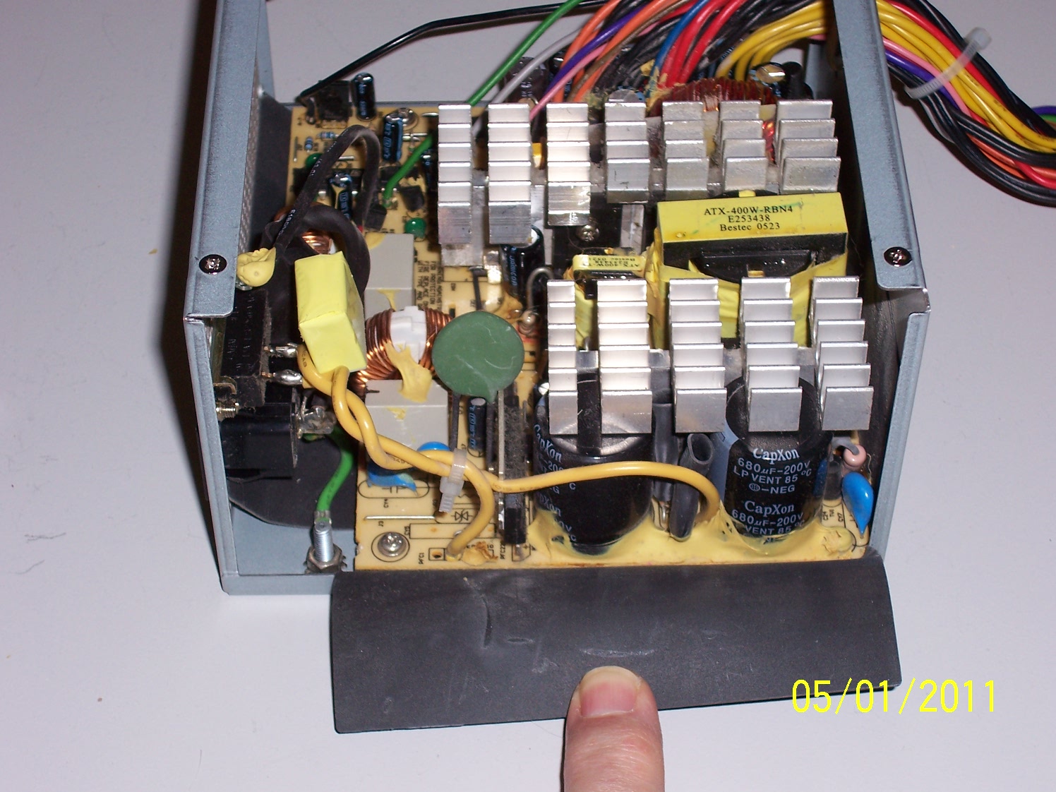

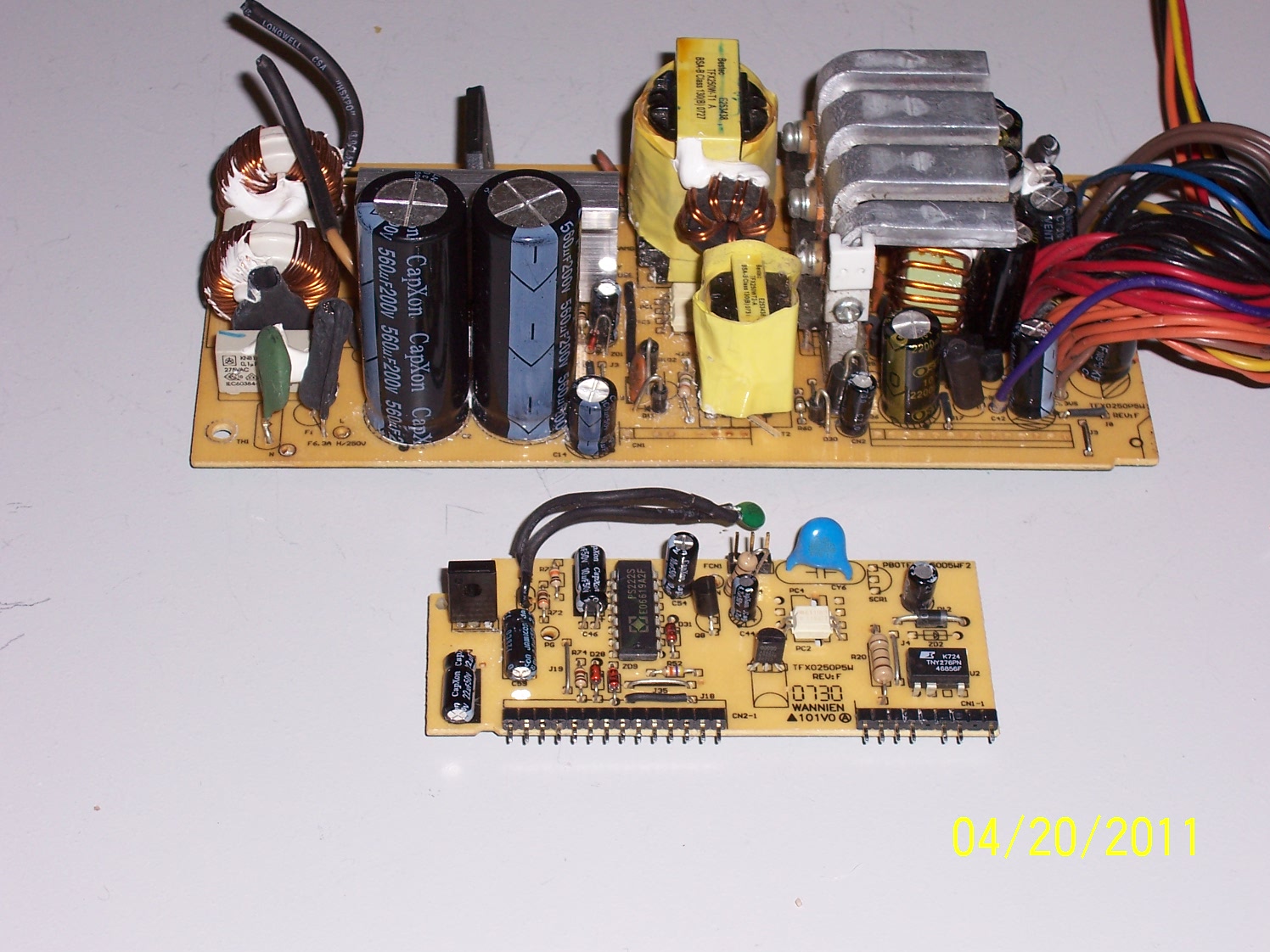

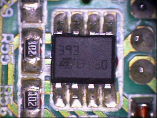

                    • everell
                      • Jan 2009
                      • 1514
                      #30

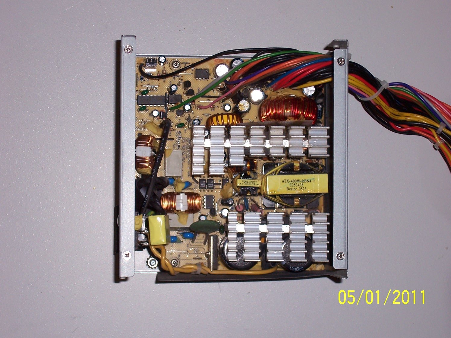

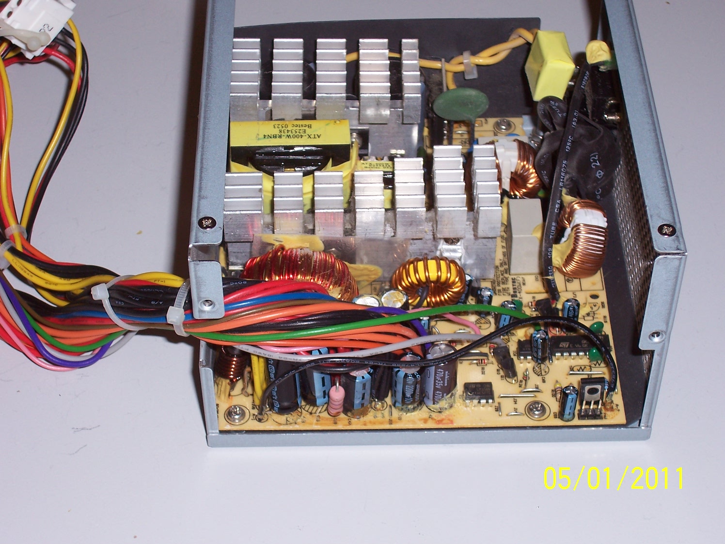

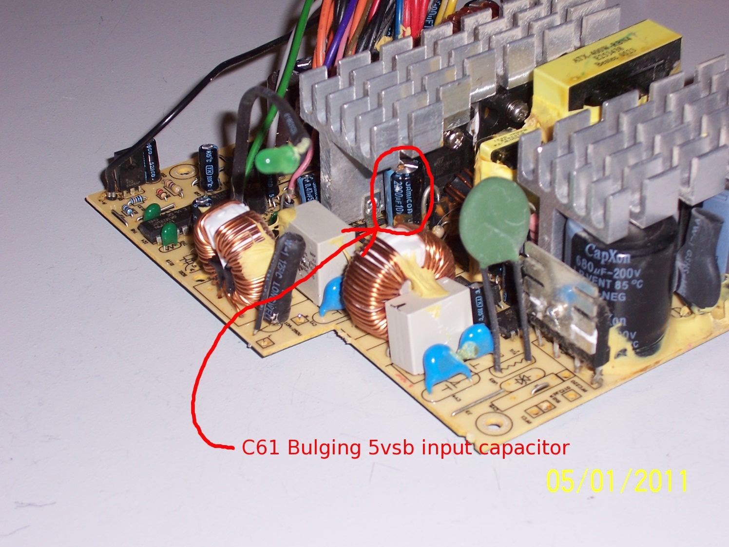

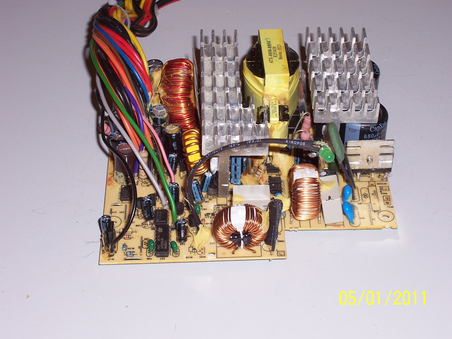

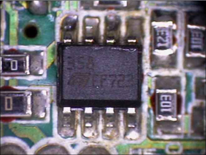

                      Next up is the Bestec ATX-400W. This is the first Bestec 400 watt power supply I have seen. It has a 24 pin mother board connector, a 4 pin cpu connector, 5 molex connectors, 2 SATA connectors, and a floppy connector. Nice balance. It has two 12 volt rails, one at 17 amps and one at 10 amps.
                      Silicon includes a SG6848D chip for the 5vsb circuit. No two transistor circuit problems! It uses UC3842B for main pwm, a TPS3510P for supervisor chip, LM358N and LM339N chips for supervisor support. It has one large switching transistor, but I could not make out the part number. The main switching transformer is a good size, also the heat sinks. The overall weight of the power supply makes me believe this is no gutless wonder.
                      On the down side, typical of Bestec, the 5vsb input capacitor C71 is bloated. The +5 volt output capacitor is also bloated. Both are Jamicon 2200 uF/10 volt capacitors. Also typical of Bestec, lots of glue that needs to be removed.
                      Overall it looks like a good project that needs glue removed and caps replaced.

                      • c_hegge
                        • Sep 2009
                        • 5219
                        #31
                        Oh wow! Look at all that glue. Believe it or not, I've never seen the 5vsb input cap bloat on a bestec before.
