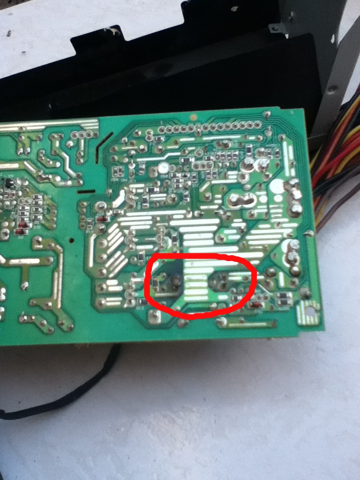

The cap's voltage is simply the maximum it can handle, so going up in voltage isn't a problem. The only potential problem could be that the 2200uF 16V Panny FM is 12.5mm Diameter, while the original is 10mm diameter, so it may not fit.
I'd probably use either http://uk.rs-online.com/web/p/aluminium/7083572/ (RS Components UK)
or
http://uk.farnell.com/panasonic/eeuf...0uf/dp/1800626 (Element14 UK)
EDIT: Looks like RS is out of stock of panny FRs. here's a suatable FM: http://uk.rs-online.com/web/p/aluminium/5260982/
