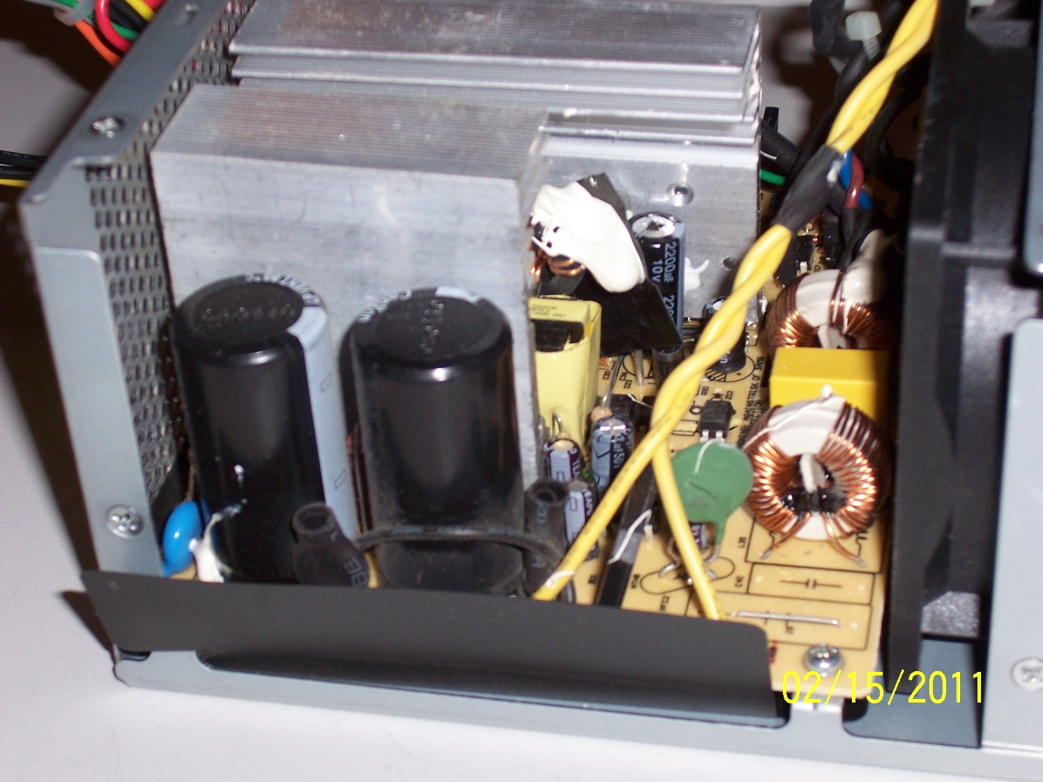

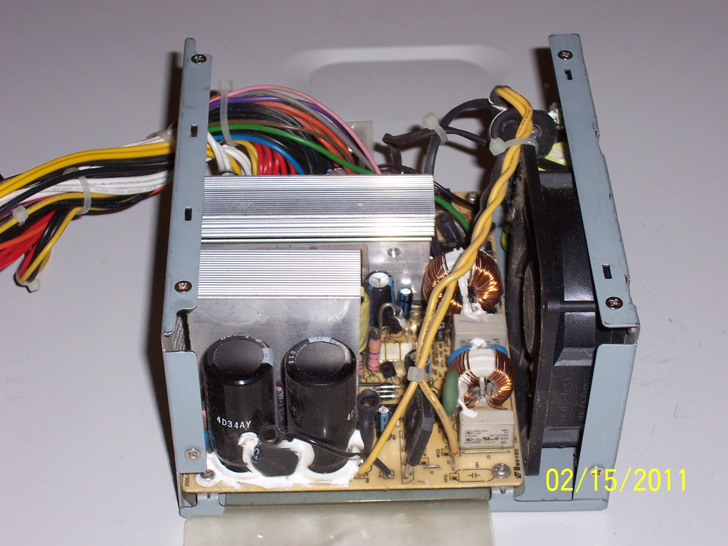

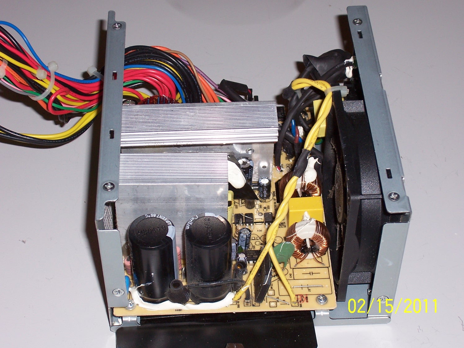

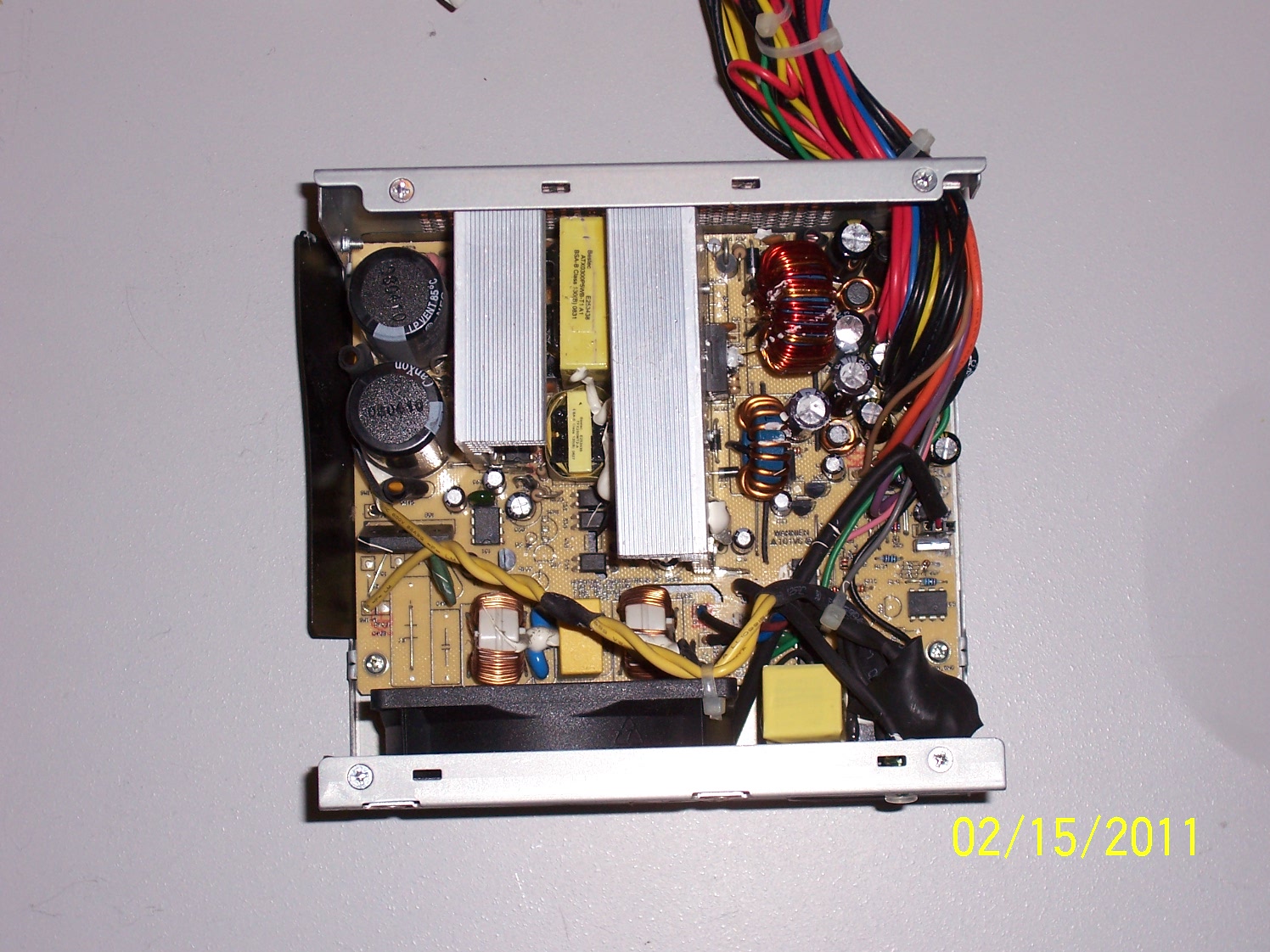

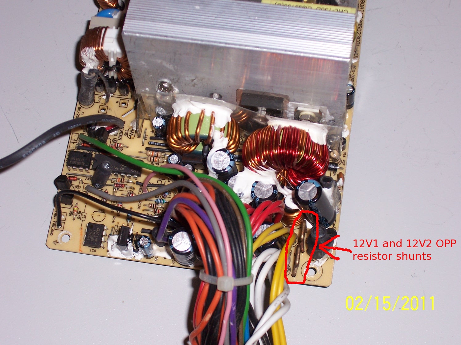

    To begin, this is the Bestec ATX-300-12EB3. In general appearance it looks much like the Bestec ATX-250 12Z, but is oriented toward the 12 volt processors. It has two 12 volt outputs each rated for 18 amps, and a 5 volt output rated for 25 amps. It uses the same 5vsb chip as the 12Z, the A6351 chip, therefore preventing the 5vsb overvoltage problem in the early 12E model. It also has four optoisolators, one of which is the crowbar circuit for added protection. When something causes the power supply to shut down, the crowbar circuit prevents you from turning the computer off then back on. You have to unplug it from the wall to release the crowbar. This prevents people from thinking the problem went away by using a simple restart.
    From the pictures you can see two shunts used for the two 12 volt overcurrent protection circuits. Something new added since the 12Z.

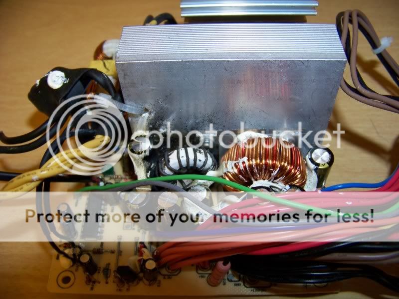

    Re: Bestec....the next generation

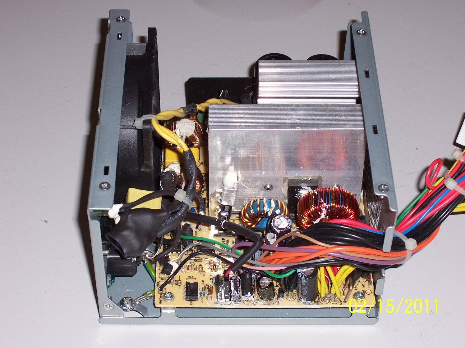

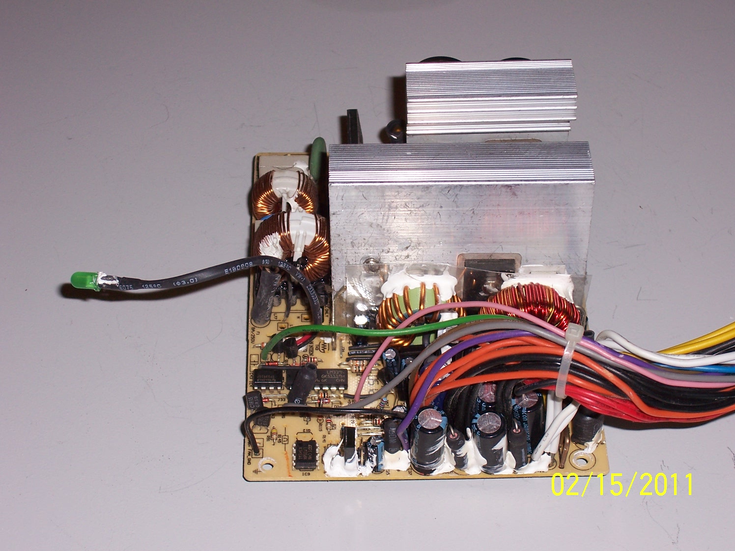

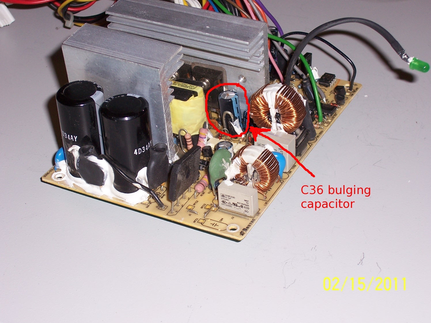

    On the down side, capacitor C36 was bulging on this power supply. C36 is in the same location as in most of the Bestec models. C36 is the input filter for a pi filter on the 5vsb line. Therefore with time it gives the same 5vsb problems as earlier models. My solution is simple. Move C36. First remove capacitor C36 from its present location. Drill two new holes on the other side of the heat sink. See photo showing new location. Then solder a new capacitor in the new location for C36.

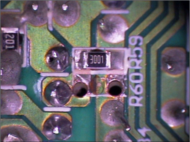

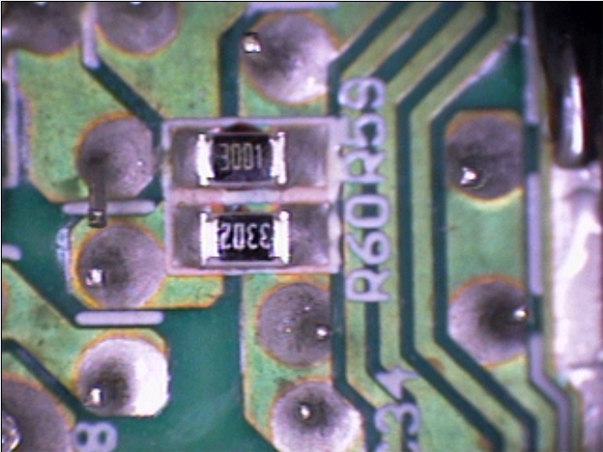

      I was not fully satisfied with the actual 5 volt output and 12 volt output, so I added a trimpot to the 5v/12v regulator circuit. Now I can tweek these two voltages. Remove smt resistor R60, drill two new holes and add a Bourns 3266W-1-503LF 50K trimpot (Digikey 3266-503LF-ND).

        The glue is still white!
        I've got a 250- and 300-12Z here. The glue job in the 300 was disgusting. Across isolation barriers, etc, like I've mentioned before. The stuff on the output inductors was extra crispy. Light to dark brown, it just crumbled... I had to remove them to clean them well enough. The mess in the primary wasn't any better. Across a pin on the transformer and touching the 'discharge'/damper diode, it was especially crumbly.
        You better remove that crap bridging those opts before there's an accident.

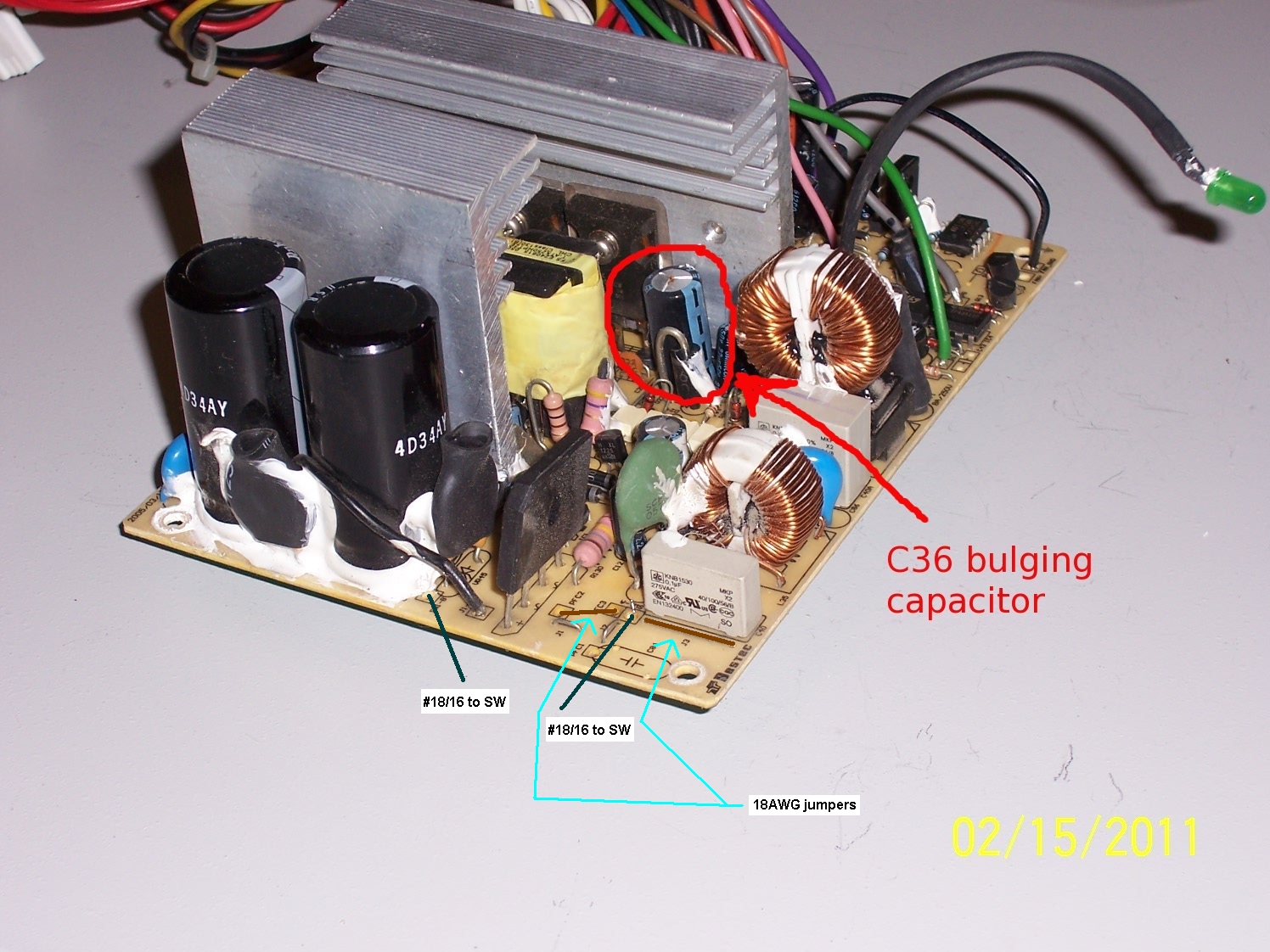

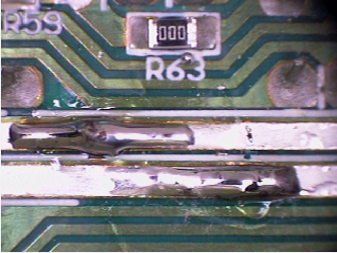

          After moving capacitor C36 and taking the pictures, I added a jumper wire to configure the pc board for 120 volts input. Originally I was going to recap this one AND get rid of all that white glue in the process, but after replacing that one capacitor the psu seems to be working great.
          I may recap it yet, and remove the glue, but I hope that Bestec will pay attention to our power supply analysis, and learn that the position of capacitor C36 is causing a lot of premature failures. Not as spectacular as the 5vsb problems in the 12E models, but still a problem which needs to be addressed. Nearly every Bestec power supply I have opened has a bulging C36 capacitor.

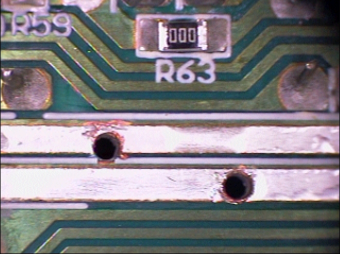

            As for glue damage, here is a picture of a diode in a Bestec ATX-250 12E after glue was removed.
              Oh yes, complete with corrosion.
                I use a jumper when troubleshooting the pc board out of the case. Once I am finished with the board, I remove the jumper and reinstall the switch wires that are still in the case as I put the pc board back in the case.
                I did leave the jumper in one gutless wonder. It will probably never be used in a computer again. Computer power supplies I work on are not customer repairs for pay, just a hobby I acquired a couple of years ago.

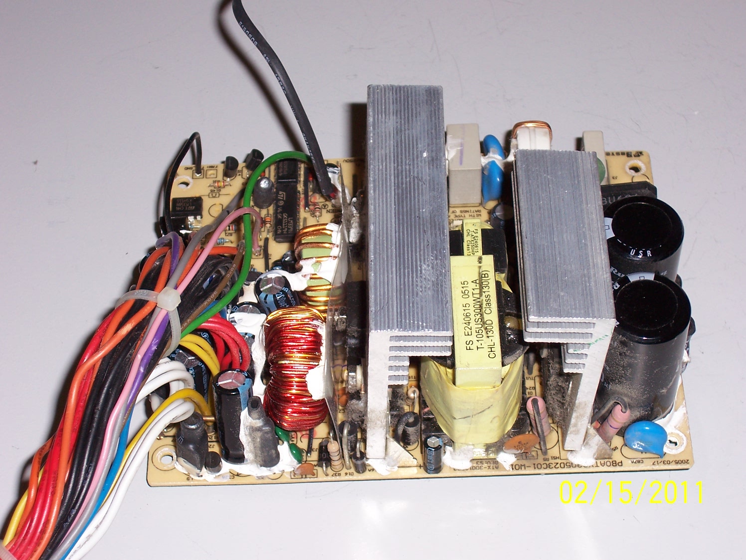

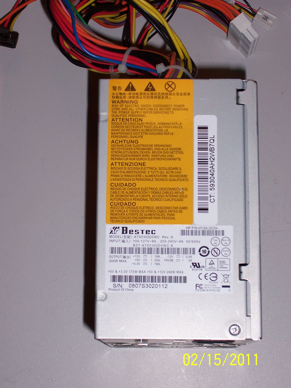

                  Next up is a Bestec ATX0300D5WC. More heavily oriented toward older 5 volt boards, this power supply has one 12 volt output at 19 amps and 5 volt output at 25 amps. What's new here? First, it has two SATA connectors as well as five molex connectors and one floppy connector. It has a 24 pin connector for the mother board and a four pin connector for cpu. Since it has a HP part number I am guessing that this is a OEM for an economy pc by HP. No six pin or eight pin connectors for high speed graphics cards. No LED indicator light on the back of the power supply case.
                  Inside the psu, what's new? The 5vsb uses a TNY276 chip. This pwm chip runs at 132 khz and has lots of nice new features. Looks like Bestec is moving away from the A6351 chip I have seen in so many of the Bestecs. Maybe the old A6351 workhorse has gone obsolete.
                  On the down side, capacitor C36 is bulging, as usual. Bestec needs to move that capacitor to a cooler location. If you get one of these to fix (for yourself, not for customers), you can drill two new holes and relocate the capacitor.

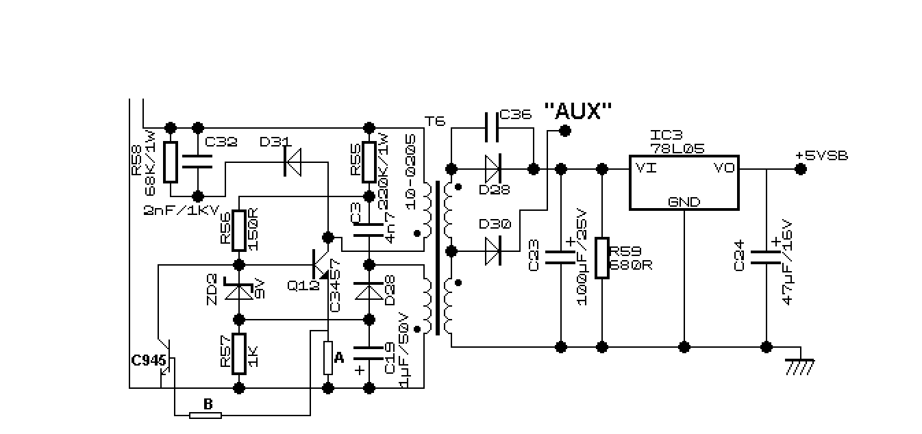

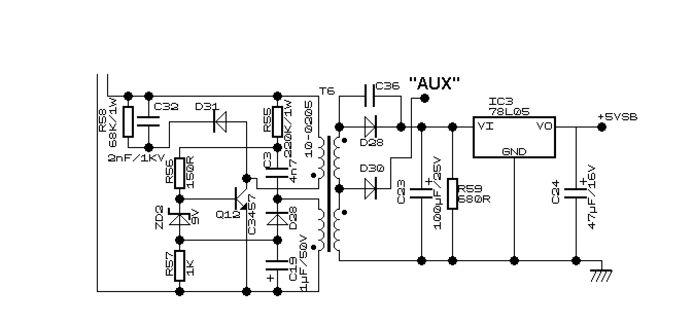

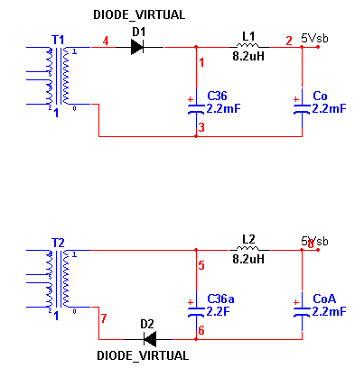

                    Looks like they're using a different mix in those output inductors. I'd like to say it's -52, but those are green with one face blue.
                    Do you realize that the 5Vsb diodes are 'backwards'? Look at my diagram. I left out the 4148(?) next to the rectifier as well as that SMT cap on the back of the board. Even though it's wired differently, the correct DC polarity is obtained. Almost like 'turning a circuit over' to switch from PNP to NPN transistors in the good old days.
                      Placing the diode in that configuration is rather common with 5vsb circuits. Look at diode D7 in the 5vsb circuit of the infamous Bestec mobo killer, the Bestec ATX-250 12E. This diode configuration is NOT what caused the psu to be a mobo killer, but the technique has been around a long time.
                        I know that. That 'important' cap would go bad and 5V would run away.
                        Starting bias is supplied through R55 and R56. Q12 starts conducting. The tertiary winding provides feedback via C3. After a few cycles, C19, C23, and C24 begin to charge up. C19 is the 'critical cap' and its rectifier is D28. Eventually, the voltage on C19 gets low enough to cause ZD2 to conduct. When that happens, drive to Q12 is removed and energy is no longer transferred to 5Vsb, AUX and tertiary. The ratio of the tertiary winding is such that just as the zener starts conducting, the AUX and preregulated 5Vsb supplies are of the proper voltage.
                        That's how these can regulate without an opto.
                        R57 is a load for D28/C19 and a return path for the zener. D31, C32, and R58 make up the snubber/damper.
                        In a two-transistor ckt, there is a resistor from Q12's emitter to the negative supply. Upon excessive primary current, the top of this resistor, "A," is high enough to bias the 2SC945 into conduction through resistor "B." This makes the main switcher fold back, limiting the current to that value that causes ~.7V drop across resistor "A."
                        When C19 gets high ESR, it can't charge fast enough. Therefore, the zener doesn't conduct and remove drive from Q12 when it should. Instead, the circuit has to 'kick harder' to get to the point where the tertiary voltage is high enough to make the zener conduct. But now AUX is 30-40 volts! Since there's a 7805 to 'regulate down' the 5Vsb in this particular supply, this continues until the 494 dies or the 7805 shorts. In those that take 5Vsb directly off the secondary, we end up with 10-15V directly into the motherboard. This is the very mechanism that makes this circuit run away.

                                  Is this a Bestec? What model?? Looks to me like the 3.3 volt line had a problem. I see two bulging capacitors and the 3.3 volt coil looks burnt.
                                  My complaint was capacitor C36 on the other side of the heat sink. Not sure about what Q36 is.
