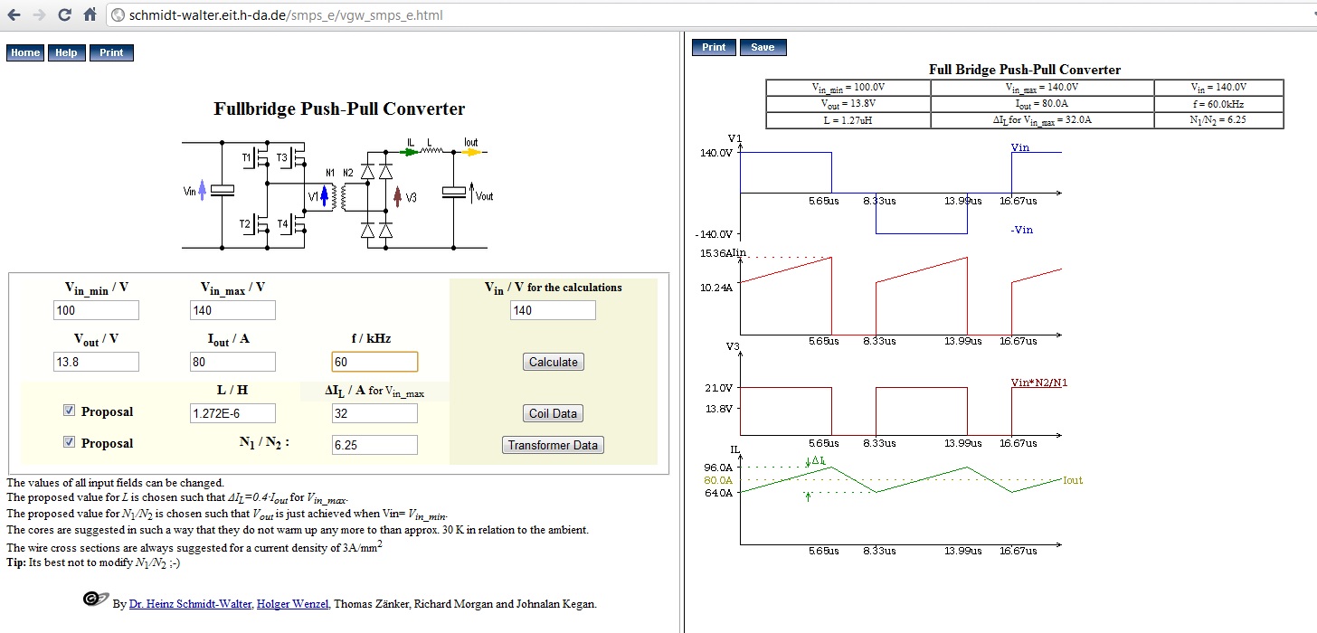

    I have started down many paths but what I really want to do it learn what is needed to build a SMPS for all my bench work and HAM radio equipment. I have an old ATX converted that I have used for years but its not going to be able to keep up before too long..
    I have read tons of forums and DIY/Homebrew sites but I still end up confused, no one seems to do Switch Mode..
    I found a link to http://schmidt-walter.eit.h-da.de/smps_e/smps_e.html and keyed some values in but I dont understand what those transistors are on the Primary side I'm attaching an image of what I put in there to maybe I can get a little help/lesson to get me going with a little more steam, I would really like to get one built and running my stuff so I can say I made that.

    Re: DIY Supply.. Trying to learn. any help apreciated..
    How much current does your equipment require?
    That's because SMPS is more complicated than the usual transformer, diodes/rectifier and voltage regulator stuff. You will need the proper coils/inductors/transformers, correct type of capacitors, switching transistors/MOSFETs and special diodes/rectifiers (usually Schottky ones). Thus its rarely used in DIY stuff.
    That's voltage full swing push-pull configuration (able to drive from full +Vsupply to -Vsupply). If you ever seen a car high power amplifiers using bridge configuration, its almost the same thing.

      HAM Radio 22A @13.8v
      Hobby Charger ~10A
      Misc stuff ~5A
      Future Amp for HAM ~40A
      So total and I know it wont all be on full all the time is ~77A so thats why I was shooting for around 80+ amps
      I have tons of old HP server power supplies that I can gut for heatsinks Rectifiers and Schottky diodes, and I'm no stranger to Digikey and Mouser.
      I have done through hole and SMD work via kits for projects so I have some solder skills, and I'm not afraid to etch my own boards.. I have used cadsoft and made a few small things.
      This is just a new dimention I have not dove into and I really want to learn and understand it..

        I have a calculator spreadsheet but for now it only deals with 2 transistor forward. Anyway, the equations i have used are mostly from "Switching Power Supply Design, third edition". That book will tell you just about everything you need to know. Marty Brown's "Power Supply Cookbook" is also good but it's kinda awkwardly organized. But you will find in there what you didn't find in the other, including one of the most critical topics of SMPS design - control loop compensation.

            One thing to note is that the wire diameter calculations in those books are WAY overrated. I have a calculator in the spreadsheet attached to the last post in this thread. This will realistically tell you what dissipation you can expect for the specified wire area, length, current and temperature rise.
            I can tell you one thing - for 80 amps you will need thick litz wire, so that you can keep the frequency high and number of turns reasonable (skin effect comes into play). I usually run my supplies at 100kHz effective frequency. For a half or full bridge that means you set the oscillator on the controller at 200kHz. For a forward topology you would set the oscillator at 100kHz. Both topologies are suitable for your power output - you don't see full bridge in PC power supplies rated for 1kW or more, just the double-ended forward converter. It's my favorite topology as well. Also a full bridge would need a specialized controller, for two transistor forward or half bridge you can grab a controller from almost any old PC PSU you have lying around.
            Unfortunately i didn't have time to supply the wire tables for the calculator as well so grab 'em off the internet. Oh and one more thing. If you go with the 2 transistor forward converter i'd suggest you use type 1 compensation ie just a single capacitor. This means your transient response is going to suck, but radio equipment is fairly constant in power draw so i wouldn't worry. Just use a fat capacitor bank and it will take care of things for you.
