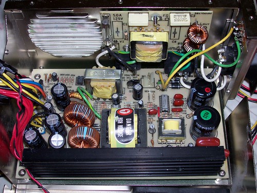

Is it bad practice or against any safety rules for a single heatsink to be used for both hot side and cold side components, even if the components are insulated from it with mica or silicone rubber washers? I ask because here's a 1980s UL approved PC PSU from Senstron that uses a single large heatsink for everything, and it doesn't seem to be junk:
