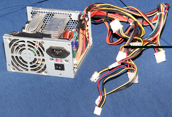

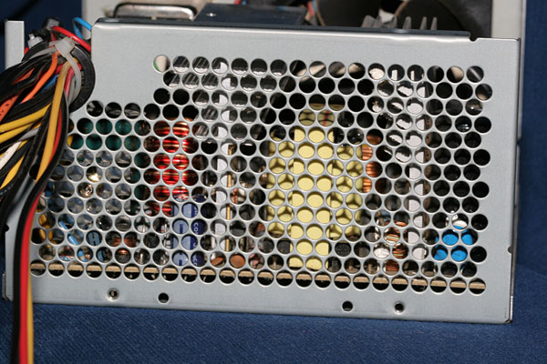

    Addtronics ENP-0735 350W. this was an impulse buy a while ago and i havent seen availability of these where i am since then. It is quite a heavy psu. My zalman went to the office to power my main pc cos 1 hdd more was too much for my pc there. so this was taken from my media pc to power my main pc. its 350w powers quite happily a 2.8 p4, 3 HDDs, 2 optical drives and 2x80mm case fans. i had forgot it was quite low wattage.
    Re: Addtronics ENP-0735 350W

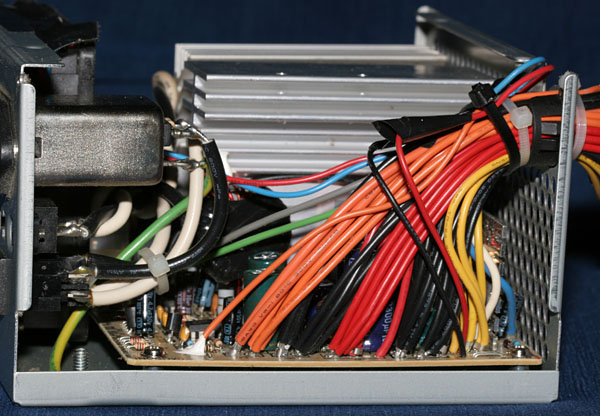

    the interior grille is nice, no restriction of airflow

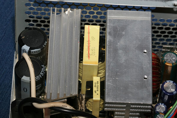

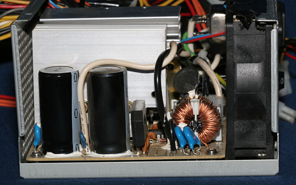

            Looks pretty well built to me.
            It appears to be an Enhance built unit, like the majority of Akasa and Silverstone units. I see a few Teapos in there... unfortunately I've also seen a few Enhance units with Fuhjyyu in them too

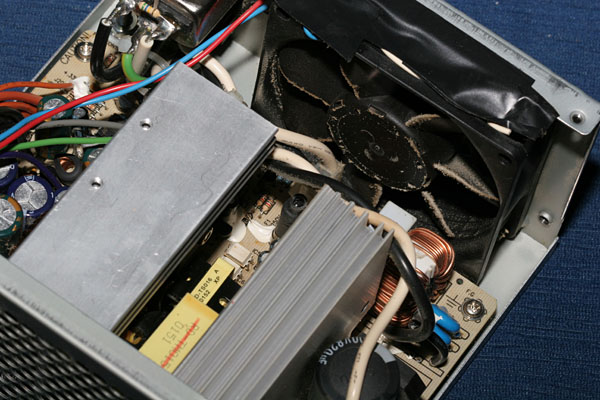

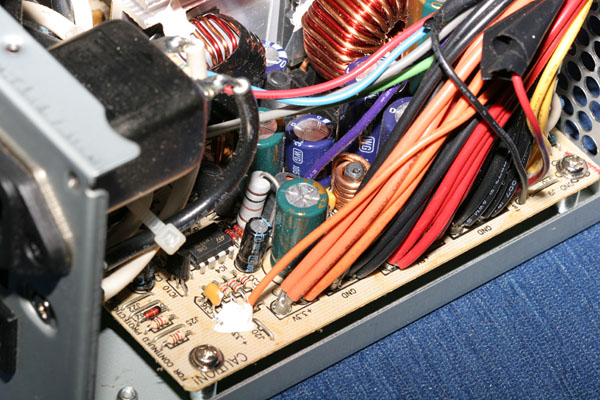

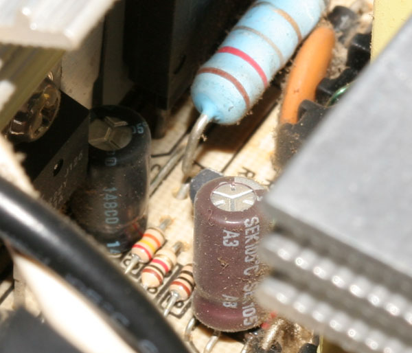

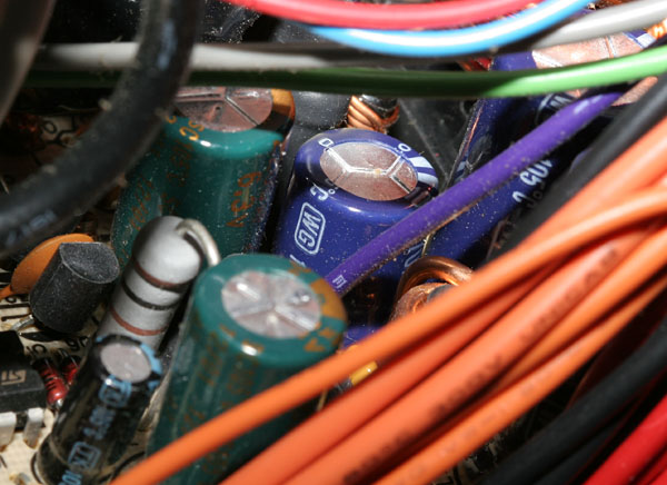

                jamicon and teapo only here. it is the second psu i have seen with jamicon. the large jamicon are WG series. there is one small teapo and the rest of the smalls are jamicon.

                    teapo 820uf 200v

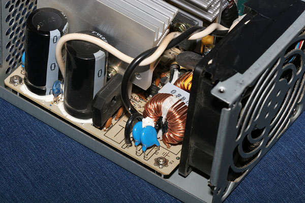

                        jamicon wg and tk series

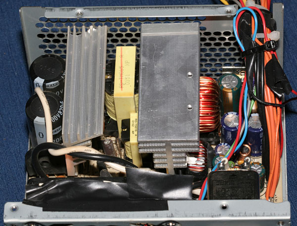

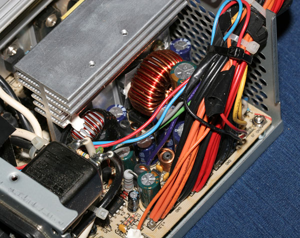

                          little teapo

                            yeah it looks like a good 350w. i think it is before the Fuhjyyu popularity. it is a few years old. i was suprised to see jamicon though which are good caps. the fan was originally an adda unit. i guess they gave it the full 12v. it was quite loud but not an unacceptable whirr which i just hate, it was simply pushing too much air. so i replaced with a papst and the sound is good, the heat is ok. good for them to spec a good fan though. "silent" fans leave me wanting for more and heat up the case too much.

                                      unfortunately i have figured that they specced a powerful adda fan for a reason. heat was ok loading with a northwood but now on my media pc with a celeron 2.66 prescott and similar components 3hdds, 2 optical it is VERY HOT!
                                      so i replaced temporarily the papst 8412 n/2gl with a pelko which is the most powerful fan i have, i use them on servers. they dont last long though. i also put another papst for case exhaust. seems ok now but not quiet anymore.....
