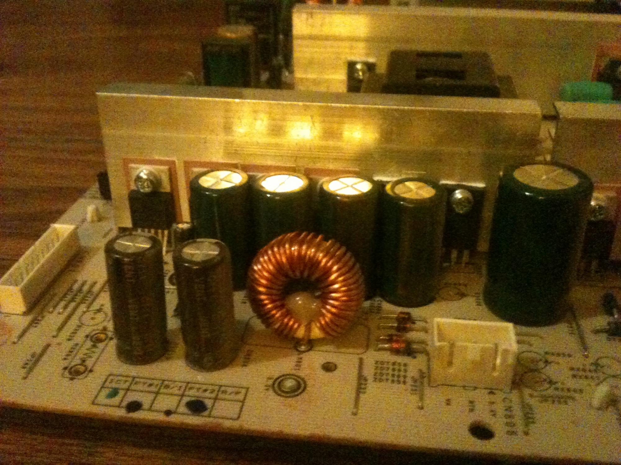

    I'm totally new to the forum so I do hope this is posted in the right section. Apologies if not. Basically my issue is my samsung plasma tv. It started radomly turning itself off then getting stuck in an almost boot-up like cycle. Sometimes starting up then 2mins later restarting. After a bit of research on the net I've come to the conclusion it is highly likely to be the power supply board and quite possibly a bad capacitor. I've removed the back of the tv and located the power supply board. I'm trying to find which of the capacitors could be the issue. None of them show the tell tale signs in which you describe as a bad cap. The only one I can see that is different is one that has a green stain on the top (only small stain). I know this is mainly for p.c's on here but I'm guessing the boards work around the same basic principles. Any help would be much appreciated or just a shove in the right direction.

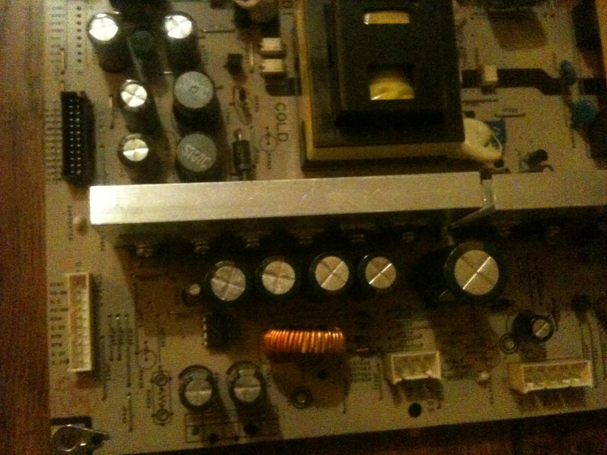

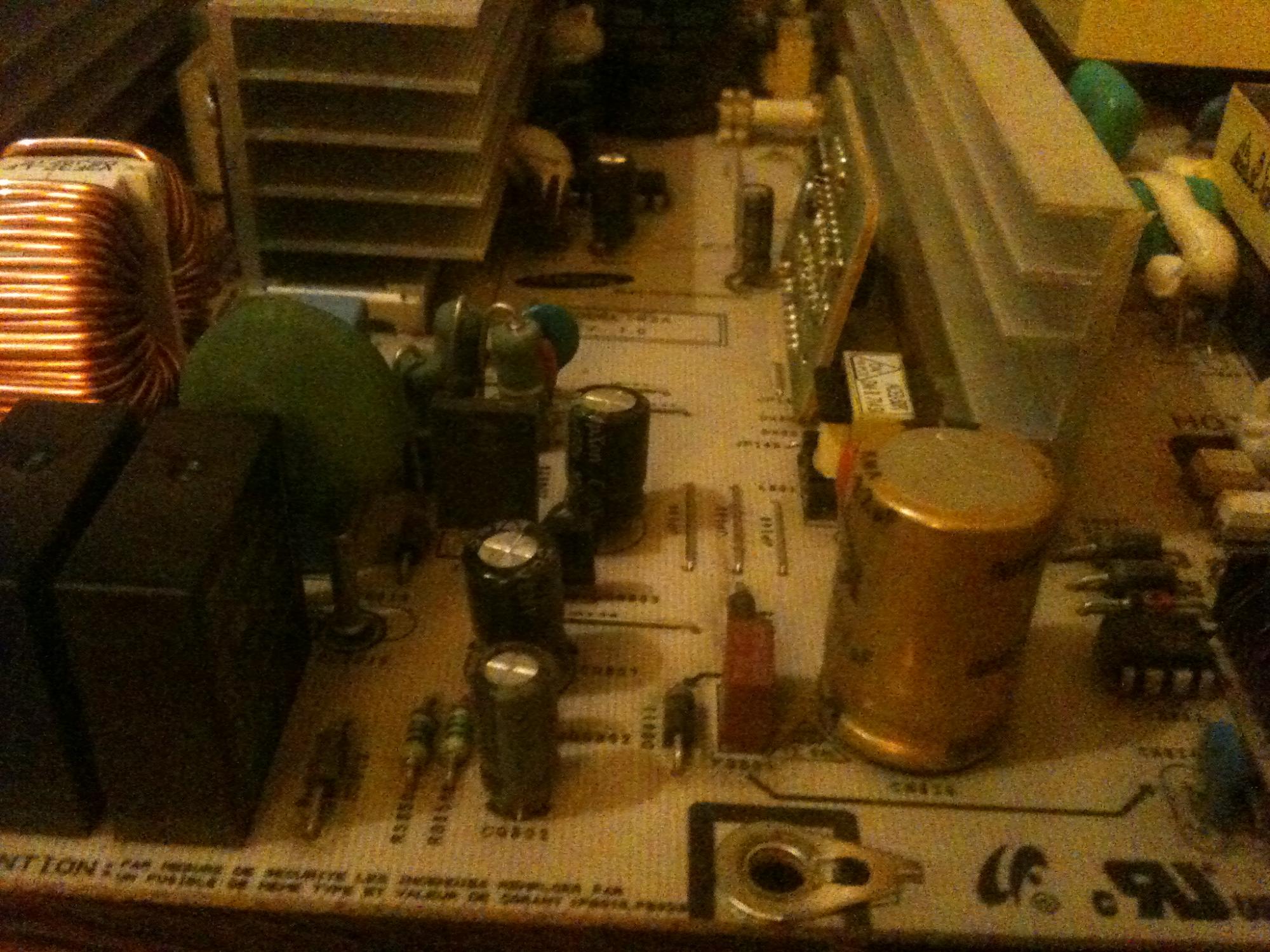

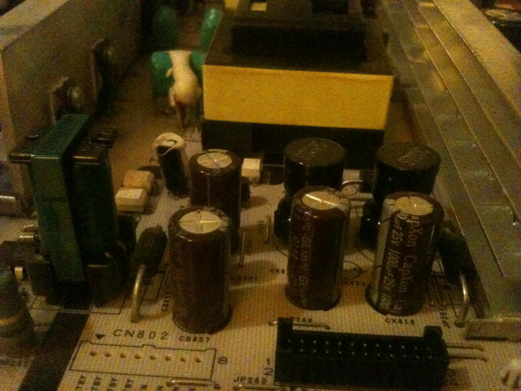

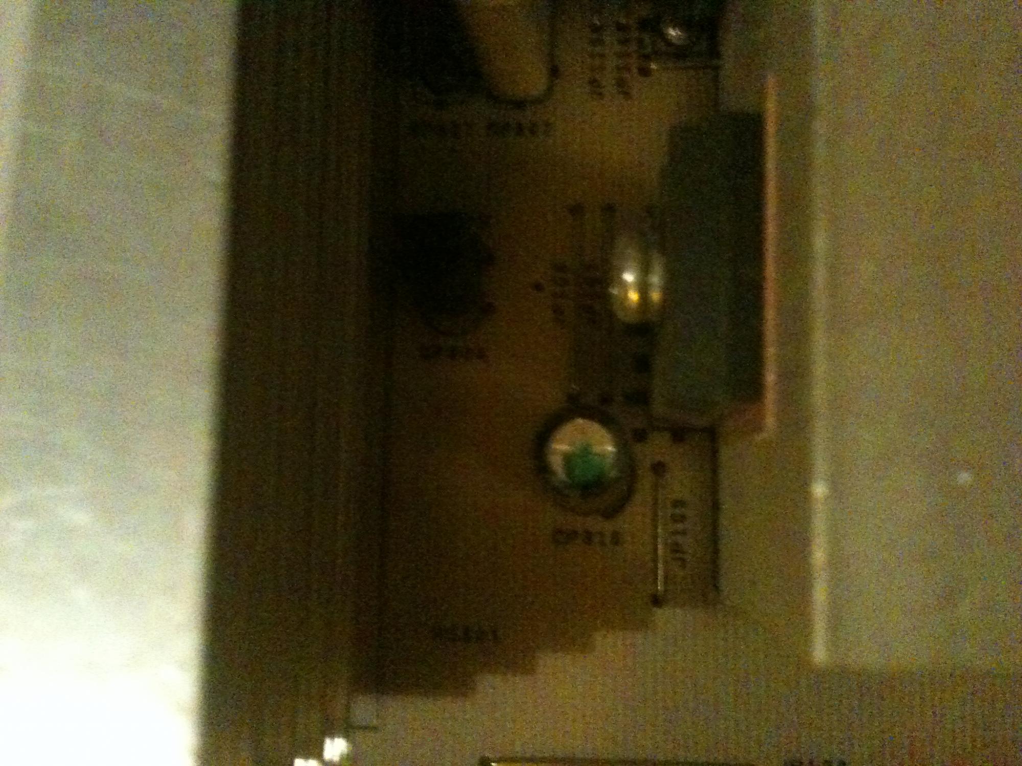

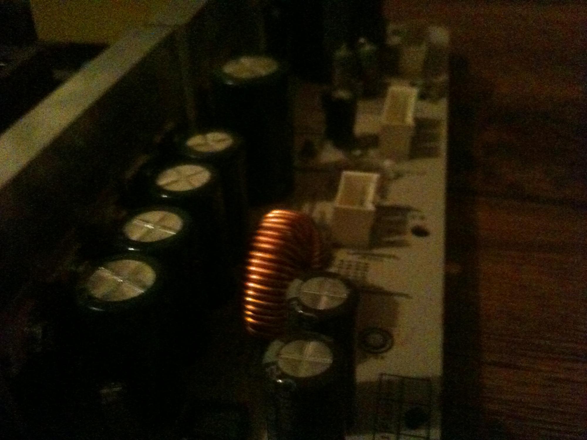

            here is the best i could get as ive only the iphone to hand. 330.jpeg is the one with green on it. sorry for last post it made no sense whatsoever

              CapXon...
              Eventhough they are not deformed or bulged if you will, replace them.
              Shame on Samsung for using CapXon. Darned Korean garbage.

                    From what I can see the only letters visible are GL

                      Originally posted by momaka
                      For CapXon KM use any of the following: United Chemicon LXY, LXZ, KY; Panasonic FC; Nichicon PW, PM, HE; Rubycon YXG
                      For CapXon GL: United Chemicon KY; Panasonic FK; Nichicon PM, HE; Rubycon PX
