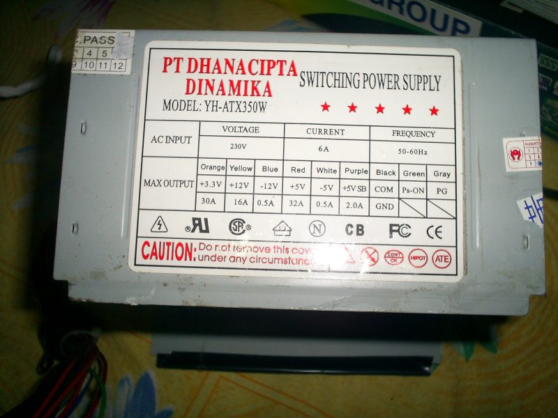

        #183
        Re: Power supply build quality pictorial
        YH-ATX350W
        (PT DHANA CIPTA DINAMIKA)
        All caps are Capxon. None are bulged/leaking.
        3.3v -> 1x 1000uF 10v
        5v -> 1x 1000uF 10v, 1x 2200uf 10v
        12v -> 1x 1000uF 16v
        Bridge rectifier diodes:
        2x RL206
        2x IN4007
        Regulator/controller:
        Daewoo DBL 494 (cooked)
        SEC KA7805 (on secondary heatsink)
        On secondary heatsink:
        SBL3040PT @ 5V -> 30A 40V rated schottky diodes
        MOSPEC F06C20C @ 12V -> 6A 20V rated schottky diodes (OMG, the PSU label says 16A!)
        MOROCCO P3020L (?)-> one leg connected to 3.3v and one leg connected to 5v.

            #185
            The +5V is rated for 32A, and the +3.3V is rated for 30A; and the +5V rectifier may be carrying the +3.3V current as well?!
            PeteS in CA

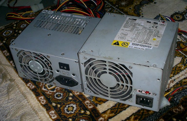

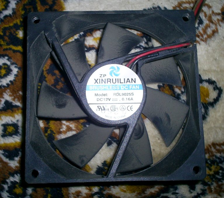

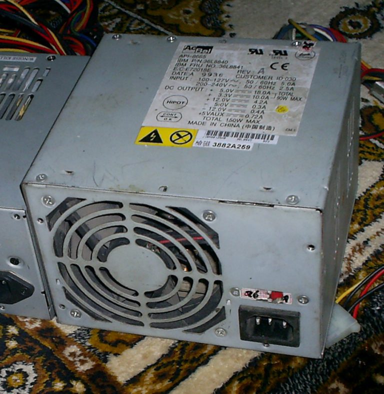

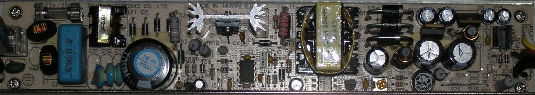

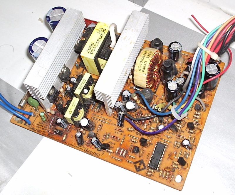

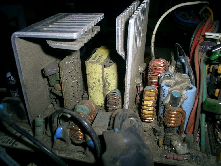

                          #192
                          Acbel API-8665 (150W)
                          With the thick dust everywhere it surely doesn't look empty.
                          days are so short when you actually do something..
