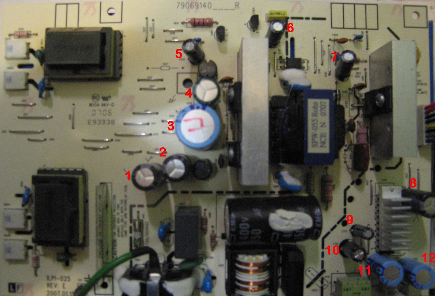

    I've had this for some time and I took out all of the caps when I didn't know better and now I want to know which caps and series come with this board.
    ILPI-025
    REV: E
    2007.01.15
    Anyone who is repairing this can you help me out?

          Can you list me also the brands and series for each cap:
          C501
          C817
          C815
          C818
          C820
          C827
          C807
          C702
          C713
          C701
          C707
          C705
          In total there are 13 caps on the board (Including the big primary cap).
          Much obliged.
          • mockingbird
            • Dec 2008
            • 5484
            Re: Optiquest Q9 Board "ILPI-025"
            Ok, here's a picture, I thought I could make it easier, since our board revisions are slightly different and the board numbering seems to be off:
            1) C501
            2) C817
            3) C815
            4) C818
            5) C820
            6) C827
            7) C807
            8) C702
            9) C713
            10) C701
            11) C707
            12) C705
            Ignore the capacitors that are there. I replaced them with inedequate parts when I knew no better.
              As promised:
              1) C501 - Su'scon 470uF 25V SG105°C 0705(M)
              2) C817 - Su'scon 470uF 25V SG105°C 0705(M)
              3) C815 - Su'scon 1000uF 25V SG105°C 0703(M)
              4) C818 - TEAPO 1000uF 10V SY105°C 0703 A3T1
              5) C820 - Su'scon 47uF 25V SH125°C 0701(M)
              6) C827 - Su'scon 47uF 25V SH125°C 0701(M)
              7) C807 - Su'scon 47uF 25V SH125°C 0701(M)
              8) C702 - Su'scon 470uF 25V SG105°C 0705(M)
              9) C713 - TEAPO 10uF 25V SH105°C 0643 A3T2
              10) C701 - TEAPO 220uF 16V SH105°C 0704 A3T2
              11) C707 - Su'scon 470uF 16V SK105°C 0705(M)
              12) C705 - Su'scon 470uF 16V SK105°C 0705(M)
                Thank you very much, I really appreciate it. Here are suitable replacements, all by Panasonic (Except for the primary), from Digikey, all in stock:
                1) http://search.digikey.com/scripts/Dk...name=P12388-ND
                2) http://search.digikey.com/scripts/Dk...name=P12388-ND
                3) http://search.digikey.com/scripts/Dk...name=P12379-ND
                4) http://search.digikey.com/scripts/Dk...name=P11203-ND
                5) http://search.digikey.com/scripts/Dk...&name=P5151-ND
                6) http://search.digikey.com/scripts/Dk...&name=P5151-ND
                7) http://search.digikey.com/scripts/Dk...&name=P5151-ND
                8) http://search.digikey.com/scripts/Dk...name=P12388-ND
                9) http://search.digikey.com/scripts/Dk...&name=P5161-ND
                10) http://search.digikey.com/scripts/Dk...me=P10370TB-ND
                11) http://search.digikey.com/scripts/Dk...&name=P5543-ND
                12) http://search.digikey.com/scripts/Dk...&name=P5543-ND
                And the primary, if you're interested in replacing it too:
                http://search.digikey.com/scripts/Dk...me=565-1481-ND
                Highest length I went was 20mm, which is the height of the two larger heatsinks, so they should fit just fine.
                On my board C701 is "Suscon SK" not "Teapo SH". I still have that one original on my board. Not to worry, they're both general purpose caps anyways, most likely interchangeable, all I had to do was either match or slightly exceed the ripple with a higher quality part.
                  I found the caps I removed, it appears that they did indeed use the Teapos and Suscons interchangeably (And probably why yours lasted longer than this one - a testament that Teapo is in fact superior to Suscon). Just to compare to your list:
                  1) C501 - Su'scon 470uF 25V SG - 10mm x 17mm
                  2) C817 - Su'scon 470uF 25V SG - 10mm x 17mm
                  3) C815 - Su'scon 1000uF 25V SG - 13mm x 20mm
                  4) C818 - Su'scon 1000uF 10V SG - 10mm x 17mm
                  5) C820 - Su'scon 47uF 25V SH - 6.3mm x 11mm
                  6) C827 - Su'scon 47uF 25V SH - 6.3mm x 11mm
                  7) C807 - Su'scon 47uF 25V SH - 6.3mm x 11mm
                  8) C702 - Su'scon 470uF 25V SG - 10mm x 17mm
                  9) C713 - TEAPO 10uF 25V SH - 5mm x 11mm
                  10) C701 - Su'scon 220uF 16V SK - 6.3mm x 11mm
                  11) C707 - Su'scon 470uF 16V SK - 8mm x 11mm
                  12) C705 - Su'scon 470uF 16V SK - 8mm x 11mm
