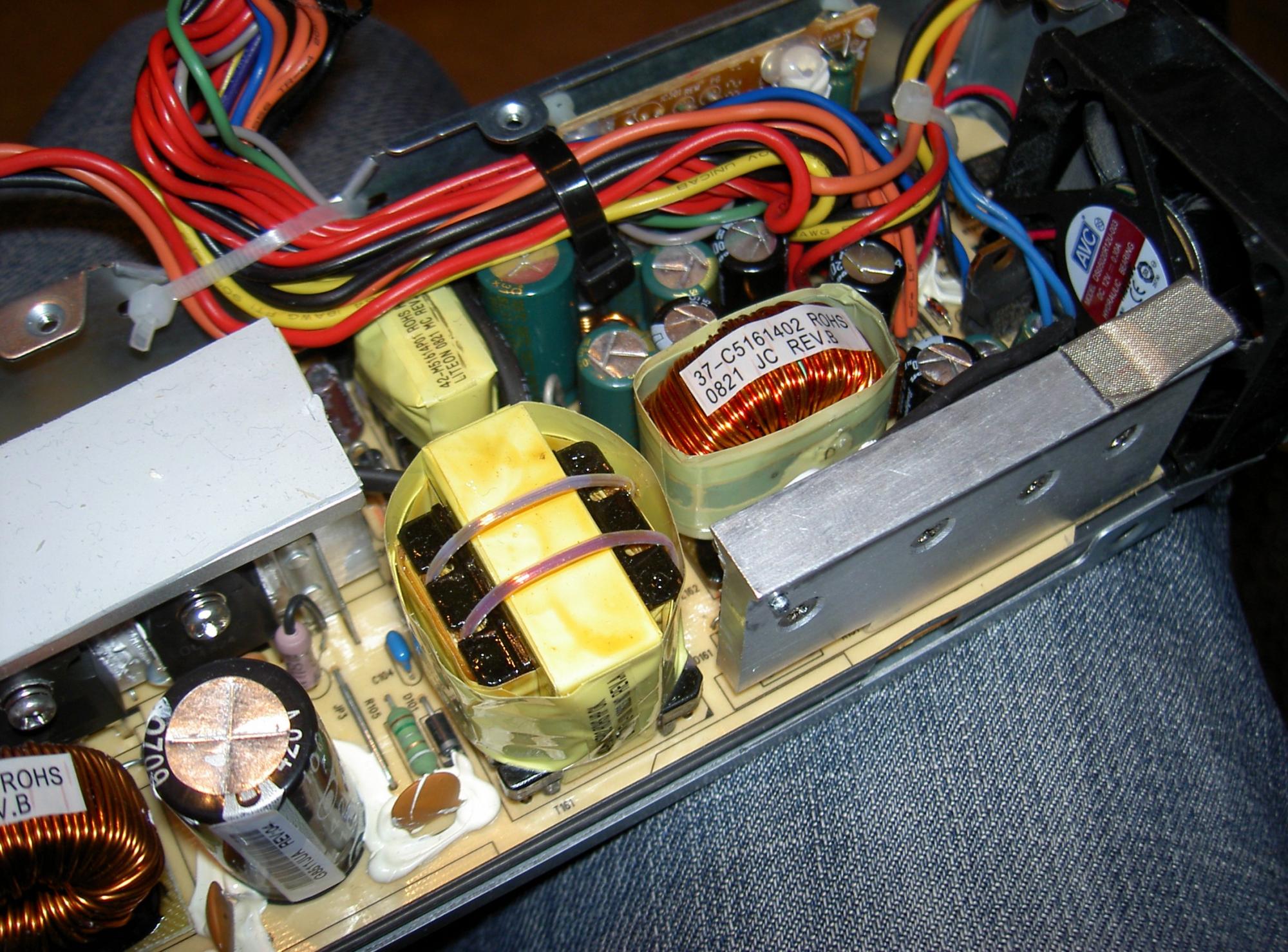

    Hi, here is a PSU from a HP Pavilion Slimline S3522SC
    It's a really small nice HTPC doodad with a Intel Pentium Dual-Core E2180 2,0GHz S775, so therefore heat output in the system is a problem...
    It has OST capacitors in the PSU and they have been baked well by it...
    5VSB was at ca 3.3v when I got it. (Thankfully it went low instead of high).
    Just for testing I replaced the bulging 3300uF 10v cap in the 5VSB circuit with a Sanyo WX 3300uF 10v.
    (Similar ESR and Ripple, size is 12.5mm wide vs 10mm of the original OST but it is not a problem because this capacitor spot was made to fit a 12.5mm capacitor).
    After this the 5VSB was happy at 5.1v, and the system was able to POST.

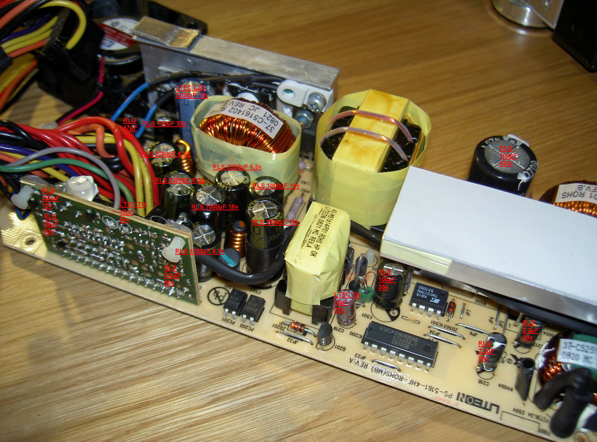

    Now there are more bloated caps, and I will replace them of course.
    But I am curious about one thing, the small caps, I can't find any suitable replacements for those.
    The originals have quite low ESR, but the variants from Sanyo, Rubycon and Samxon seem to not even list ESR? (General purpose I guess?)
    So did OST just lie when they made their spec, or I really need to find these caps?
    Only thing I managed to find was Sanyo OS-CON 30v, they have better ESR and Ripple, but of course they would need to be rated 50v aswell!
    Or would it be ok to go up in capacitance, to say 22uF 50v where we find Sanyo WX & Rubycon ZL with exact same ripple and ESR as this OST cap? (crap?)

    Well I've recapped it and it works
    I left the 2.2uF, 3.3uF caps alone, as I could not get a definitive answer on if their specs are real or not (I also left the 10uF caps alone)
    BigPope asked me to measure them, but doing so would require desoldering them and then I would not have been ok with soldering them back in again
    Here she is all dressed up in Sanyo, Suncon and Rubycon
