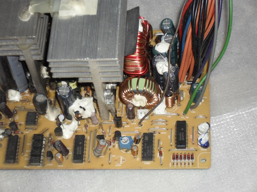

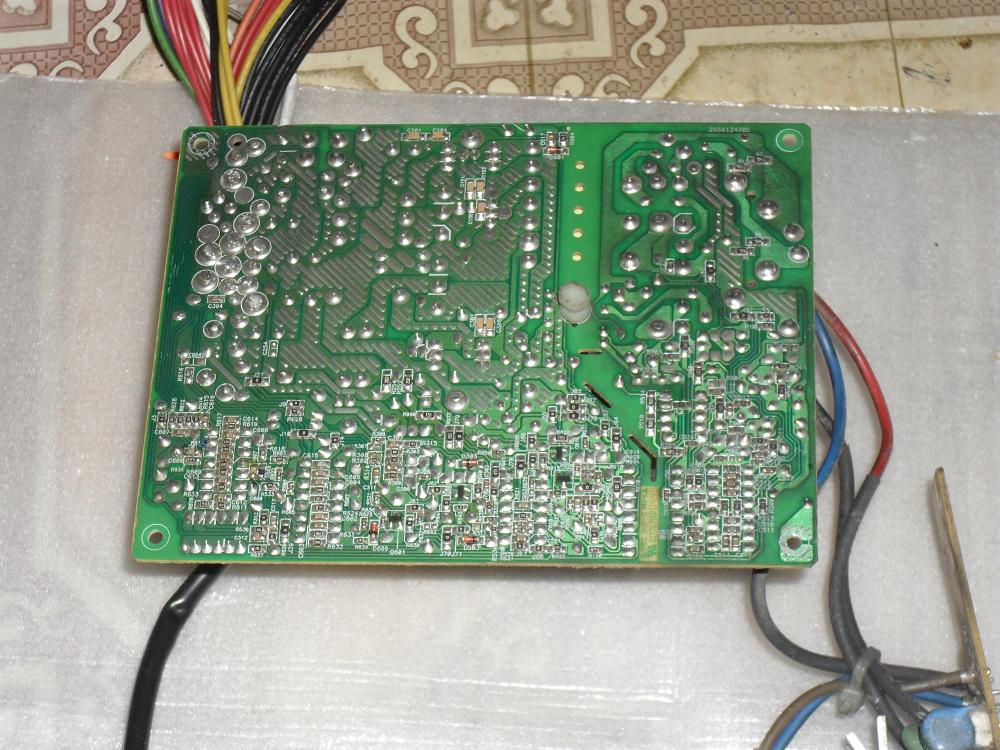

    hi there..i'm newbie here..

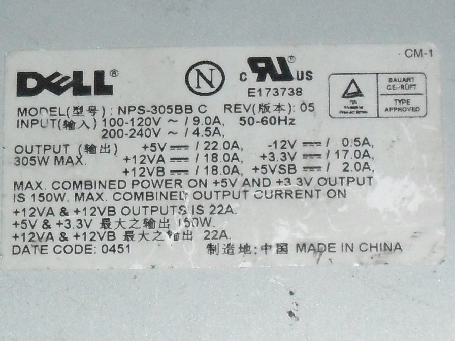

    i have a DELL NPS-305BB psu..and i want to ask some question..

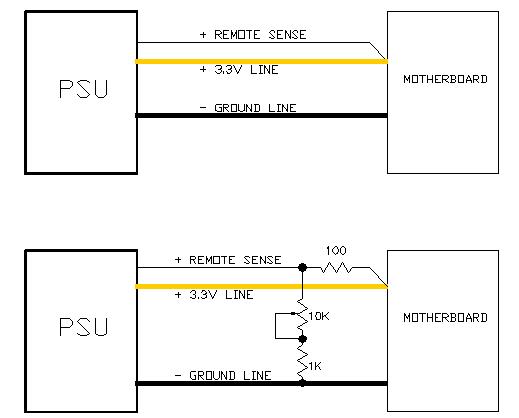

    1. i do 3,3v sense mod with 47ohm fixed resistor and 10k vr through vsense cable, but theres no voltage change from 3,3v line..any sugestion?
    the VR is set for max resistance, and when decreased the voltage still constant 3,3v

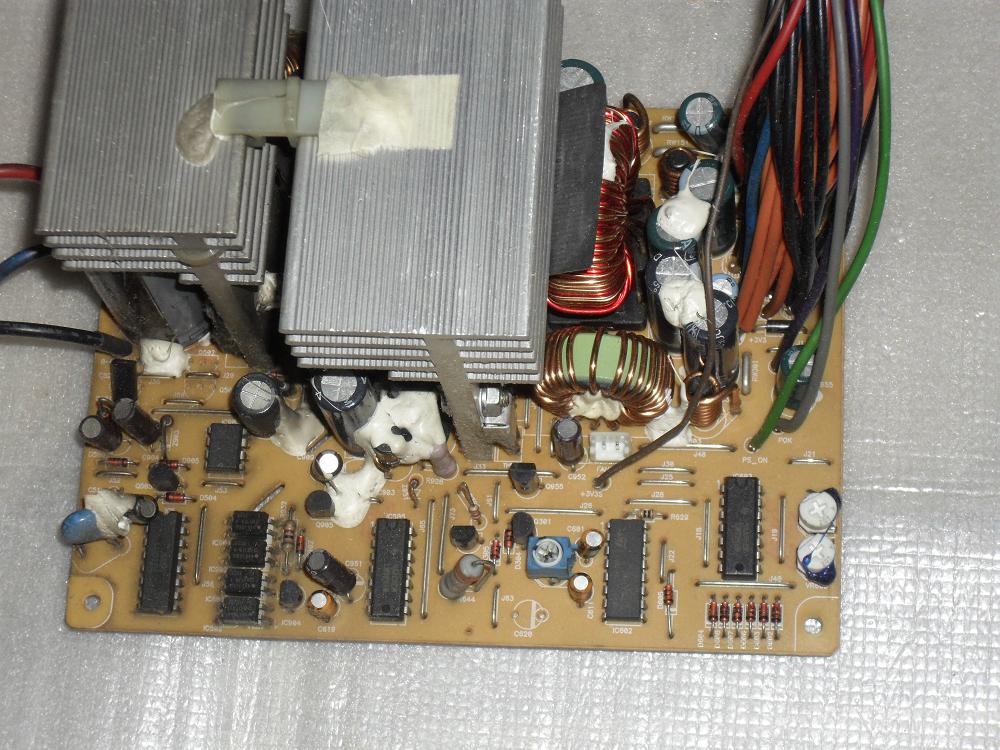

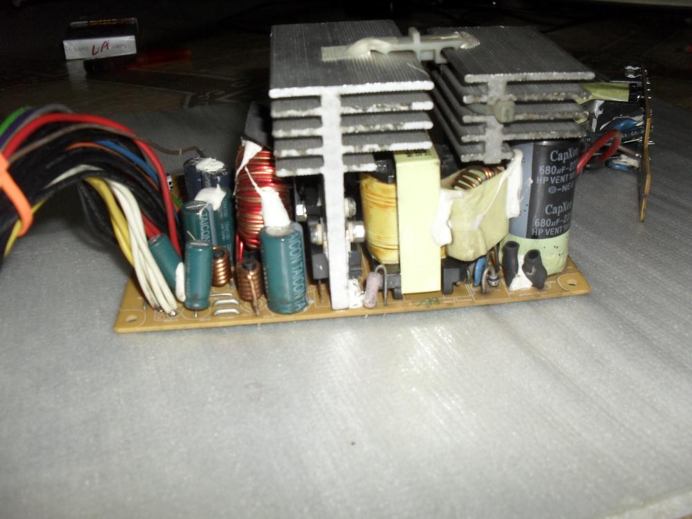

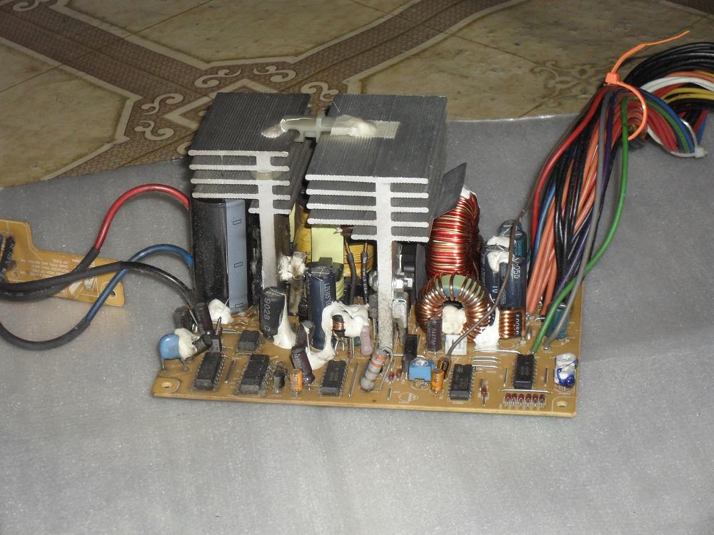

    2. this psu is about 3 year old..the caps is CAPXON in primary and full of TAICON in all over secondary and filtering stage..how well is this caps in the psu ??

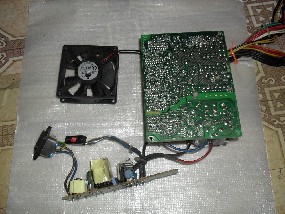

    the pic of psu is on atachment..
    thanks for your attention..

    Re: (ask) DELL NPS305bb 3,3v sense mod no go..
    looks like a Delta but numbered like an NPS. Built in 2004 i believed.
    This particular one is sensing from +5vsb.
    Delta and NPS are good PSU.
    NB: I have one which needs complusory replacement of a taicon cap for start * search the forum for more clues
      its a NEWTON POWER actually i guest..from the UL number are dell corporation..if its a delta, i believe the model start from DPSxxx..but this is NPSxxx..
      There's a pots near the 3,3v sense cable (thin brown cable), the blue white one, if i adjust this pot, it affect in 12v and 5v line only..and another two pots near the edge (the white one) that i don't know for..

                    Originally posted by holmes222
                    i do use the jumper to get vdimm from 5v line..but the dram mosfet regulator getting so hot..to eliminate that, i want to use the jumper trick based at XS that need to overvolt the 3,3v line up to about 3,5v..
                    yes, the mosfet very hot when use vdimm from 5V. the PCB was burnt on my mobo.
                    try following circuit, could be usabled.

                          POM_MJ's schematic is essentially what xtremesystems.org has as instructions, sans schematic, with these differences:
                          - there is no 1kΩ resistor in series with the pot
                          - the inline resistor is 47Ω, not 100Ω
                          Accordingly, you should see a voltage variation on the sense line to the power supply of between 3v and 3.27v. As you adjust the pot, the 3.3v should rise to compensate for the voltage decrease on the sense line. Start the pot at MAXIMUM resistance and adjust down from there. Monitor that 3.3v line carefully.
                          You may damage the motherboard and the 3.3 VRM with too much voltage.
