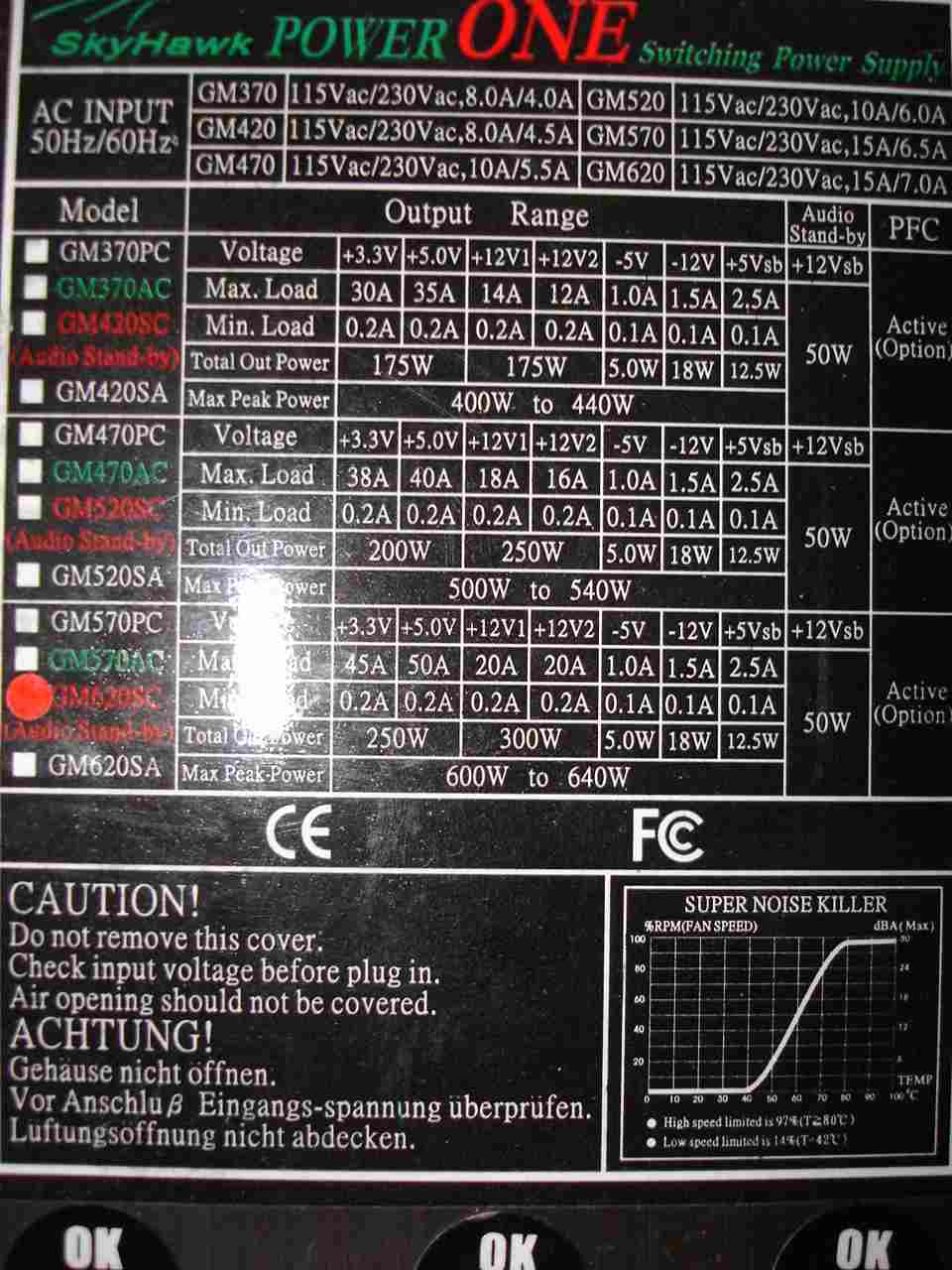

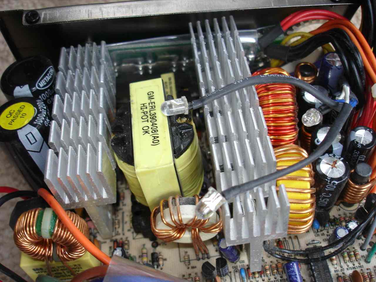

    Got this in a box of parts that I bought
    Felt quite heavy, was surprised to see it's a SkyHawk - last SkyHawk I had, just about needed tethering to stop it floating away
    What's your opinion of its quality, or otherwise ?
    I'm planning to replace the bulging secondary caps, then connect it up to a motherboard and etc. that don't have much value

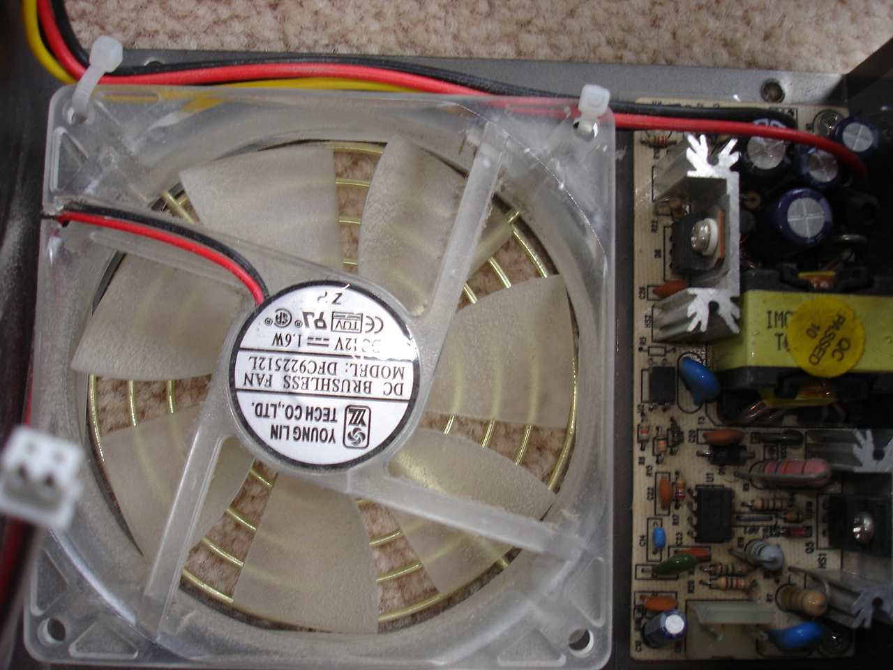

    This is its cover assembly, showing the second fan

      Skyhawk designs (most) of their own units. Expect it to do 400W pretty well in spec, might be able to do 500W for a bit but ripple would probably skyrocket and voltage stability might suffer.
      • Th3_uN1Qu3
        Believe in
        • Jul 2010
        • 6031
        • Romania
        Re: SkyHawk Power One

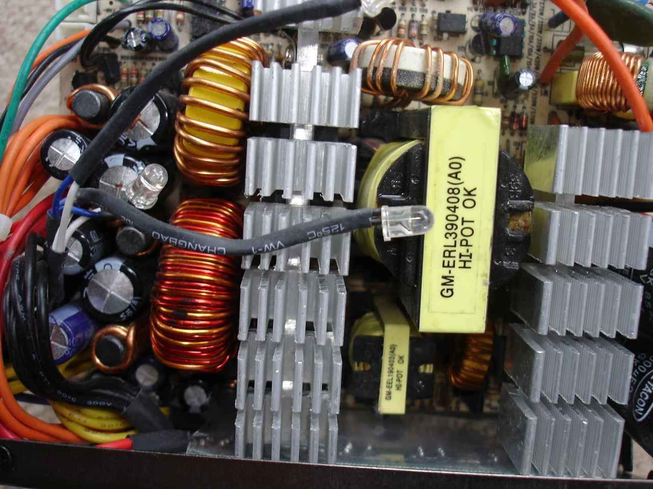

        The filtering looks quite healthy and the main transformer is big - i'd say with good quality cap replacements it'll do 500W in spec.

            I'm sure I had a CIT 450W with the exact same heatsinks...

              Isn't this actually a Solytech? - L&C/Deer/Allied/ et. al.

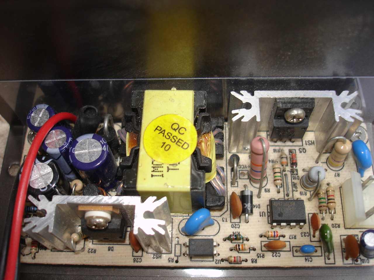

              What is the board next to the 2nd fan? Pics please.

                Skyhawk designs and builds their higher end units, their low end units are hardly designed though. Just the general leadman/sunpro look-a-like gutless wonder units.

                  Hope this satisfies your curiosity
                  Tom's Hardware review mentions an audio standby feature - "You insert an audio CD into the CD-ROM drive. After pressing the drive's play button, the CD is played back via headphones or speakers connected to the slot plate."
                  The cable coming out of that board has a Molex connector on the end, presumably to provide always-on power to a CD drive

                    Excellent! Explains the "Audio Standby" column on the spec plate.

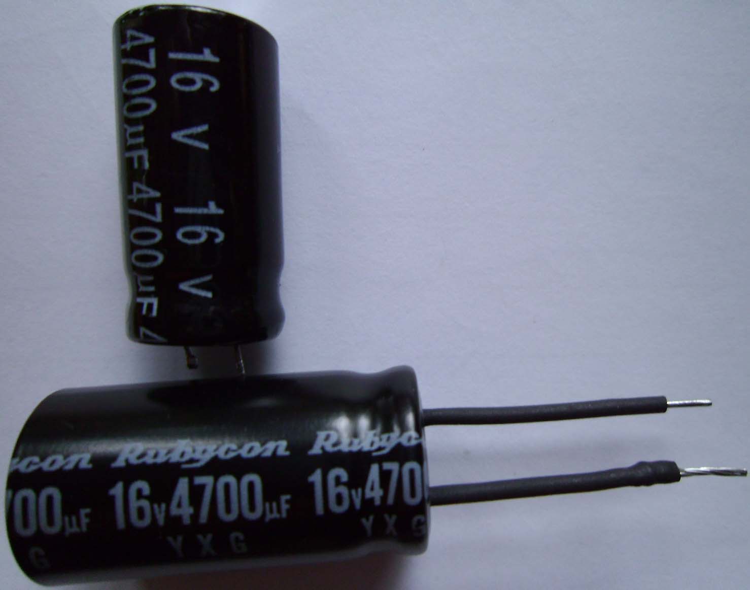

                      I replaced the 5 bulging caps with ones recycled (and tested) from scrapped motherboards
                      2 x 3300uf 10v GL replaced by Panasonic FJ 3300uf 6.3v
                      2 x 4700uf 10v GL replaced by Chemicon KZE 4700uf 6.3v
                      1 x 4700uf 16v Metacon replaced by Chemicon KZE 4700uf 6.3v
                      The last one was carelessness - only when disposing of the old caps, did I notice one was 16v instead of 10v
                      That replacement didn't do anything horrible after about half an hour of testing
                      What's the worst that could happen - just the capacitor fail, or something more serious ?

                        you could have been luck y and it was on a 5 or 3.3v rail. unless you know for certain i would still change it out thouhg!

                          The cap will fail shortd if overvolted. This will cause the PSU to shut off.

                            or blow up if its crp

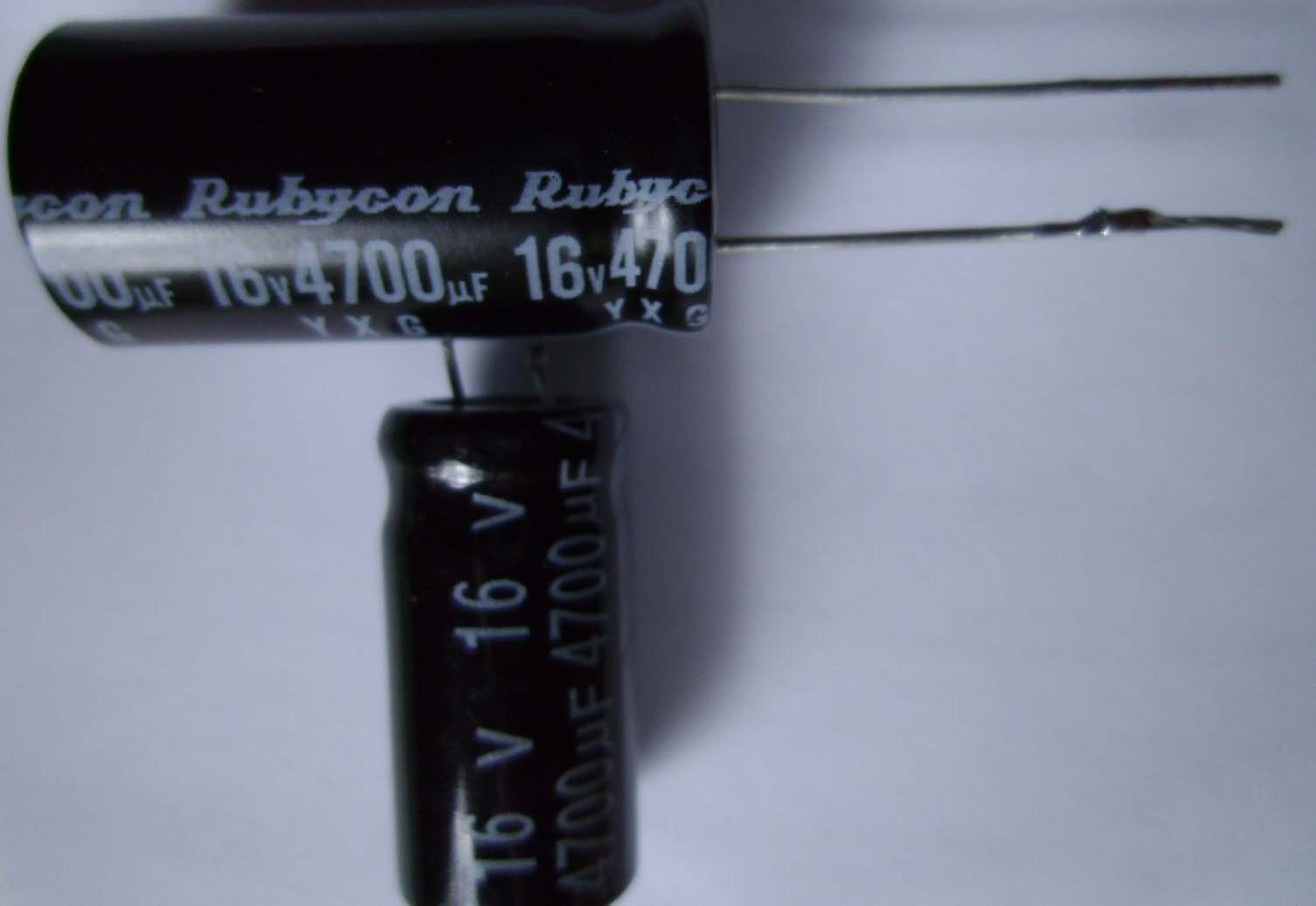

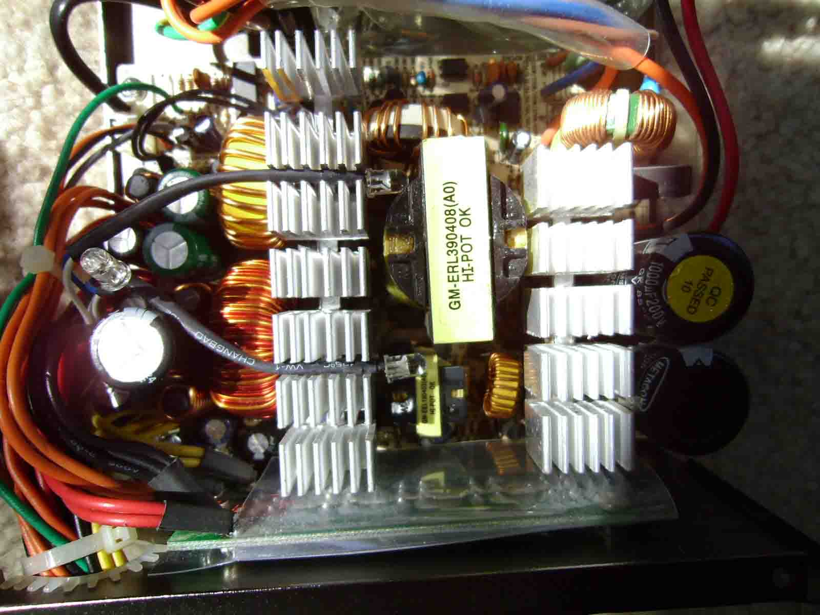

                              I finally got around to replacing the 4700uf 6.3v cap I'd put in, where the original was 4700uf 16v
                              Trouble was, it wouldn't fit - the positive lead could get to the PCB, but the negative couldn't
                              I hope the electronics gurus here aren't too horrified, but I chose to extend the negative lead

                                Then put shrink tube over the two leads

                                  Here it is, dominating the area, but it works
                                  No wonder the original didn't last - contrast its size with the replacement in previous two postings' pictures
