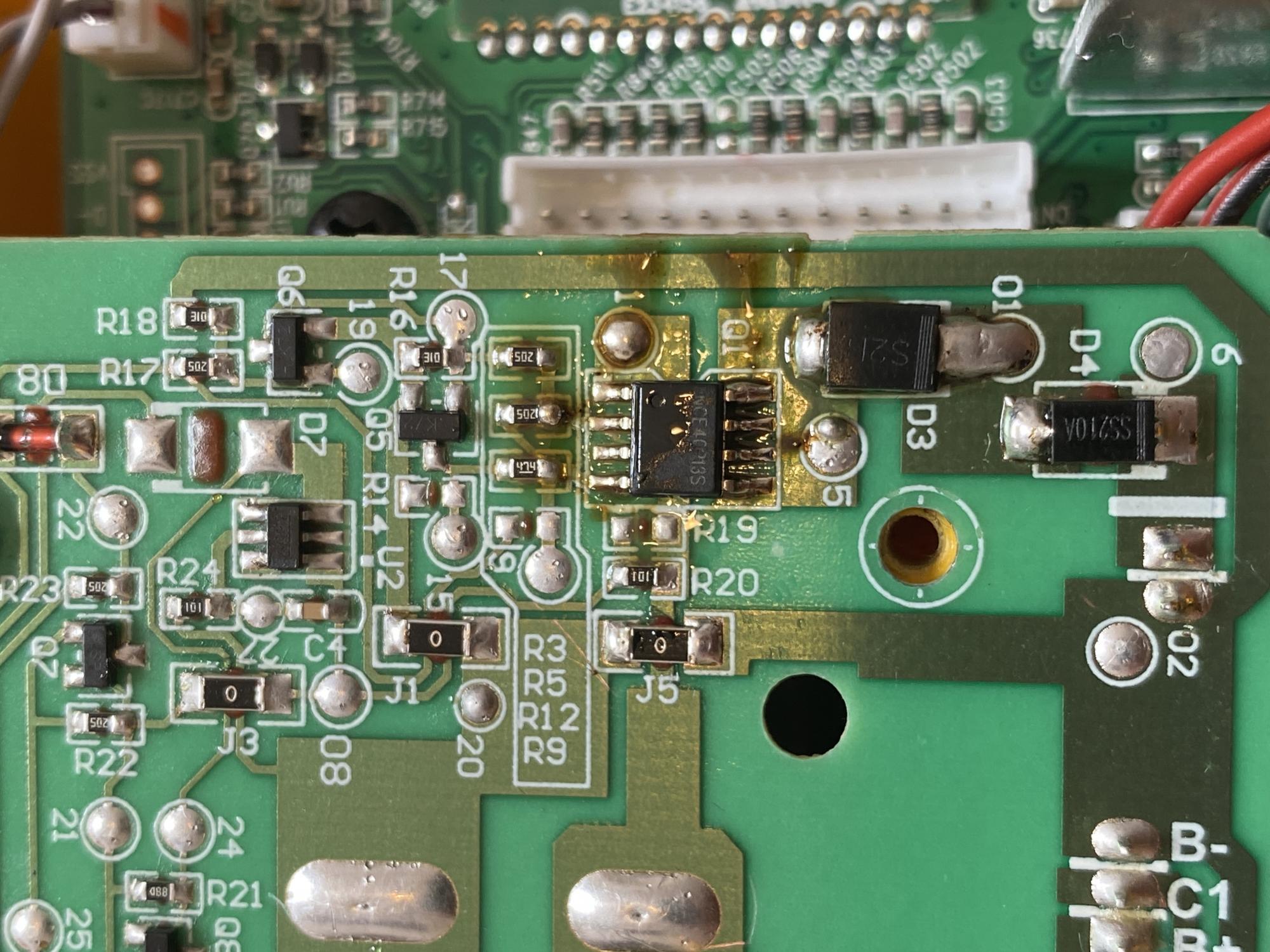

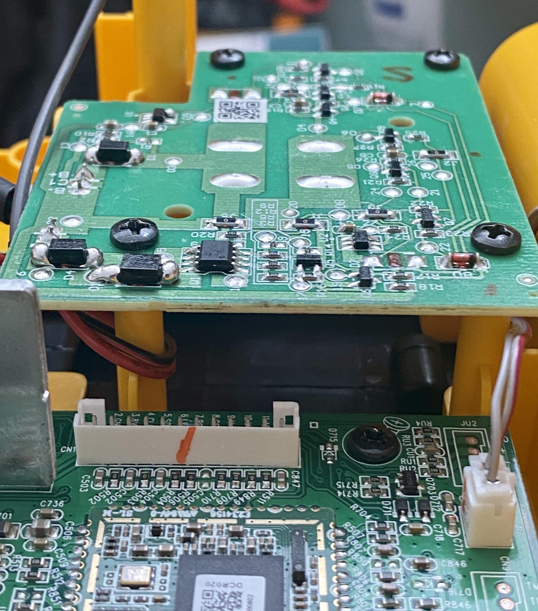

    Hi hoping you can point me in the right direction
    Powerboard not outputing voltage to main board.
    Looks like battery voltage comes in and runs through a battery discharge protection circuit triggering a P-Channel Mosfet NCE40P13S for output to main board.
    Uses C3 pin on battery which I think is one of the cell voltages
    Input from battery is 20V fully charged
    Seems like there is full battery voltage at the gate of the mosfet, nothing on the drain and full battery again on the source which doesn't seem right.
    The two diodes on the output of the mosfet seem to be ok.
    Some of the solder points look balled - but compared to other boards ive seen this seems to be common or from factory?
    Any tips on fault finding and understanding the way this circuit works please would be appreciated.

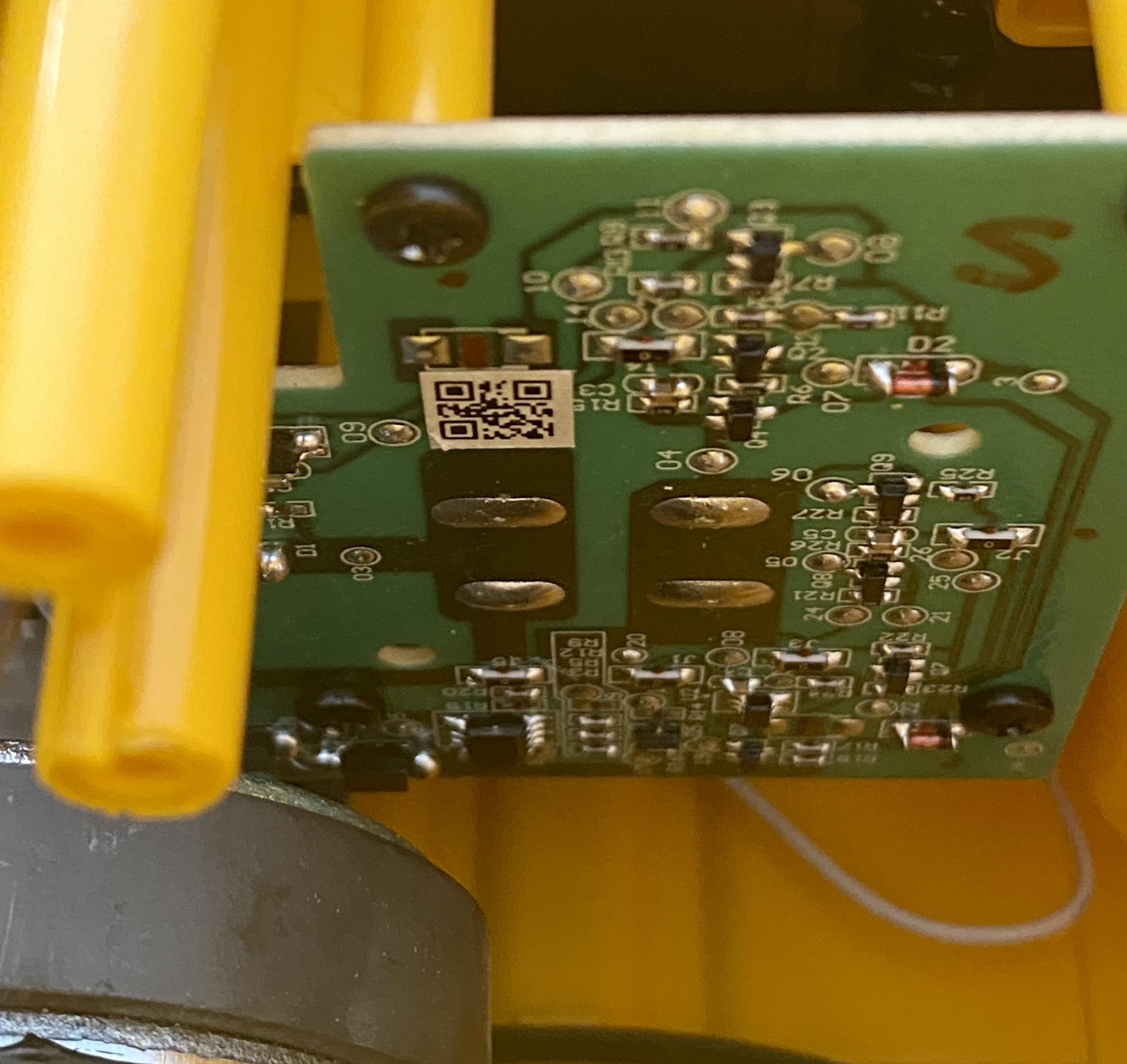

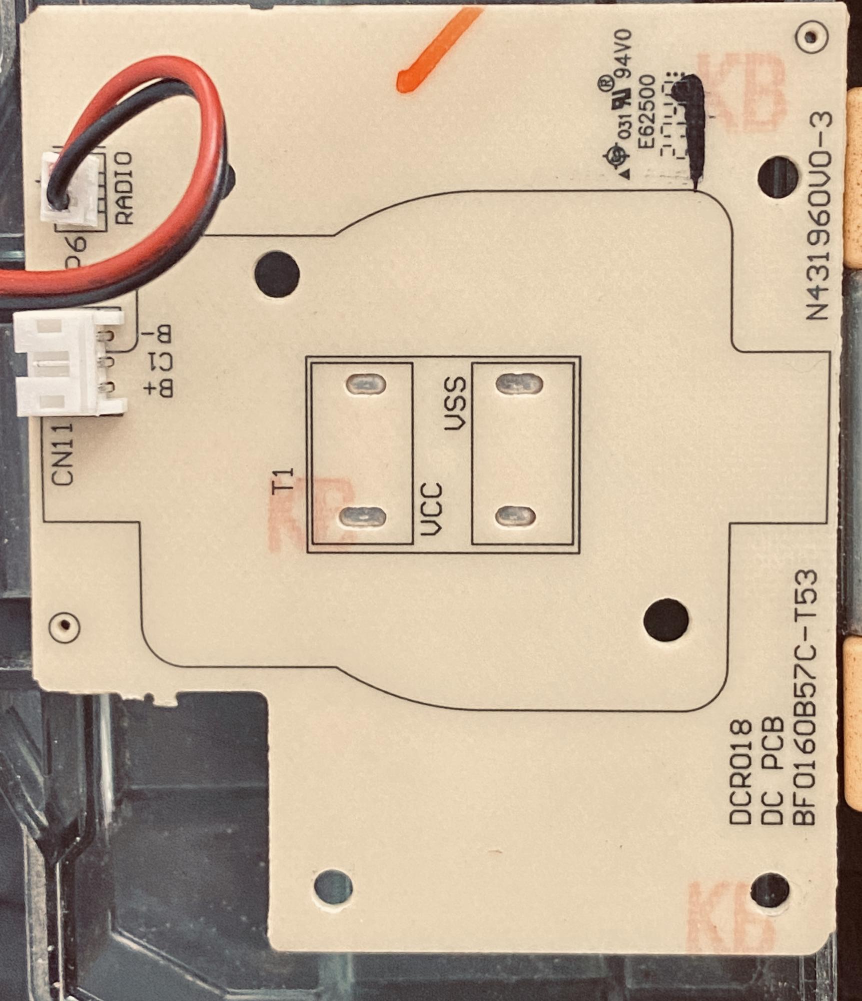

    what are the 4 large center pads for?
    i can see something was pressing onto them.

      Re: dewalt battery powered radio - no power at board
      Nothing, test points?
      Here are images of the reverse of the bird and also the board in situ showing no contact with anything else

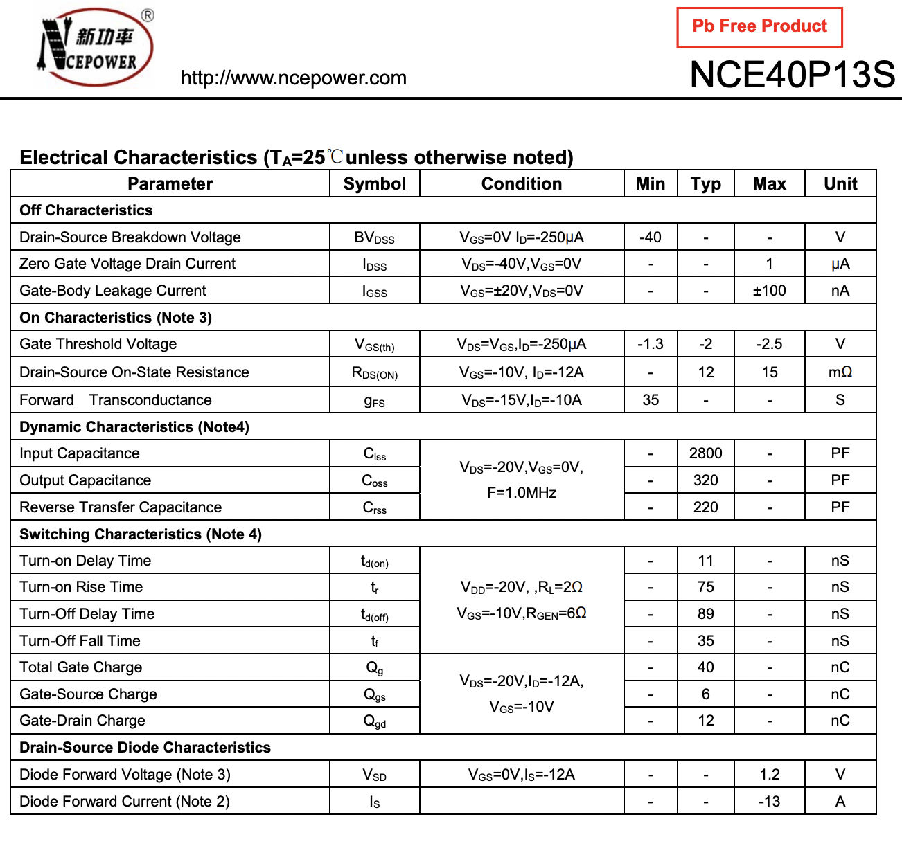

          The fet needs a differential between gate and source to turn on - spec says typical -2.5v
          Tested it has battery voltage at both

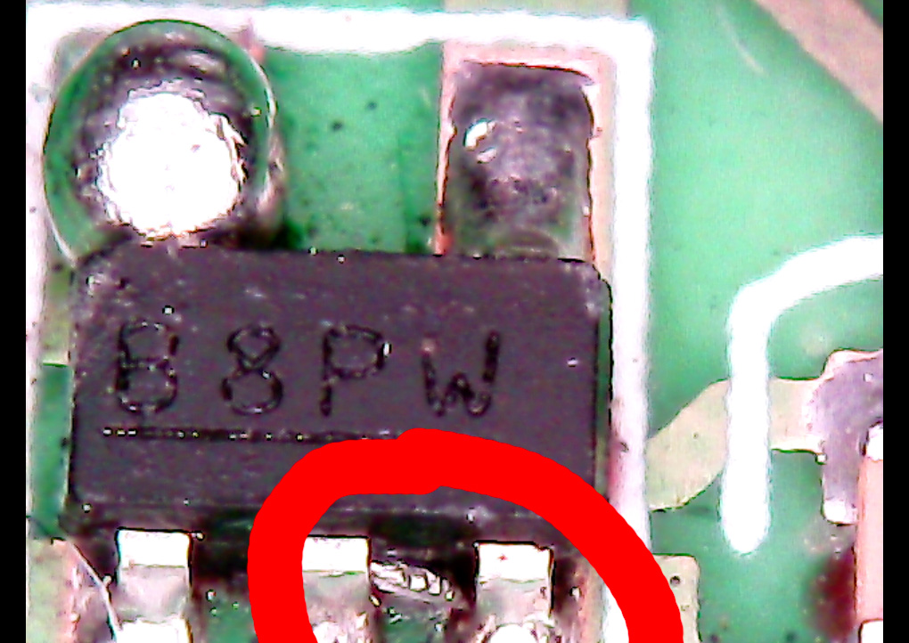

              all resistors look sensible values

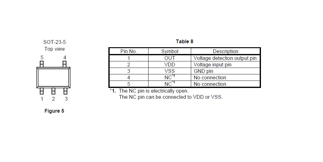

              found short between two pins of the little (sop25?) 5 pin ic
              re flowed and removed the short but still not joy
              anyone know what this ic is and what its doing?
              Marked B8PW but google isn't having any joy

                  It seems to be a S-80830CNMC voltage supervisor 3V , pin 2= Voltage input pin 3= ground

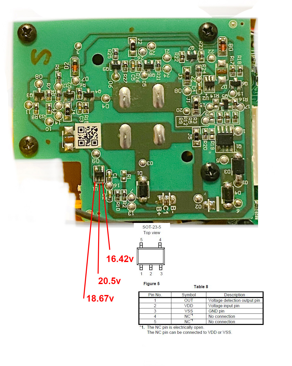

                    maybe do some measurements on these pins
                    Seem to be same as initial measurements
                    on a fully charged battery >
                    pin 1 - 18.67v
                    pin 2 - 20.5v
                    pin 3 - 16.42v
                      ahh interesting
                      if thats correct it would make sense that it uses the differential between battery + and pin c3 on battery to detect single cell voltage and cut off if below 3v?
                      on a fully charged battery I have >
                      pin 1 - 18.67v
                      pin 2 - 20.5v
                      pin 3 - 16.42v
                      Vdet is essentially 4.1v in this case referenced to battery pin c3 rather than battery negative - and I'd expect VOut to follow Vdet which it isn't?
                      The short I had between pin 1 and pin 2 shouldn't have caused a problem other than turning it off - is that correct?
                        try measure voltages using pin 3 as reference .
                        • geoff69
                          • Dec 2019
                          • 14
                          • uk
                          in which case we have
                          4.1v VDD Pin 2
                          3.7v OUT Pin 1

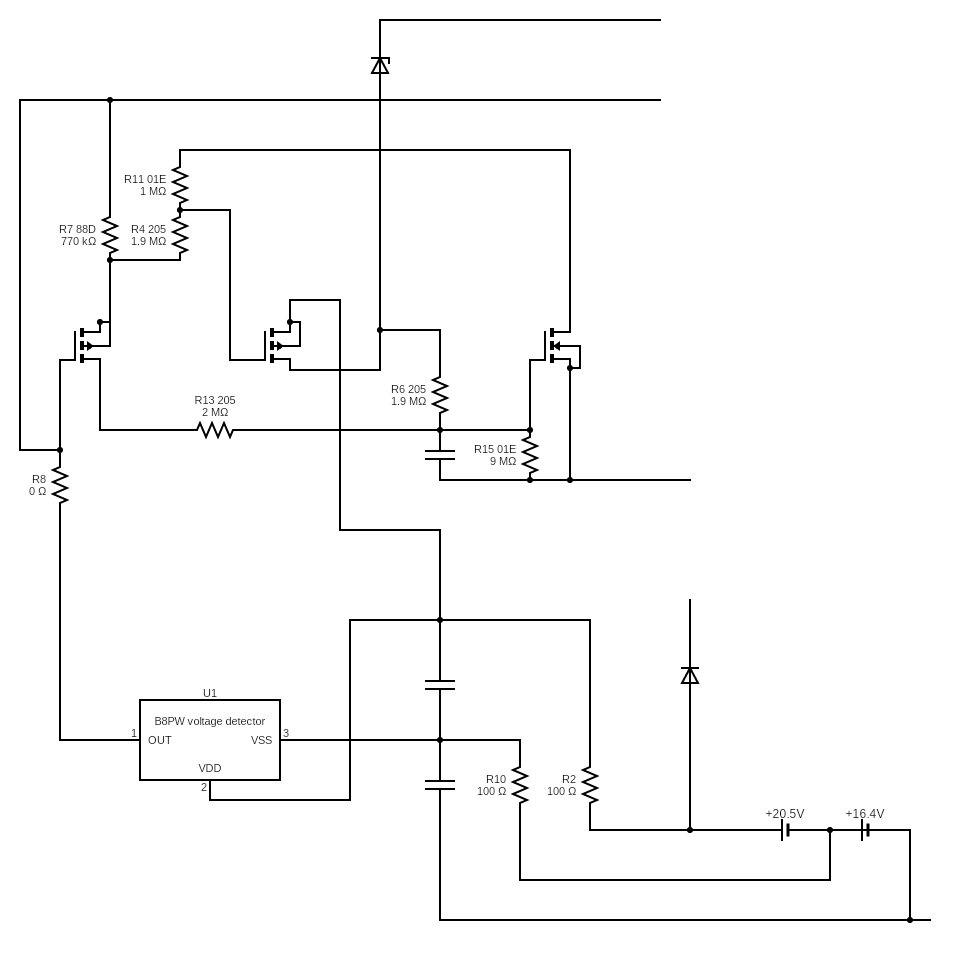

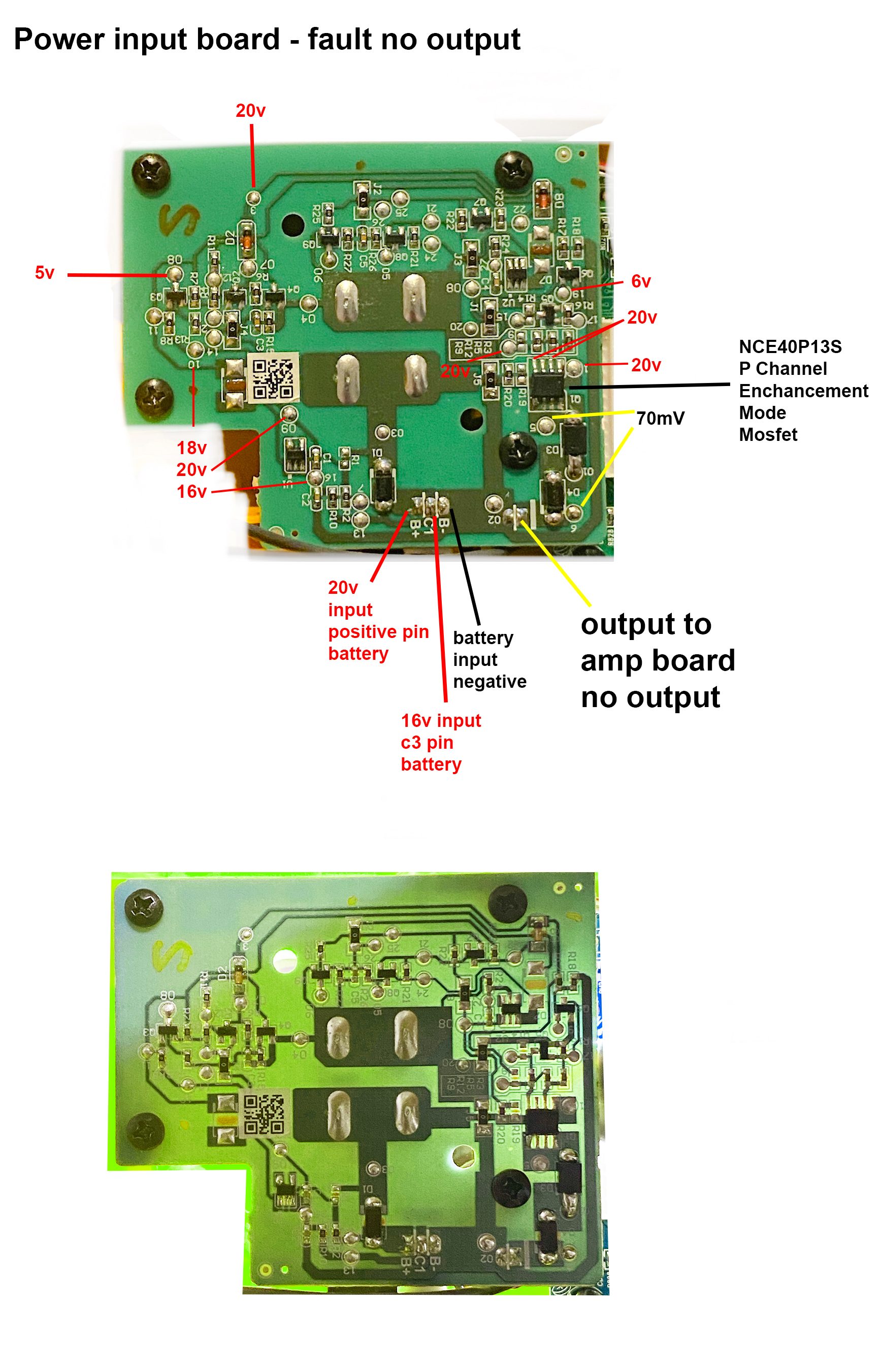

                            I've tried to draw out the circuit from the left hand side of the board
                            I've taken the values of the resistors as measured and they're close to the smd codes
                            transistors are two channel p and an n
                            Is it any help? I can't follow whats happening
                              I suggest you read that datascheet of the voltage detector very carefully. There is a theory on how this thing works, simple test circuits etc. what happens if you use a pull down resistor on the output?
                              • geoff69
                                • Dec 2019
                                • 14
                                • uk
                                From what I can tell >
                                If it is that particular voltage detector and not something else …
                                There is a voltage detect value in this case defined at 3v with upper and lower hysteresis values to prevent oscillation. Vdet being 3v with min -Vdet and max +Vdet
                                If vdd is below operating voltage the output is undefined
                                Otherwise output follows Vdd or Vss depending if Vdd is above or below Vdet - switching on the upper and lower bounds of +-Vdet values
                                Test circuit just seems to be a 100k resistor between output and Vss
                                I can't see a scenario where output is somewhere between Vdd and Vss as measured unless it's below operating voltage and therefore undefined or floating about?
                                There's a good chance I'm missing something obvious though so I am more than open to being corrected

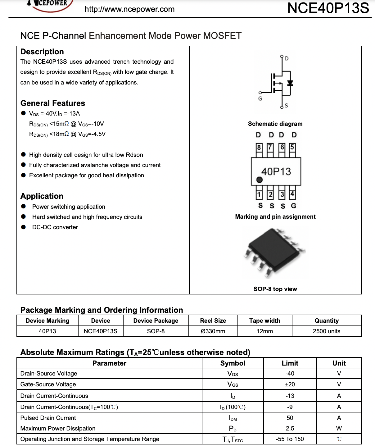

                                  SOLVED
                                  Replaced output pmos NCE40P13S and now working
                                  R5 looked suspect as measured only 674ohms vs expected 2M ohm and is across the gate and source
                                  Thanks for all your help
