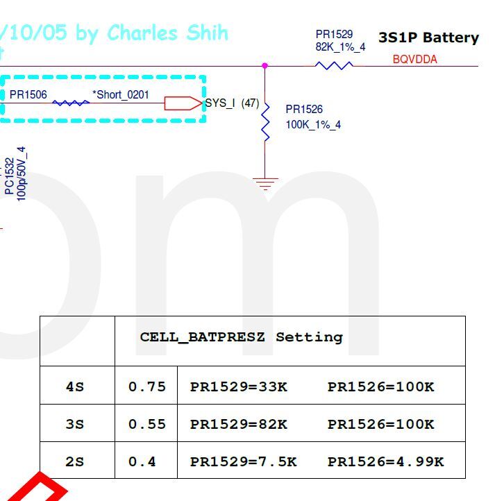

    ThinkBook 15 G3 ACL Not Charging Battery - LA-K602P Board
    since i couldn't find schematic or boardview for this model (LA-K062P), i use closest board model found here https://www.badcaps.net/forum/troubl...-and-boardview
    the schematic share same marking for each component, using same PD-Controller, same BQ25710, the only different is the battery cell used. LA-K061P uses 3S battery while LA-K062P use 4S battery per schematic.
    what i've done:
    - flashing the bios
    - replace battery with new one
    - replace bq25710 and all related mosfet to it
    but nothing changed, new battery will drain even with charger pluged-in.

    after inspecting schematic & tracing pin 8 of PUB1, found what i think it's a PRB23, removed from the circuit and it measure exactly the same value as LA-K061P schematic (43.2K) and doing calculation of this divider it's a same value as i measured earlier on PUB1 at pin 18 and it said for 4S battery while the unit i worked using 3S battery. the owner said it started about a month ago, he realized that the battery not charging when pluged in charger and sometime the laptop turned off by itself. that's make me wonder why it can charge the battery before while those divider are meant for 4S battery?
    anyone could point where to look? i attached picture from another thinkbook schematic using same bq chip and 3S battery

          the unit i worked on use 3S battery, i think it should have 12.6V on main power rail sir, the schematic on first post it's LA-K061P and it uses 4S battery that's why it 's written as +16.8VB​ on main power rail
          on the first post i wrote "replace bq25710 and all related mosfet to it"
          at first plug power adapter pin #4 (CHRG_OK) has 3.2V but after 1-2 second it pulled low (0V), measure resistance to gnd (without any power applied to the board) it's on range between 20-30 kilo ohm, even i tried removing capacitor C255 near UEC1 it still pulled low after 1-2 seconds
          i tried all type of power adapter that has type-c connector that known good on other board but the result still same, last step i tried injecting 20V on VIN_MUX rail and the result remain the same again

            found the culprit!!!
            it was replacement mosfet for PQB2, at first i'm using QA3118 mosfet assuming it has a bigger "ID" based on datasheet, after replacing it twice without resulting any progress i ordered same part number that came with the board.
            upon arrival immediatelly changed the QA3118 and voila, the board came alive even without battery attached & would charge the battery from 0% to 100% without issue (except for heat).
