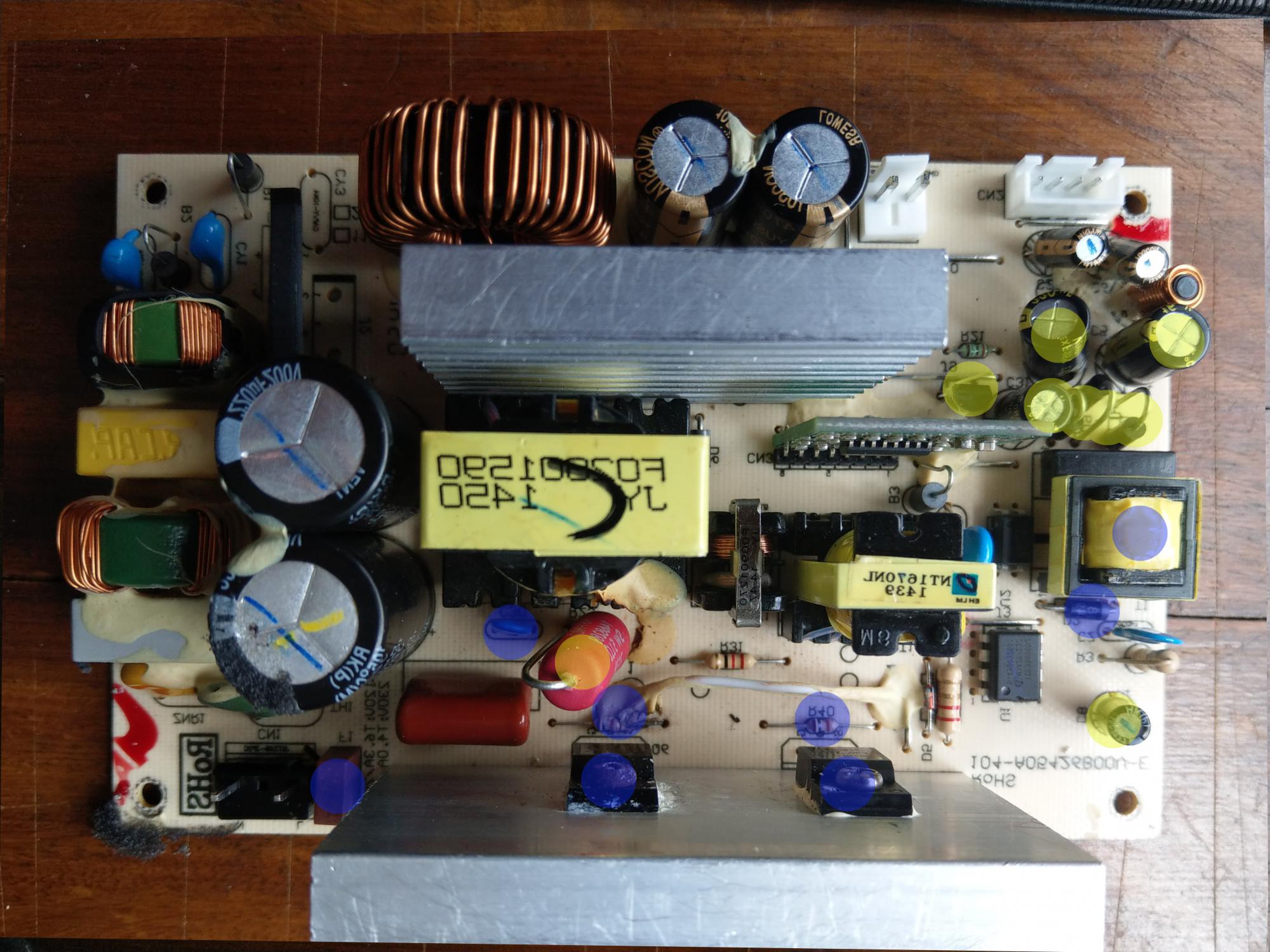

ICE3B0365J Troubleshooting (W200 Sub)
  • CapLeaker
    replied
    Re: ICE3B0365J Troubleshooting (W200 Sub)
    sorry... was thinking about a different amp.
    In any case... its got to be something stupid as you got it to work.
    Leave a comment:
  • SFB
    replied
    Re: ICE3B0365J Troubleshooting (W200 Sub)
    I have already checked the small transformer for the standby circuit, but not the big one.
    I will take some measurements again and see if anything has changed, then have a prod around.
    Is the amp IC the one on the vertical board with 16 legs?
    Leave a comment:
  • CapLeaker
    replied
    Re: ICE3B0365J Troubleshooting (W200 Sub)
    Seems like a cold or broken solder joint or trace. Since it did started to work on some point. Could be also a broken wire on a transformer leg. Start pushing on things with a plastic tool. Maybe reflow the amp ic with the Million legs.
    Leave a comment:
  • SFB
    replied
    Re: ICE3B0365J Troubleshooting (W200 Sub)
    ***** it!!
    It died again. No sound, LED staying red and blinking.
    Better than being totally dead like it was before I guess.
    Leave a comment:
  • SFB
    replied
    Re: ICE3B0365J Troubleshooting (W200 Sub)
    *update*
    After checking a few components out-of-circuit yesterday and doing a few continuity checks this morning, I just reconnected everything and now getting the expected voltages across the 4 pin (+7/-7, 3V) and 54V, the LED is staying on, but had no sound until I swapped the speaker connectors around and now it is all working fine.
    What could have caused the change as I am absolutely baffled?
    Leave a comment:
  • SFB
    replied
    Re: ICE3B0365J Troubleshooting (W200 Sub)
    Seems like someone had a go with it already and ripped a bunch of pads and a trace out where the stby circuitry is.
    Yeah, as I mentioned in my OP it is a family memebers sub and he tried the initial fixes himself via a couple of threads on AV after it had completely died (he said that prior to this he would have to switch it on and off a couple of times before it fired up) While trying to repair a combination of too much heat and being a bit aggressive damaged the pads and tracers so first thing I did was repair them - I didn't have any magnet wire so used component legs for now, and used a microscope with pictures to make sure I got the connections right. (I have attached a photo of the undamaged area I found online.)
    The original problem was the 51ohm/5V resistor had crumbled and there were signs of corrosion in that area so he replaced that, and after that didn't work replaced the main 3 caps and 3 diodes in the start up by default as they appear to be the usual problem. When that again didn't work he gave it to me to have a look at as knows I have an interest and trying to learn more.
    First off in a PSU there are two grounds. Primary GND is always measured on the negative side on the primary bulk capacitor. Any voltage measurements done in the primary section, that’s where your negative probe goes.
    The secondary GND is separated from the primary GND. Any voltage measurements done in the secondary goes to the secondary rail capacitor GND.
    Yes, I have been doing this.
    You got to figure out is it not turning on, because the stby voltage isn’t there, or there is something wrong with PSon and it doesn’t allow the main power rail to power up.
    For your entertainment I squiggled for shits and giggles something together on the fast.
    From the things you marked, the only ones I haven't tested are the inductor, the feedback opto, and the load resistors (which I assume you have to test out of circuit with being parallel to caps?)
    Another thing I noticed is there is a large vertical red resistor in the primary with some brown goo on the bottom? Remove that brown goo and check that resistor. When measurements in circuit doesn’t make sense, take it out and remeasure the part out of circuit. Did you check if the mosfets aren’t shorted?
    That was the original replaced resistor and I have checked it since I have had the board. I did check both the mosfets and the diode near the inductor and all are fine.
    Maybe explain exactly what’s happening with the psu when you turn it on. Be careful with the heat sinks in the primary, they can be live!!!
    Originally we were just getting a blinking LED, but that is constant now, but no audio to speaker. There appears to be an initial surge on the primary up to the primary of the main transformer but then just drains off. The standby circuit just remains dead. Is there anything I should be looking at in particular?
    And yeah, they are live.
    Originally posted by geoff69
    Common faults on these boards - sounds like you've checked some of the caps.
    The 5 output caps and three diodes of the smaller transformer. Caps can look fine physically but still be crapped out.
    The large 5w 51ohm resistor.
    Yes, they have all been replaced besides the 2 smaller caps near the standby pins, but they checked fine with a multimeter.
    Last edited by SFB; 07-20-2023, 05:54 AM.
    Leave a comment:
  • geoff69
    replied
    Re: ICE3B0365J Troubleshooting (W200 Sub)
    Common faults on these boards - sounds like you've checked some of the caps.
    The 5 output caps and three diodes of the smaller transformer. Caps can look fine physically but still be crapped out.
    The large 5w 51ohm resistor.
    Leave a comment:
  • CapLeaker
    replied
    Re: ICE3B0365J Troubleshooting (W200 Sub)
    Seems like someone had a go with it already and ripped a bunch of pads and a trace out where the stby circuitry is.
    Fist off in a PSU there are two grounds. Primary GND is always measured on the negative side on the primary bulk capacitor. Any voltage measurements done in the primary section, that's where your negative probe goes.
    The secondary GND is separated from the primary GND. Any voltage measurements done in the secondary goes to the secondary rail capacitor GND.
    You got to figure out is it not turning on, because the stby voltage isn't there, or there is something wrong with PSon and it doesn't allow the main power rail to power up.
    For your entertainment I squiggled for shits and giggles something together on the fast.
    Another thing I noticed is there is a large vertical red resistor in the primary with some brown goo on the bottom? Remove that brown goo and check that resistor. When measurements in circuit doesn't make sense, take it out and remeasure the part out of circuit. Did you check if the mosfets aren't shorted?
    Maybe explain exactly what's happening with the psu when you turn it on. Be careful with the heat sinks in the primary, they can be live!!!
    Leave a comment:
  • SFB
    replied
    Re: ICE3B0365J Troubleshooting (W200 Sub)
    Ah okay, that makes sense. I have an ESR meter and freeze spray on the way too.
    It isn't shorted, but with you mentioning that I did take readings on the transformers a while back (blue is to ground)
    Leave a comment:
  • CapLeaker
    replied
    Re: ICE3B0365J Troubleshooting (W200 Sub)
    Does lower the ESR on high ESR capacitors. So if it would be a bad startup cap, the unit would work after heating. Opposite effect you get with cooling on caps.
    Is the secondary power rail shorted? You should see some resistance as it has 2 load resistors installed.
    Leave a comment:
  • SFB
    replied
    Re: ICE3B0365J Troubleshooting (W200 Sub)
    How would heating the board show anything?
    Leave a comment:
  • SFB
    replied
    Re: ICE3B0365J Troubleshooting (W200 Sub)
    The reason for the VCC fluctuating is the thing I'm not sure about. I have swapped all the caps and diodes in that area but the power isn't even getting to them as the secondary side of the transformer is dead, though the transformer itself is fine. I can only assume it is something to do with the feedback voltage (though I have no idea what value it is supposed to read) or the IC itself needs replacing. The fluctuating SoftS is to be expected due to its relation the the VCC, and the CS is dead because the secondary on the transformer is dead with it not starting up. There is a surge of power on startup as read it on the earth rail, but then it dissipates.
    Yeah, it's the same board in the Tannoy and those caps and diodes were the first things checked and swapped out anyway. Seems the issue is deeper than simple checks but I am at a bit of a loss, hence posting here.
    Leave a comment:
  • CapLeaker
    replied
    Re: ICE3B0365J Troubleshooting (W200 Sub)
    Look at this: https://www.youtube.com/watch?v=Ym1dvujBtns
    Looks very similar to your PSU?
    Leave a comment:
  • CapLeaker
    replied
    Re: ICE3B0365J Troubleshooting (W200 Sub)
    Figure out why your VCC is fluctuating. VCC should be almost rock solid and have very little fluctuations. Maybe heat sections of the board up with wifeys hair dryer to 40-50C and see what’s happening.
    Leave a comment:
  • SFB
    replied
    Re: ICE3B0365J Troubleshooting (W200 Sub)
    Bump
    Leave a comment:
  • SFB
    replied
    Re: ICE3B0365J Troubleshooting (W200 Sub)
    Yeah, I replaced the 15v electrolytic but the old one tested fine.
    Leave a comment:
    replied
    Re: ICE3B0365J Troubleshooting (W200 Sub)
    did you replace the small cap in the lower right corner near the chip?
    Leave a comment:
  • SFB
    started a topic ICE3B0365J Troubleshooting (W200 Sub)
    ICE3B0365J Troubleshooting (W200 Sub)
    Hello all.
    I am currently trying to troubleshoot and repair a W200 Sub as a personal project/learning and it seems to have gone a bit beyond my circuit knowledge having exhausted most of the obvious testing (attached images blue=tested, yellow=replaced). A repair had been attempted by a family member prior and some of the tracers damaged so I had to repair them first.
    The board is a 104-A05426B00V-E and is an ICE3B0365J chip, and after finding the chip datasheet have gotten the following readings;
    1.SoftS - Unreadable (fluctuating)
    2.FB - 473mV
    3.CS - 0
    4.Drain - 330V
    5.Drain - 330V
    6.n.c. - 110mV (fuctuating)
    7.VCC - 15V (fluctuating)
    8.GND - 0
    I vaguely understand what each pin is for, but I'm not sure what values I should be expecting in order to trace where any extra voltage is being lost, or being gained. I am assuming the Feedback voltage is too low so it is cycling restart, but I might be misunderstanding the datasheet. The transformer secondary is not receiving any voltage at all which I assume is due to the VCC not being stable.
    Any insight into this would be very much appreciated.
    Last edited by Per Hansson; 07-25-2023, 09:25 AM. Reason: Offsite images uploaded
  • Cemal Odabasioglu
    MacBook Pro A1707 Motherboard Diagnostic Help – CD3215 heating and Fluctuating Rails
    by Cemal Odabasioglu
    I'm currently diagnosing a MacBook Pro A1707 motherboard that does not power on. I've gathered some data but am stuck and need expert advice.
    Note that i'm a beginner in electronics and i'm trying to learn while trying to repair this macbook that my work gave me. I'm really curious and love understanding how thing works and i already learned so much.
    Only one usb c port is taking 20v and have 12.5v on PPBUS_G3H. when trying other ports, 2 are not going to 20v and one is going to 20v but the CD3215 is getting really hot.
    Observations...
    01-14-2025, 03:54 PM
  • triplefour
    ONN 100012588 Has fluctuating Voltage on PSU 12v
    by triplefour
    Hello all got another TV here im puzzled by. why cant they all be easy fixes that just need a little love and some tape???
    anyway i go to this guys house to look at an ONN 100012588
    this is my first time looking at one of these brand of TV's.
    TBH i have low expectations because i see ONN as the cheap walmart brand that suddenly popped up selling the cheapest version of all kinds of tech things. and someone sent me a ONN flash drive with some data on it with some recordings they wanted me to check out and it immediately broke and corrupted the data and i was unable to...
    09-14-2022, 07:41 PM
  • blues_spirit
    practical courses for troubleshooting pc motherboards
    by blues_spirit
    Hello from France,
    mon2 kindly advised me to post a thread to ask the question(s) I'm concerned about. I'm new to the forum and I'm looking for practical courses for troubleshooting pc motherboards especially laptops in Europe, if possible in France. I have been a computer network system administrator and a corrector of administration modules for automated programs under Unix. But I really miss the practical "ops" side of troubleshooting. So I would like to start from the beginning: 1.8V, 3.3V, 5V and 19V tests for example, etc...
    Do you think this is feasible for me? I...
    12-18-2022, 12:56 PM
  • beetle1303
    Wine Chiller - SMPS issue - fluctuating voltages
    by beetle1303
    My wine chiller, TECNO SW-126LCD, is semi-functional - it powers up, can set temperature, and chilled to the set temperature, and cuts off compressor, etc. It however runs very hot.
    Upon taken out the PSU and did some basic check - 5V output to LCD panel buttons and display is stable, but there is no 12V output to LED lights, and fans.
    Further checks found the secondary side voltage is fluctuating around 8-15V range, but the 7805 regulator seems ok and producing the stable 5V output.
    Checking further on the primary side: Incoming line input to bridge...
    09-04-2023, 10:33 AM
  • gcrezz
    GV-N2060OC-6GD REV 2.0 GIGABYTE video card troubleshooting assistance needed.
    by gcrezz
    The issue with this video card is the HDMI port. Specifically on pin 19 (Diode checks on all other pins are normal). When i do a diode check on it from the pin on the board itself, I have nothing. There is also no short on the pin. Resistance reads about 200k. Normally on any HDMI pin 19 I would expect some voltage drop anywhere from .5v to 1.2v but here, I have nothing. The card is operational and can be used via the displayPort ports, but not through the HDMI. Attached you will find the pdf schematics for the card on page 22. I have verified that all of the resistors on this line before the...
    07-25-2024, 09:49 AM
