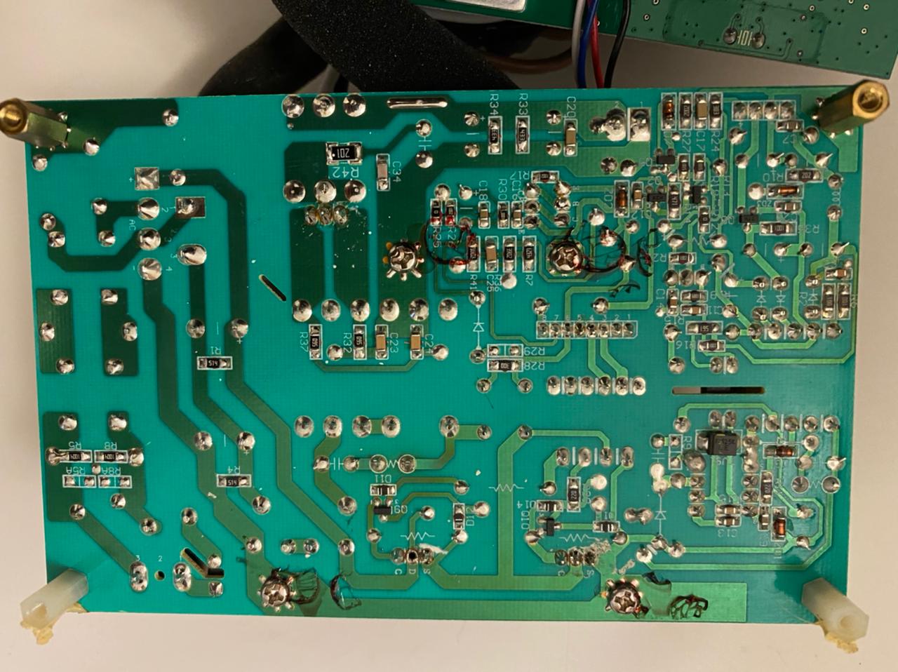

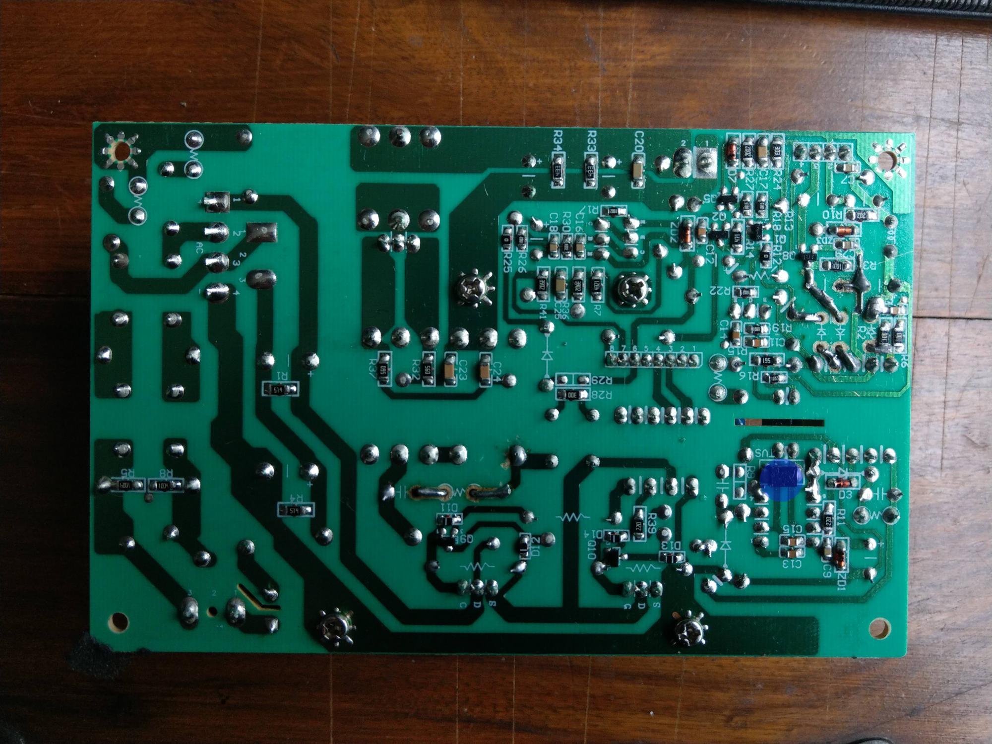

    Hello all.
    I am currently trying to troubleshoot and repair a W200 Sub as a personal project/learning and it seems to have gone a bit beyond my circuit knowledge having exhausted most of the obvious testing (attached images blue=tested, yellow=replaced). A repair had been attempted by a family member prior and some of the tracers damaged so I had to repair them first.
    The board is a 104-A05426B00V-E and is an ICE3B0365J chip, and after finding the chip datasheet have gotten the following readings;
    1.SoftS - Unreadable (fluctuating)
    2.FB - 473mV
    3.CS - 0
    4.Drain - 330V
    5.Drain - 330V
    6.n.c. - 110mV (fuctuating)
    7.VCC - 15V (fluctuating)
    8.GND - 0
    I vaguely understand what each pin is for, but I'm not sure what values I should be expecting in order to trace where any extra voltage is being lost, or being gained. I am assuming the Feedback voltage is too low so it is cycling restart, but I might be misunderstanding the datasheet. The transformer secondary is not receiving any voltage at all which I assume is due to the VCC not being stable.
    Any insight into this would be very much appreciated.

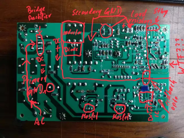

                      Seems like someone had a go with it already and ripped a bunch of pads and a trace out where the stby circuitry is.
                      Fist off in a PSU there are two grounds. Primary GND is always measured on the negative side on the primary bulk capacitor. Any voltage measurements done in the primary section, that's where your negative probe goes.
                      The secondary GND is separated from the primary GND. Any voltage measurements done in the secondary goes to the secondary rail capacitor GND.
                      You got to figure out is it not turning on, because the stby voltage isn't there, or there is something wrong with PSon and it doesn't allow the main power rail to power up.
                      For your entertainment I squiggled for shits and giggles something together on the fast.
                      Another thing I noticed is there is a large vertical red resistor in the primary with some brown goo on the bottom? Remove that brown goo and check that resistor. When measurements in circuit doesn't make sense, take it out and remeasure the part out of circuit. Did you check if the mosfets aren't shorted?
                      Maybe explain exactly what's happening with the psu when you turn it on. Be careful with the heat sinks in the primary, they can be live!!!
                          Yeah, as I mentioned in my OP it is a family memebers sub and he tried the initial fixes himself via a couple of threads on AV after it had completely died (he said that prior to this he would have to switch it on and off a couple of times before it fired up) While trying to repair a combination of too much heat and being a bit aggressive damaged the pads and tracers so first thing I did was repair them - I didn't have any magnet wire so used component legs for now, and used a microscope with pictures to make sure I got the connections right. (I have attached a photo of the undamaged area I found online.)
                          The original problem was the 51ohm/5V resistor had crumbled and there were signs of corrosion in that area so he replaced that, and after that didn't work replaced the main 3 caps and 3 diodes in the start up by default as they appear to be the usual problem. When that again didn't work he gave it to me to have a look at as knows I have an interest and trying to learn more.
                          First off in a PSU there are two grounds. Primary GND is always measured on the negative side on the primary bulk capacitor. Any voltage measurements done in the primary section, that’s where your negative probe goes.
                          Yes, I have been doing this.
                          You got to figure out is it not turning on, because the stby voltage isn’t there, or there is something wrong with PSon and it doesn’t allow the main power rail to power up.
                          From the things you marked, the only ones I haven't tested are the inductor, the feedback opto, and the load resistors (which I assume you have to test out of circuit with being parallel to caps?)
                          Another thing I noticed is there is a large vertical red resistor in the primary with some brown goo on the bottom? Remove that brown goo and check that resistor. When measurements in circuit doesn’t make sense, take it out and remeasure the part out of circuit. Did you check if the mosfets aren’t shorted?
                          That was the original replaced resistor and I have checked it since I have had the board. I did check both the mosfets and the diode near the inductor and all are fine.
                          Maybe explain exactly what’s happening with the psu when you turn it on. Be careful with the heat sinks in the primary, they can be live!!!
                          Originally we were just getting a blinking LED, but that is constant now, but no audio to speaker. There appears to be an initial surge on the primary up to the primary of the main transformer but then just drains off. The standby circuit just remains dead. Is there anything I should be looking at in particular?
                          And yeah, they are live.

                            Re: ICE3B0365J Troubleshooting (W200 Sub)
                            *update*
                            After checking a few components out-of-circuit yesterday and doing a few continuity checks this morning, I just reconnected everything and now getting the expected voltages across the 4 pin (+7/-7, 3V) and 54V, the LED is staying on, but had no sound until I swapped the speaker connectors around and now it is all working fine.
                            What could have caused the change as I am absolutely baffled?
