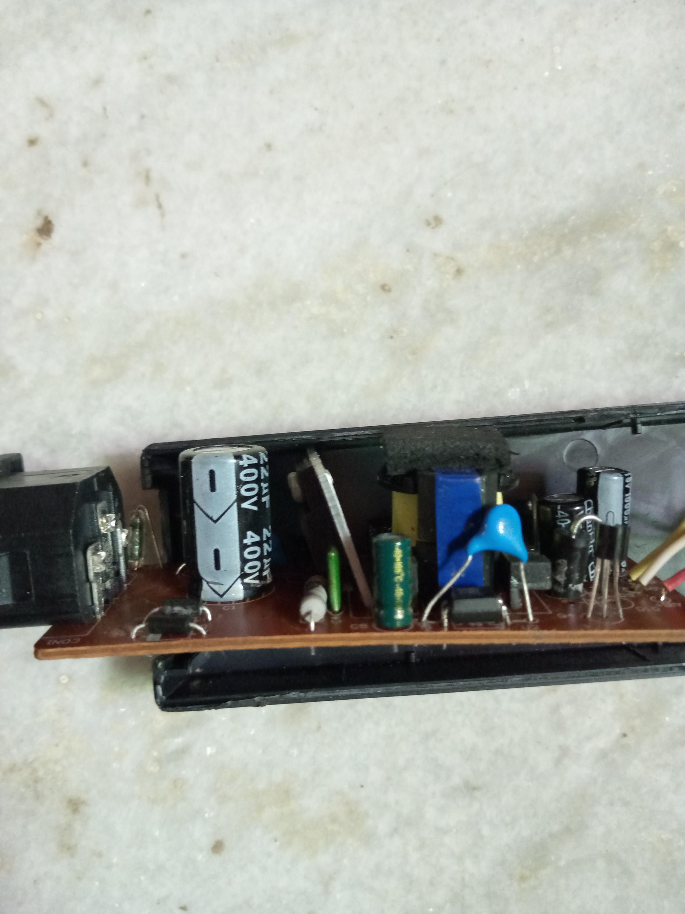

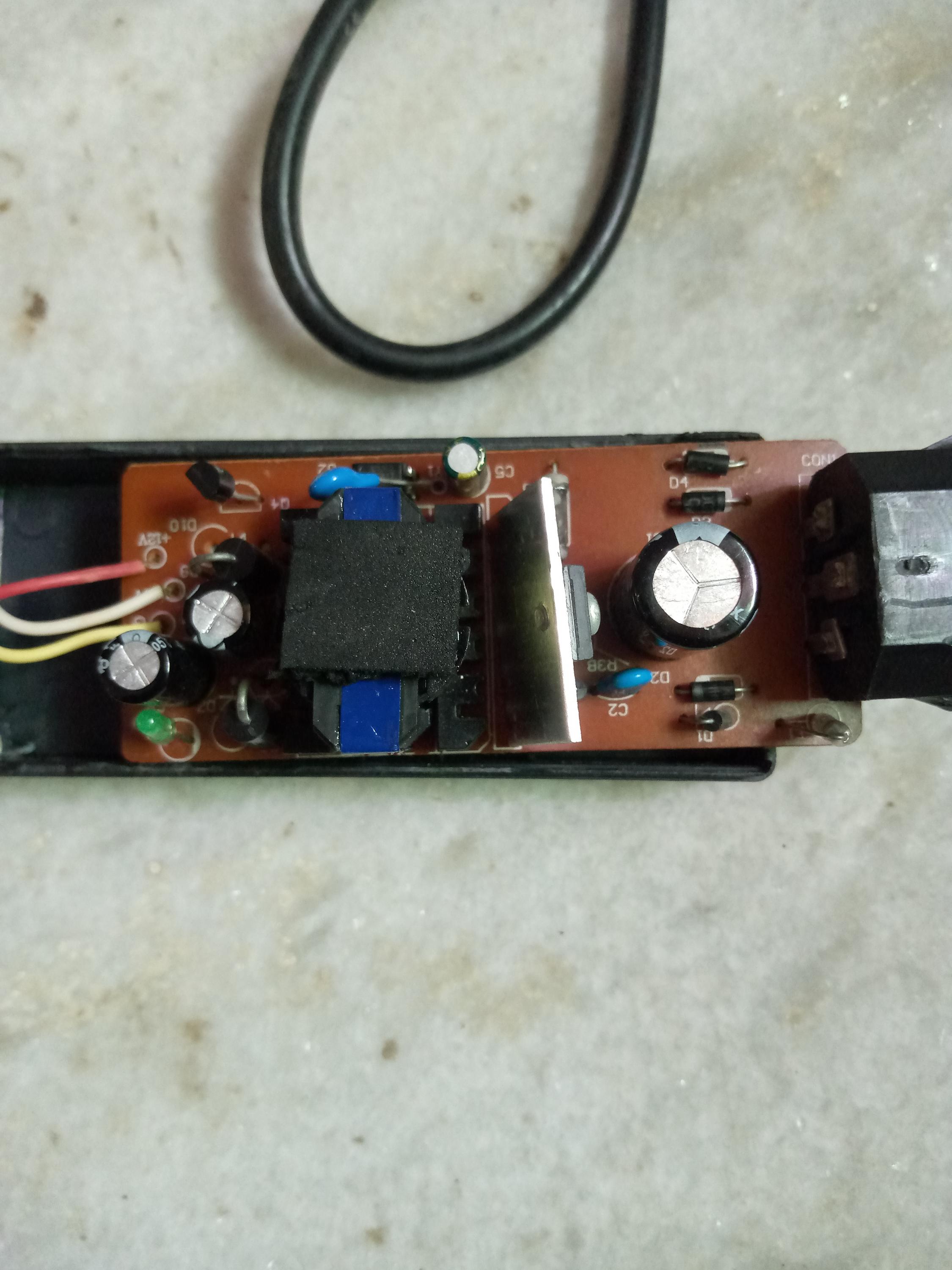

    hello , i use this adapter only for a case fan ,it ran for like 10 days , until today, i opened it , looks like a blown fuse , other than that i am not sure what else to check out , but i have tried to see what are shorts with a multimeter

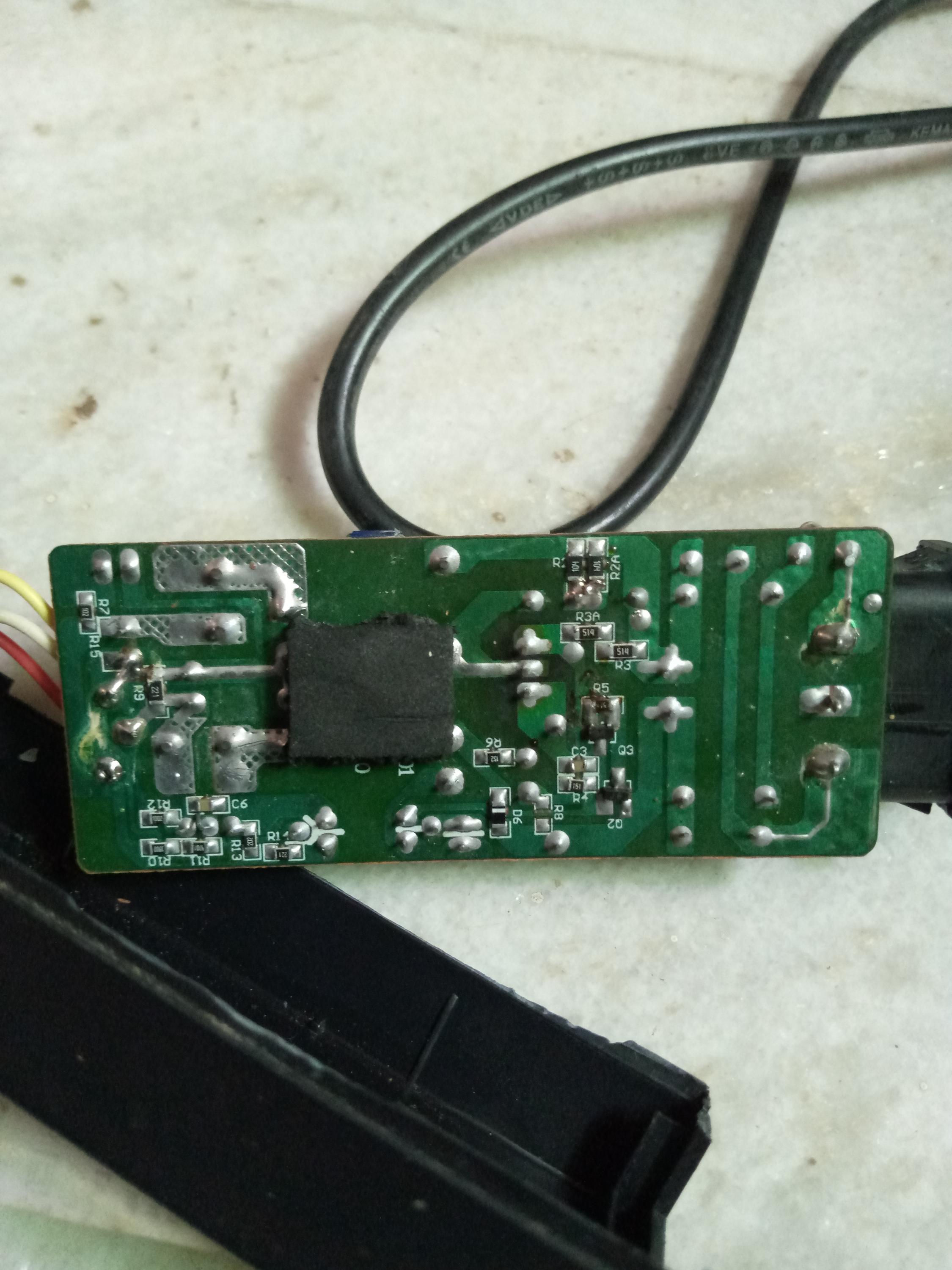

    at back -both 514 doesnt give me any reading or beeps(continuity) ,but if i keep at end of one 514 to other opposite end of other 514 - it gives me beep- continuity . other resistors are giving me readings , but please do tell me what should i check , i might have missed a lot .
    at front - at the plug in - at side of c2 blue capacitor - the d2 is shorted , other side d4 is shorted the fuse doesnt give continuity , the ceramic broken like resistor gives a reading, its not shorted the 3 points of mosfet which is attached to heat sink aluminum at back gives continuity beeps . the capacitors all give readings except that green small capacitor , other diodes are ok
    other than this please guide me what else should i do before replacing fuse and other stuffs, thank you .

    the pics are attached now
      • 31246
      Re: 12v/5v power supply -no power out
      i see no pics.
      desolder the mosfet and rectifier diodes and check them all for shorts

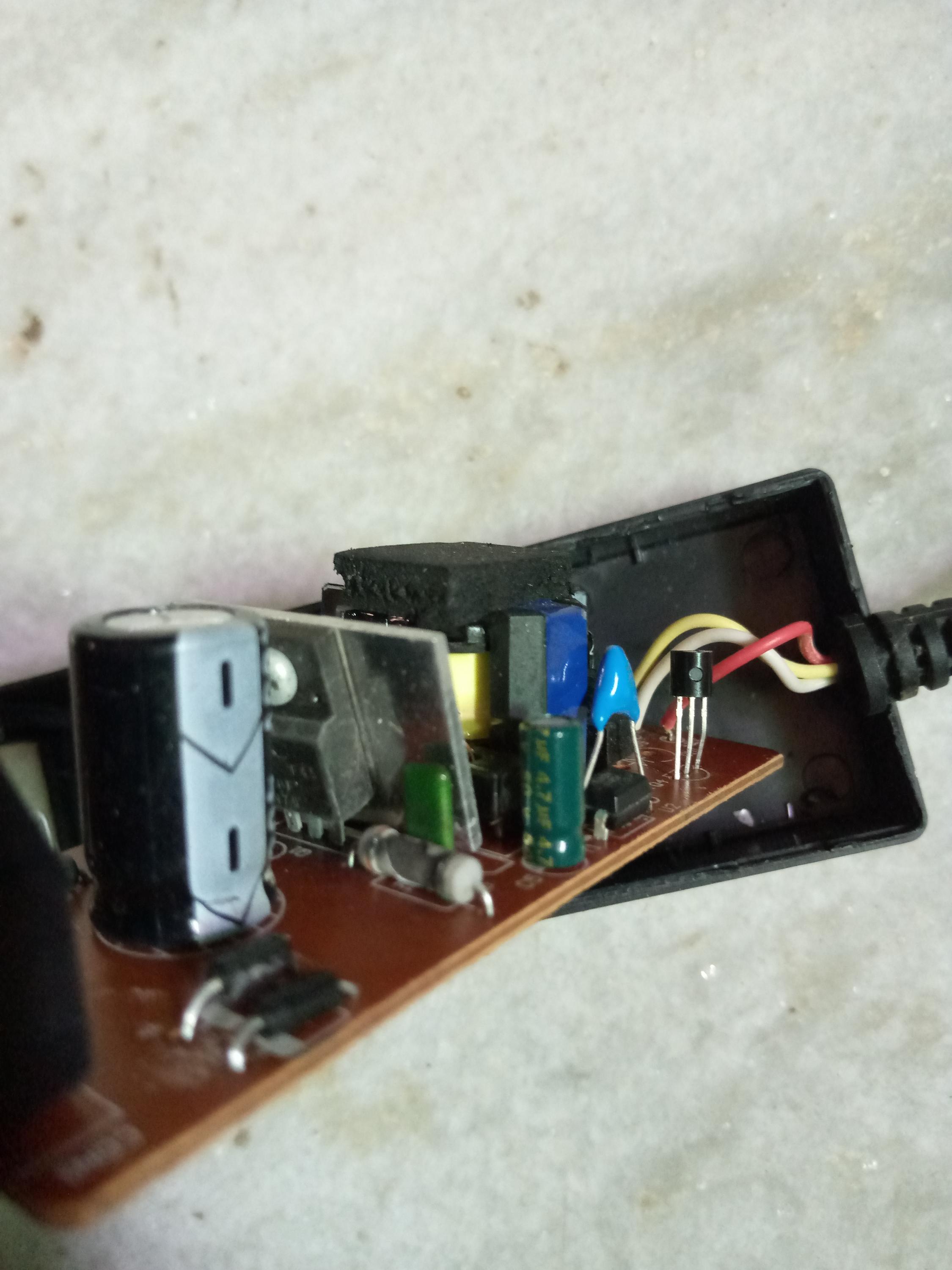

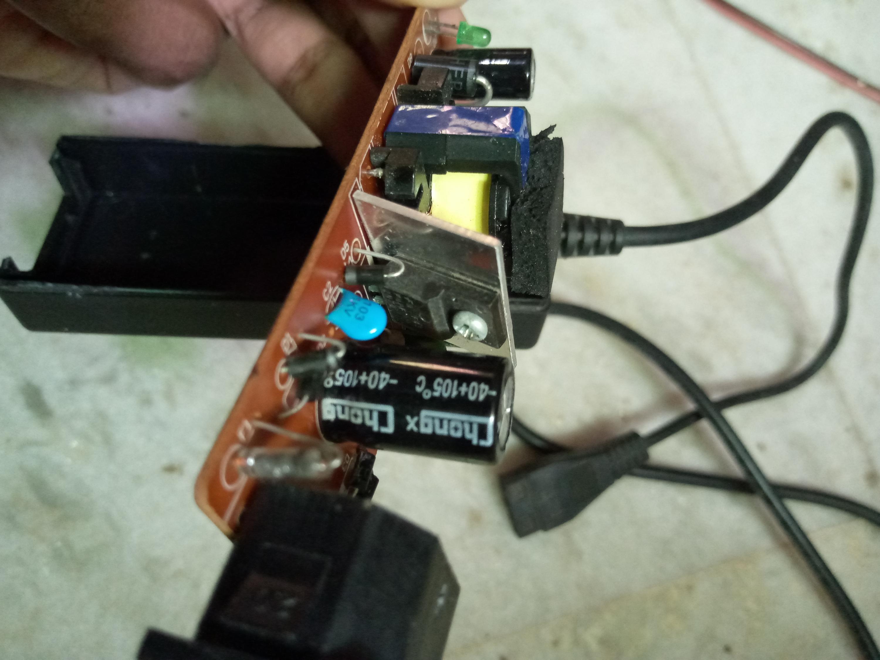

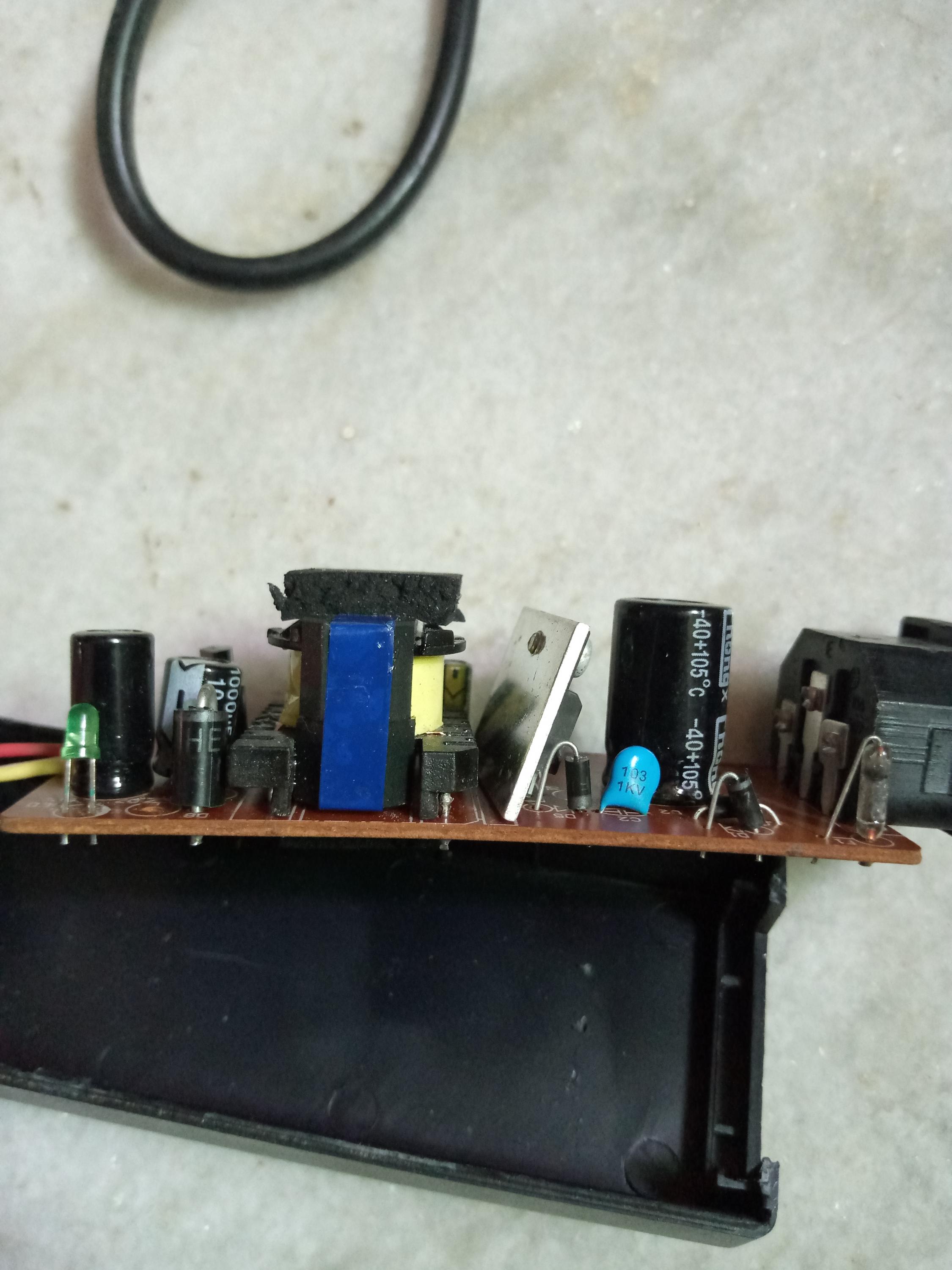

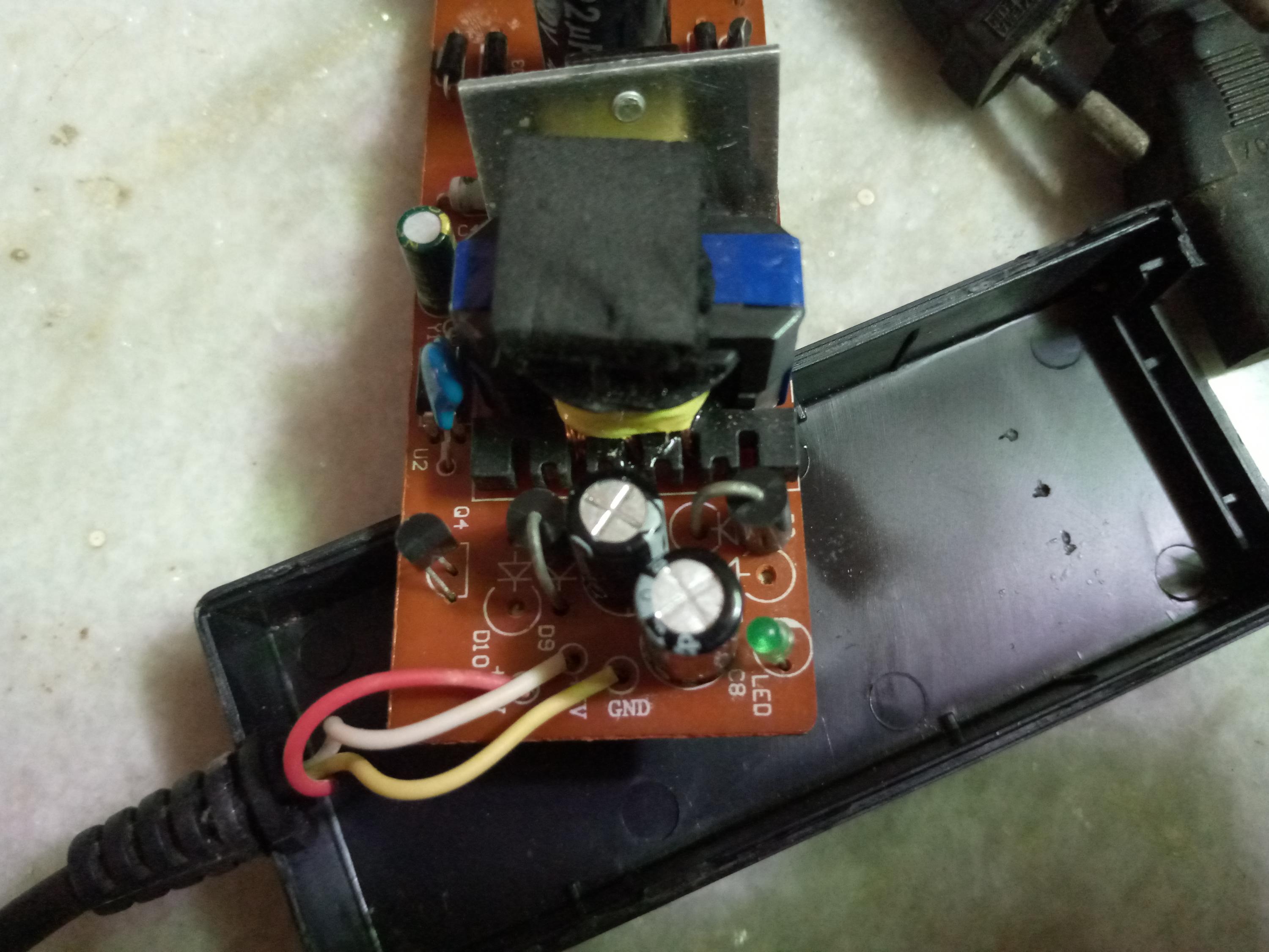

            pics here now
              • 31246
              mosfet has shorted and blown the safety resistor and probably damaged the mains rectifier diodes.
              also burned a resistor on the track-side
              • petehall347
                • Jan 2015
                • 4440
                • United Kingdom
                looks like c3 fell off

                  If the mosfet is shorted on all three legs, you also got to inspect the gate drive circuit.
                    c3 is at back, looks like its moved , but it gives reading 175

                              the problem is the build quality,
                              tiny fuse, poor construction.
                              if you want to fix it then start by removing the fet and rectifier diodes and test them off-board.
                              then test the main smoothing cap because it could have failed first and caused this.
                              your biggest challenge is going to be finding out the values of the 2 burned resistors.
                              and you need to check all the stuff on the trackside too.

                                smoothing cap means the c5 green 50v 4.5uf ? and about the resistor which gives continuity beep is 514 smd at back side 510 kΩ . please point out the names with colurs in the pcb in pic if i have missed anything , thank you
                                  • 31246
                                  no, the mains smoothing cap - probably 47uf 400v
                                    oh the bigger ones , mm it reads well ,some readings come and disappear like other capacitors . i will remove those resistors and rectifier diodes ,mosfet 2n70 and be back to update, thank you
                                      at back of pcb there is q2 and q3 , how to check it , q2 gives continuity beeps on both pins , i am not sure whats it, how to check it , please guide me , thank you.
                                        • 31246
                                        if any part looks suspicious on your meter, remove it and test again.
                                        because it could be caused by something else on the board connected with it.
                                        that is why i said to remove the mosfet and diodes
