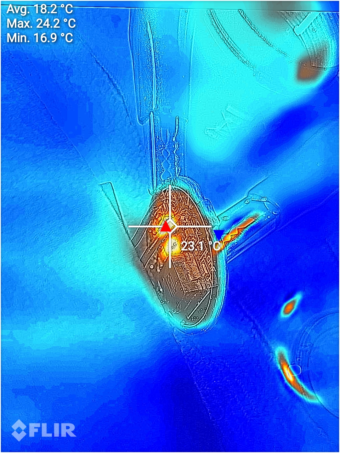

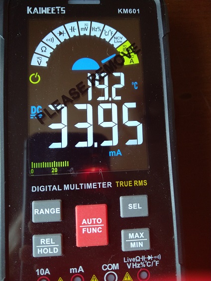

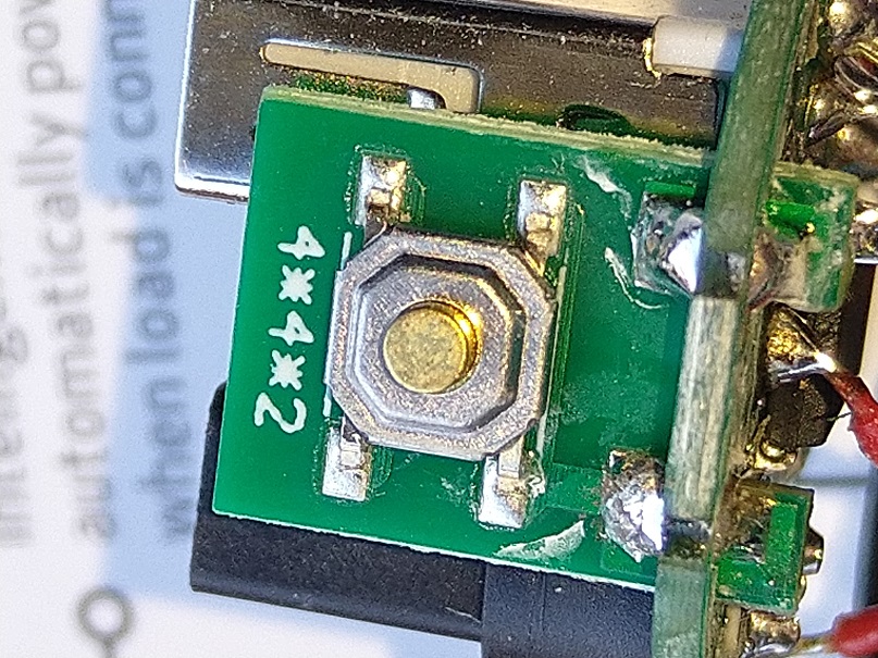

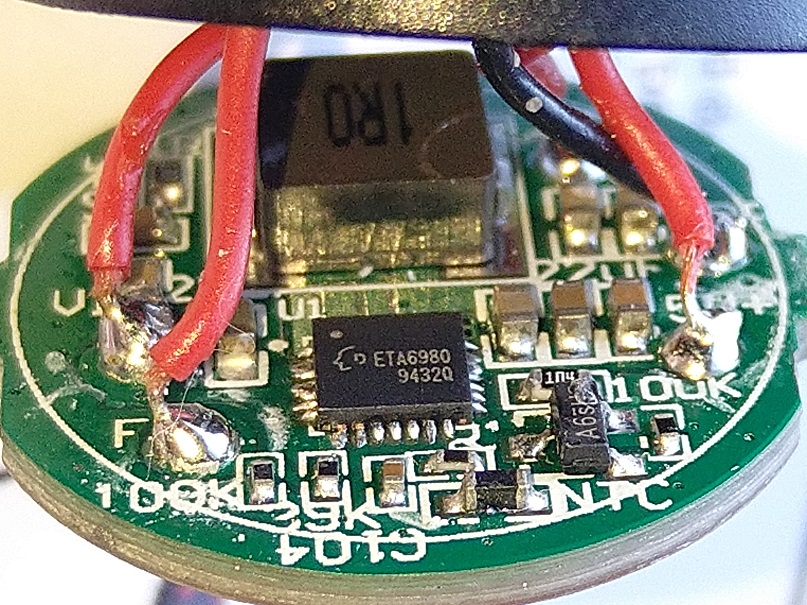

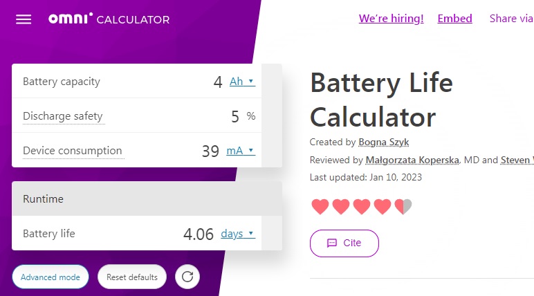

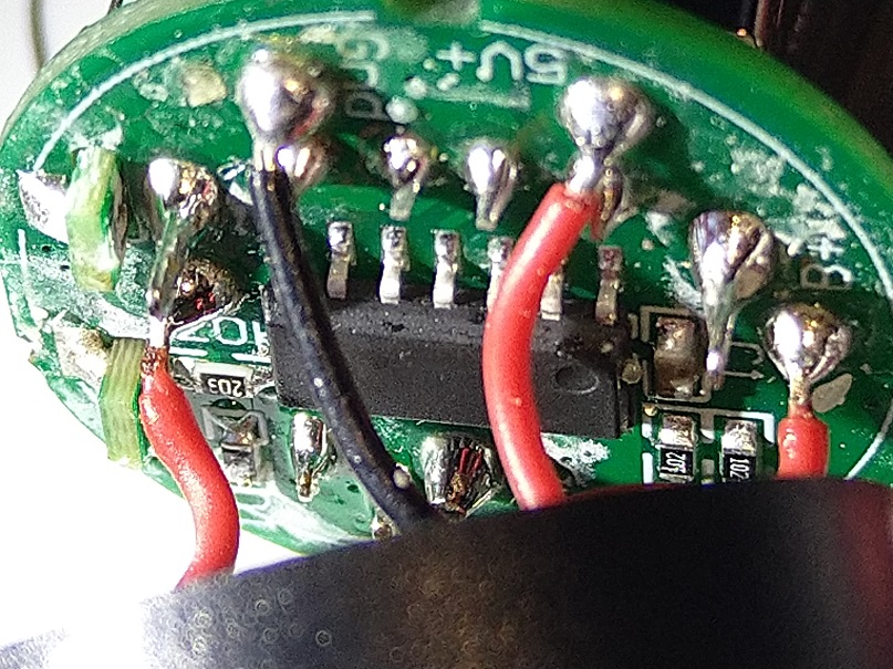

    Well I did not disasemble the headlamp yet to verify. But the SCANGRIP POWERBANK 03.5782 - quiescent current draw 39mA. The thing drops dead unused in 3 to 4 days.
    The FLIR shows that supposedly Power management chip is faulty, but the chip failed to be identified by the numbers on it.
    FLUX is everywherenot cleaned, bad job by SCANGRIP.
