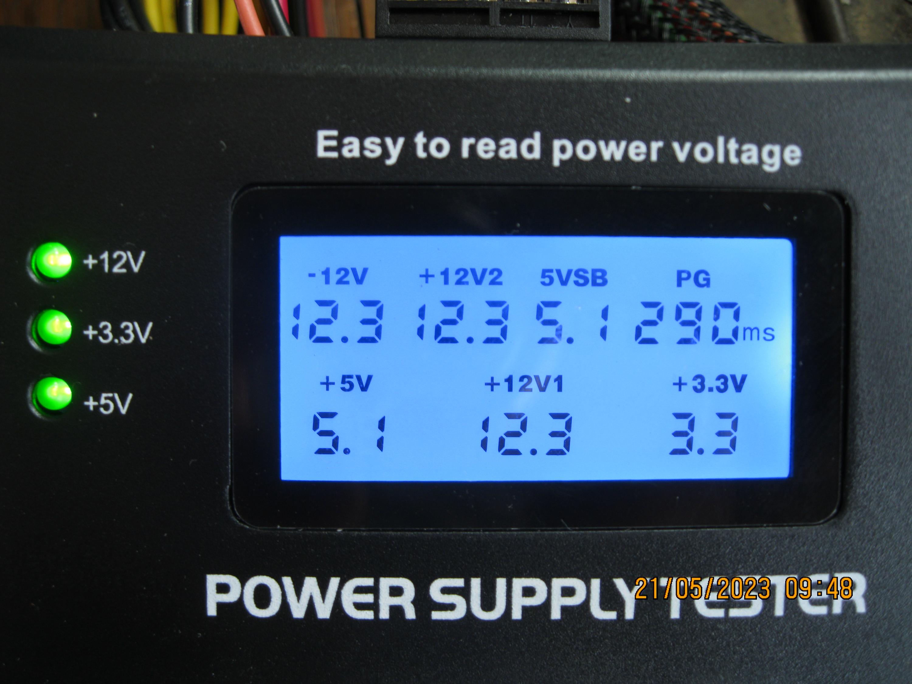

              3rd test, no light bulb, power supply tester : all voltages ok (see attachment)
              4th test , no light bulb, with 1 HDD : ok, all seems working so far !
              As this is my very first "serious" electronic repair, I'm very happy !
              Thanks so much guys for all your help !
