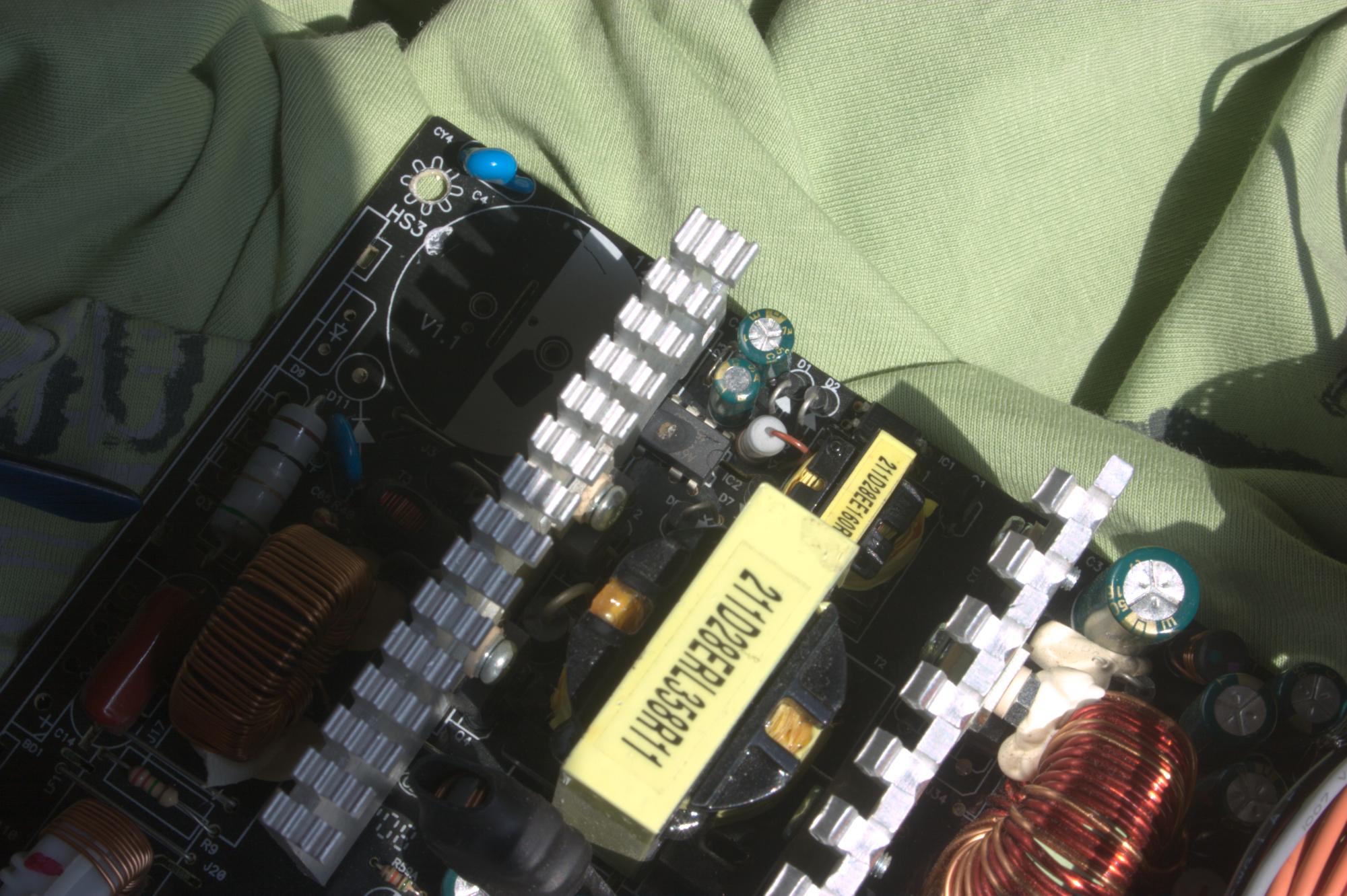

    Hi there,
    A few years ago, my ATX Aerocool VP-550 blew its fuse. I replaced it : it blew again...
    A IC blew as well, and is now showing it guts (see center of the picture).
    After some research, I think it belongs to the STR-A6000 series (Off-Line PWM Controllers with Integrated Power MOSFET).
    I can see its first 2 digits "A6...."
    It has only 7 pins instead of 8 (no pin 6)
    It's located very close to the filter capacitor (180uF, 400V) of the primary stage.
    Does someone know what IC it is exactly ?
    Other components out-of-order (maybe more...) :
    • thermistor SCK-2R56 (2.5 ohms, 6A)
    • Bridge rectifier GBU606 (short)
    • Capacitor (180uF, 400V) shows 5.5uF on digital multimeter
    • unknown IC (STR-A6000 series?)
    • MOSFET MDP13N50 (sits just next to the bridge rectifier on the same heatsink, short)

    Re: AeroCool VP-550 : IC identification issue
    Hopefully you were careful opening the case. The rest of the lid of the IC should be floating around the inside of the power supply. I think you are right on it being a Sanken STR-A60xx series. Luckily there aren’t many to choose of. However these very few to choose of have different switching frequency. 67 vs 100khz.
      Unfortunately, I didn't pay attention while opening the case, and the rest of the IC is lost...
      As for the exact part number, I ordered a few STR-A6059H (the first of the series working at 100kHz), thinking maybe it was related to another IC on the other side of the PCB : a CM6805BG (10-PIN Green-Mode PFC/PWM Combo CONTROLLER), which also works at 100kHz.
      There's certainly a way to determine, or at least narrow down the research, to find which one would fit knowing the other components connected to it but I don't know how and I couldn't find a place where to order a complete STR-A6000 series.
      Probably Vdss MIN(V) and Rds(on) MAX (ohm) of the IC can give some important information to choose wisely...

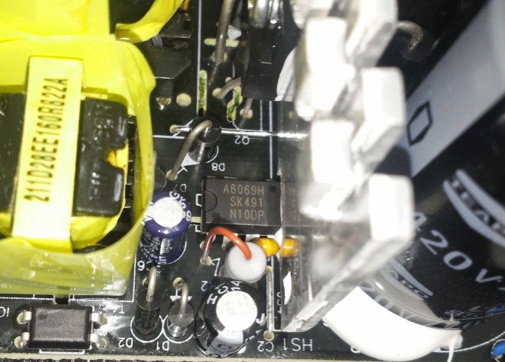

                    I did some digging (being bored this morning ) and I found one single reference on the AeroCool VP-550 that chip in question being an STR-A6069H.
                    Good luck!
                    • lotas
                      • Jan 2016
                      • 4625
                      • Russia
                      Yes, in these series is STR-A6069H.
                        Good luck!
                        As I see in the datasheet A6059H has the same specs (it would probably be a good replacement IC)
                        But how the hell did you find that !?!?
                        Thank you so much !!!
                          It's a slightly different configuration (there's a second capacitor near the heatsink and there's no what looks like a yellow capacitor close to pin 3 and 4)
                          But anyway, thank you so much !!!
                          I also plan to install a 8 pins socket so IC can be replaced easily if needed.
                          Keep you all updated once I've got all parts soldered.
                          Fingers crossed...
                            By not using Google as a search engine. Yw.!
                            Using a 6069H or a 6059H doesn’t matter. The Difference is the max input voltage handling of the IC.
                              Using a 6069H or a 6059H doesn't matter. The Difference is the max input voltage handling of the IC.
                              Indeed, I only tried google search...
                              Oh, ok, it'll be the A6069H or any A606x then (700V max), not the A6059H (650V max).
                              Thank you very much for that info !

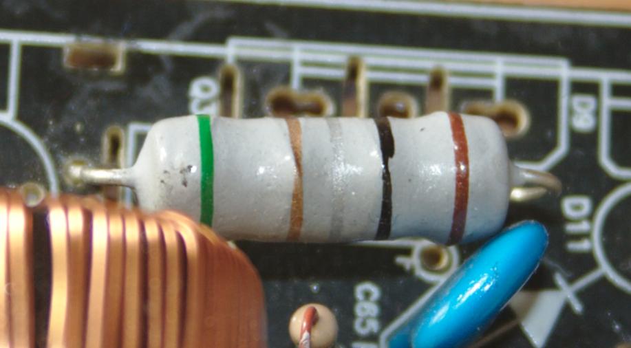

                                        What is the power rate of that 5 bands resistor (1 stage, near the big capacitor) ?
                                        I couldn't find a color code calculator that found the answer using 5 bands.
                                        Looks like it's a 4 bands resistor with a fifth one...
                                        According to its color, BROWN - BLACK - SILVER - GOLD - GREEN...
                                        (correct me if I'm wrong, I'm color blind, I've got problems especially with the greens, I'm a "deuteranope" guy)
                                        ...it's a 4 bands resistor, and it should be a 0.1 Ohm 5% resistor, right ? (and indeed, I can measure it with my DMM).
                                        Then, if it's a 4 bands resistor, what is the meaning of the last green band ?
                                        Also, how can I find the power rating so I could order one if needed (even if it looks in good shape to my eyes) ?
                                        Dimensions : width = ~17mm, diameter = ~6mm
                                        Is it a 5W resistor ? More than 5W ?
