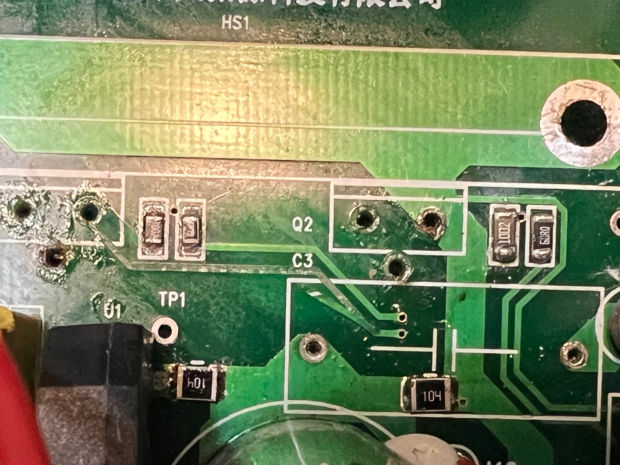

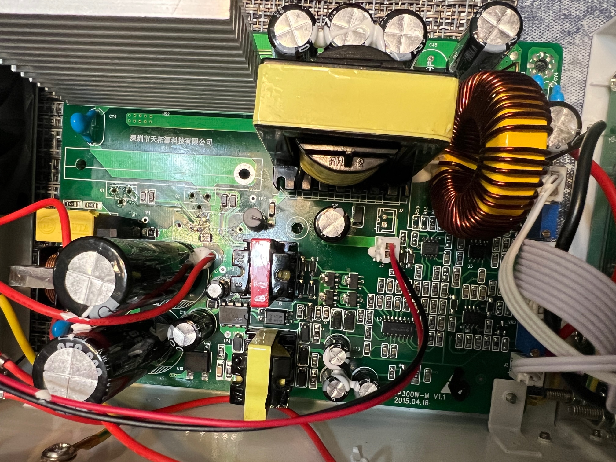

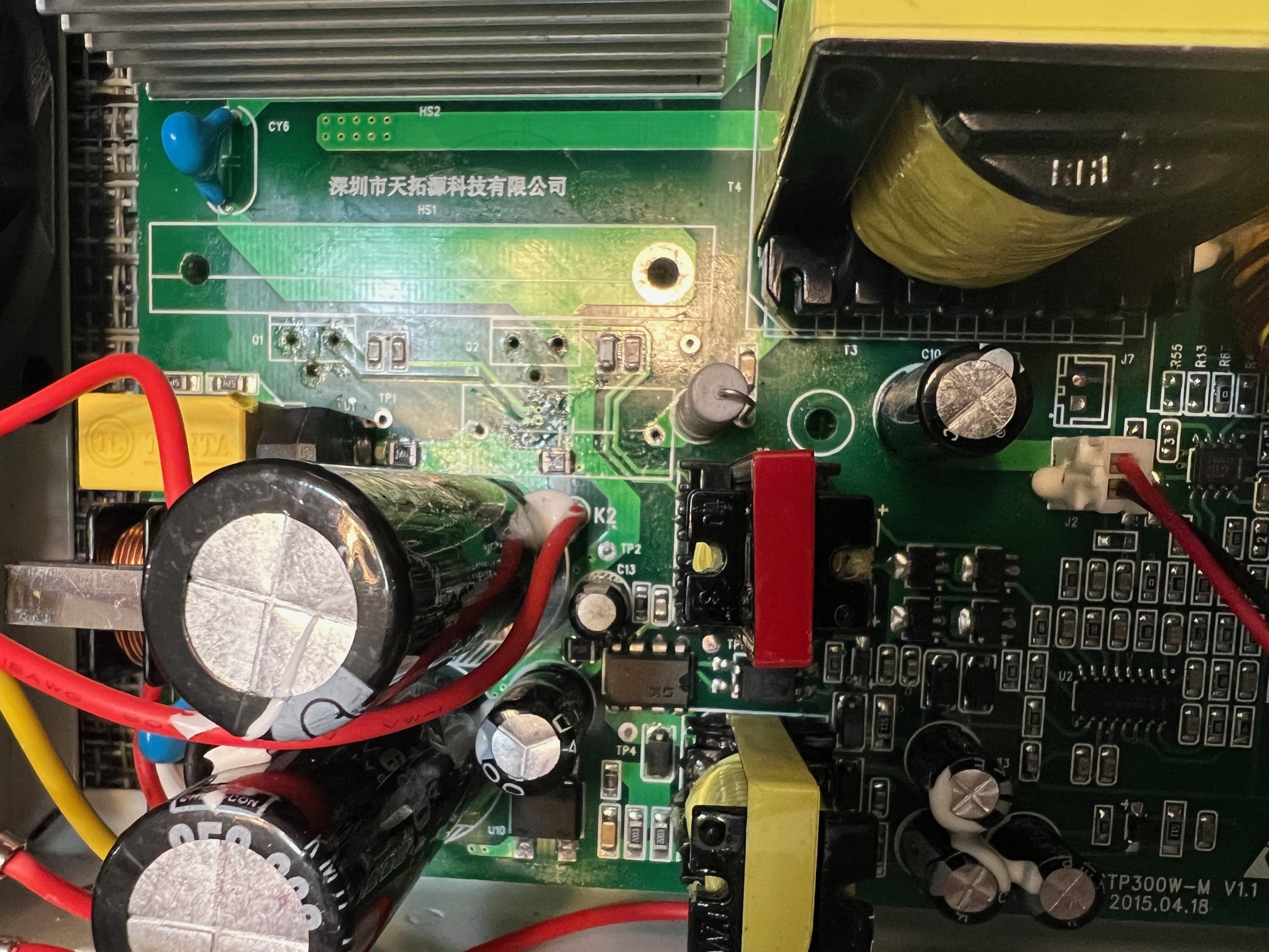

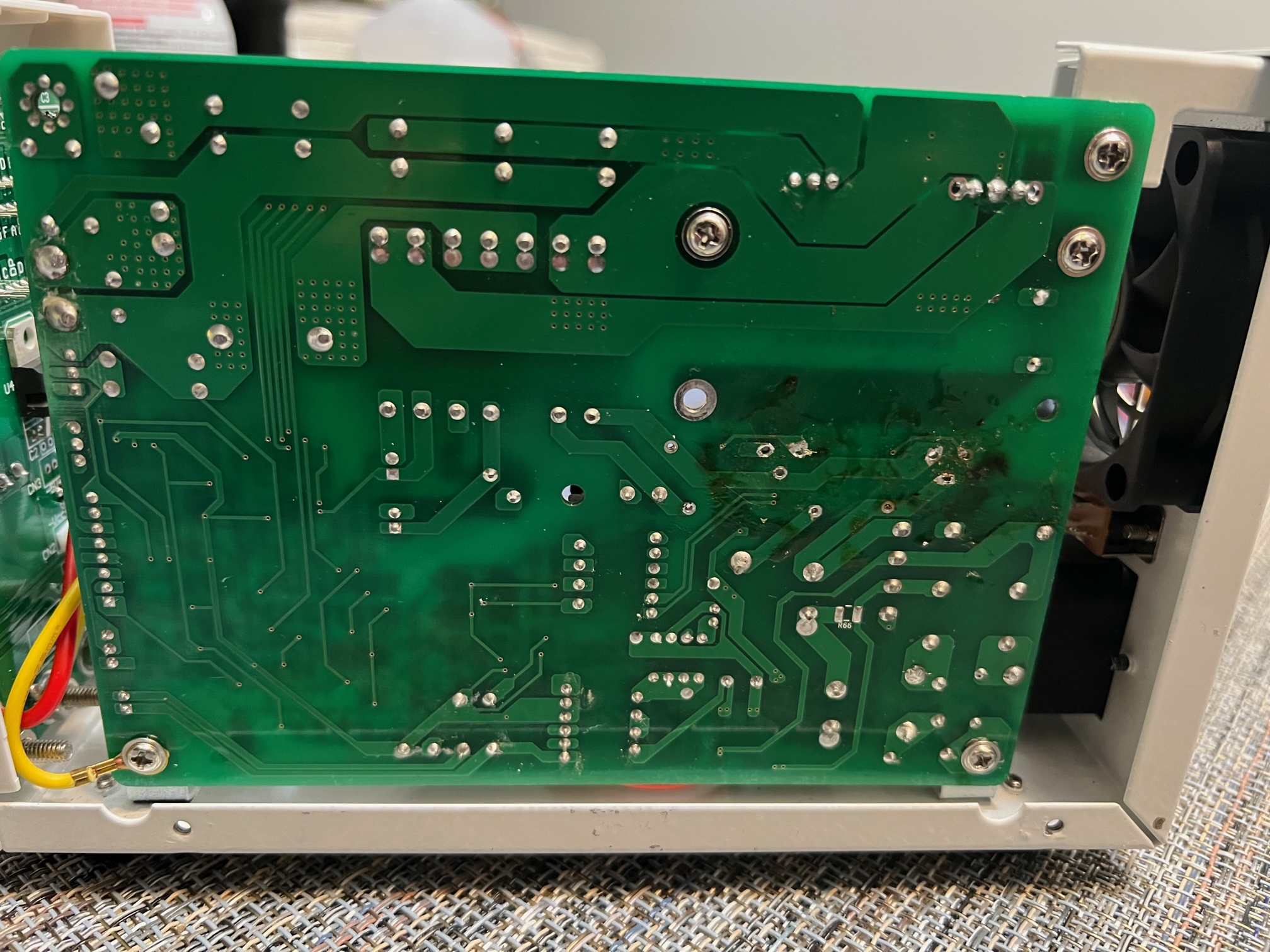

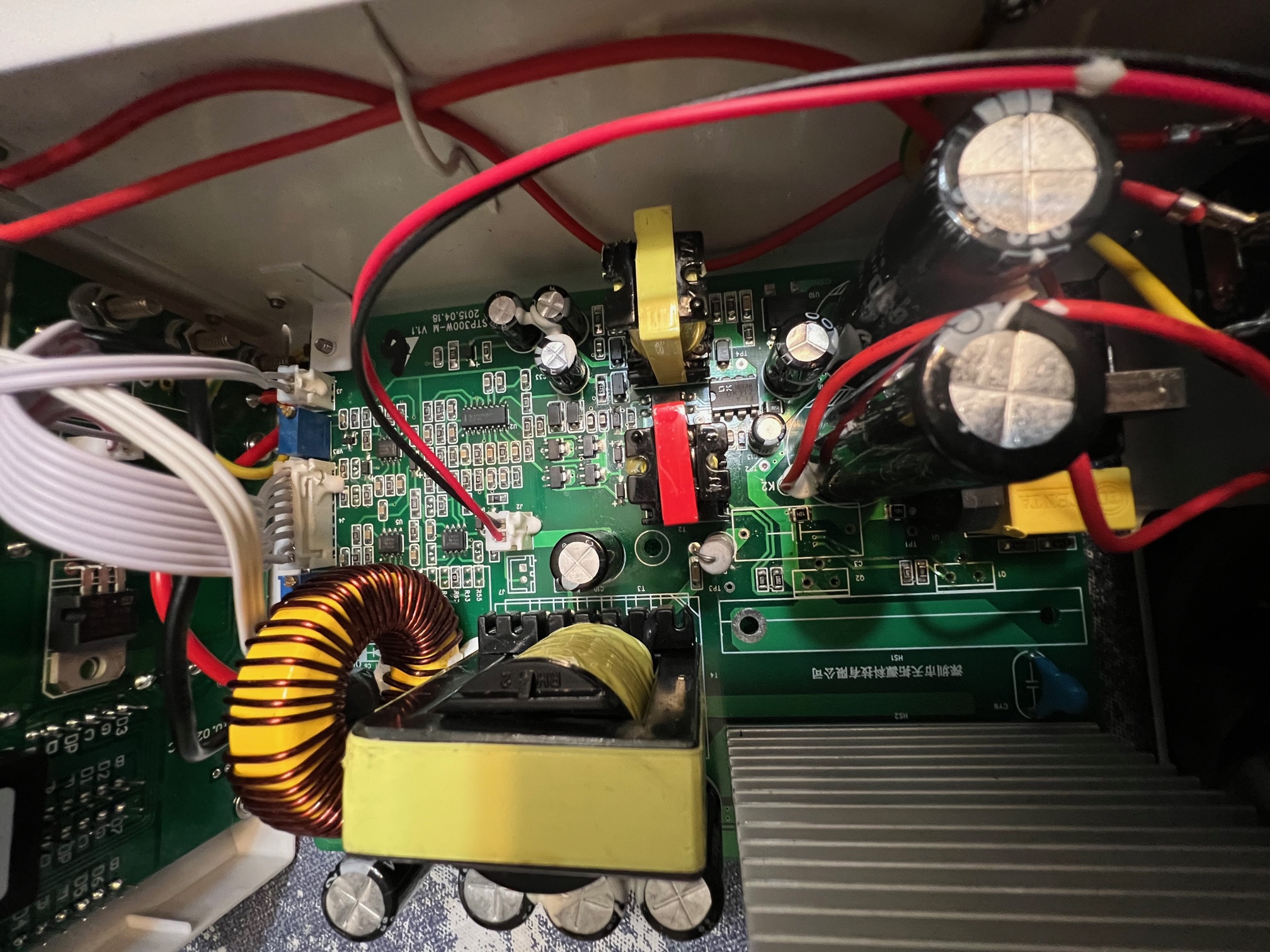

    I have a power supply that has not been used much, several months ago I went to use it and as I was setting up the voltage and amperage I heard a loud pop and the unit turned off. The main fuse was blown. I replaced the fuse and it turned on but was unable to set voltage or amperage, they both stayed at 0.
    upon inspection I found the 2 Mosfets blown along with 2 resistors. The mosfets are PTA09N50 and a 68 and 10k resistors.
    I replaced the components and turned it on, there was no blown parts but the voltage only went up to 2.2V, I turned the unit off and after a while started to toublshoot it, upon turning the unit on the mosfets blew and one of the resistors went open. The main fuse was also blown
    I was unable to find any shorts, any input would be greatly appreciated. please see photos for better illustration.
    the second time I removed the mosfets I ended up peeling back a trace, I will have to repair that.

    if the mosfets gad shorts to the gate then you need to examine the drive circuit
    • mike123333
      • Oct 2011
      • 196
      Re: STP6005 Power Supply
      One Mosfet is shorted gate to drain and the other is shorted gate to drain and source.
      Would the likely area be in the hot side or could the cold side cause an overload. the optocoupler does not seem to be shorted at all.

        optocouplers dont usually short, they go open
        what drives the gate pins

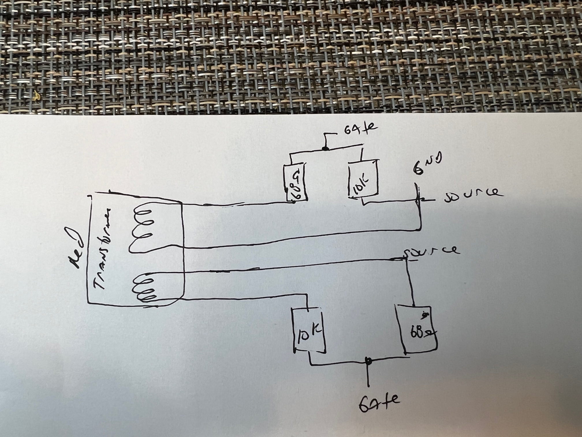

          I sketched out a rough schematic, these go to the red transformer, the drains are tied together to another transformer.
            • 31161
            thats a flashback, not seen a transformer used as a base amplifier since the 1970's!!
            so check the windings are good i suppose, and check whatever drives the transformers

                maybe the transformer is leaky?

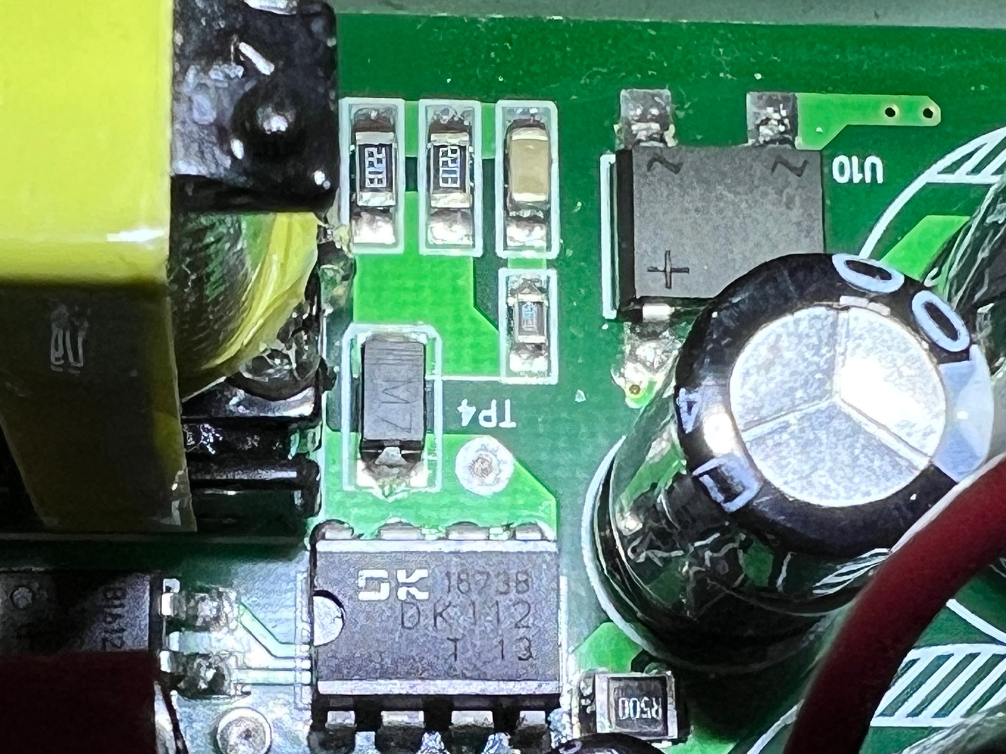

                it actually reminds me of an AT psu,
                i'll look for some schems if you tell me the chip number.
                maybe the chip or small cap is bad?

                      the 8pin chip next to the optocoupler
                      • mike123333
                        • Oct 2011
                        • 196
                        I checked this chip out for shorts and could not detect anything.

                                  By the way , and in another review , you said also "I removed the mosfets I ended up peeling back a trace" . So check if you removed a trace pin between dual sides of pcb .
