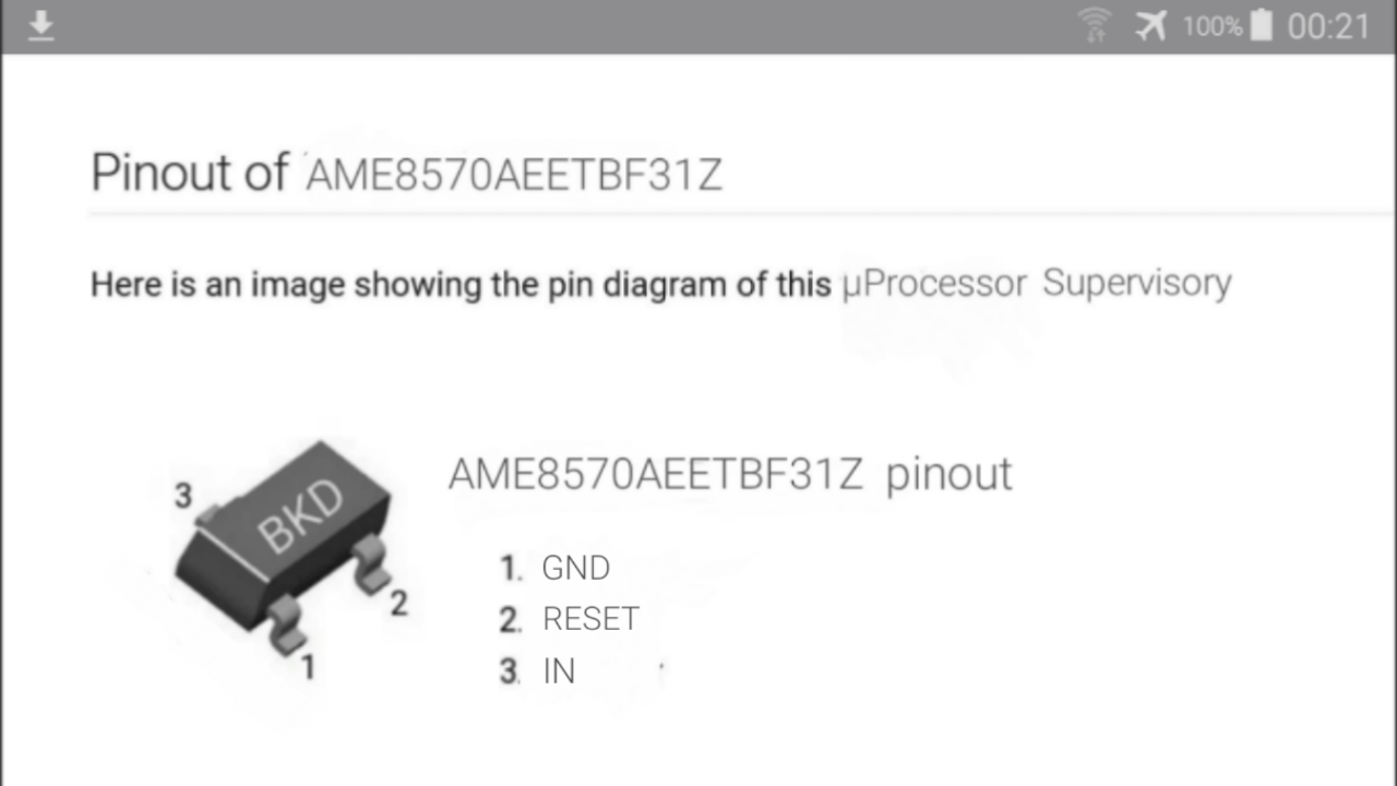

    ALG - LM4040BEX3-2.1-T
    BKD - AME8570AEETBF31Z
    maybe
    but they arent transistors - so you may be looking at them wrongly

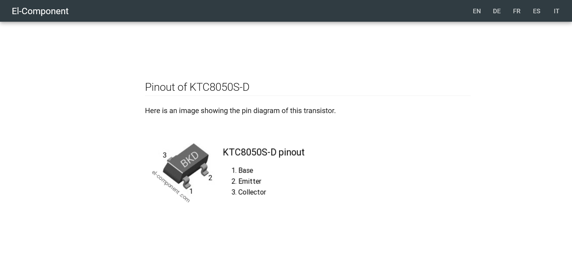

        For the BKD : KTC8050S-D Bipolar Transistor

          Re: Identifying Transistors for Power Supply
          contradicive answers.
          welcome to the world of smd markings

                • 31033
                Originally posted by vanel
                Is having the schematic the only way to know for sure?
                you can look at how a part is connected to the circuit to determine if for example, it's a transistor or a voltage regulator
                  What I gave you is the 100% ... Read the "Marking code" in the datasheet , and so in any datasheet of the BDK ..
                  Hard luck stj ;
                    • 31033
                    nice try but you could read the datasheets of the part numbers i gave too.
                    truth is a lot of codes are used more than once.
                    my databook shows some codes relate to as many as 10 or more devices.
                    it's a total shitshow

                      Show me something like this and it's no problem stj;
