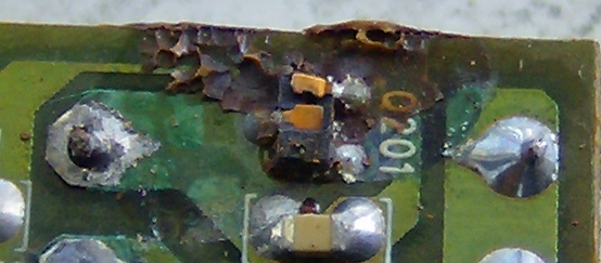

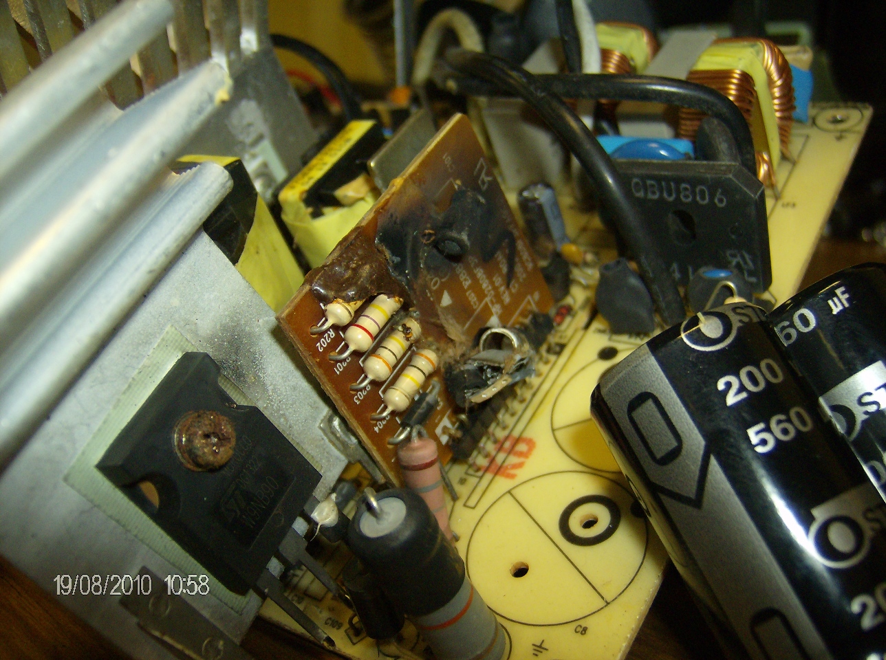

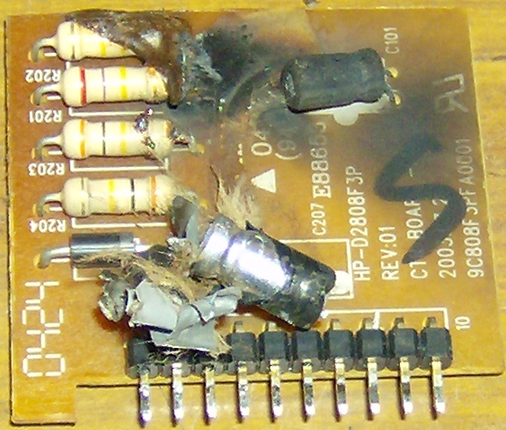

    This PSU came in a HP workstation xw4100, looks like the little board labeled "CTR BOARD" had some problems,
    https://www.badcaps.net/forum/attach...1&d=1282236762

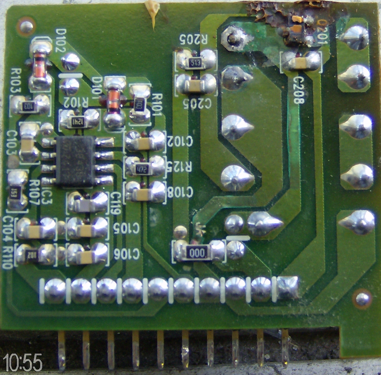

    i have managed to look the caps values and resistances colors, but im having trouble with the SMD on the back.
    I believe is a transistor but, i am not sure, and if it is i dont know what is its part number... i was wondering if anyone has this particular model and could help me out by taking me a look...? please.
    Also, given the fact that i do not have around any other of this unit, i dont know if i could find the specific part even if known... so I began wondering what replacement could I use?? (if i cant get that specific) what should i be looking for in my dead PSUs cemetery? (cause i sure am I wont get new SMDs around)
    Any info, tip or advise is appreciated.

    Looks like no one has a psu just like yours, but I have one that is similiar, probably an earlier model, the HiPro HP-D2537F3R.
    The resistor values are:
    R201 270k
    R202 240k
    R203 300k
    R204 300k
    The one I fixed, R201 and R203 were open
    The transistor is Q201, and the marking on it is BR (two other characters afterward I could not read, very tiny letters or symbols). It is a NPN transistor used to switch on the 5vsb pwm chip, a KA1H0165R.
    Voltages on Q201 when working properly are:
    emitter 24.4 volts
    base 25 volts
    collector 24.5 volts
    The capacitor I could not read the value of it without unsoldering and removing the small pc board from the main pc board. The capacitor also had glue all over it, making reading values near impossible.
    Hope this helps.
