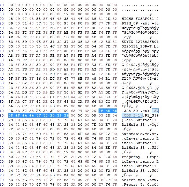

WANTED: Teboview / TVW file format specification to write OpenBoardview decoder
  • inflex
    • Aug 2012
    • 545
    There's file format called "Teboview" with an extension .tvw, and I've noticed some Lenovo laptop boards are using it.
    I would like to write a decoder for the format for OpenBoardview but thus far, naturally, I've not found any useful specification on the internet. I've downloaded TeboView-ICT but unfortunately it also doesn't provide a lot of information about the technical information for each part/net/etc.
    I've decoded a moderate amount of the file format but I would *really* appreciate it if anyone could drop a file format spec accidentally
    There's at least one 3rd party program out there that can decode it that I know of but I'm not sure how they got the spec and it's unlikely they're going to share it.
    As an alternative, if anyone has some *small* TVW files they'd like to share, that might provide me a smaller search space to decode the puzzle.
    Most of the files I have now are 1MB+, something simpler more along the lines of 100K would be vastly preferred

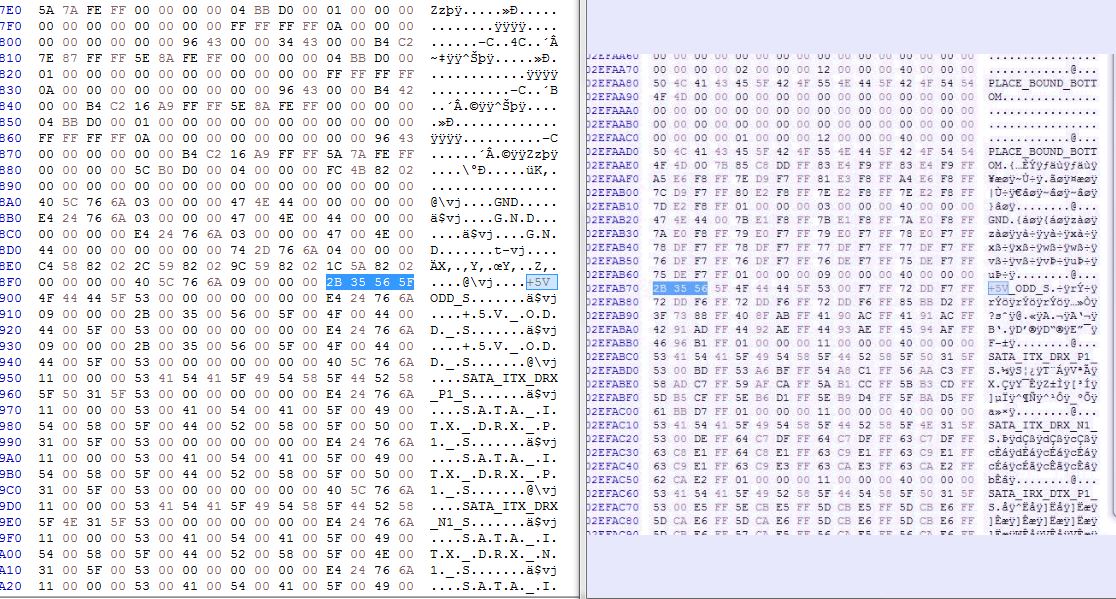

            • mmu
              • Aug 2019
              • 28
              • France
              Re: WANTED: Teboview / TVW file format specification to write OpenBoardview decoder
              Oh, Pascal strings everywhere :-)
              Looking at the 3 example files, and counting strings with backslashes inside, it seems to me the 4th value in the header after all the strings should be the layer count.
              I started writing a python parser, not much else to see yet.

                        • inflex
                          • Aug 2012
                          • 545
                          Trying to write a format table for these types of very dynamic (length) structures is frustrating. I'll try write something with more clarity

                            • inflex
                              • Aug 2012
                              • 545
                              I've updated the fileformat description document with what I'm trying to achieve
                              Code:
                              PART entry:
                              type/details	| description
                              string		part name
                              int32		bounding box minimum x
                              int32		bounding box minimum y
                              int32		bounding box max x
                              int32		bounding box max y
                              int32		center x
                              int32		center y
                              int32		rotation (degrees)
                              uint32		unknown (132)
                              uint32		unknown (0)
                              uint32		unknown (1417)
                              uint8		unknown (1)
                              string		metadata about part (100K etc)
                              int16		unknown
                              string		package name (case insensitive)
                              string		unknown, possible UID
                              uint32		unknown (0)
                              uint32		pincount
                              uint32		unknown (2)
                              PINS			Array of pins
                              PIN entry:
                              uint32		networkID/map entry
                              uint32		unknown (0)
                              uint32		integer pin index (1-based, ie, 1, 2, 3...n)
                              string		pin name (1, 2, 3 etc for small parts, or AA42, B24 etc for BGA)
                              uint32		unknown (0)
                              YouTube Repair Videos - https://www.youtube.com/user/19PLD73
                              FlexBV BoardView software - Linux/OSX/Windows - http://pldaniels.com/flexbv

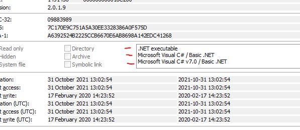

                                  • mon2
                                    • Dec 2019
                                    • 14566
                                    @mmu, try this Boardviewer:
                                    https://we.tl/t-Gs3ZMzhbWY
                                      • 21467
                                      It is in dot net. Theres a good app for windows called dotPEEK that might help to decompile part of it

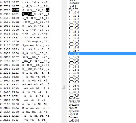

                                      • mmu
                                        • Aug 2019
                                        • 28
                                        • France
                                        Thanks, this one runs, but doesn't help much.
                                        The decompiled version doesn't have much info, just tons of hex :-)
