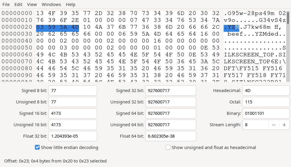

    Removing the password is trivial.
    I took a file which has a password in it, and removed the string that occurs after the .G34S string and set the string length byte to 0. Now is readable in TeboView 4 without requesting the password.

      Oddly the Gigabyte file didn't open in TeboView 4 even after stripping the password… But forcing the previous string to "G34…" stopped it from complaining about license :-)
      Opened a PR with a python tool to strip the password.

        Anyone want to throw a theory on why some of the TVW files have this extended sort of header before the first labelled layer?
        Seems there's a few occurrences of the 0 3 2 1 sequence in it.
        This is the Gigabyte file that was attached in a slightly earlier post here in this thread.

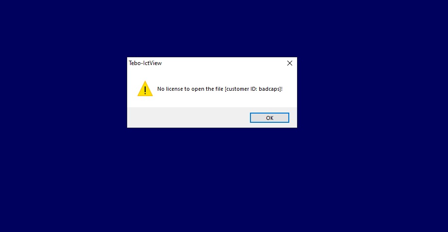

          For decoding Customer ID
          0000000 1111111 2222222 3333333 4444444 5555555 6666666 7777777 8888888 9999999
          efgefge fghfghf ghighig hijhijh ijaijai jabjabj abcabca bcdbcdb cdecdec defdefd
          aaaaaaa bbbbbbb ccccccc ddddddd eeeeeee fffffff ggggggg hhhhhhh
          3453453 2342342 1231231 0120120 9019019 8908908 7897897 6786786
          iiiiiii jjjjjjj kkkkkkk lllllll mmmmmmm nnnnnnn ooooooo ppppppp
          5675675 4564564 vutsrqp wvutsrq xwvutsr yxwvuts zyxwvut kzyxwyu
          qqqqqqq rrrrrrr sssssss ttttttt uuuuuuu vvvvvvv wwwwwww xxxxxxx
          ikzyxwv mlkzyxw nmlkzyx onmlkzy ponmikz qponmlk rqponml srqponm
          yyyyyyy zzzzzzz
          tsrqpon utsrqpo
          First Number
          0 e
          1 f
          2 g
          3 h
          4 i
          5 j
          6 a
          7 b
          8 c
          9 d
          a 3
          b 2
          c 1
          d 0
          e 9
          f 8
          g 7
          h 6
          i 5
          j 4
          k v
          l w
          m x
          n y
          o z
          p k
          q l
          r m
          s n
          t o
          u p
          v q
          w r
          x s
          y t
          z u
          75785zn

            Oh my, how did you conjure this up? Inside knowledge or just worked out the crypt?

              I never use teboview
              just search and compare

                It does appear in boardviewer

                    license must match in the program to open the file. otherwise failure
                    The license can be modified in IctViewLicense.dll

                                  First byte 07 is sum of chars .
                                  07 47 33 34 76 53 34 7A 00 11 59
                                  _________ HEX ____________ASCII ____ DECODE______
                                  07 47 33 34 76 53 34 7A = G34vS4z = LianBao
                                  possible to modify the number of characters but you have to remove unnecessary letters from the dump, just leave 00 at the end.
                                  03 48 6E 49 00 11 59
                                  EX: 03 48 6E 49 = HnI = MxP
                                  8 chars max
                                  blocked by exe, not succeeded in putting more

                                    Added a string decoder for testing, and will add this to the main program later.
                                    https://raw.githubusercontent.com/in...ode-string.cpp
                                    Code:
                                    pld@WorkstationTT:~/development/pld/teboviewformat$ gcc -Wall decode-string.cpp -o decode-string
                                    pld@WorkstationTT:~/development/pld/teboviewformat$ ./decode-string 75785zn
                                    badcaps

                                        (the 3-2-1 sequence appears to be a header/lead-in as opposed to a suffix).
                                        indicates the start of each chapter or page, the last byte change, I don't know how to explain
                                        exemple:
                                        03 00 00 00 02 00 00 00 01 00 00 00 0E SILKSCREEN_TOP
                                        03 00 00 00 02 00 00 00 01 00 00 00 0E SOLDERMASK
                                        03 00 00 00 02 00 00 00 01 00 00 00 03 TOP
                                        03 00 00 00 02 00 00 00 01 00 00 00 03 IN1

                                          The last byte is the string-length of the layer name.
