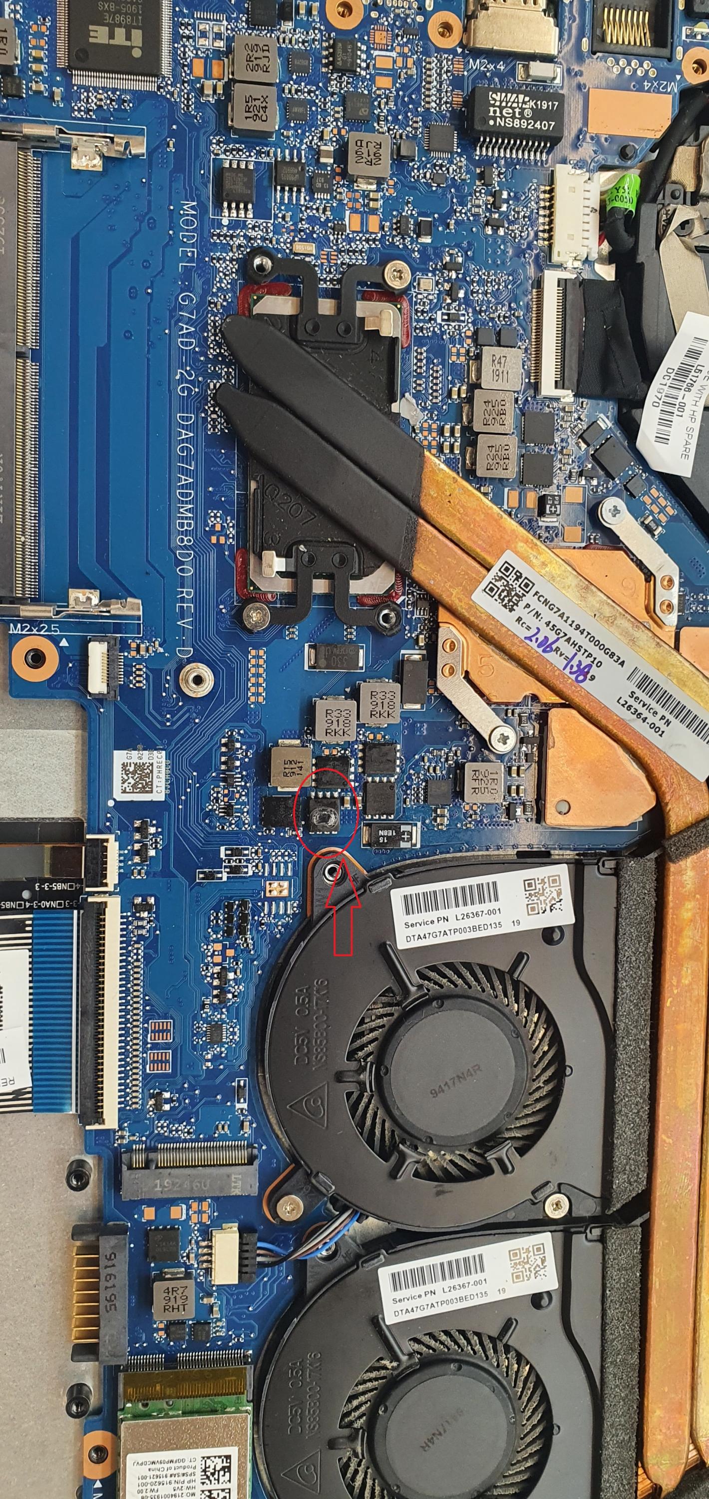

                  hi, i need help finding shematics or identifing this component. already try to replace for another n-type mosfet- still geting bsof after gpu driver instalation
                  • anshad
                    • Nov 2010
                    • 249
                    Re: hp 14-ce1002ne DAG7ADMB8D0 boardview or schematic
                    Probably won't matter even if you replace the original part. The short is more likely to have caused irreversible damage to the CPU/SoC by sending 20 volt directly instead of stepping down to a smaller voltage (close to 1v). Since you have mentioned BSOD after installing the graphics driver, i assume the PWM in question supplies core voltage to the internal graphic engine of the CPU (Intel HD Graphics). I have Seen this kind of CPU damage caused by shorted Mosfet dozens of time.
