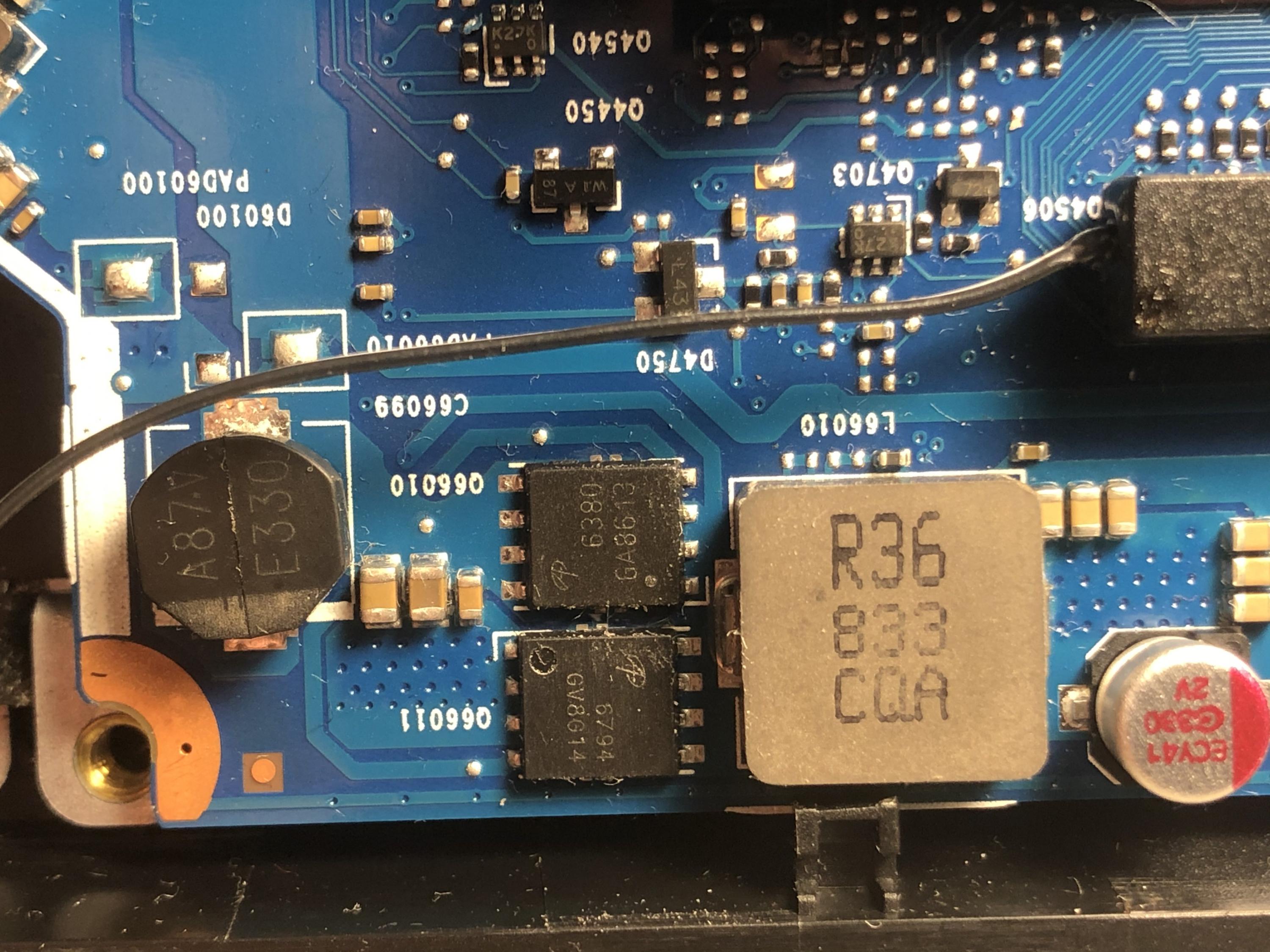

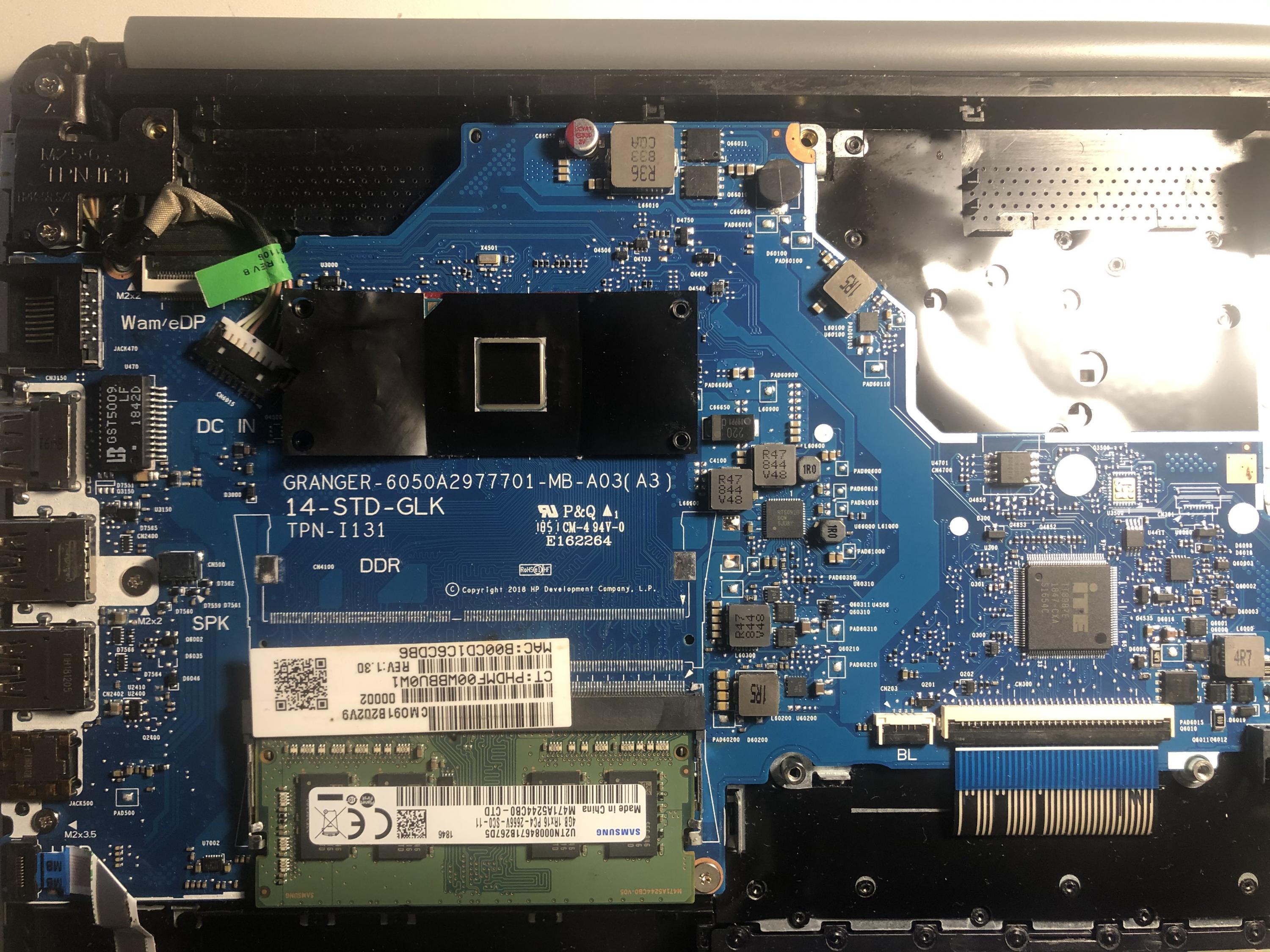

    Hello ppl!
    I have a Hp 14 Laptop CK09890NA, and I have searched on net trying to find a schematic, but I couldn't get nothing about this model except the BIOS file.
    The motherboard is GRANGER-6050A2977701-MB-A03 (A3), 14-STD-GLK, TPN-I131. Laptop won't boot, and I find that the power Mosfets are damaged but I can't identificate them. They are marked as Q66010 AND Q66010 on the motherboard.
    1 Mosfet - 6794 GV8G14
    2 Mosfet - 6380 GA8613. I couldn't find anything on Google.
    Any help I will appreciate much.
    Kind Regards from Lisbon

    Second picture shows CPU VCore MOSFETs and they don't look damaged.

      the mosfet q66011 is an aon6794 and the other is aon 6380
