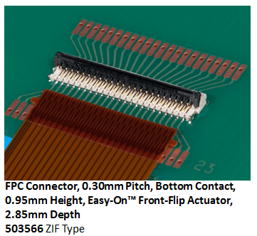

    I recently picked up an Asus G750JM, and the LVDS connector was fried from the last guy forgetting to remove the battery before putting a new LVDS cable on. I already replaced the cable, but the connector itself is still bad. I took it off, but I'm unable to find a replacement online for some reason. I'm not sure if I'm just searching the wrong thing or what, but I just have no idea where to get one. Looking for a few of them, because I've got a few other asus laptops which use the same connector which I need to replace (tried to take the connectors off of them, but the plastic melted).
    I'm also looking for a board view for it, just in case I need to replace a fuse or something on it. Thanks!

                Couldn't find it there, either. I'm attaching a picture of the connector that I took of another board, one that I don't have the GPU for.

                  Re: Asus G750JM board view and unable to find replacement LVDS connector?
                  this type of connector is very hard to find on the market but it's soldered on various motherboards not only asus.
                  I have desolder it from a common hp mobo.
                    Yeah, I have an old Phenom II HP board that has it, might end up just trying to take it off that. I'd really prefer to find where to buy them just to make things easier though.
                      https://world.taobao.com/item/529038476275.htm
                          Originally posted by swimllamaswim
                          Thank you SO much!!
                          Or Aliexpress.
                          https://www.aliexpress.com/item/LCD-...2519096376.htm
