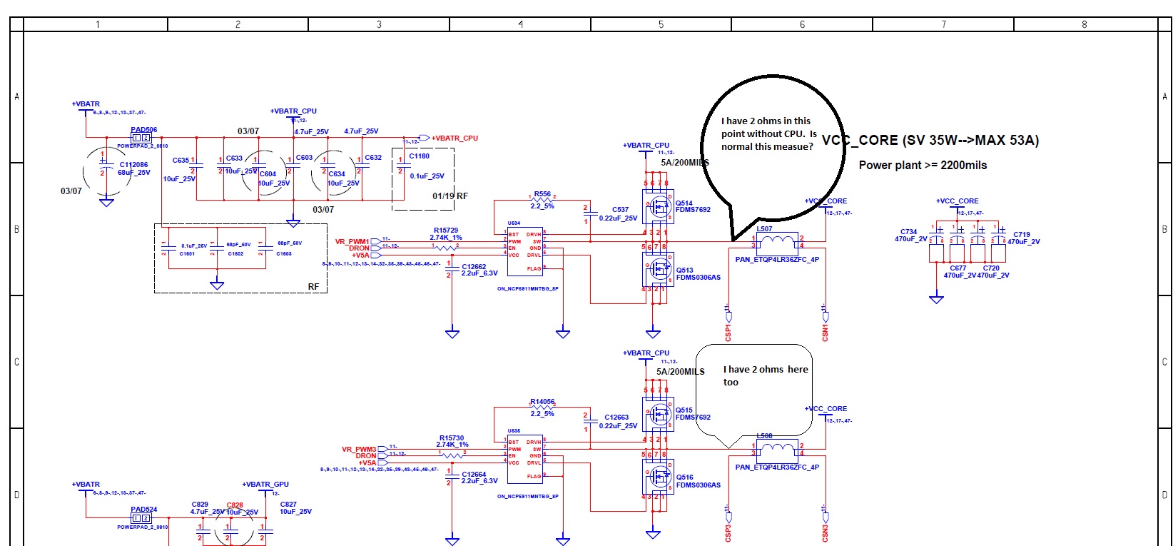

    Doubt in this diagram laptop.
    Hello, I have a doubt in this diagram laptop.
    Annex picture. Could you tell me if it is normal the value of 2 ohms off the coils. The reading was taken without processor.
    That value should be?

    Re: Doubt in this diagram laptop.
    If measuring relative to gnd without cpu 2 ohms, then no. Should show high resistance.
      more than 5ohm. remove coil to locate short
        OK, will remove coils, and will measure again.
        That value should be aproximadamente? 50 ohms or more ? 100 ohms
          2 Ohms measured between the two legs of the inductor? The DCR will be very low which is normal, if 2 Ohms against GND then is not normal.
          POWER MOSFET Q513, 516 may be bad or bad filter caps.
            Ok. The mesure is if 2 Ohms against GND ,. Es very low. I removed Mosfet and the measure is the same.: 2 ohms. I will measure caps
              "I removed Mosfet and the measure is the same.: 2 ohms. I will measure caps" both Q513, and Q516?
                Hi, removed all mosfet y the measure is the same : 2 ohms
                  Did you remove the coils? Normal resistance should be hundreds of ohms or higher.
                    Hi... RESOLVED!!! C734 BAD .
