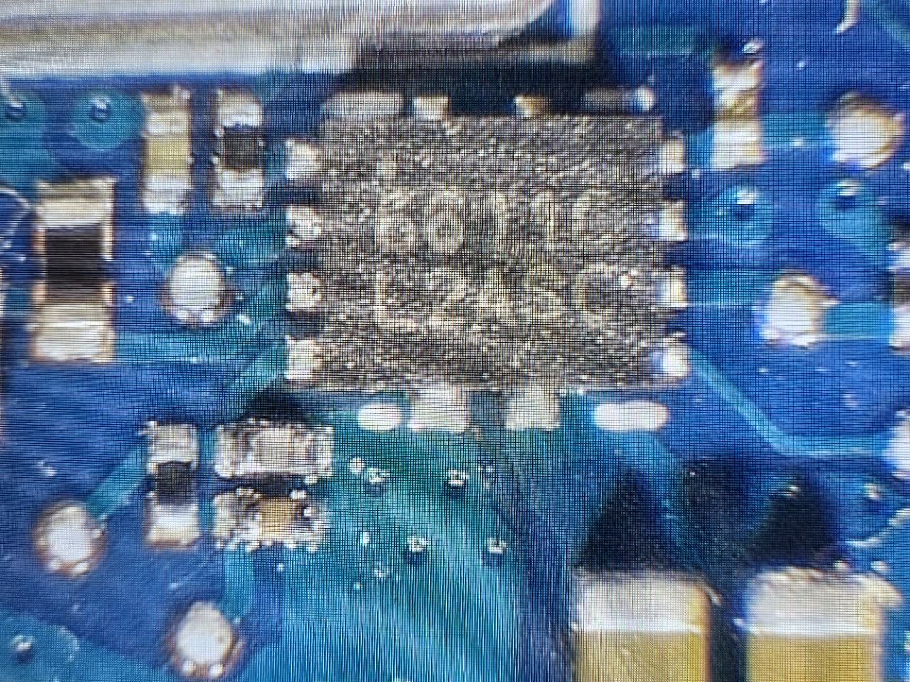

    Help identifying a chip for Lenovo Slim 7 16IAH7 - schematics needed
    I have this Lenovo Slim 7 16IAH7 notebook that is not booting properly. All voltages are there: 5v, 3.3v, 1.8v but it's still a no-go.
    I spotted this IC chip with markings "6611c" on it. The coil near this chip measures around 200 Ohms which I think is too low. But without the schematics, it's just a guess.
    I wonder if someone has the schematics for this board or perhaps, can help me identify this particular ship. Thanks.

    Mother board model number.. NM-E241 ?

      chip =6611C= is SGM6611CYTQV11G
      schemtics is here https://www.badcaps.net/forum/troubl...29#post3208329

        The motherboard number can't be found anywhere on the board. It has Lenovo FRU: 5821J18076 printed on it.
        SGM6611CYTQV11G is exactly what I was looking for. The coil next to it measures about 150Ohms resistance which I think is too low. By doing voltage injection, only this chip lights up.

          It might be marked on the other side of the board, i think it`s NB6188B-MB-V2 I7-12700H
