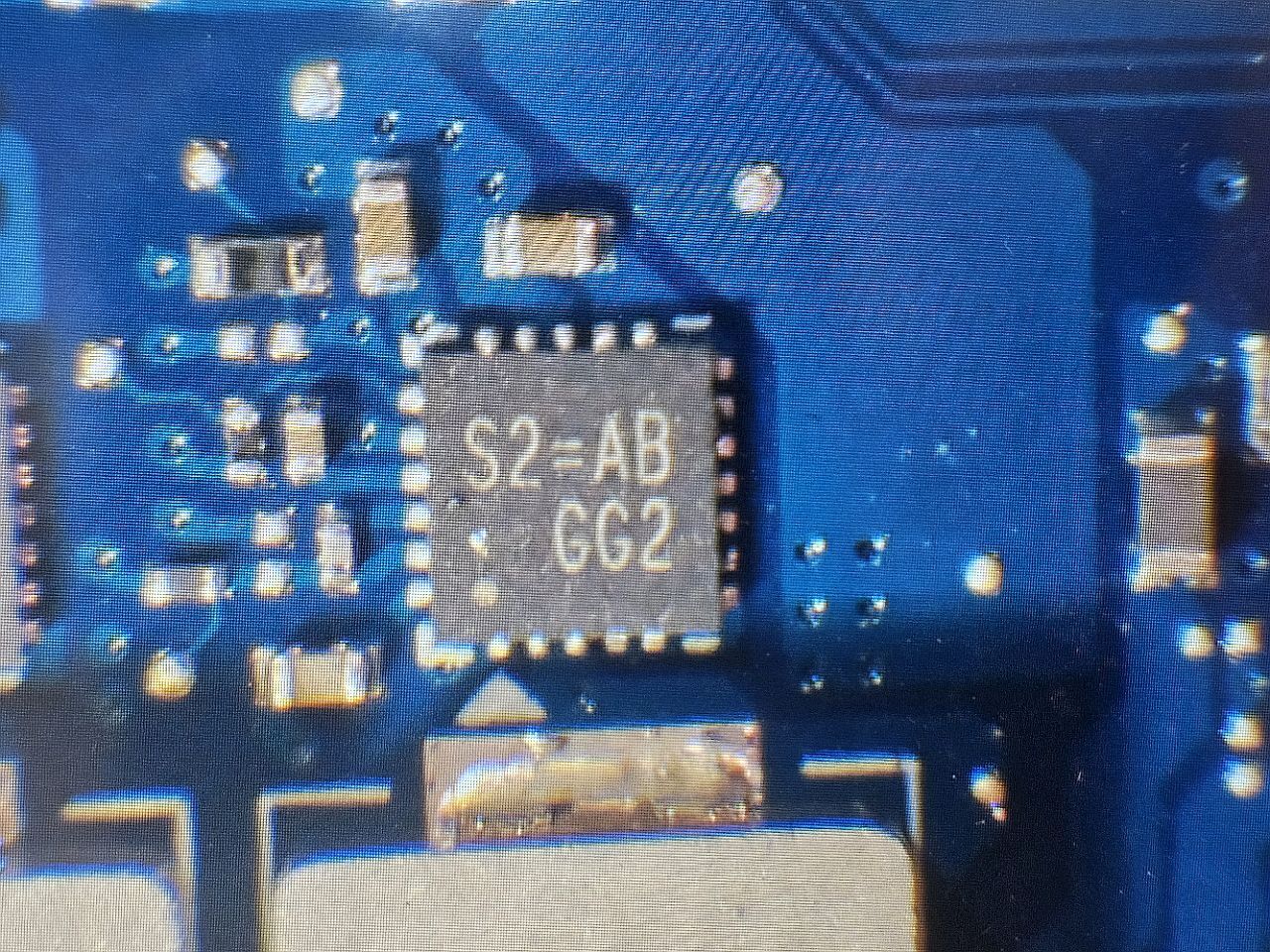

Help identifying this chip for Yoga 7 16IRL8
  • trepachka
    • Oct 2022
    • 429
    This chip is shorted thru. Based on what I see, it's either a 3.3V or 5V buck converter, just my guess. The markings on the chip state "S2=AB".
    A photo of the chip is attached.
    Thank you.

    richtek RT6310C
    • trepachka
      • Oct 2022
      • 429
      Thank you. In particular, "S2" implies RT6310CGQUF chip
