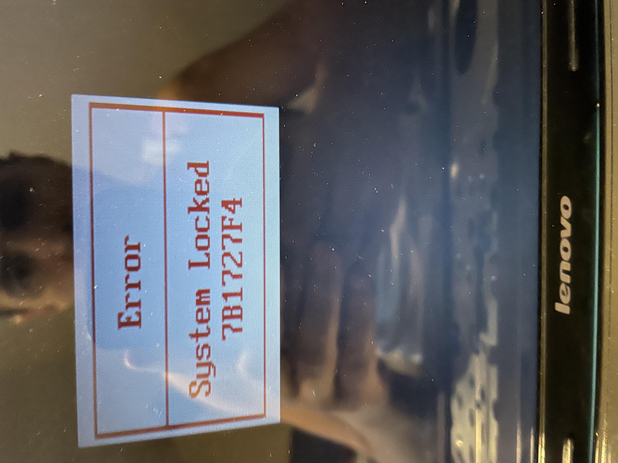

    Hello, I have this Lenovo IdeaPad Z580 (model name: 2151) that has a bios lock. (MB: DALZ3AMB8E0 REV: E)
    What I tried:
    Remove Cmos battery - no help
    Short bios pin (i see this somewhere on the internet) - no help
    On the MB there is two Winbond IC's. (25Q64FV and 25X40BV)
    I read the .bin data from 25Q64FV and try to use Lenovo Autopatcher from this post but I got an error.
    Does anyone know why is there a two Winbond IC's? And how can i remove bios password?

      After 3 wrong password i get a message:
      "Error: System Locked (and some code, this code is different every time).
      Here is an example of codes

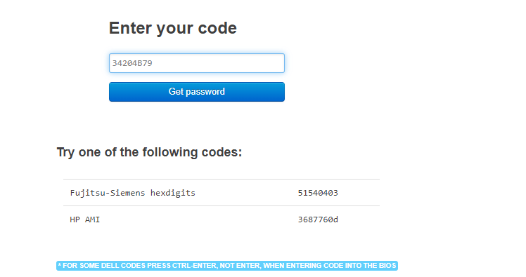

        Yep, put the challenge code in https://bios-pw.org/ and you'll get password, restart and write password.
        • rtstorm
          • Feb 2012
          • 971
          • Croatia
          Re: Lenovo Z580 Bios Unlock
          I try that and i get this (see attachment) and none of those password works

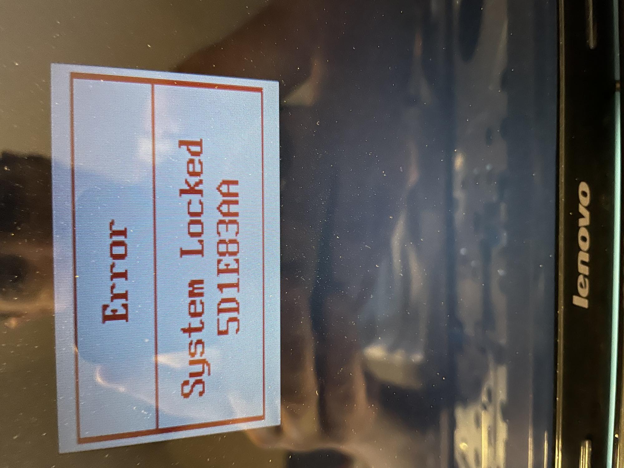

                          Ok, so i restored the original .BIN file and here is the new code 1EC34EF5.
                          But i notice that again the fan is at full speed and again the laptop turn off after 30-40sec
                          ...the quieter you become the more you are able to hear...
                          • fxreen
                            Banned
                            • Sep 2022
                            • 39
                            • Brazil
                            Password: F30364A2

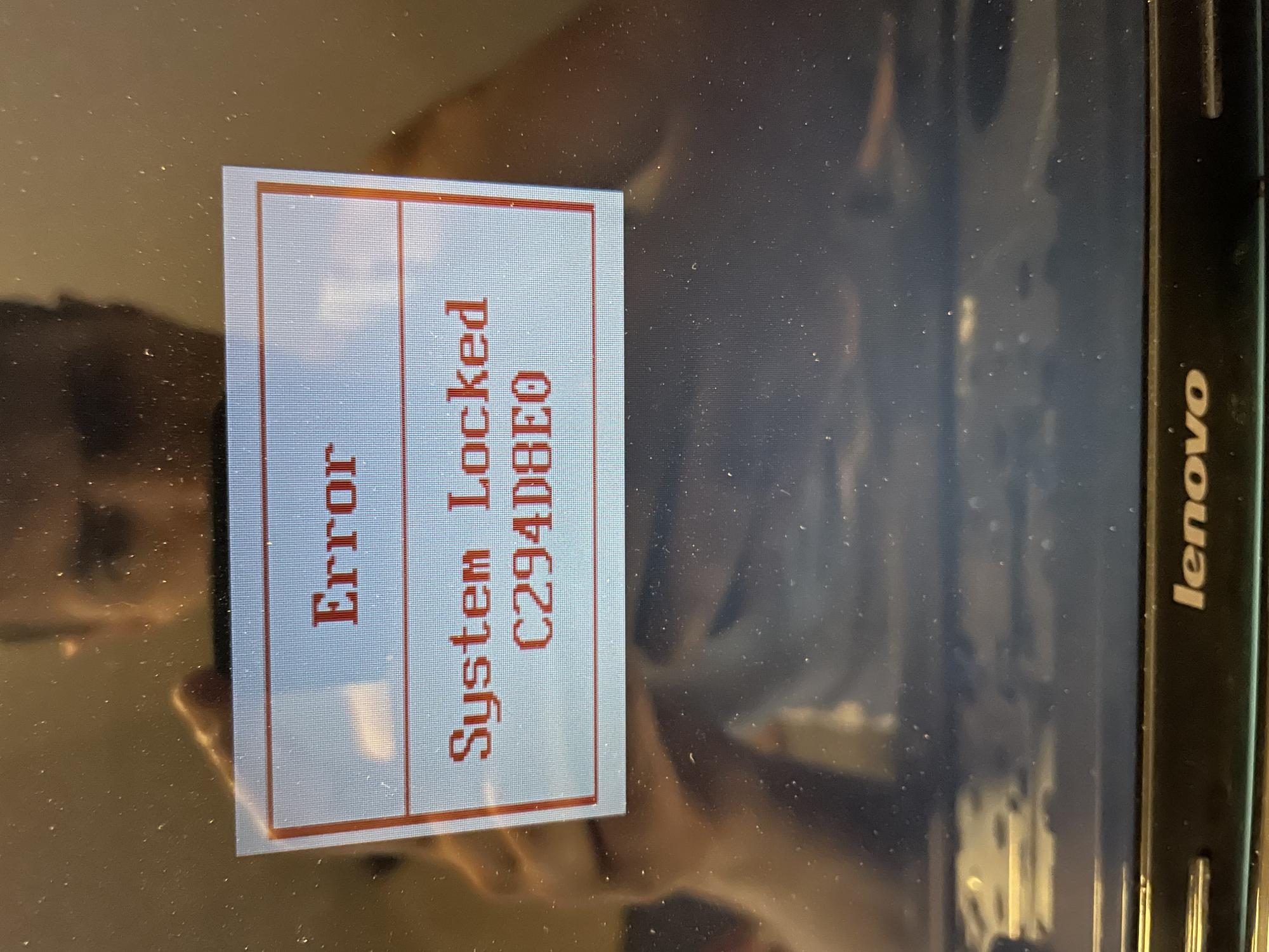

                              did not work, this is a new code 81F86127
                              • fxreen
                                Banned
                                • Sep 2022
                                • 39
                                • Brazil
                                IMPORTANT: Do not type anything until you have received the Unlock Key (password), as Hint Code will change every 3 incorrect passwords. At second incorrect password force computer shutdown and try again.
                                Password: 297934B0
