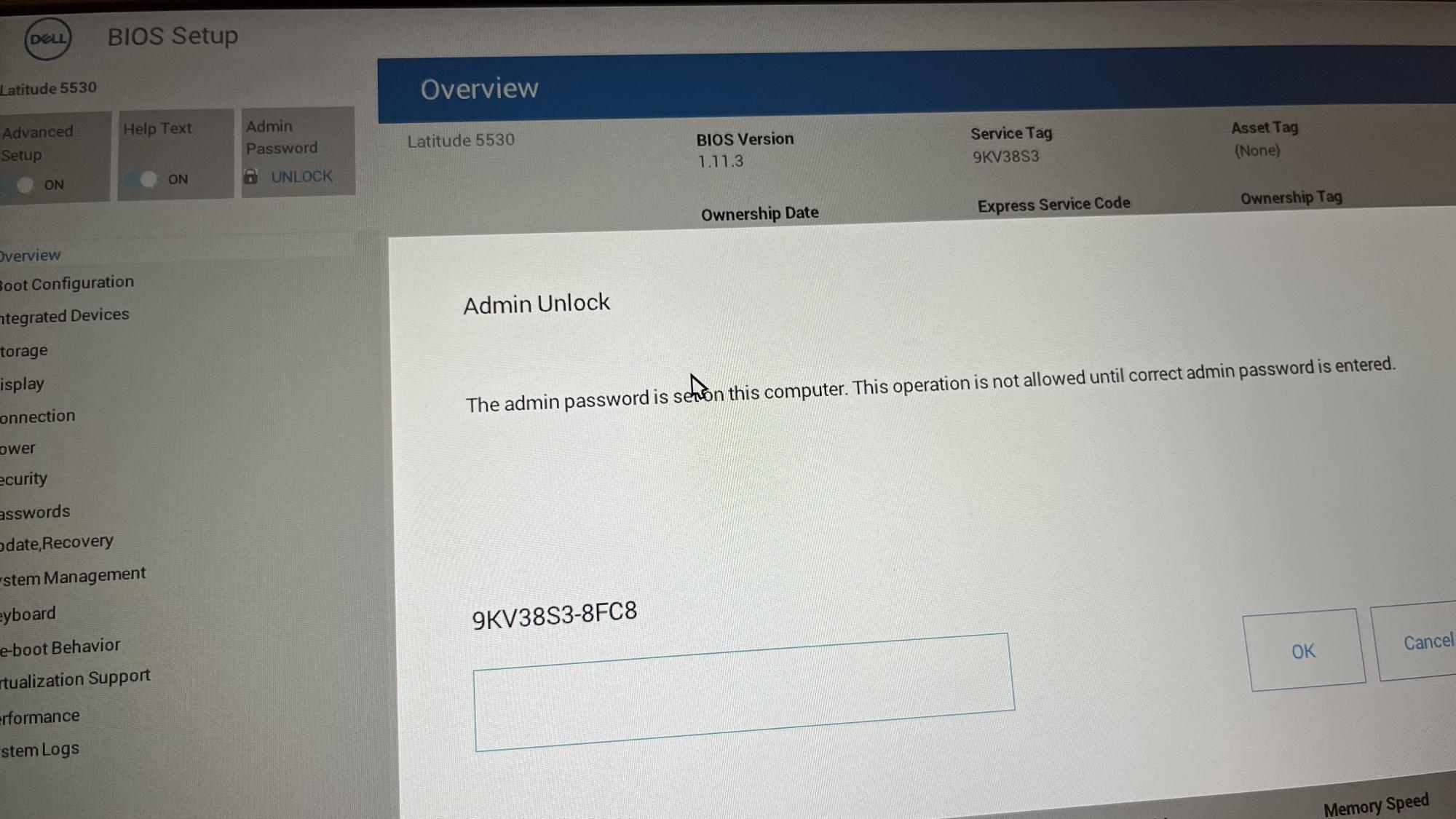

    Originally posted by ACHRAFJIRANI
    8fc8 bios pass
    pls unlock
    Unlocked:

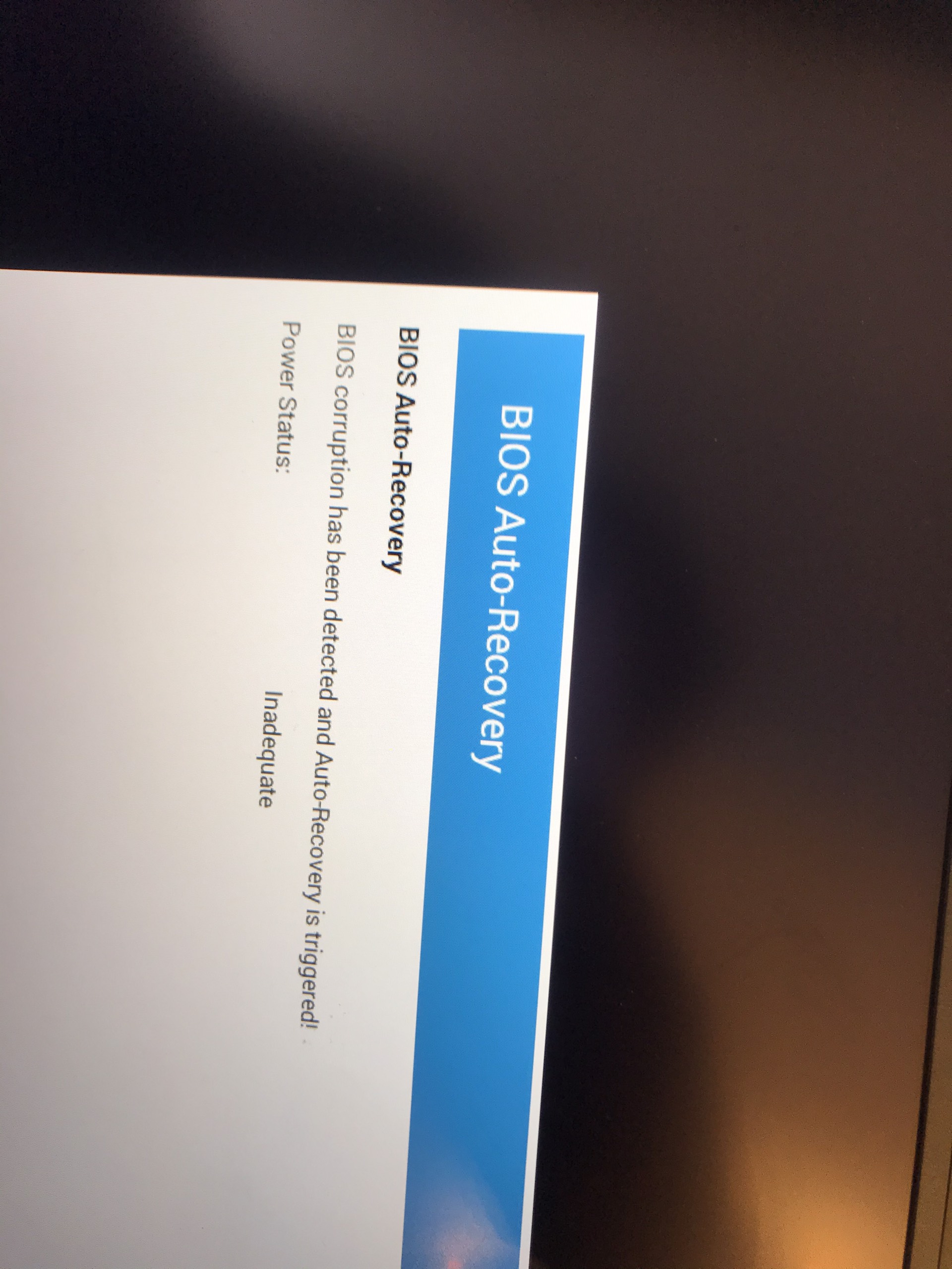

      Re: Dell Latitude 5530 bios dump??
      Need fix bios dell 5530 with bios password
      i have try to clear but after clear bios pass, bios show error like picture i add
      SN Tg: HH10WL3
        SN Tg: HH10WL3
        i have done by replace bios region

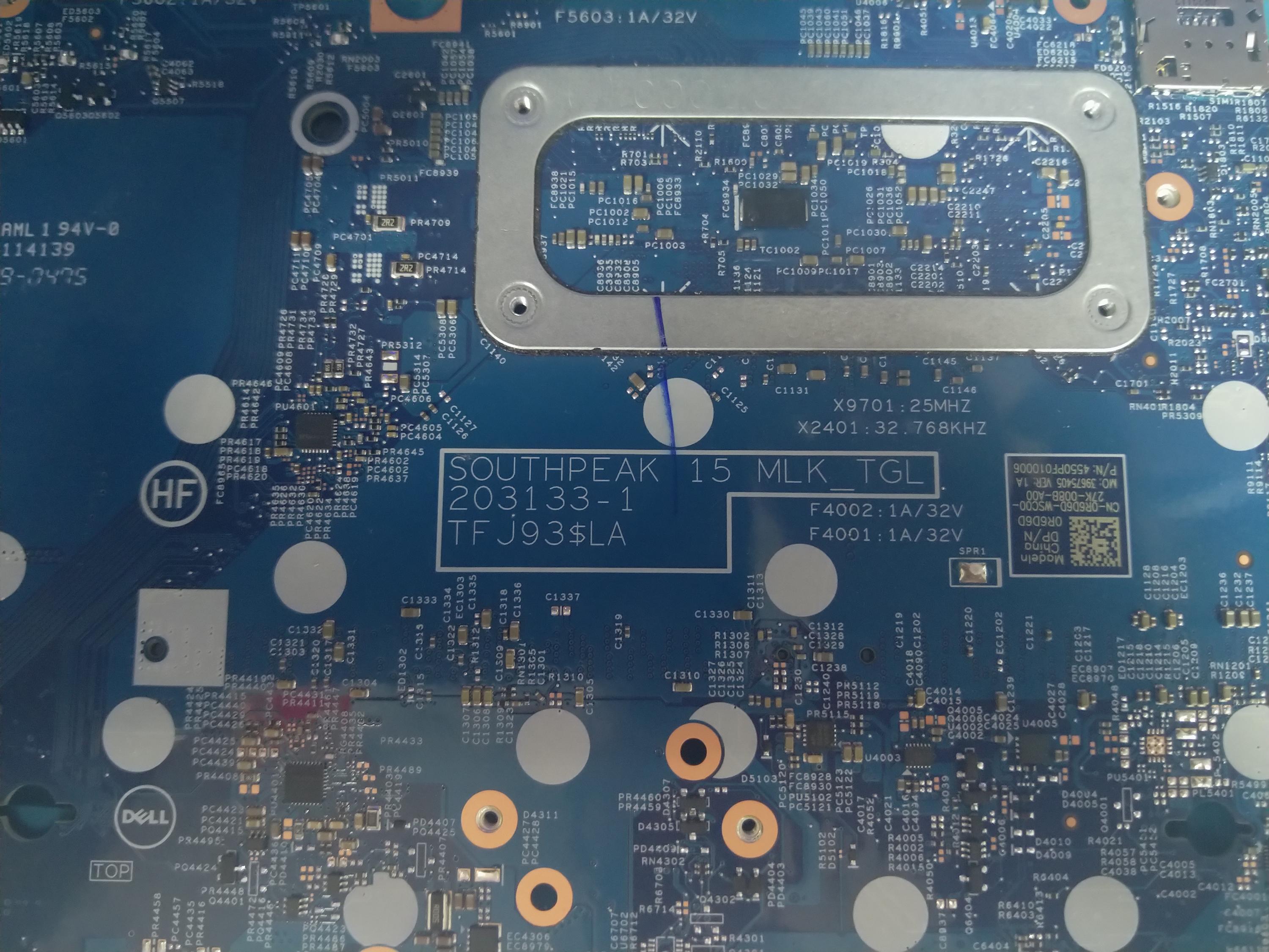

                    Please Guys , I need repair for this dump
                    Dell Latitude 5530
                    M/B : SouthPeak 15 MLK_TGL 203133-1
                    S/T : 38GGSL3
                    original bios attached ( laptop turn on 3 times with keyboard light then off)
                      Dell Latitude 5530
                      S/T : 38GGSL3
                      Here's your New BIOS, try it and let me know the results.
                      Are you sure from the Motherboard Number? Because I can't find any reference for it.

                        #31
                        Yeah, I tried searching too, new Dell model i think
                        I will give feedback immediately after test

                          #32
                          LAPTOP POWER ON , THANK YOU BOSS

                              #34
                              That's good, you're welcome.
                              after booting and exiting manufacturing mode with ALT+F, the fan still runs continuously at high speed, the CPU is not even hot, and all the drivers have been installed from the official site
                                Your Service Tag is exist in the BIOS Menu or not?
                                all donations are welcome,
                                  yes, empty S/T was modified in first boot, and also manufacturing mode disabled with alt-f after saving .
                                    So there's no error messages or any delay in startup?
                                    You can try to update the BIOS through Windows. Also it could be a hardware issue.
                                      no error message and also instant boot, BIOS already updated, I will try to follow signals with a similar schematic, since this one is not yet available
